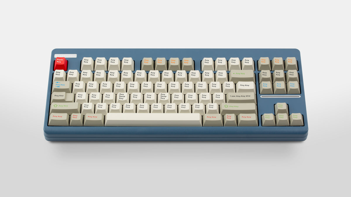

I figured this was some April-foolery, but I guess it’s real. Don’t let your memes be dreams.
