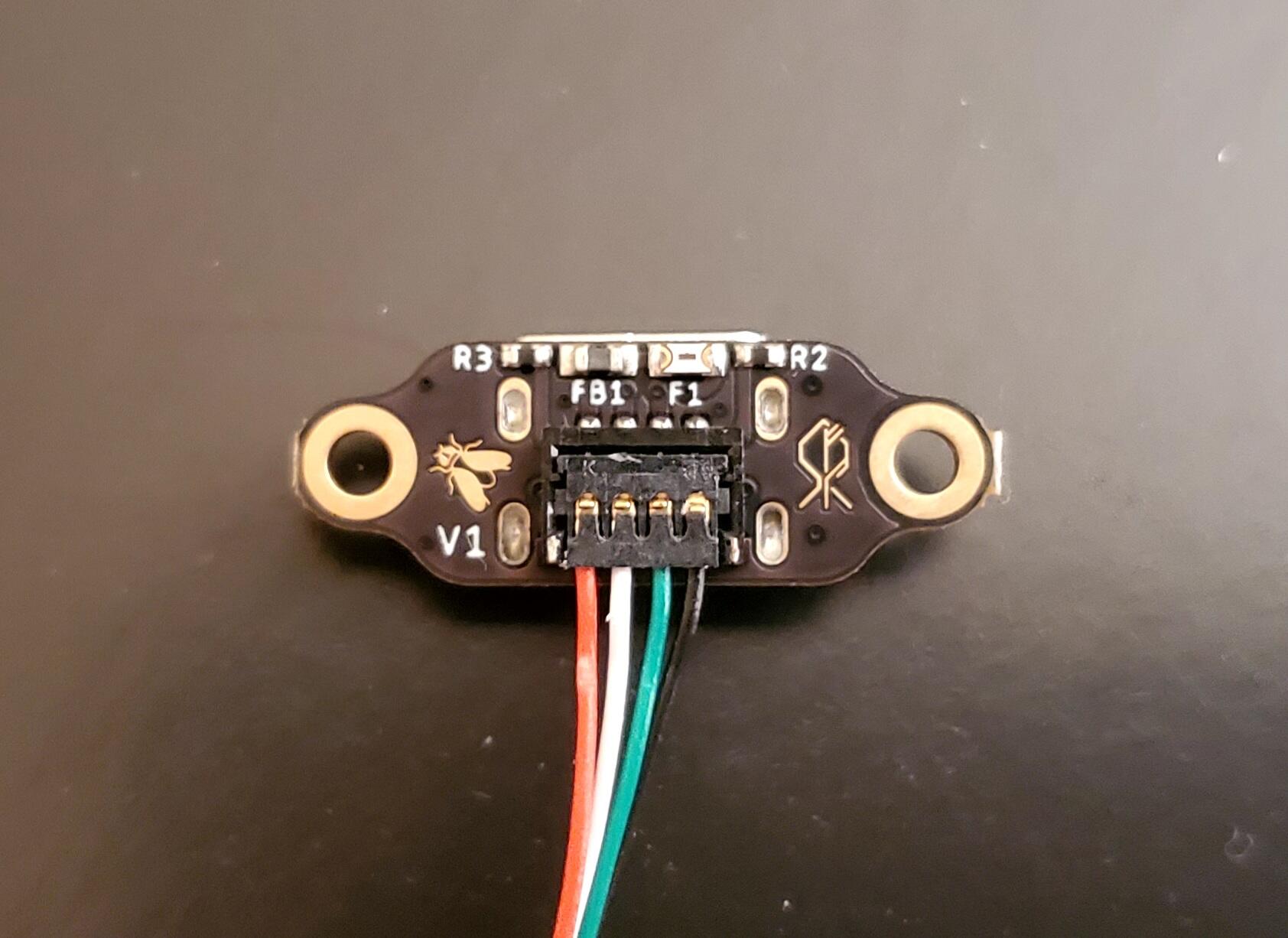

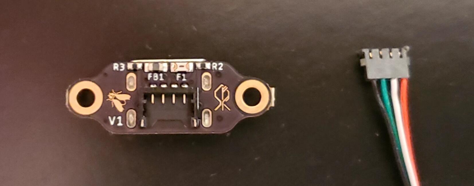

EZmate connectors… They’re kinda stupid compared to good ole’ JST SH. The height difference is minimal & the connection itself is kinda questionable. Instead of sliding into the header like JST, you have to line up the part on the cable with it’s header then press it down into the header. It has a very tenuous grip when installed in the header making it extremely easy to have the wire disconnect from the DB. I just don’t see any advantages over JST SH, especially considering EZmate is rated for only 10 mating cycles. :thinking:
…10 cycles?!
Yep after 10 cycles the connection becomes looser & more prone to coming apart since it’s just a friction fit. I mean I’m sure it has it’s uses with much smaller electronics, but just dumb for KBs IMO.
Yeah I can achieve 10 cycles just from my OCD of ā€œBut is it really securely connected? Dunno, better unplug and reseat it to be sure.ā€
I like flat ribbon cables and their connectors are similarly slim. But I don’t like how they are inflexible and need to be folded to stay in place
That’s one of the major reasons I won’t buy any modern CannonKeys boards.
Yeah I don’t get why they like EZ mate so much. The funny this is their Brutal & Brutal V2 line up used either on PCB USB or JST on both ends. All their stuff higher end than that though is EZ mate I believe.
Idk if these are ā€œgoodā€ reasons but possible explanations - 1) slightly lower space requirements allow a board to be designed differently and, most importantly, 2) people bend pins and mess up JSTs all the time which is a lot harder to do with EZmate
Agreed, those are things that EZmate has over JST for sure. I just find the super low 10 cycles of connecting/disconnecting for EZmate kinda nerfs any & all advantages it provides.
No disagreement here, just speculating having seen some absolutely wrecked JSTs in the past :slight_smile:
