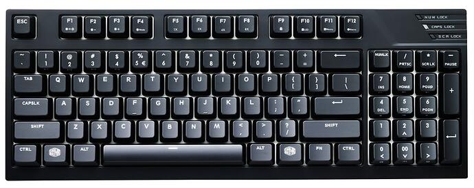

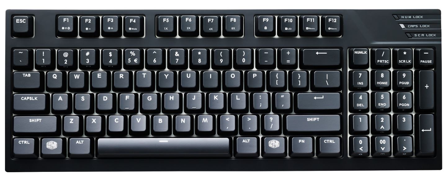

But it’s still not a fullsize (ie, actually 104 keys). It’s missing the ScrlLk key, and you’ve lost one of the Ctrl keys… And just the changes to the layout (movign Fn to the right side, making bottom row totally non-standard, a half-height set of cursor keys…argh the list goes on and on…
I mean, if you are going to have the Numpad, why on earth insert an extra column of keys, and shuffle things around on the bottom row? Just leave the main part of the keyboard as normal, and slide the numpad over a bit… Use the Numpad as both a 10-key and navigation cluster…
That’s actually the key that pushed me over the edge to posting this here… I’ve used a 10-key for years and years, changing that part of the layout would likely be far more damaging than anything… I an just see all the times I wanted to perform the subtraction operation only to delete part or all of the number I was entering…

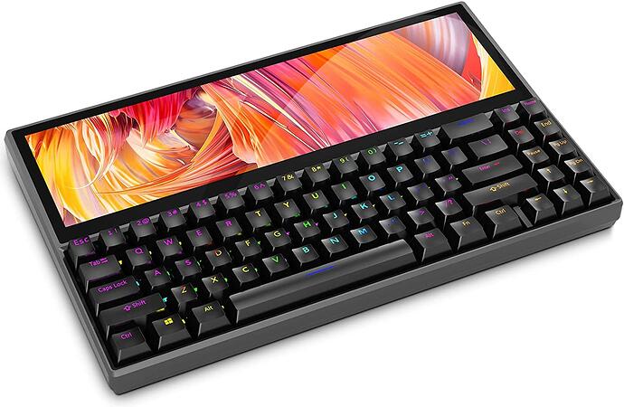

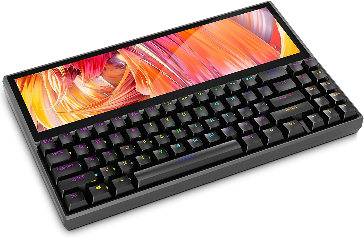

I know I really like this 71-key layout, but I will never pay $450 for this abomination:
Why? Just WHY?
Hmm if it works for you, I guess it gets old after couple of times.
I just can’t imagine having grease all over everything the stem might touch.
Someone saw the MacBook Touch Bar and thought, “I’m gonna do that, but like, way more”
