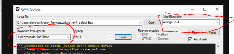

I’m trying to flash QMK on my DZ60, but it isn’t letting me. It’ll say DFU Device connected in QMK toolbox, but when I try to flash it, it will say no device present. I tried reinstalling the driver, and it didn’t work. It’s pretty frustrating, the keyboard isn’t really usable unless I can flash the correct layout. Any ideas on how to get it to work?

I got the hex file from qmkeyboard cn. I plug in the keyboard, start QMK toolbox, activate bootloader mode, then it says DFU device connected, but when I click flash, I run into the issue.
In QMK Toolbox, is the corresponding micro controller and keyboard selected as well?
I have the micro controller selected, but it won’t allow me to select a keyboard from qmk.fm, since I’m loading a custom firmware file.
If you’re loading custom firmware, you need to select that with the Open button which will let you navigate to the file you have.
Yeah, that’s what I did.

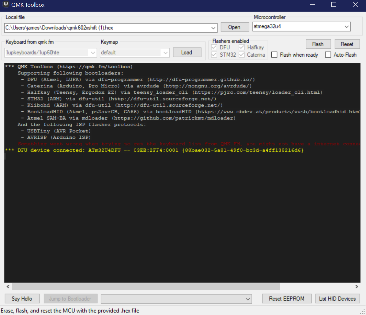

Can we get a picture of the ‘terminal’ when it reads “DFU Device Connected”?
