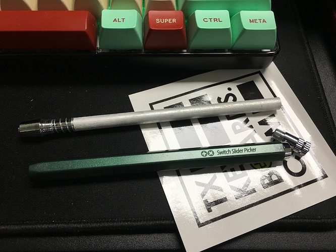

TBH fair, this is a tiny bit more than a normal jewel/IC holder, as it has very wide fingers. That should grab the cruciform top of the stem more securely than the 3 small wires seen in most jewel/IC holders. The TX branding is a nice touch to me also too!
I have one, and it does work perfectly for the application.
I hesitated at first as it is literally just a clutch pencil lead holder, but decided my current one would be too small for this new non-drawing application and finding one in the right size would probably be about the same price.
And the TX branding is a nice touch

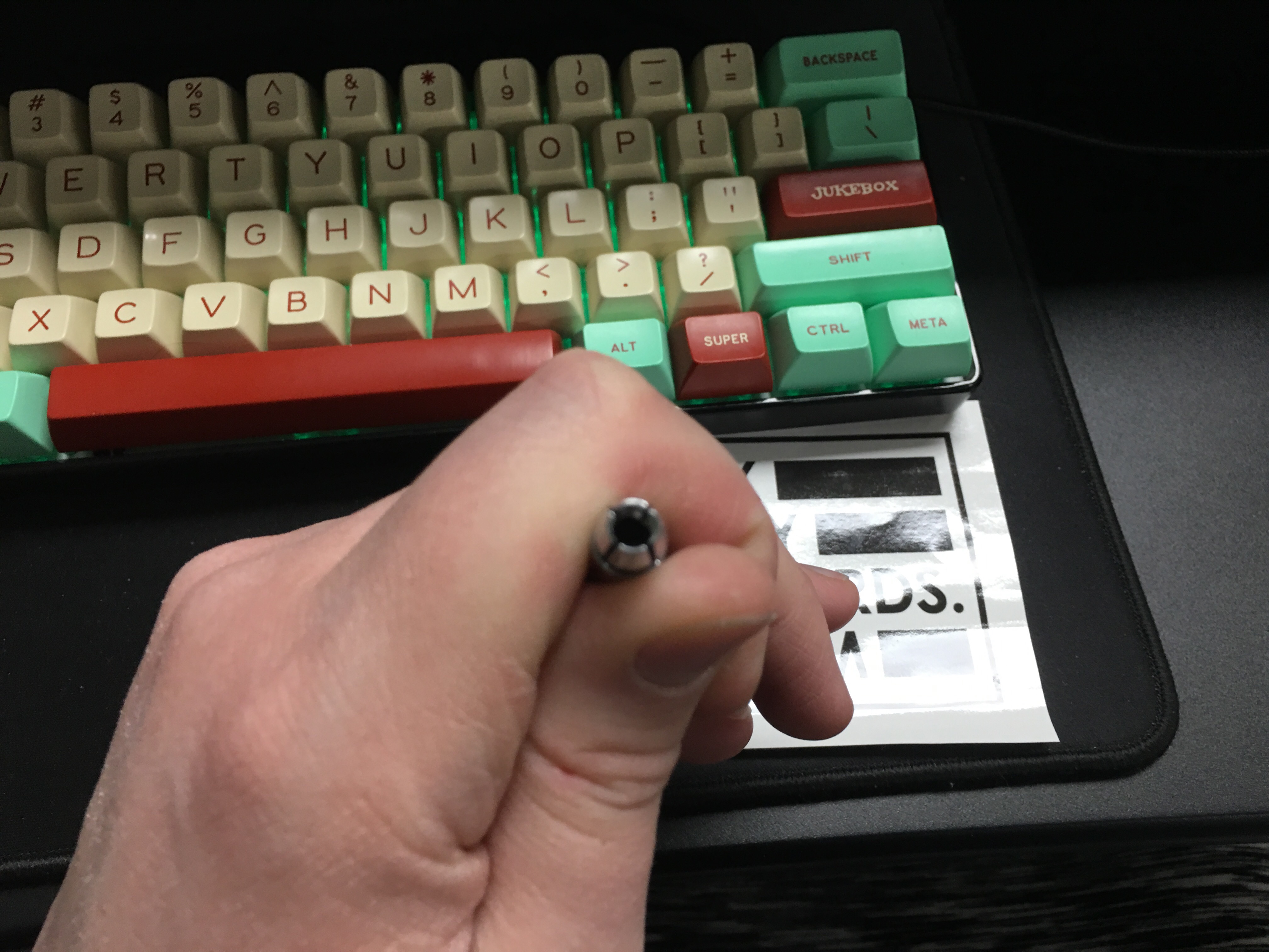

My question is: should it work with BOX stems ?
I tried picking up a Kailh Box Navy, and while it totally worked its a little more fiddly than an unboxed cruciform. You are grabbing just a little less of it because of the box.
Thank you!
So it works somehow…
yup 4 little grabber arms extend from within the shaft, and their chiseled tips are just small enough to squeeze a bit into the box.

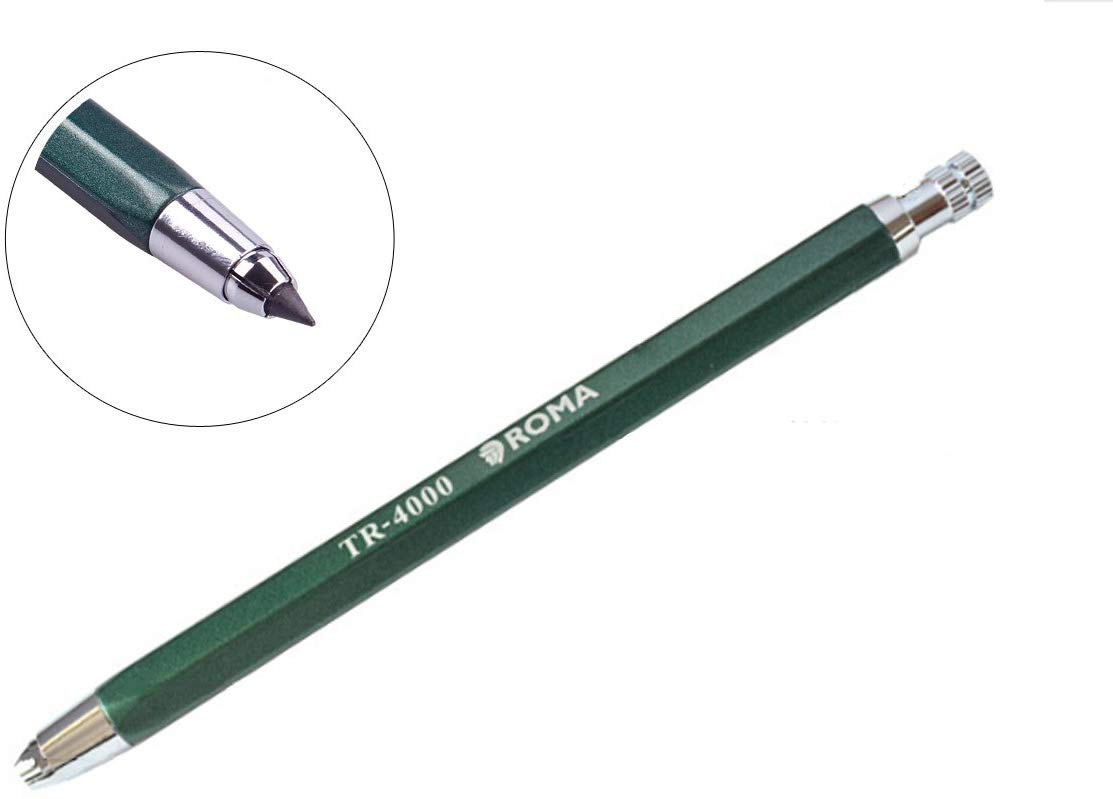

Kind of looks like a lead holder…
Example showing jaws for a 5.6mm piece of lead. :
Could this be it?..
I think it may be exactly that. Frankly, I don’t think it’s better than gem-holders for most lubing tasks.
For me, it’s better because I frequently relube and, to remove old lube, I just wipe them with a tissue. And, with a gem-holder, I can only firmly wipe in one direction. With the ‘jaws’, I’ll be able to wipe in both directions.

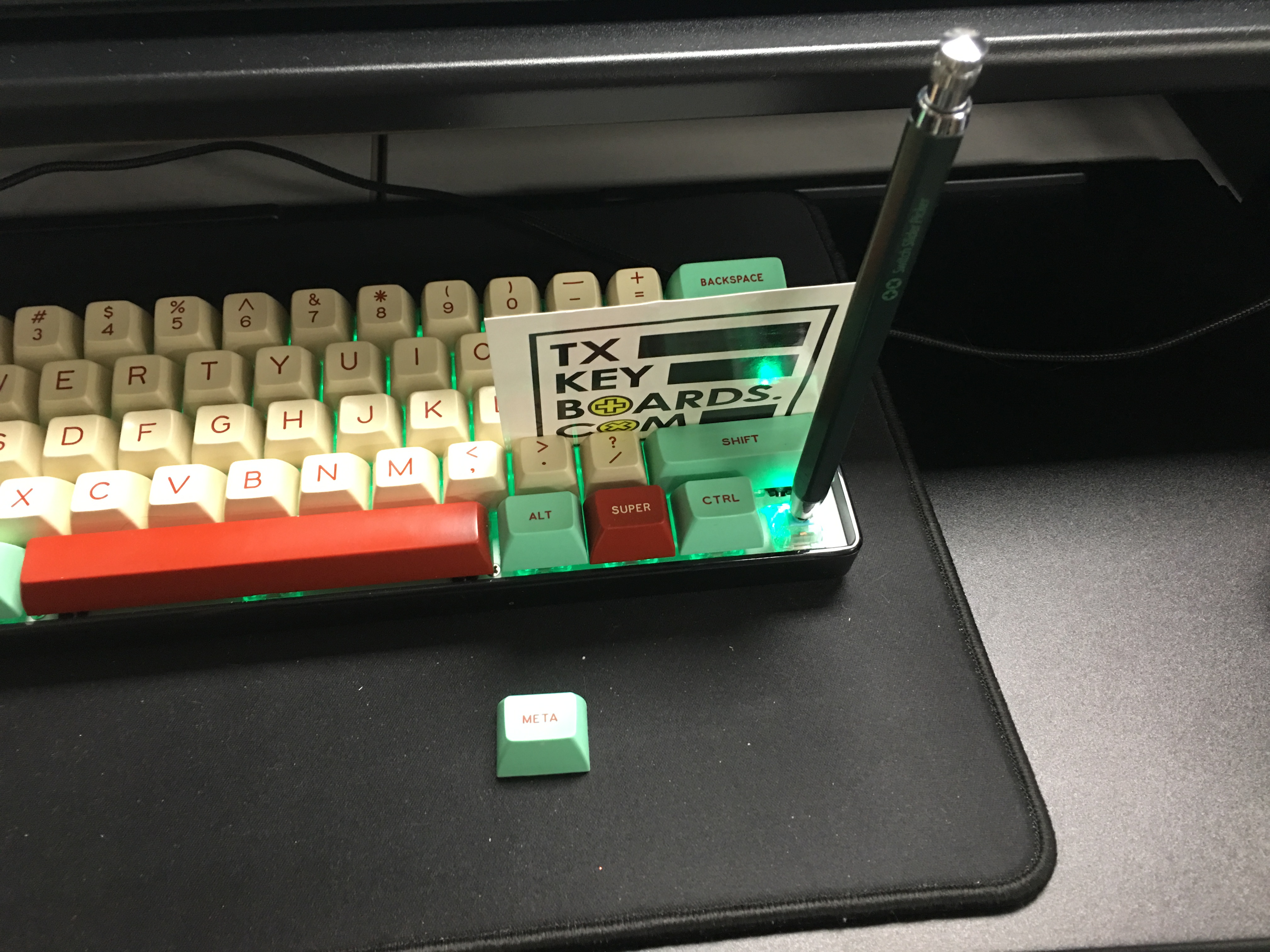

Do not forsake grabby friend
Can confirm. Used it for the first time on a real lubing project and you can firmly wipe in any direction.
