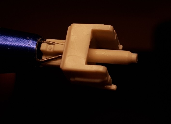

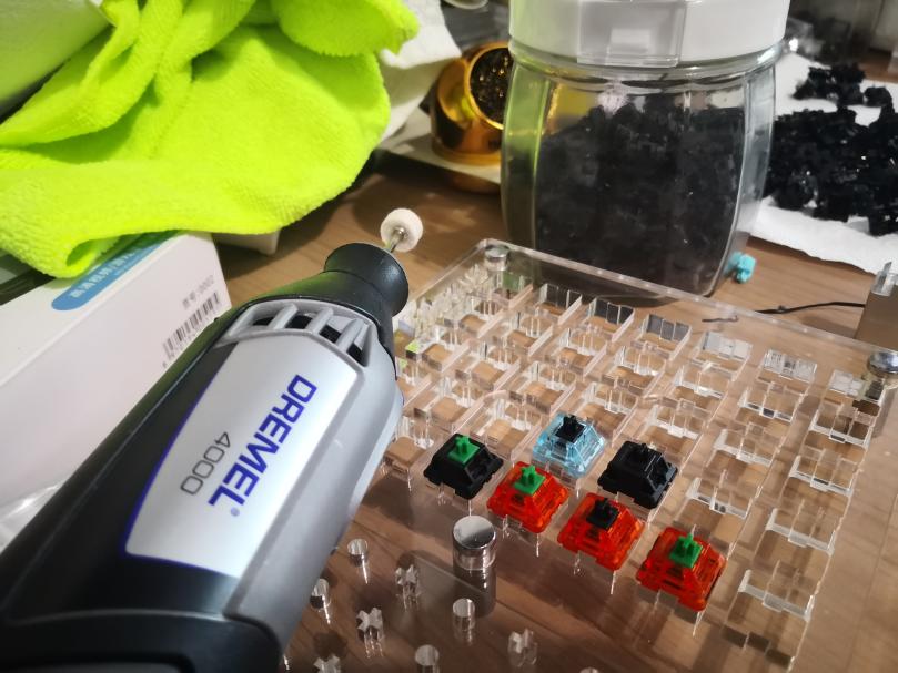

I used the Dremel 4000 in the lowest speed possible, and the wool felt cotton that comes with it, I dissolved the toothpaste in water and used it to polish all sides of the switch. I took me a lot of time to polish all the stems.
I can see how that would take a lot of time , but I think it would be a lot faster than what I am doing right now. I will try to get my hands on a dremel and try your polishing method.
I remember that different toothpaste has different abrasion amounts, so can I know what toothpaste you used as well?
It is a good question I thought in use different toothpastes but I used a toothpaste that I already had and did not intend to use it, Colgate Total 12 I think it is low abrasion. In the start I was kinda scary to fucked up all the switches, but with low speed I was able to use the dremel enough time to check if everything was ok. Finally to remove the toothpaste I used a ultrasonic cleaner.
When I tried polishing with Dremel, I didn’t use any lubricant so the cotton pad just ate through the stem. So it’s good to know toothpaste helps. There were two other problems I had:
Speed - lowest speed on my Dremel was still too high to polish safely. DIY low RPM polisher is something to look into.
Positioning - using a hand to hold the stem being polished against polishing pad was difficult, particularly when polishing stem legs. It will also result in uneven quality. However, it’s not clear if differences in polish quality can be felt. Maybe I’m worrying too much.
Yes, it is hard, I used a diamond holder.
