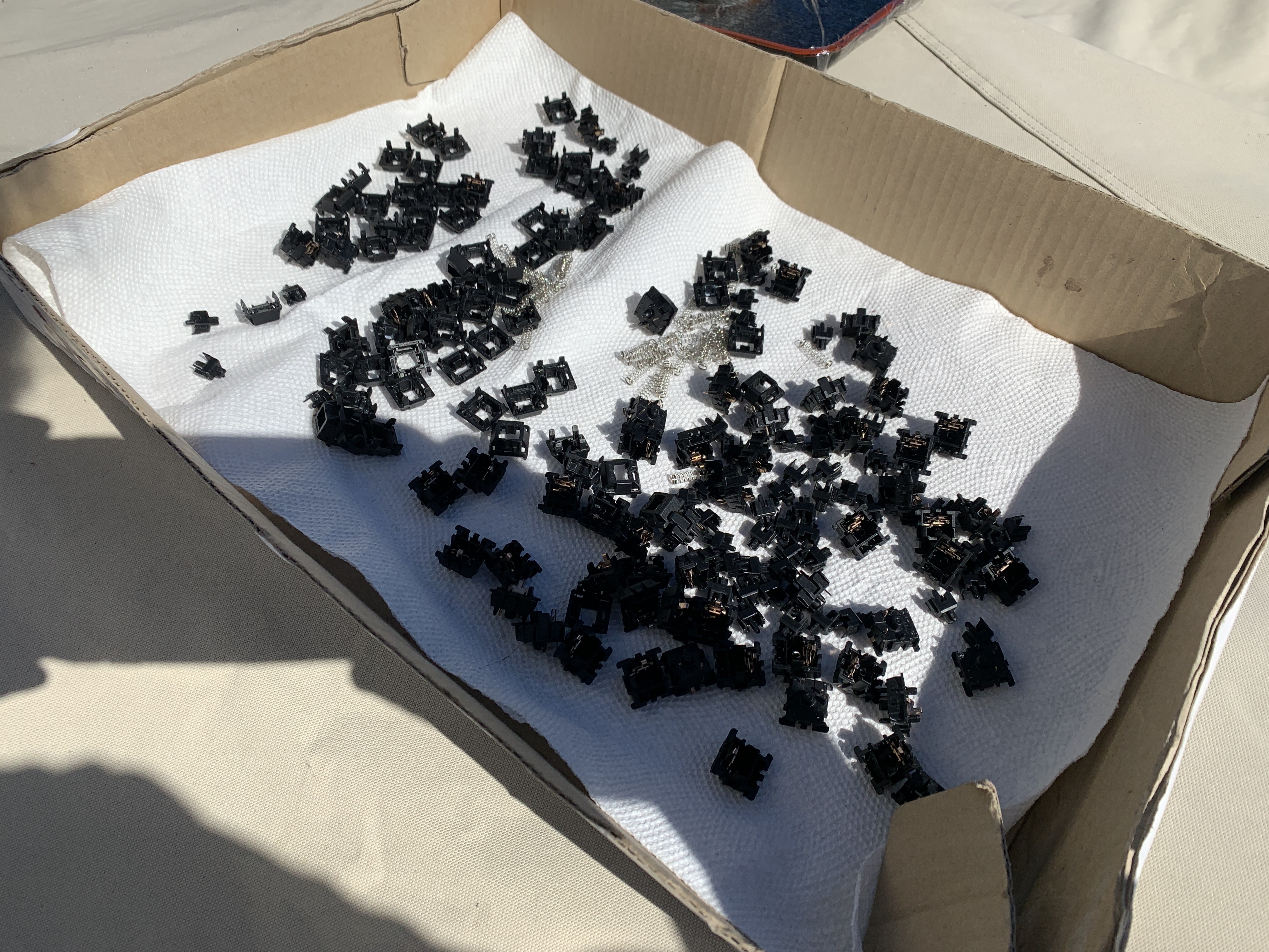

Sun-dried Double-polished Cherry blacks!
Finished a 60% set of double-polished Cherry blacks. The result is at the low-end of skating smooth and consistency is high. Satisfied with how they turned out. I’m going to use them unlubed for a while to enjoy the naked smoothness.
