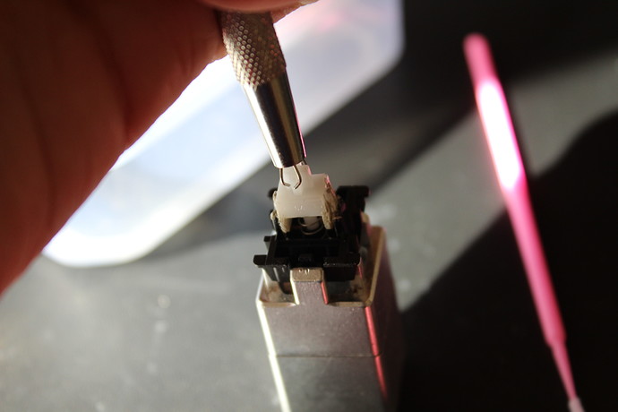

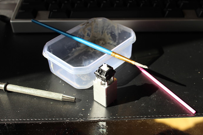

Here is my setup: Paint brush, pink microapplicator, jewelry tool (stem holder),
The microapplicator is used to remove factory lubrication from the switch leaf.
The paint brush is used to spread diamond paste over the stem.
The jewelry holder is used to hold the stem in place when applying paste and also to “break in” switches after pasting.

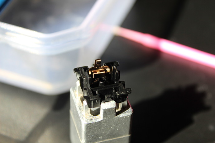

Above: factory lube on the contacts (Use microapplicator to remove)
Important: Apply a small amount of paste to the leaf “bump” before continuing on stem.
This ensures even coverage of the highest friction points.

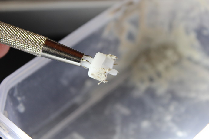

After you have removed the factory lubricant, you can use the diamond paste on the stem as shown. Mix with a couple drops of water to ensure easier application, but do not soak the paste in water.
Try to use as little water as possible.
The paste is on the stem rails as well as the legs.
Use stem holder to push stem back and forth to spread the paste around. You should feel the friction as the stem torques against the housing.
I do not polish the switch top housings because they have minimal effect on the smoothness of a switch.
This approach is consistent and works every time. It takes at least 2 minutes per switch, but is definitely worth it.

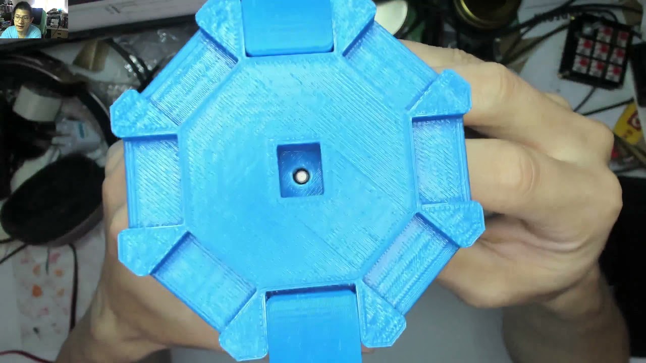

I think it would be best to rotate the switches and cover the gears in some rubber/foam to reduce wear and increase friction transferred into the stems. Really cool idea though.
Neat design. I’m partial to simpler solutions though. A non-commercial design that could be fun to build uses a hoola-hoop. To build:
