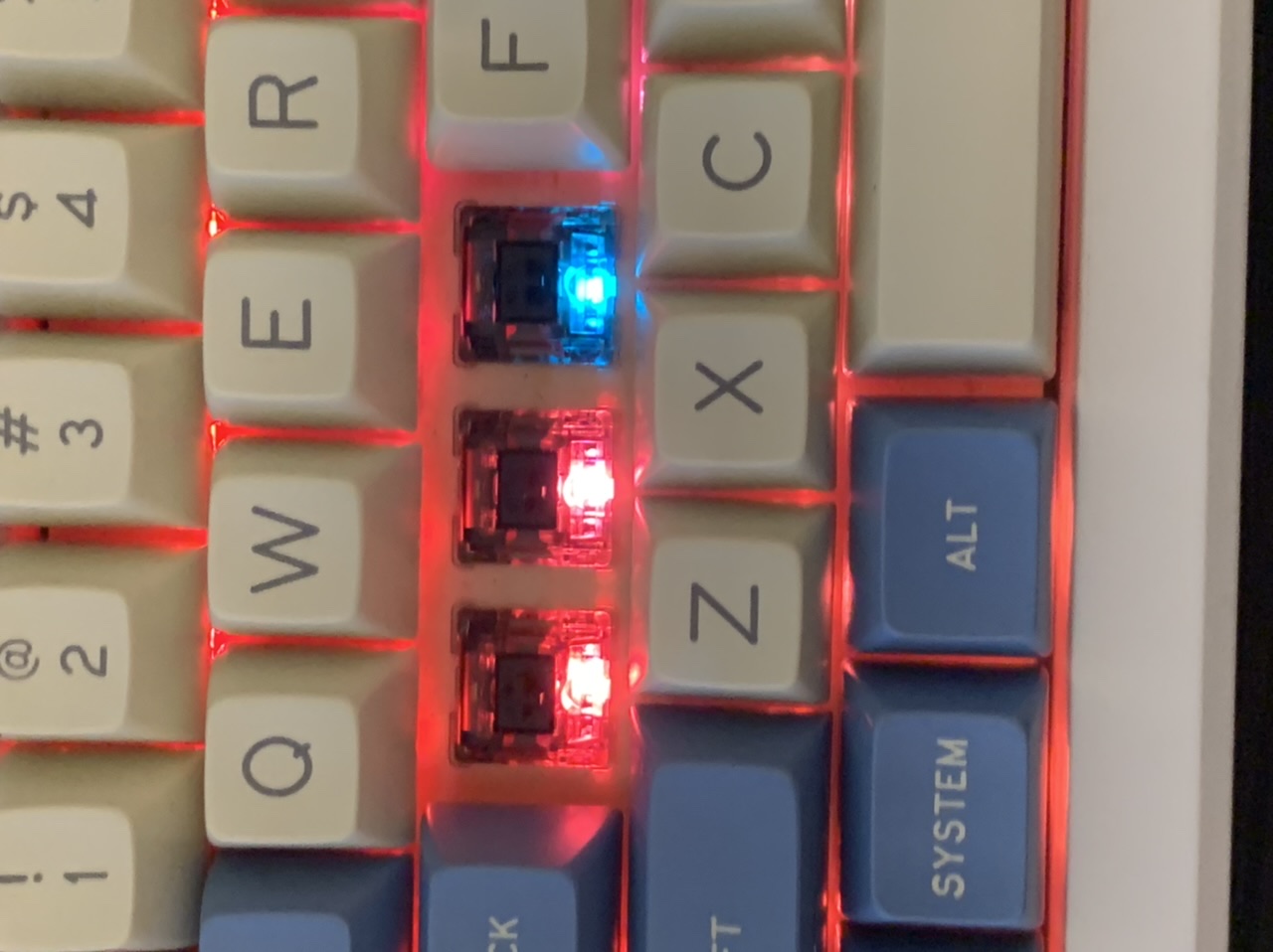

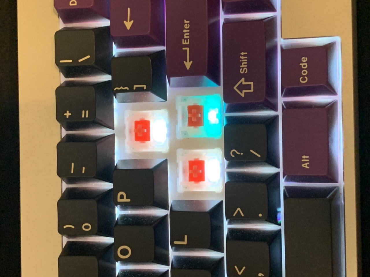

So, both my M60 a and my HS60 have an led that just stays blue. Both in different spots. Anyone else have this issue? I updated to the latest version of via but no help.

It’s the in switch LEDs. So strange that they both have an issue at the same time.
I guess the red led is out in both of them. Weird
Guess I need to source some LEDs for replacement.
M-60A:
HS60:
That is odd that it would happen on two of your boards at once. Have you tried flashing one of them back to just QMK programmed? I think most likely you are right & the red portion is burnt out on them, but I’d give that a shot just to make sure before taking them apart & replacing the LEDs.

I added some flux to the pins of that led and reflowed it. Works again! Now for my HS60 to see if that one will take the same fix.
Awesome idea & news! Definitely worth a shot on the HS60 since it worked on the M-60A! Occam’s razor in effect right there, I didn’t even think to recommend trying to re-flow them.
same thing worked on the HS60. Reflow fixed the issue!
ah snap! I was typing on my HS60 and another red channel one went out, this time on the 9 key. Welp, at least we know the fix.
Oof, I was going to suggest adding more solder. It sounds like the assembly house went light on the solder and maybe the stress from typing on the board is breaking the solder joint.
Yeah that’s what I was thinking. Those LEDs are so small & have even smaller solder points that just the flex for typing is most likely enough to start knocking solder joints out. That is one of the reasons I have yet to get a HS PCB, many more failure points than a regular one.
