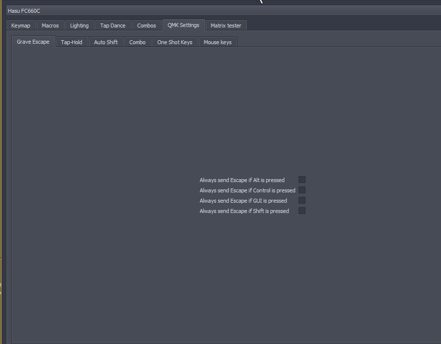

QMK Setting Screens
Grave Escape

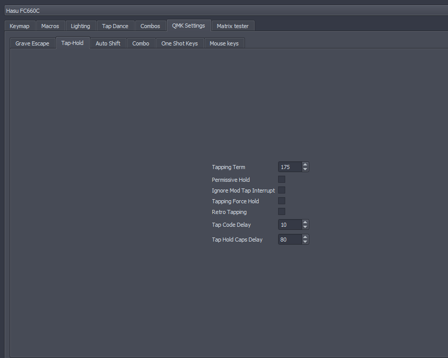

Tap-Hold

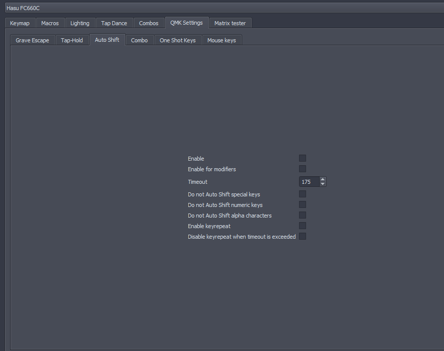

Auto Shift

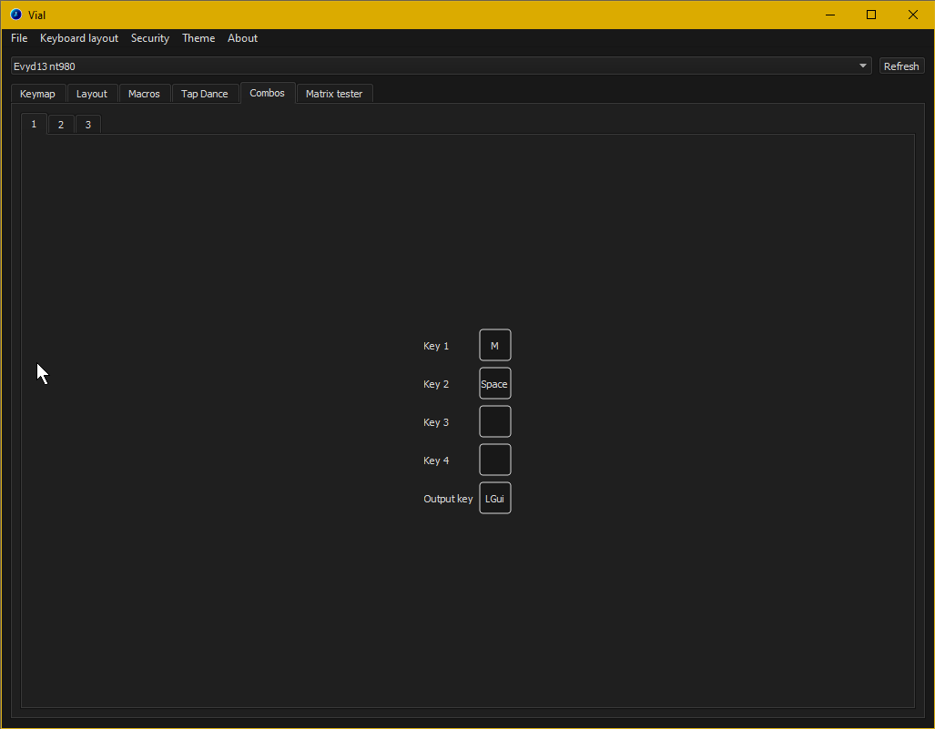

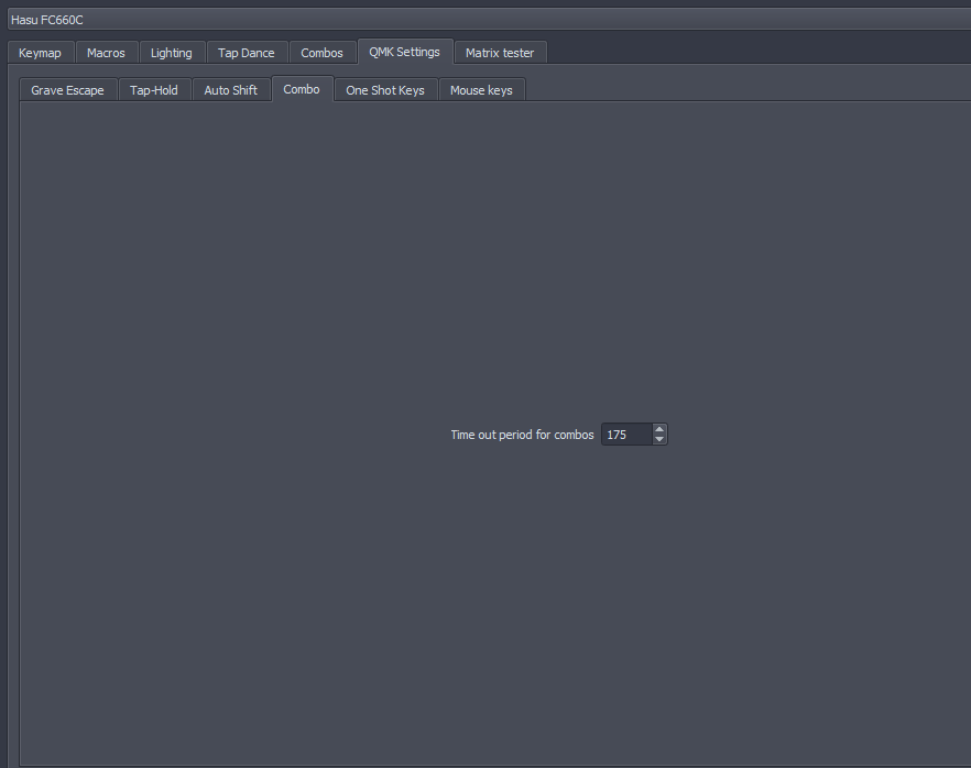

Combo

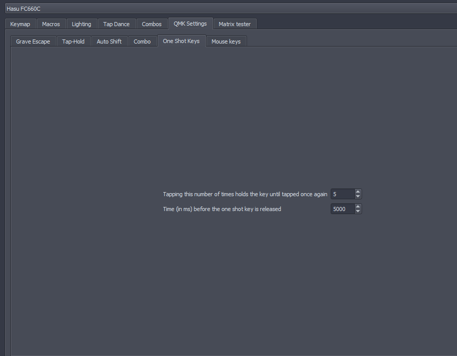

One Shot Keys

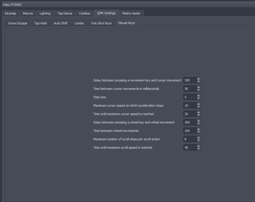

Mouse Keys
