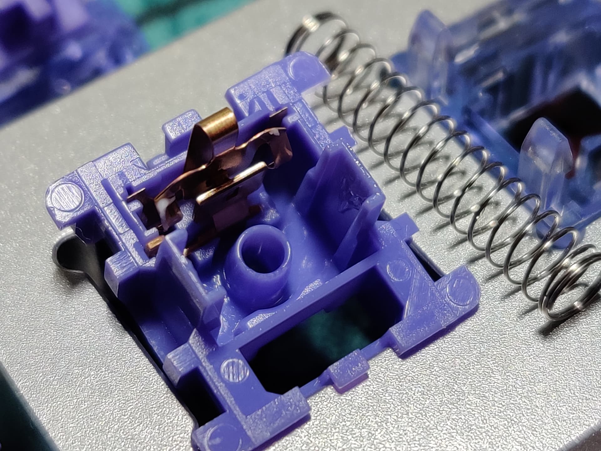

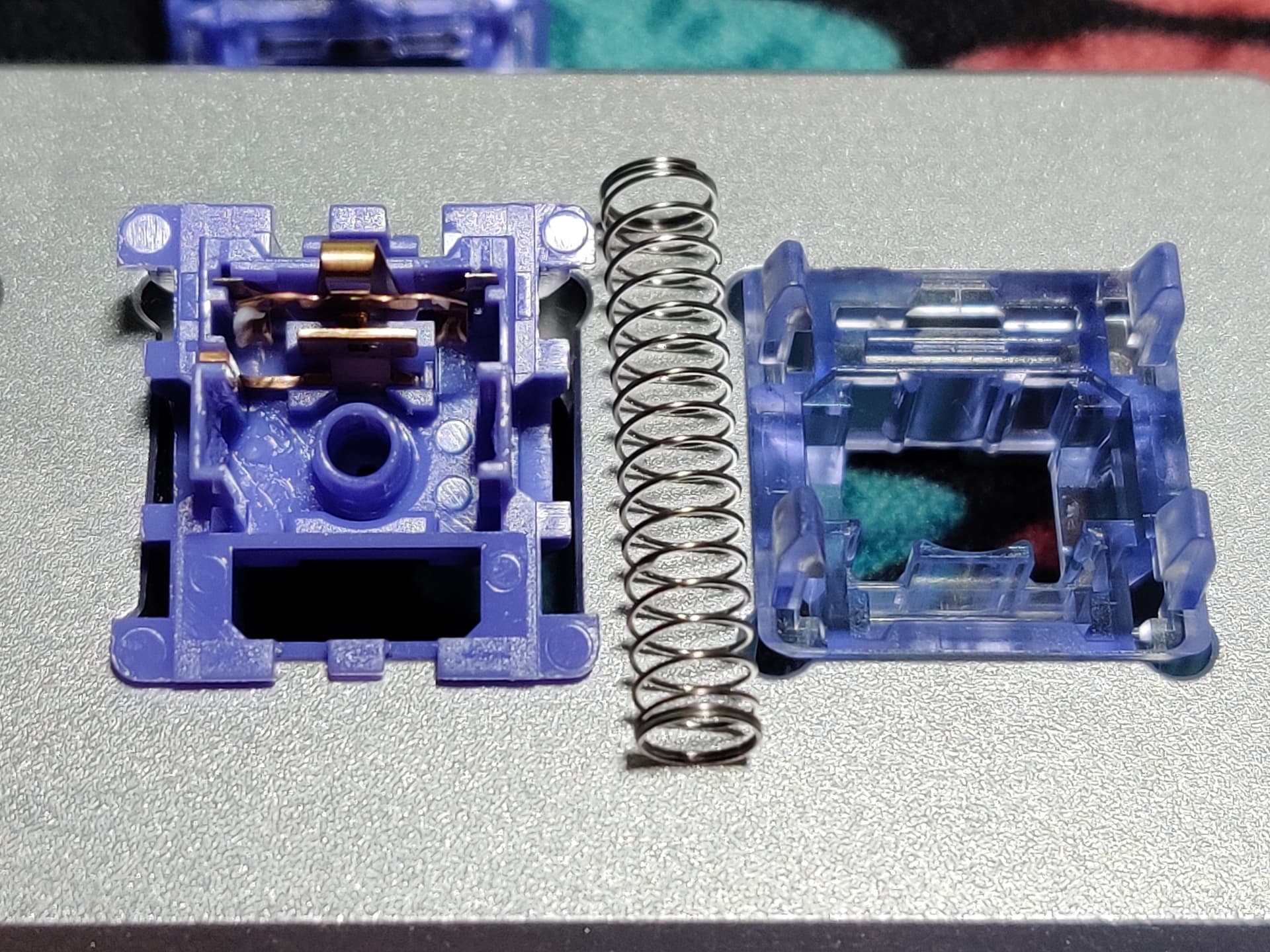

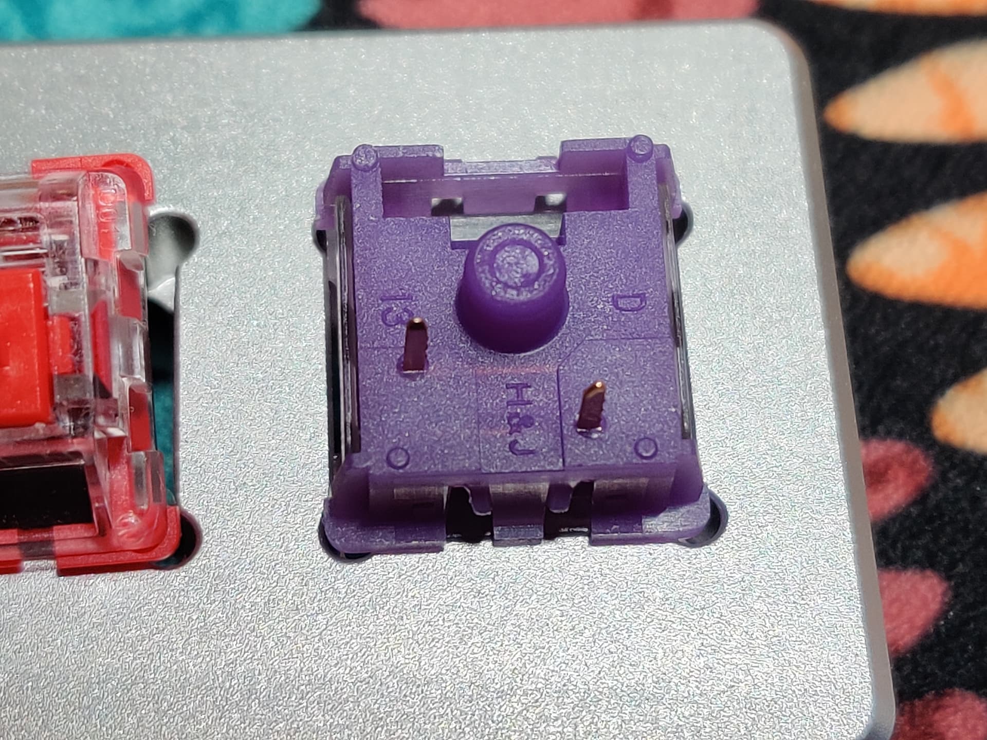

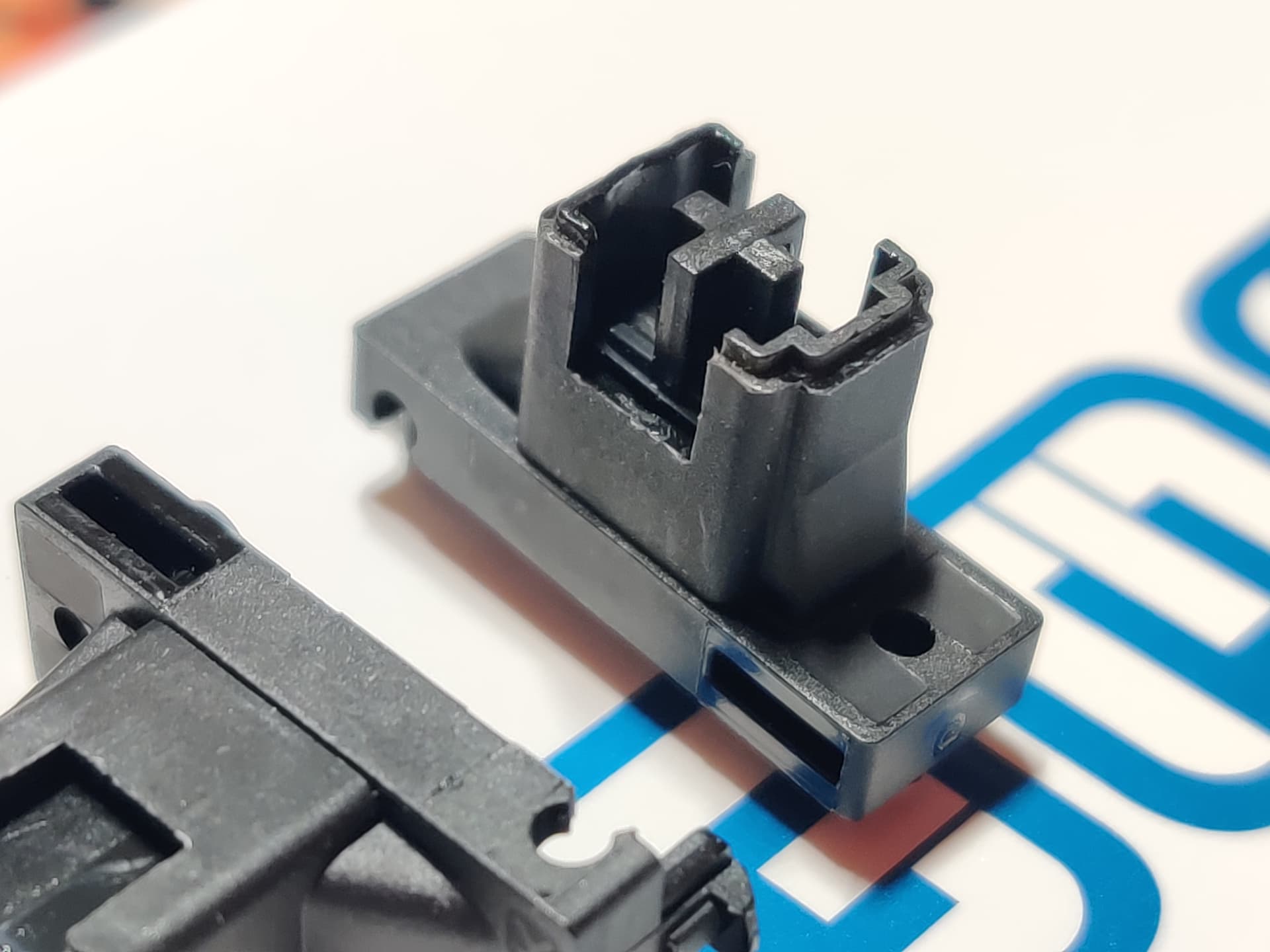

So I ordered the CK x Haimu Pastel Mint tactile and I’m getting what could be considered a squeak as well.
I recorded a clip of this and added it to my post. Are you hearing the same thing I’m hearing (second half of the SoundCloud linked there)? Any idea if this is solvable? I’m noticing it on more and more of the Pastel Mint switches; it seems to be inconsistent until it’s very consistently squeaky/chirpy.

Did you try lubing anything yet to see what might be the cause?

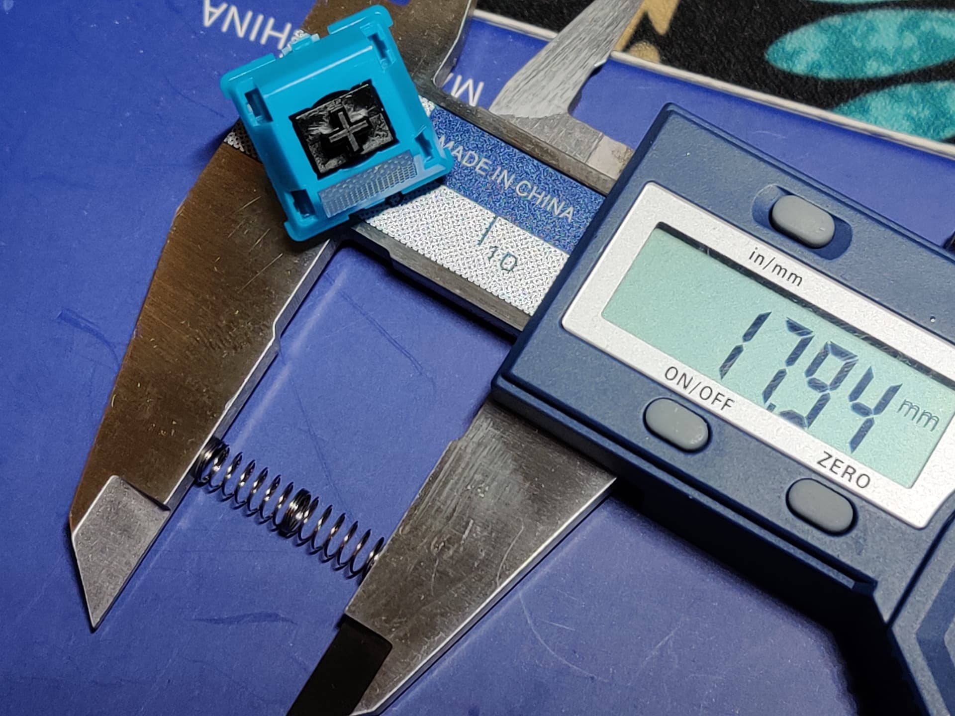

Not yet but mostly just due to lack of free time over the past week. The chirp/squeak I was hearing sounded so different than what I’ve heard in any of my other switches (about 20 sets and another 20 individual test switches) that I was curious if others had seen this issue.

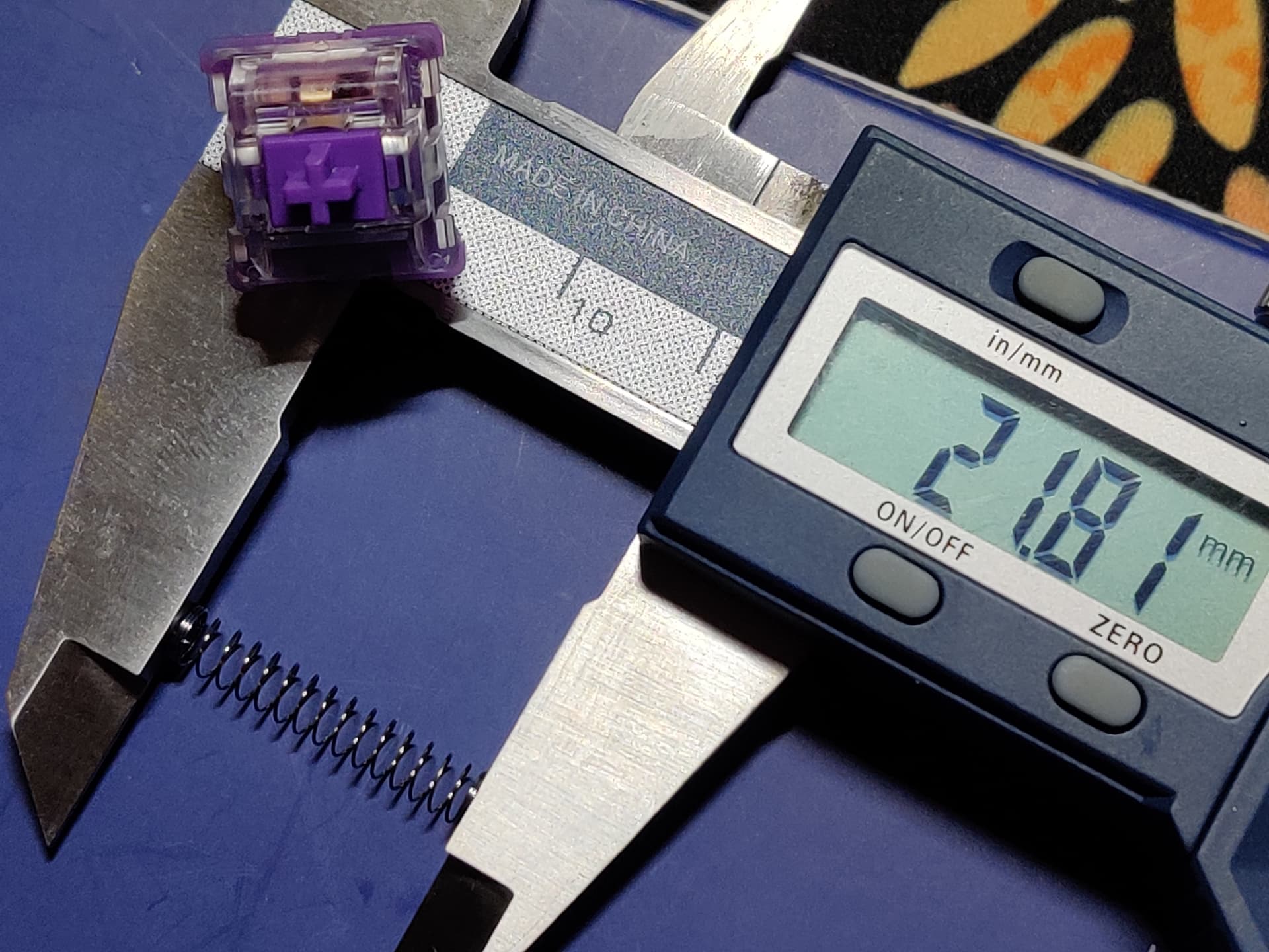

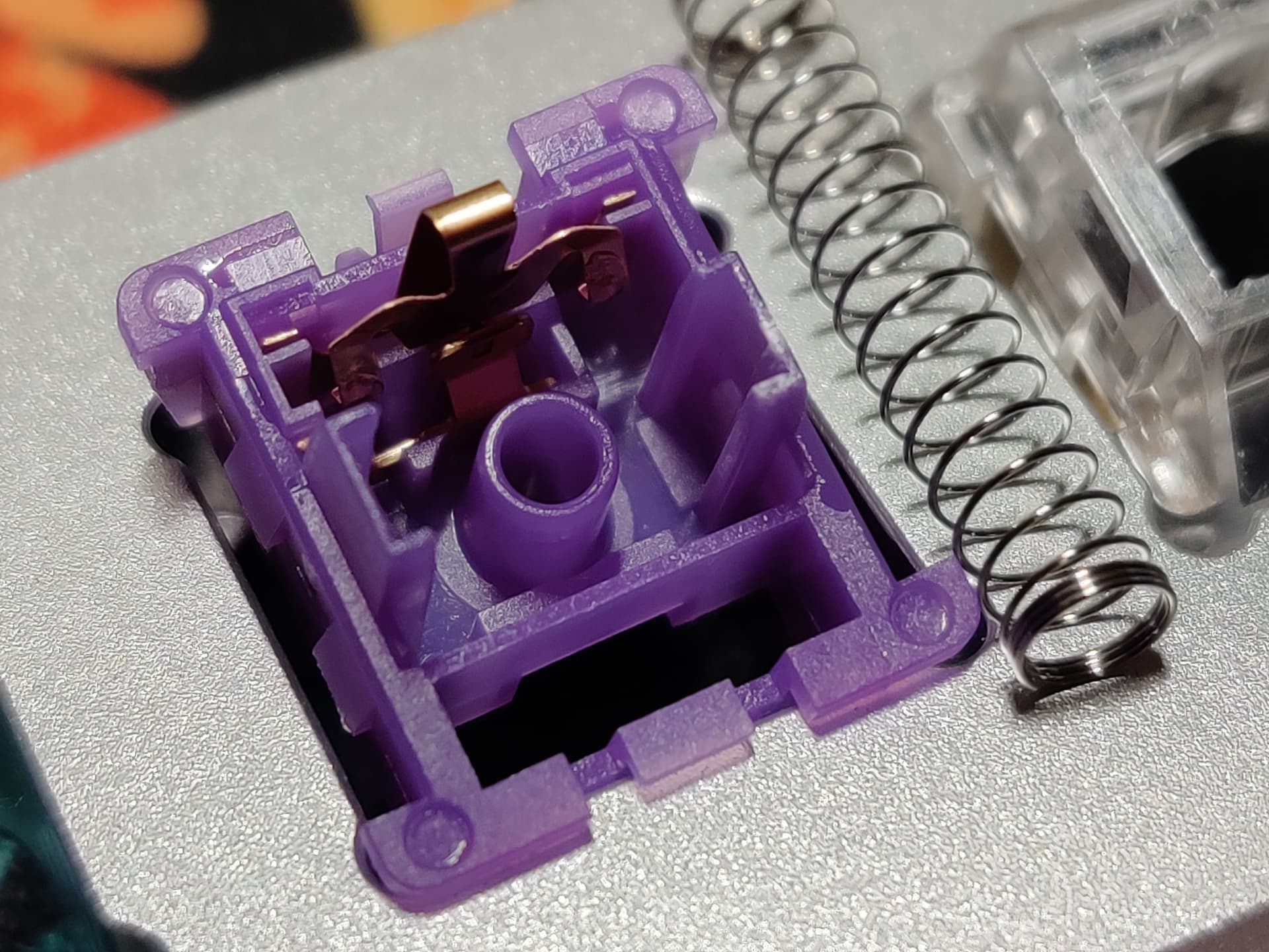

It seems to be triggered by a couple hard bottom-outs in a row, particularly if off-center, but then seems to continue even under lighter presses. It will then go back to normal only to reappear again after a few more presses. I suspect the spring (22mm double-stage) is binding in some way, so I’m going to start there on lubing/testing.
I’m not hearing the squeak I heard in the audio recording you linkedl. As to removing it, no amount of switch modding helped. But, like with North Pole switches, I think choice of case matters a lot so planted them on a case with least amount of squeak and did not look into why further.

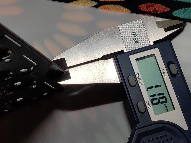

Now that I think about it, I think it’s more the plate than the case. I’ve recently learned while switch modding how tightness of plate can impact both sound and feel of the switch. An overly tight plate can squeeze the switch enough to interfere with switch return so I think what may be happening is plate tightness may be distorting the switch housing, resulting in squeaks.
Still unconfirmed but I recommend trying different plates or boards with different plates.
NOTE: By squeezing the switch housing, I don’t mean plate edges are directly pushing against walls of the switch. It’s the edges pushing against legs of the switch which in turn pushes against the switch housing. So my theory is that “open” plates, kind that allows switch housing to be opened without removing won’t squeak.
I have noticed plate material and tightness affecting how switches sound and have found that both very loose and very tight plates seem to negatively affect the sound. However…
You want to hear something crazy? I was holding those switches in hand for the sound test, and very lightly gripping them by the sides.
I put the mic from my phone near them while recording, but I can easily hear that squeak even when I hold the switches at arm’s length. It’s not like this barely audible thing that only happens right up in the mic or if I have the switch pressed against my ear. I’d estimate the volume at about 25-40% of the volume of the housing collision on a hard bottom-out.

If the switch squeaks even when held without much pressure then I don’t think it’s the plate. Haimu Pastel Peach squeaks a lot in all the boards I have except M110 replica. Bizarre.
Worst case of plate-squeezed switch I encountered was very recent. I liked how New Nixies sounded so tried replacing top housing of Cherry Red with Gat Pro X1’ss milky top. That brought the sound close to New Nixies so tried the frankenswitch from the remainder. It was pretty decent in hand so tested on a board only to find that switch stem was not returning. Test in hand again, this time squeezing the top housing legs. No return. Didn’t take much pressure either.

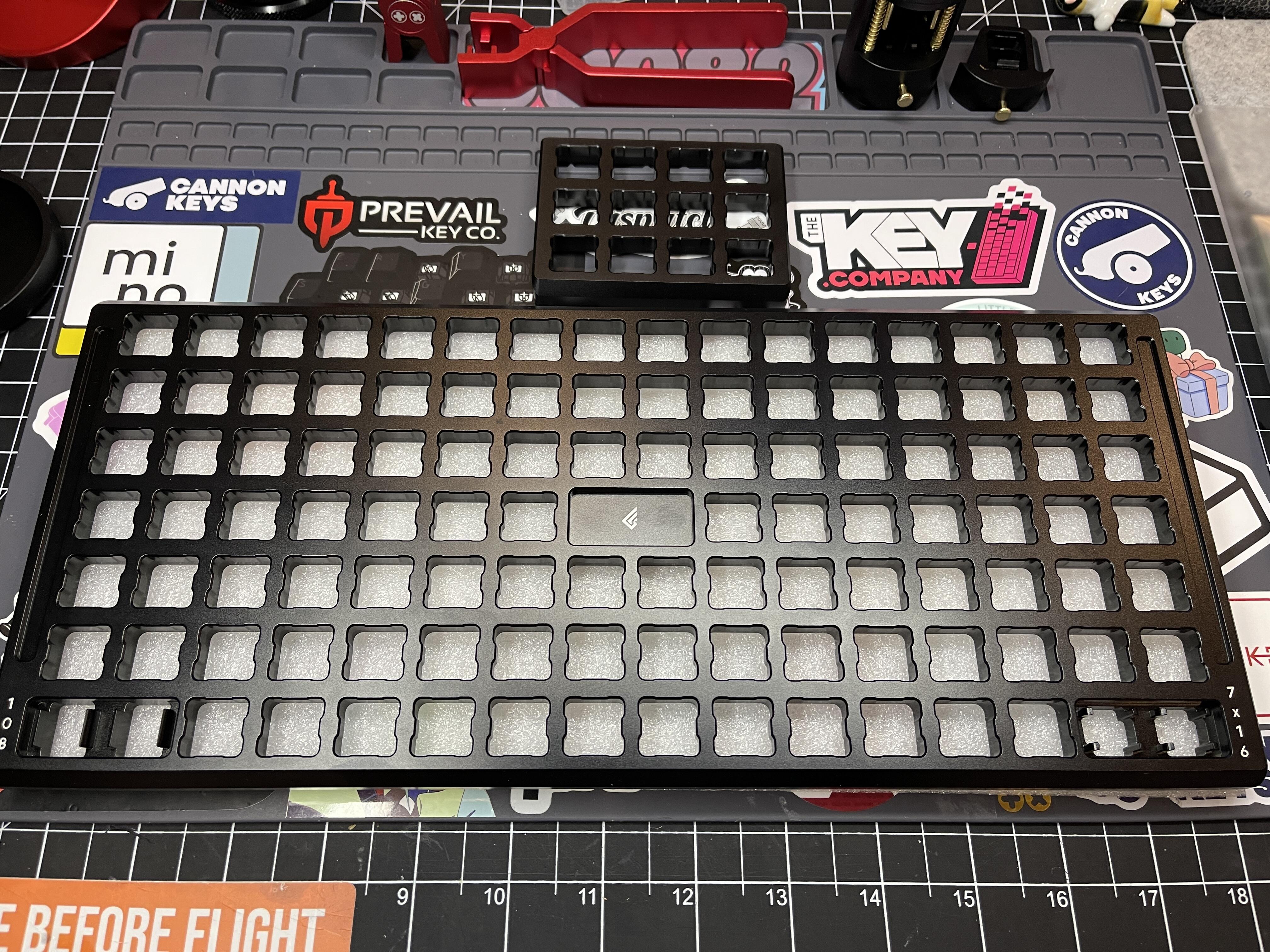

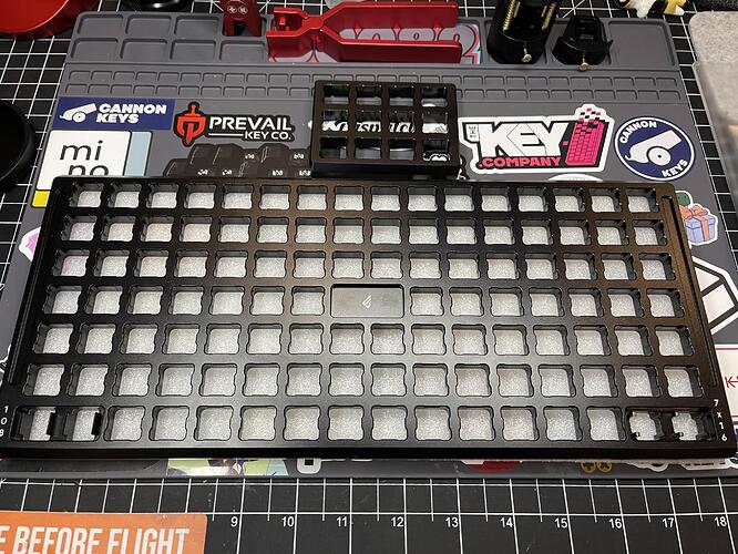

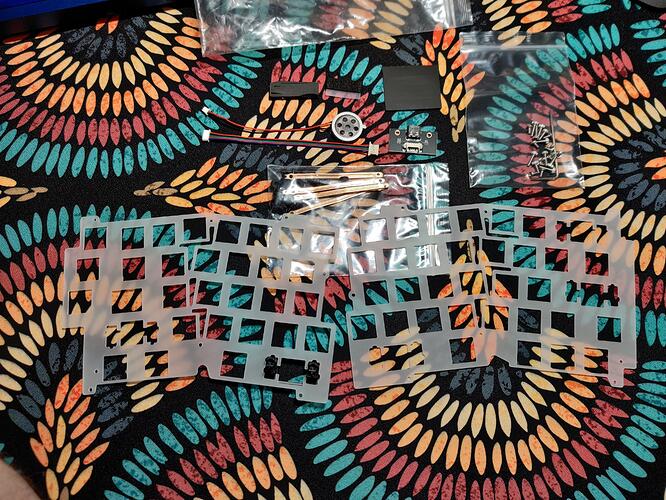

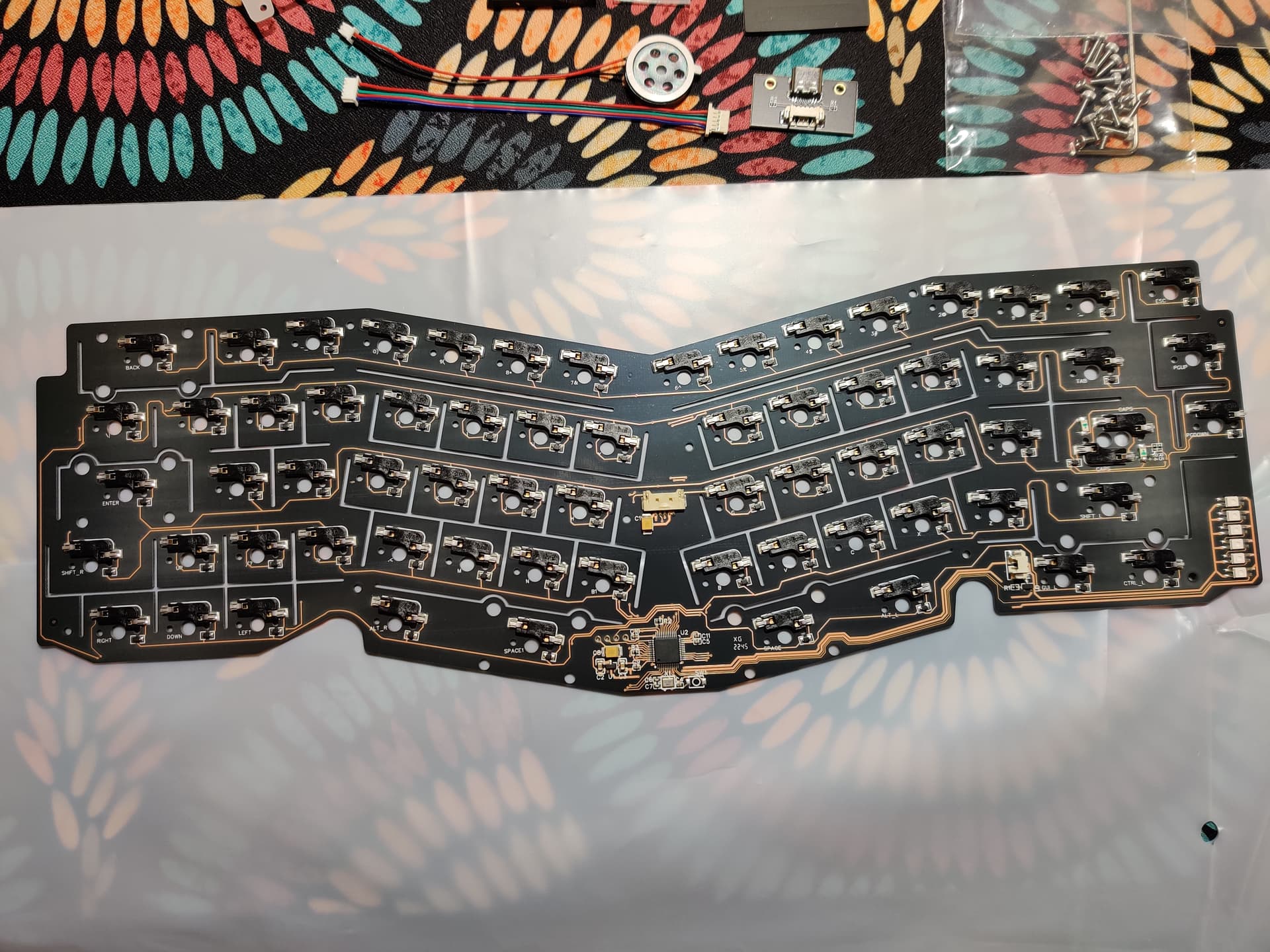

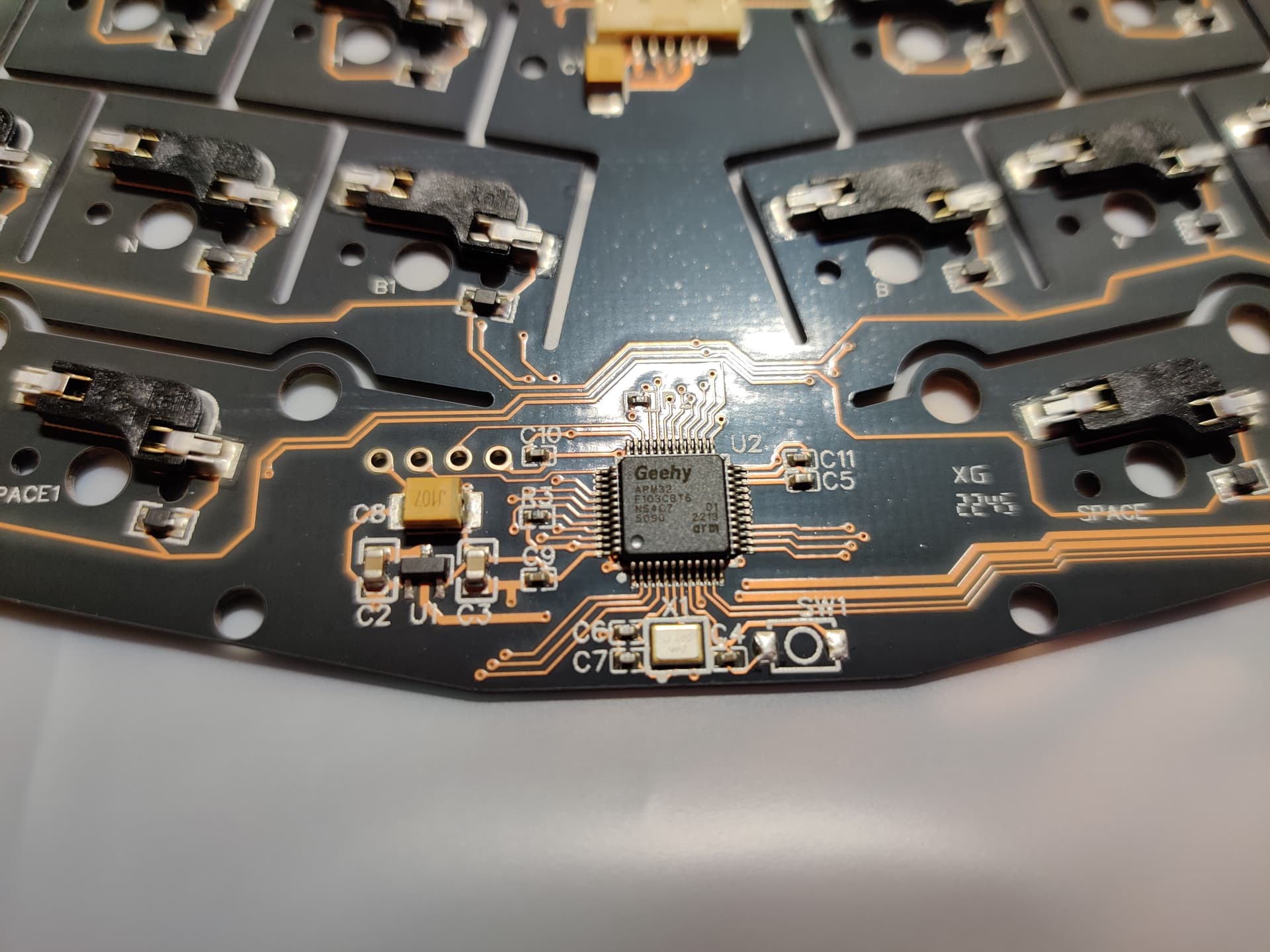

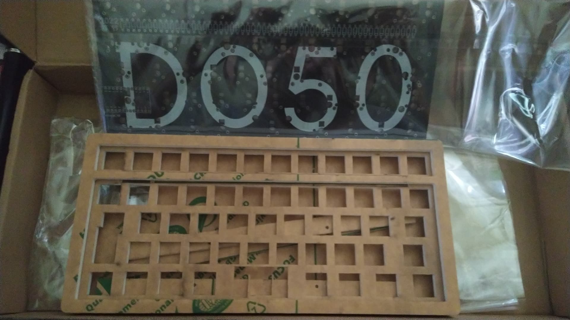

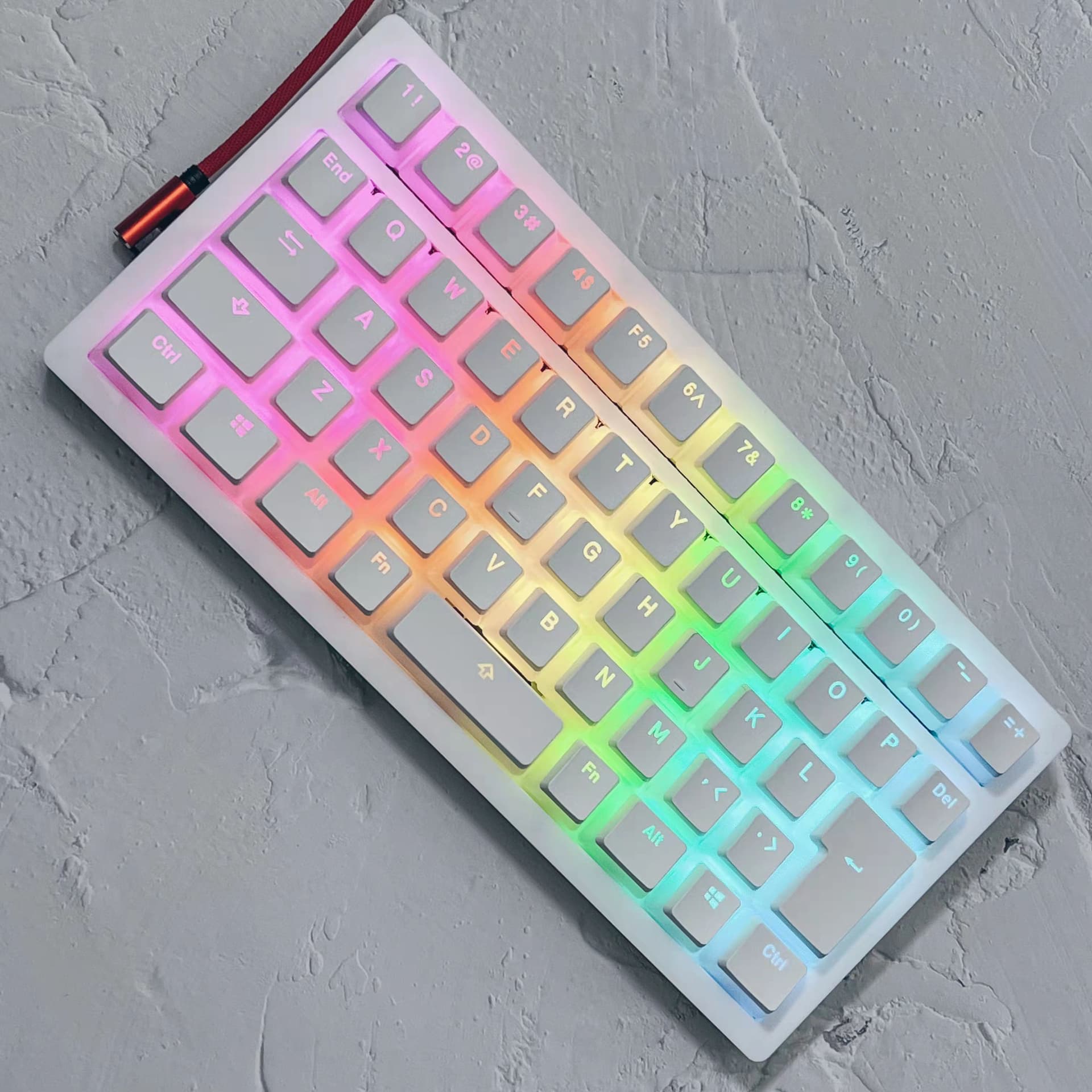

Received my DO50 kit today. it’s weird calling it a 40% because it pretty much has as many keys as my HHKB tofu, but i guess that’s why that store was calling it a 50% keyboard. I still need to buy a pro micro and some diodes, but it seems alright. Nothing got damaged in shipping. And i guess i will also include a photo of what it should look like for those who are curious. I will probably cut off the separator between the numrow and the alphas so you can see the diodes.
Who makes this kit? Wouldn’t mind having one.

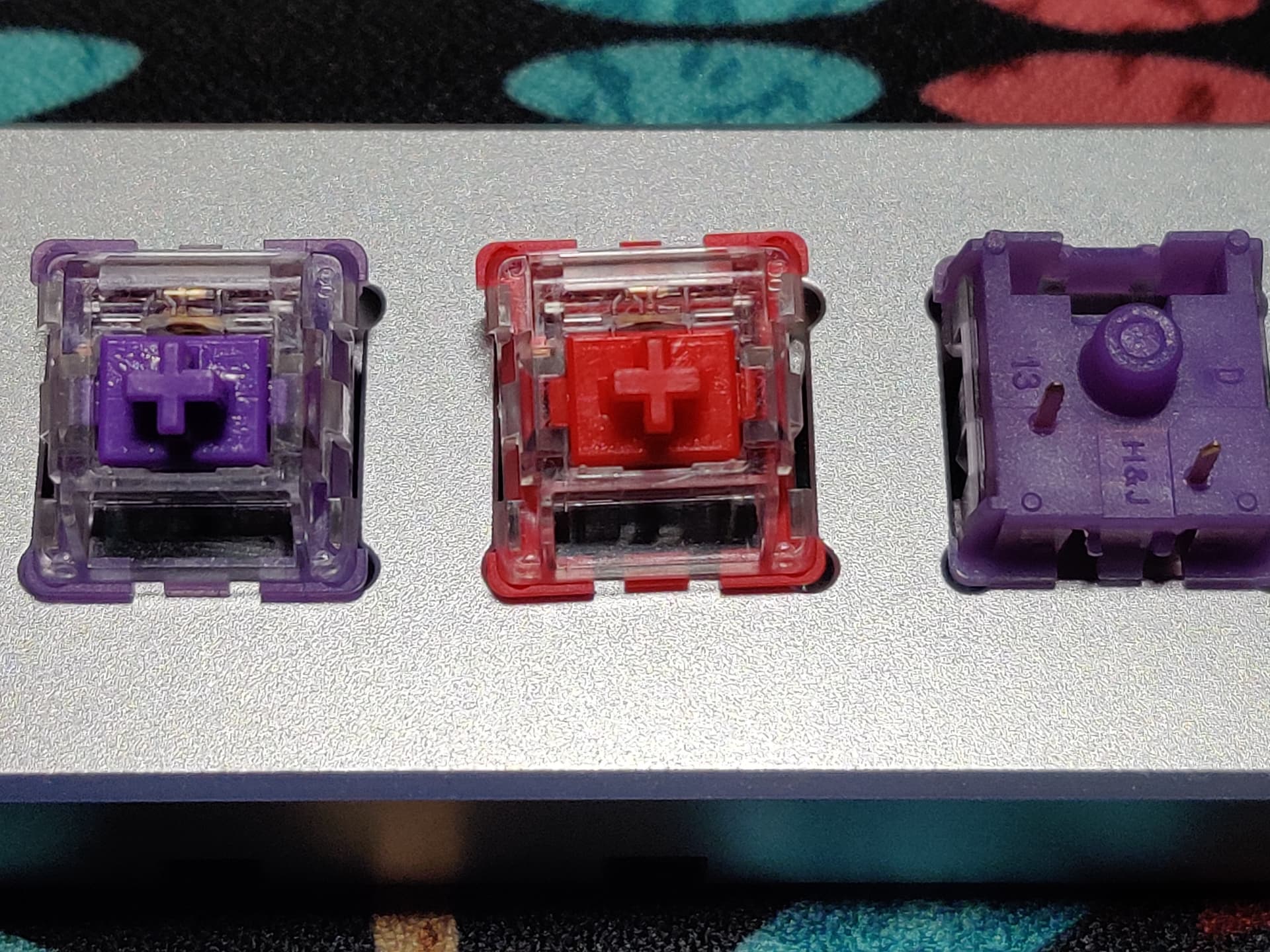

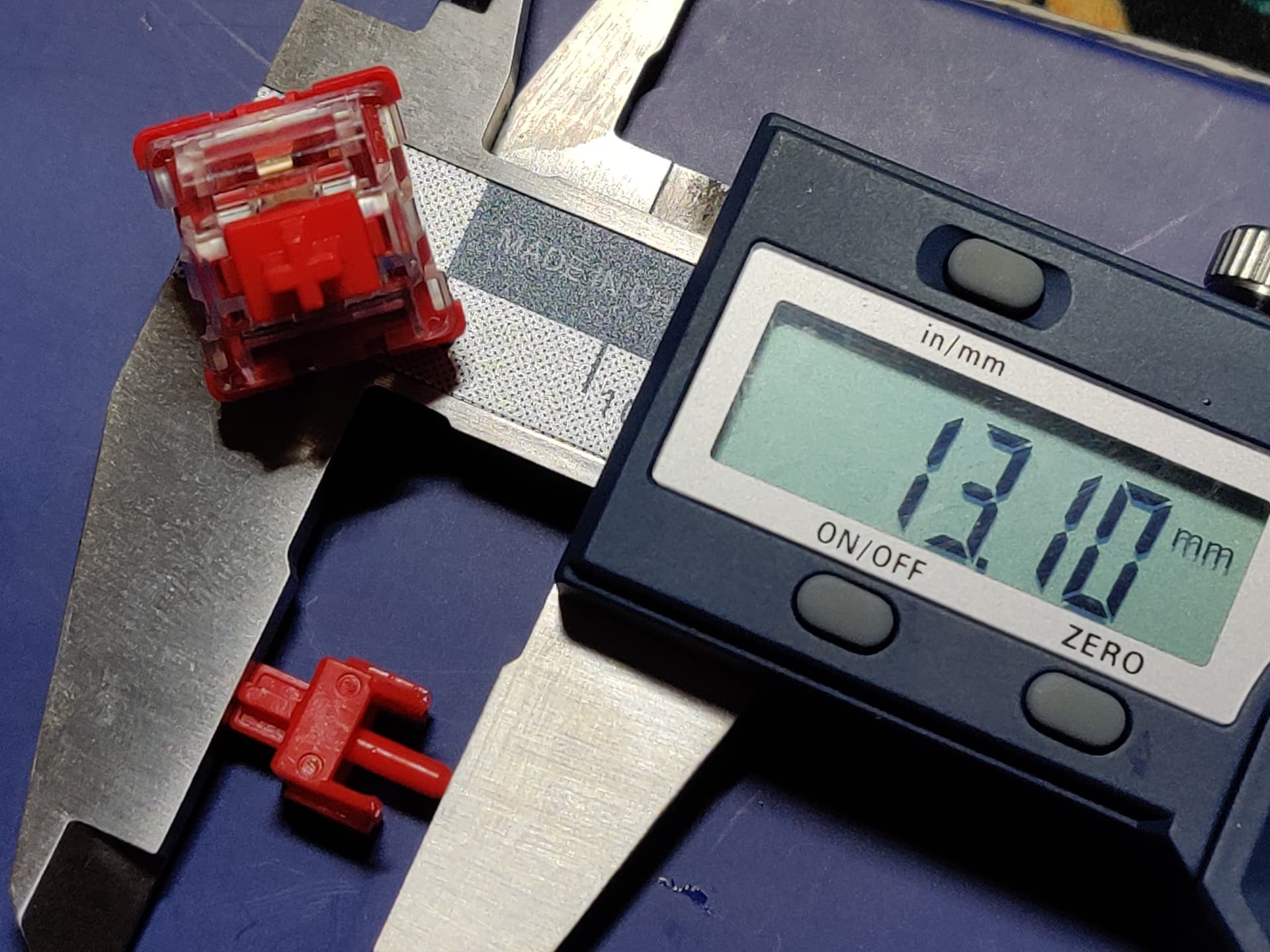

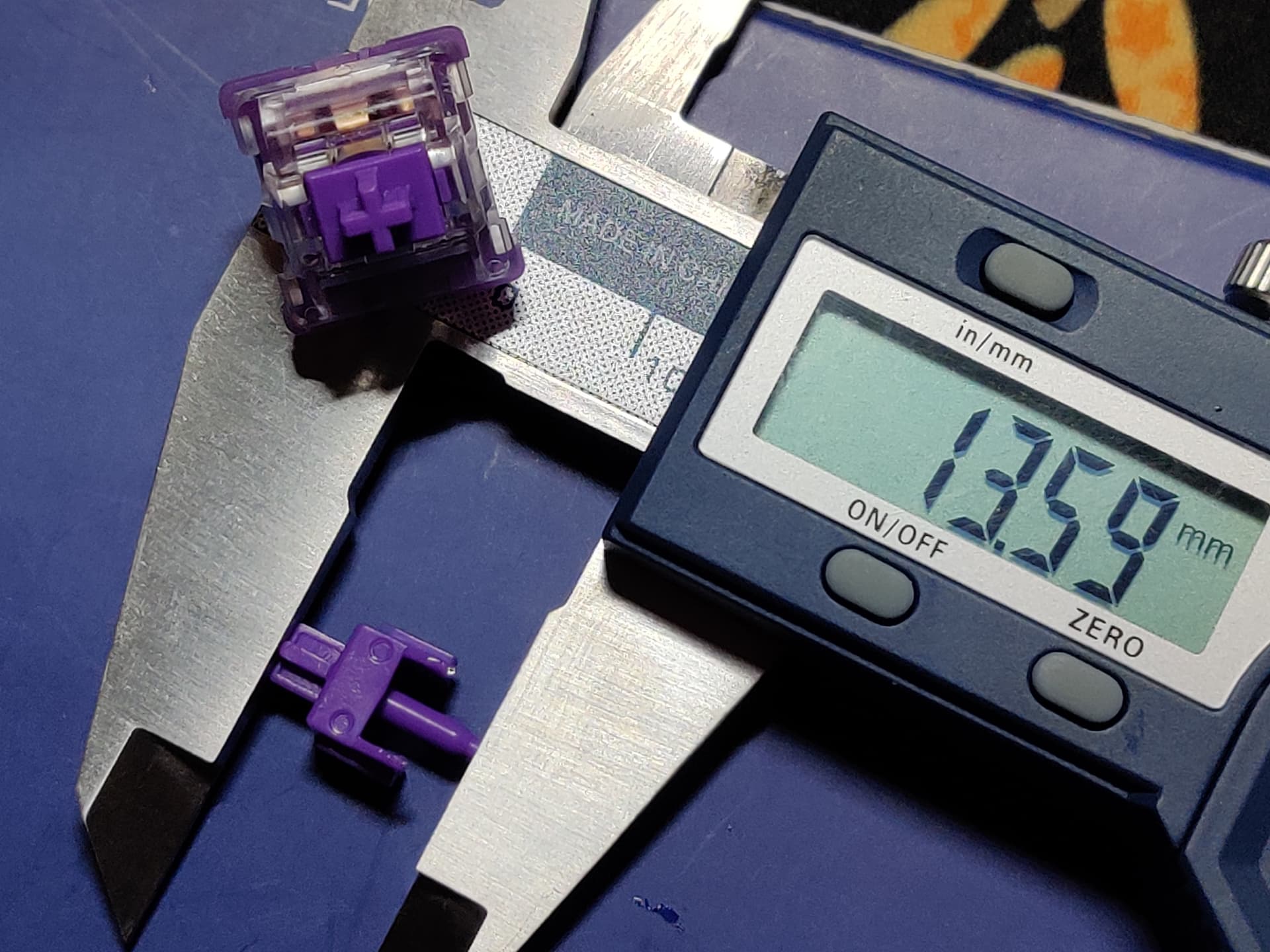

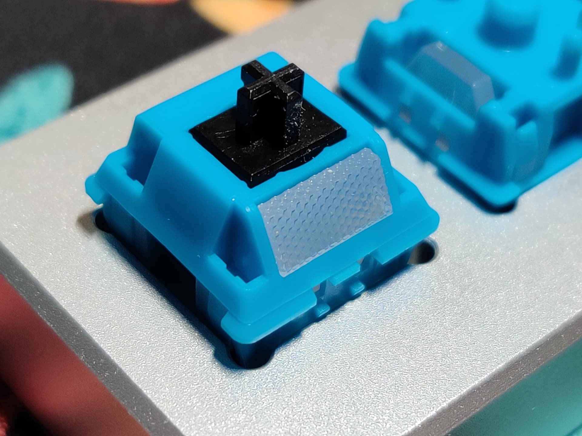

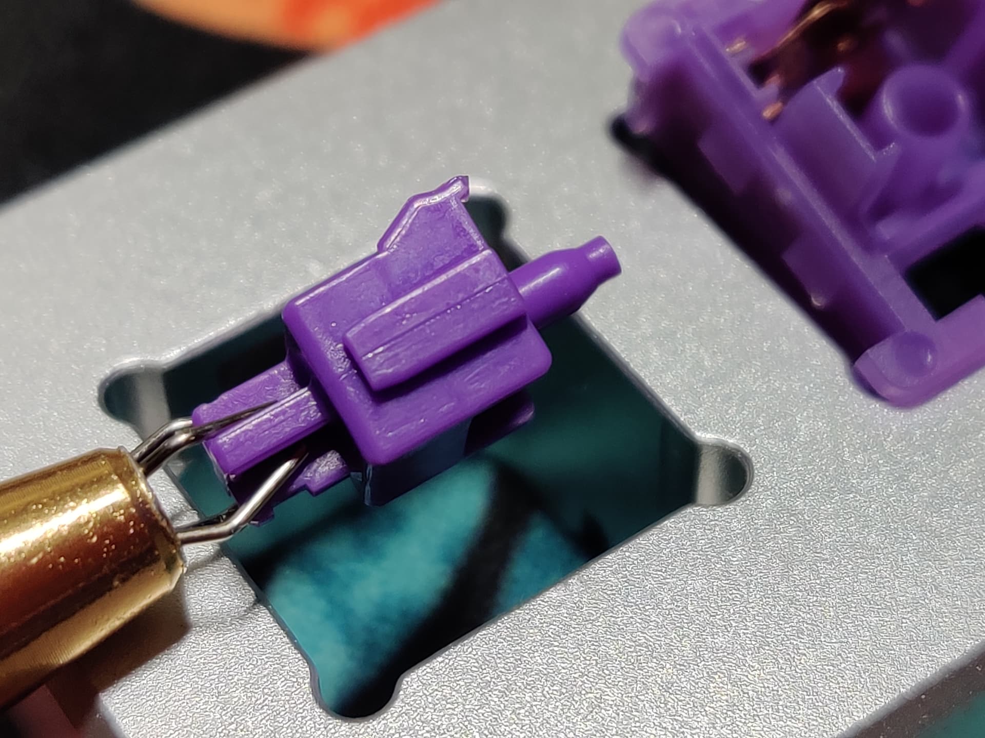

2. CIY EVO Red S and CIY EVO Purple S

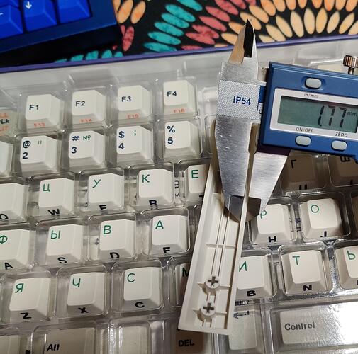

3. QMX STABILIZERS

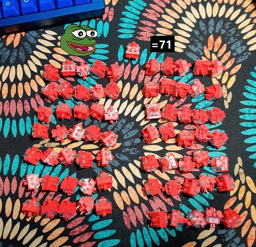

F.O.X.

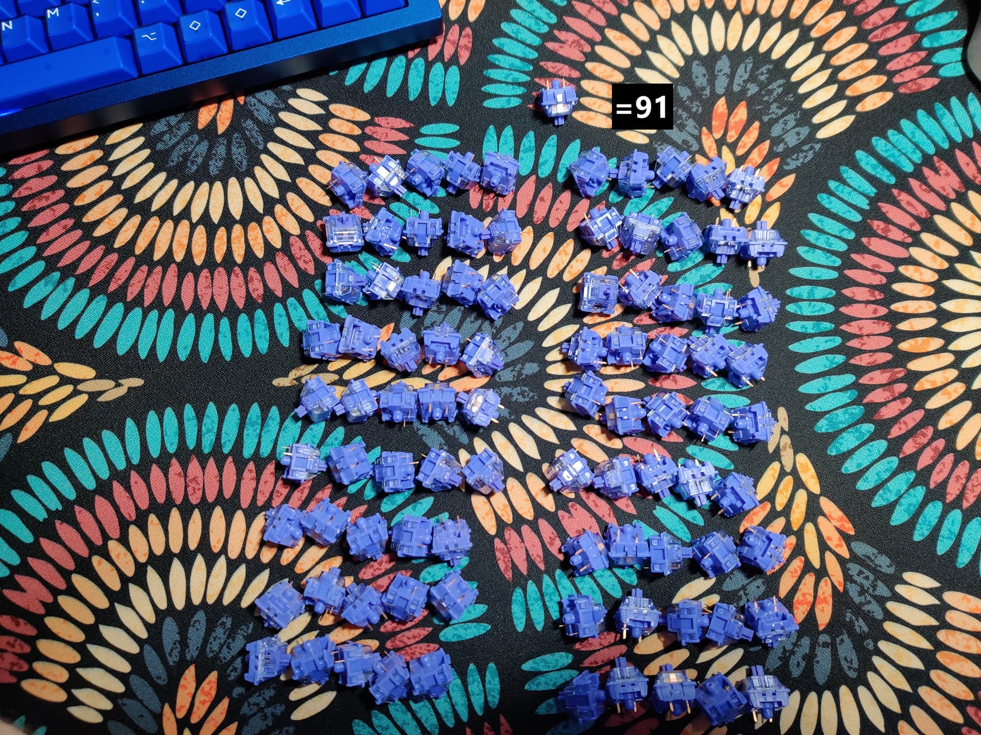

I counted… It’s only 106. :pensive:
“My day is ruined and my disappointment is immeasurable…”

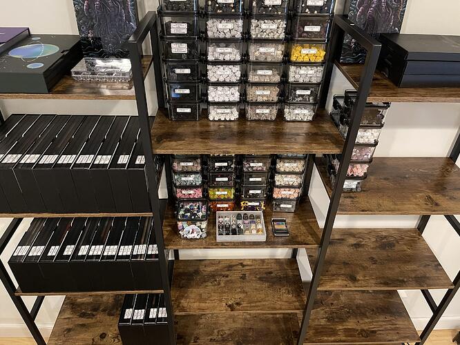

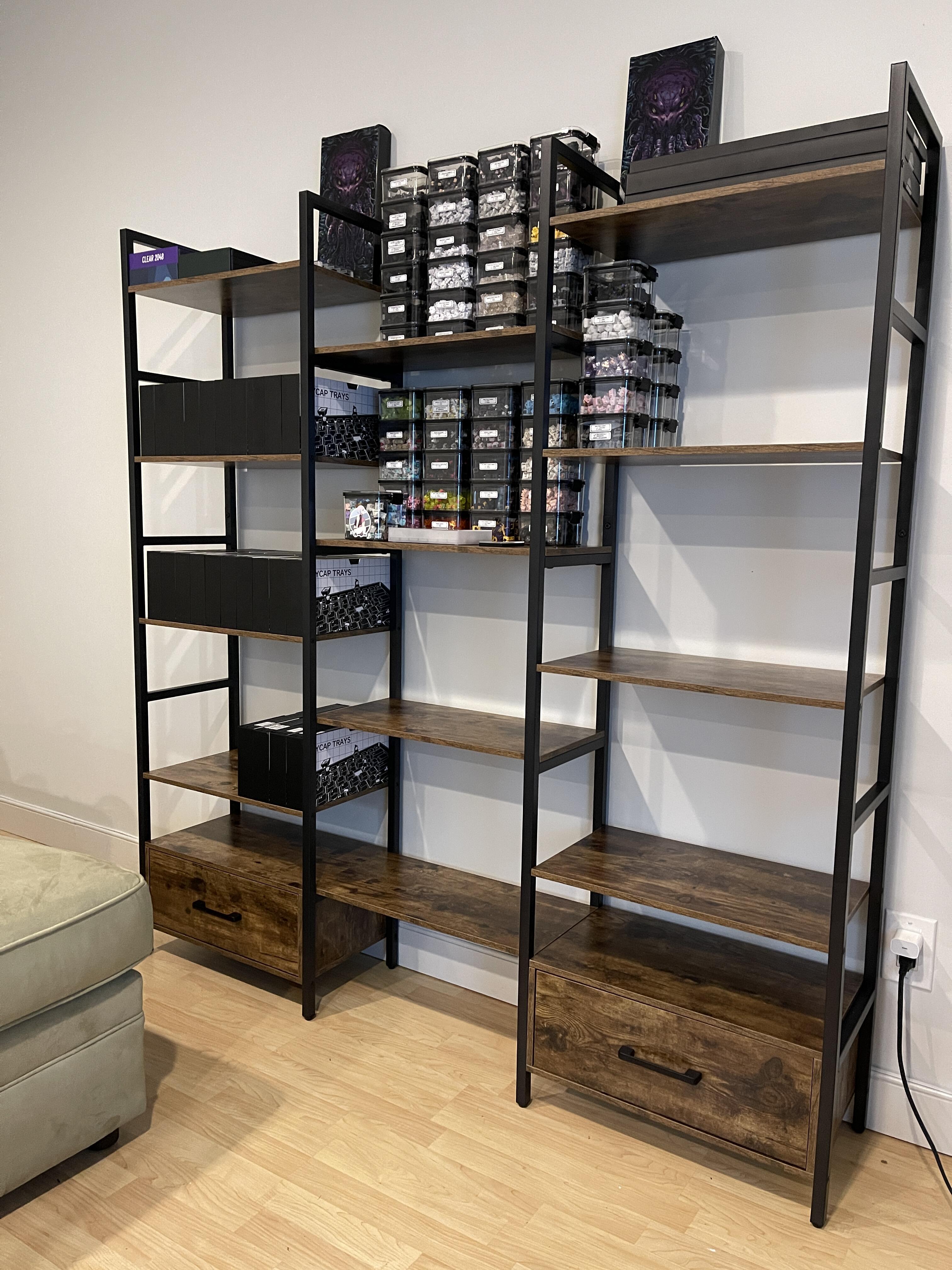

Also, I’m at the “Crap. I need to buy furniture to support my hobby” point of all of this. :face_with_peeking_eye:

It’s from taobao, so shipping may be sketch. i got it via superbuy proxy so it wasn’t too bad. https://item.taobao.com/item.htm?id=666905093705

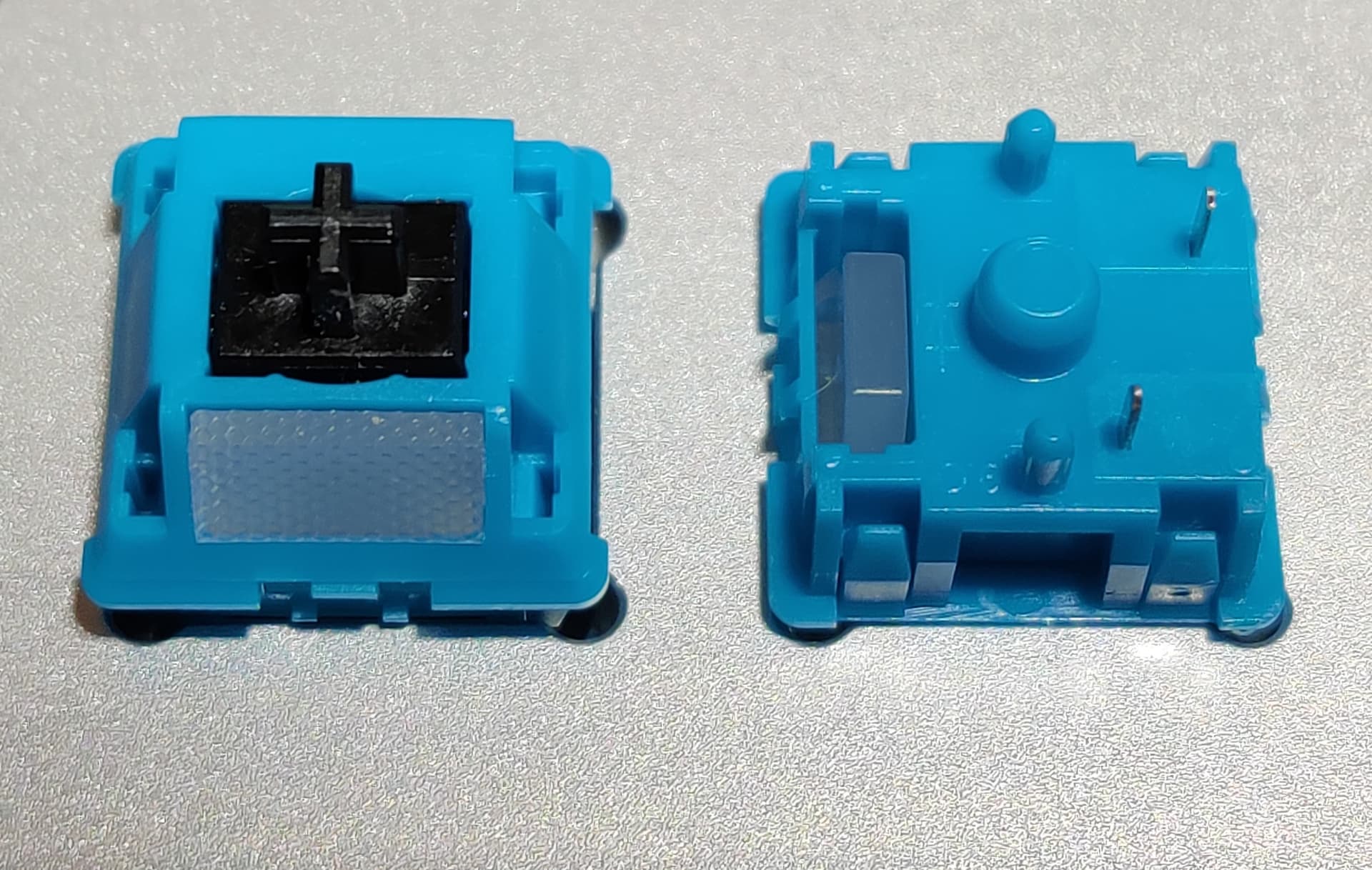

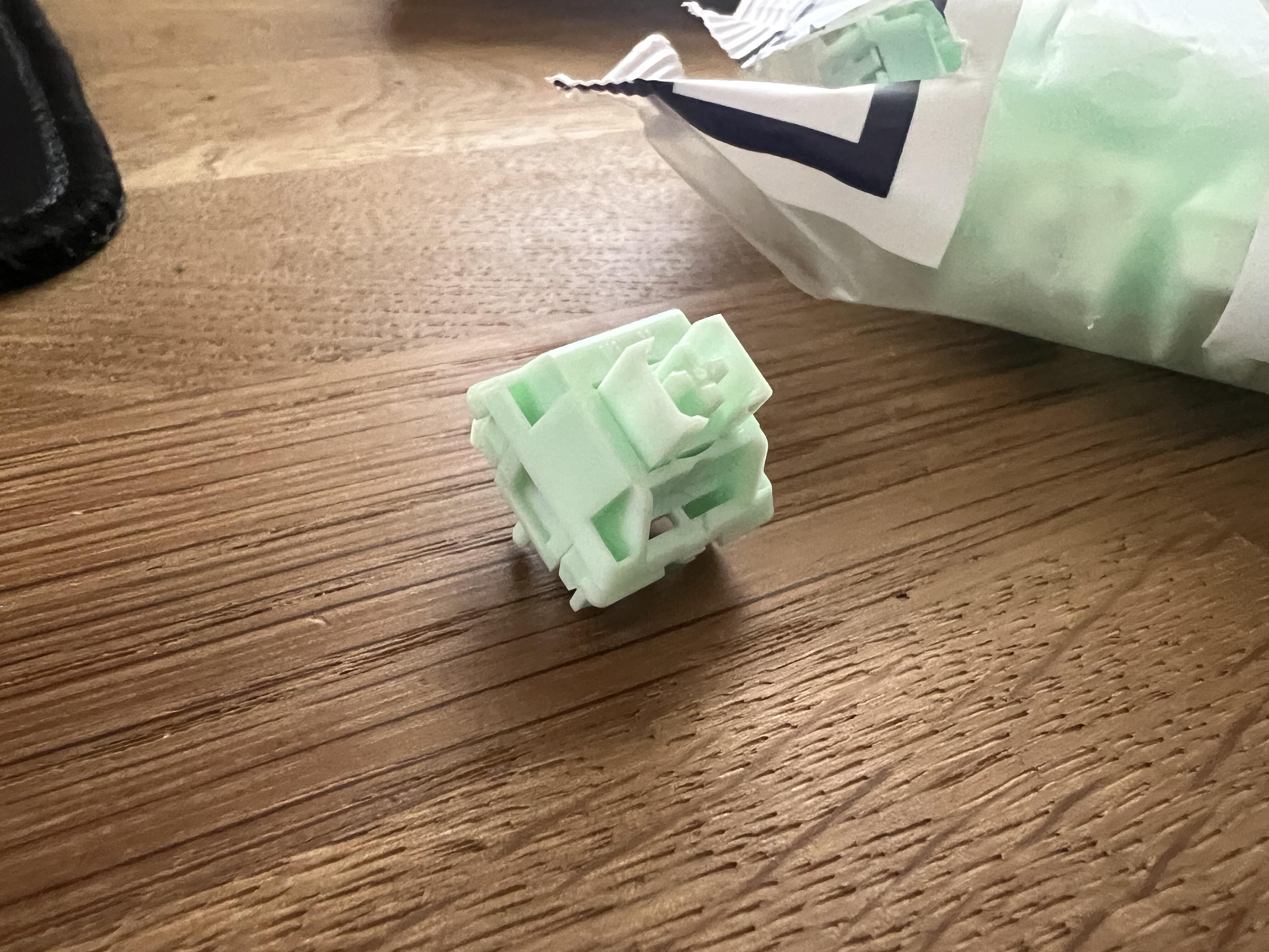

Haimu tactile mint switches from CannonKeys.
Feel pretty good. Factory lubed them with cod liver oil or something (that fish smell!)
