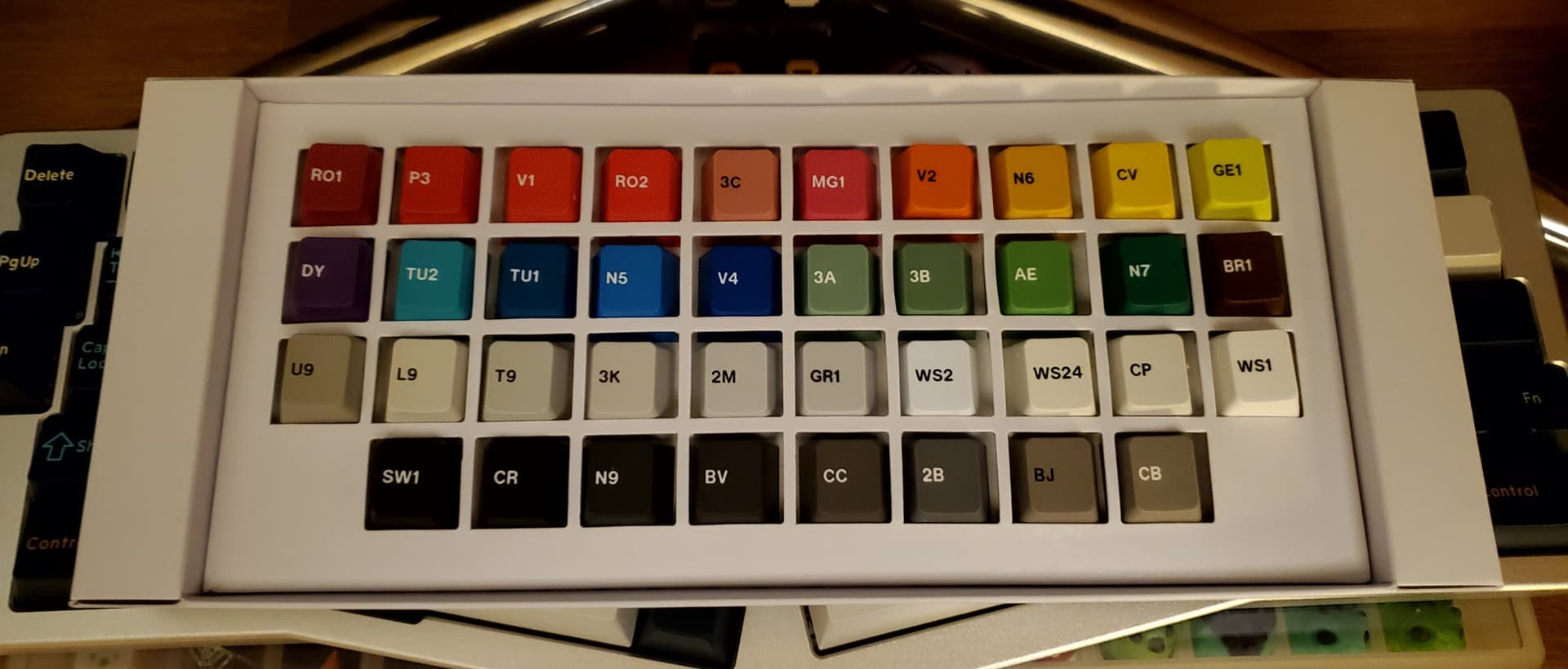

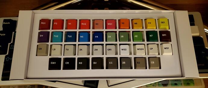

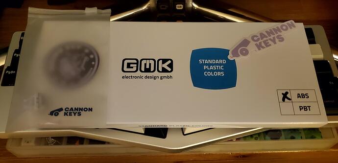

Got my set of GMK’s standard color caps in! Also got another Haimu Sky sample (kinda wish they’d keep track of who got what samples already, but I get that is a kind of unrealistic wish). Definitely some colors I have never seen in here, makes me want to try my hand at design a set LOL!

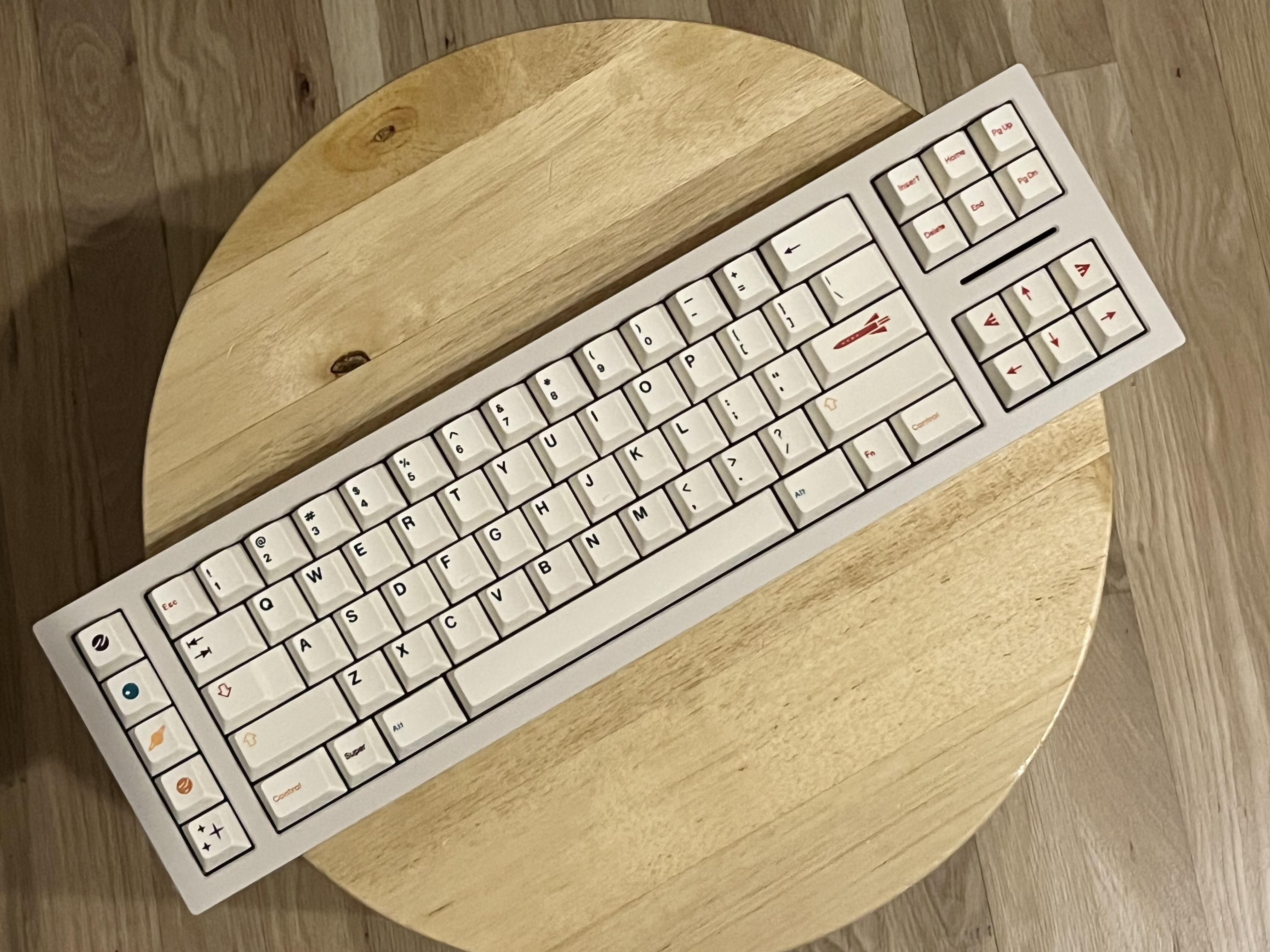

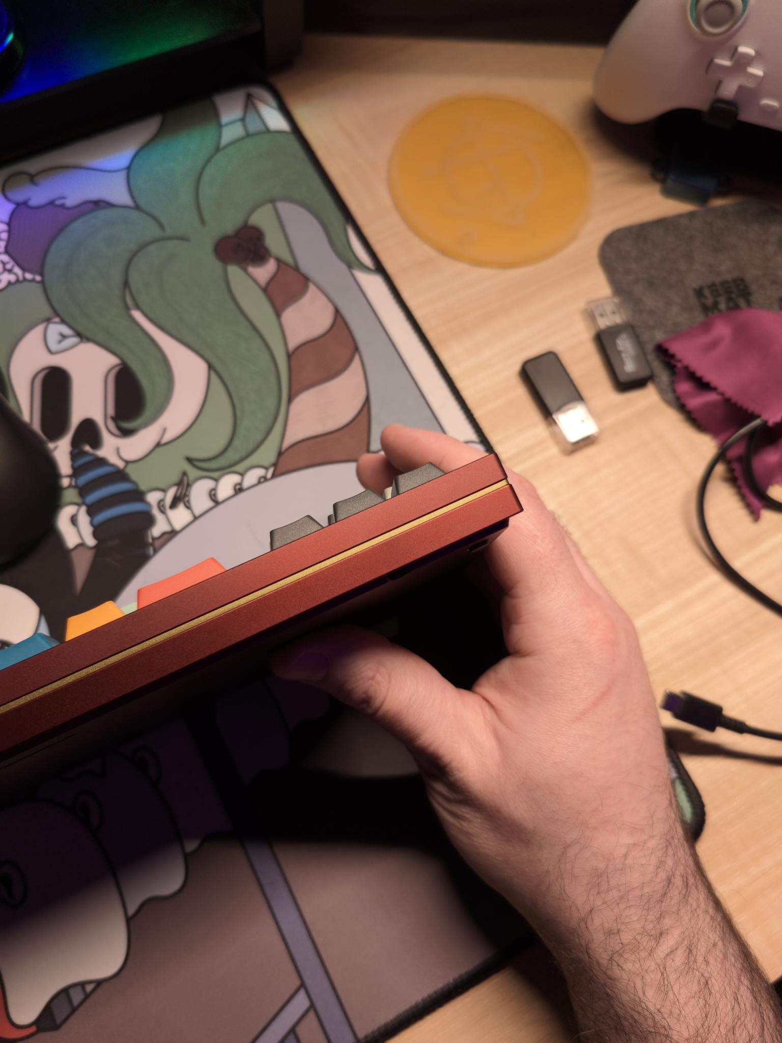

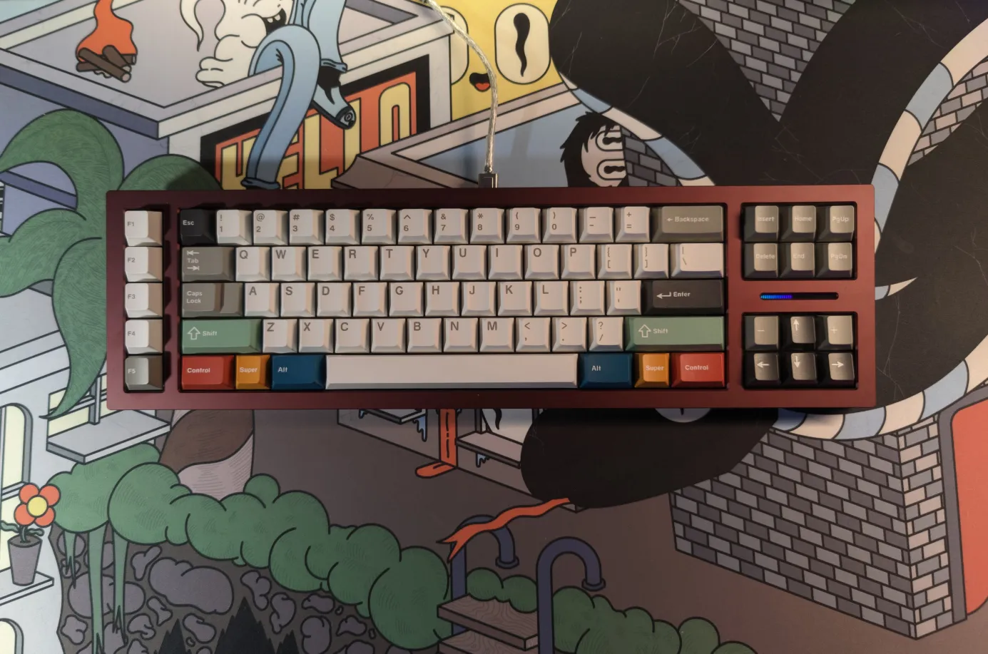

I too got my DR-70F today and built it up pretty quick.
I really like this board so far but I will say that the anno of the top and bottom don’t match. The top case is slightly darker than the bottom. I’m not sure how well it comes across in the photo though.
I’ve been really lazy lately with taking actual photos of the boards I build. I’ll have to change that. Soon™
Luckily my case halves match. Probably because of the ecoat finish
Fairly straightforward build. I thought my LEDs burned out but nope, the diffuser/blocker for the led bar just goes part way. It’s strange because it’s not 1/2 way or 1/3 of the way. You can probably remove it to see the entire led cluster.
I built it with all the foams using Gateron slay type L linears. Nice and poppy with the PE foam on the PCB.
I don’t like the look of ePBT grand tour on it, but it’s a good match. The cream is a bit on the sandy side of beige
I’ll find a better set for it and take better photos later. I think the board is a great value and well made. Probably should order a spare PCB since the unique form factor and ribbon cables will it will be impossible to replace if this one messes up down the road.
Yeah. I’m not totally upset about the anno given the value of this board. I just thought I’d make a note of it for anyone else. Plus, I’ve seen worse anno on way more expensive boards. coughramacough

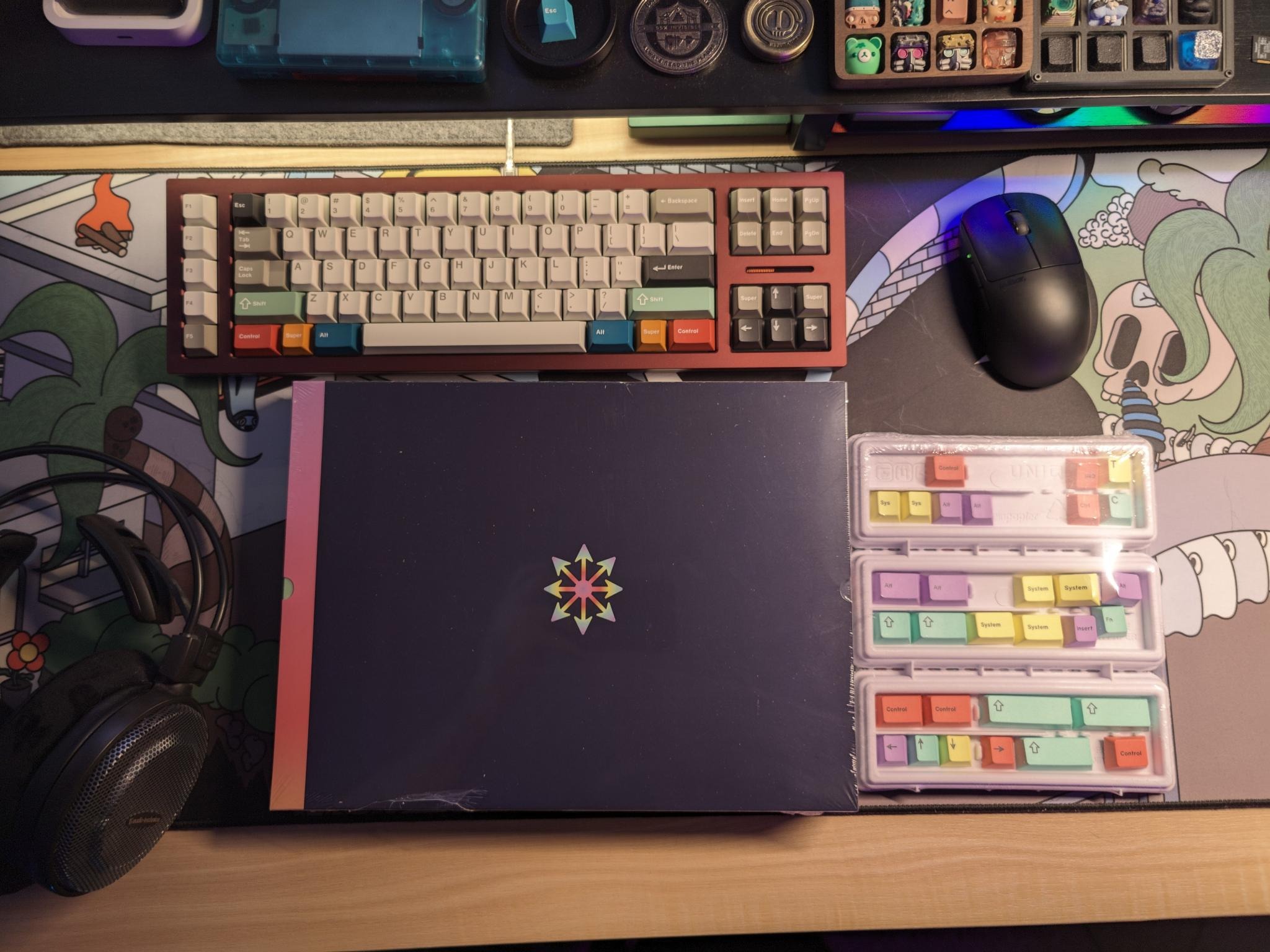

EDIT: I forgot that GMK Chaos Theory finally arrived the other day after 2+ years.

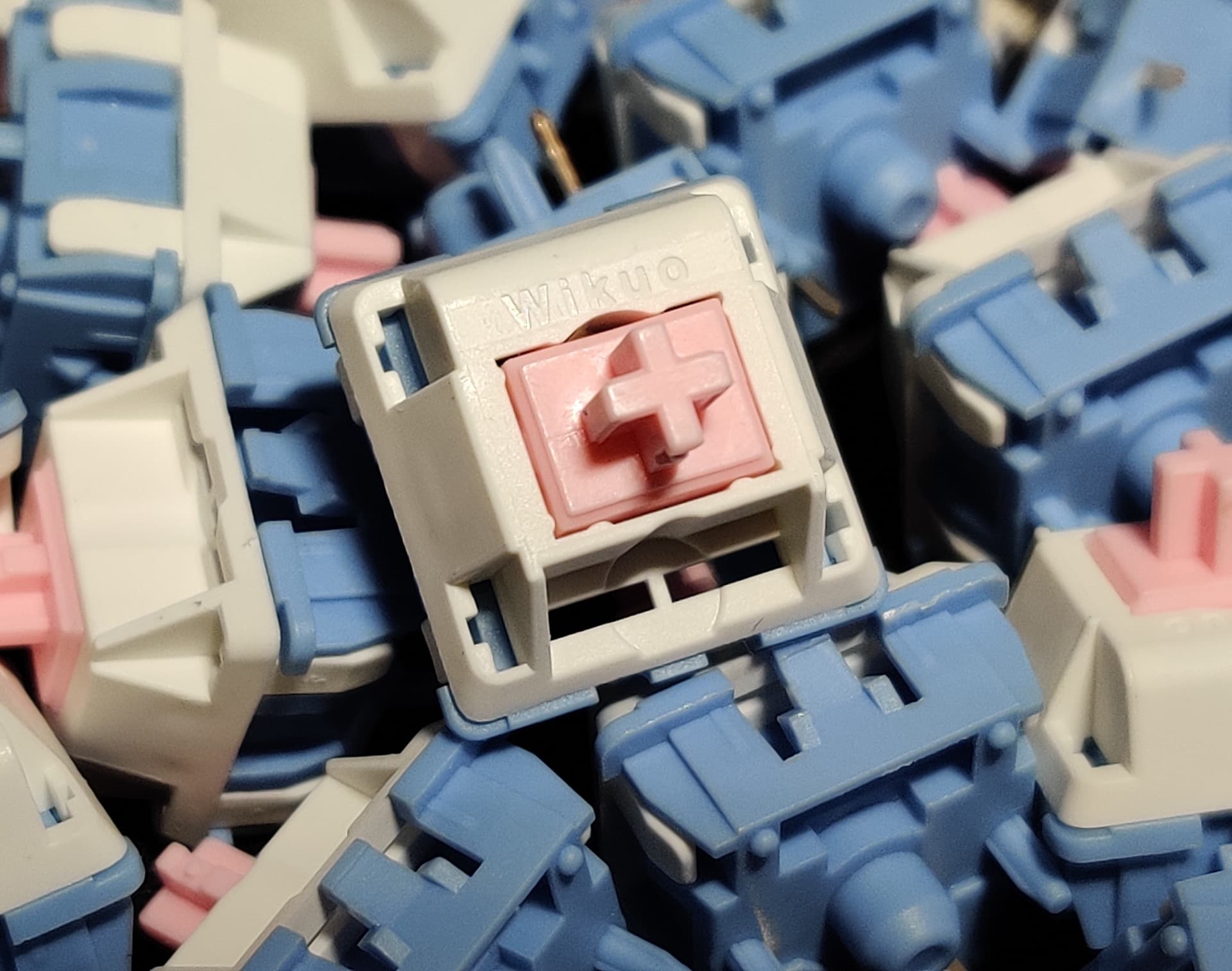

Summary
They have factory lubricant. BUT
They are so loud, a high-pitched sound of impact upward.
If you re-lubricate manually. That’s better, but in the video of “Keeb Taro” they are quieter. In real life, I thought about throwing them out the window.

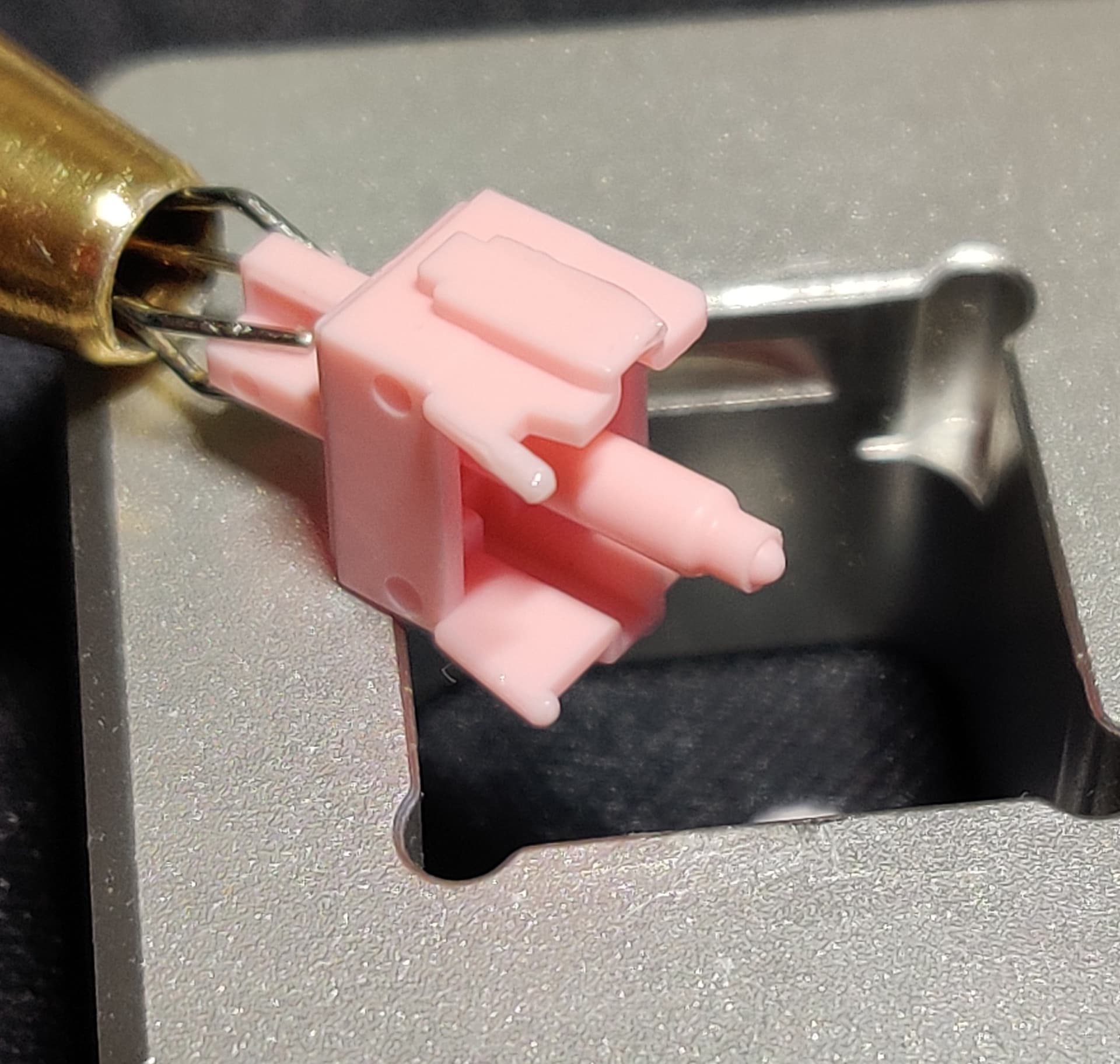

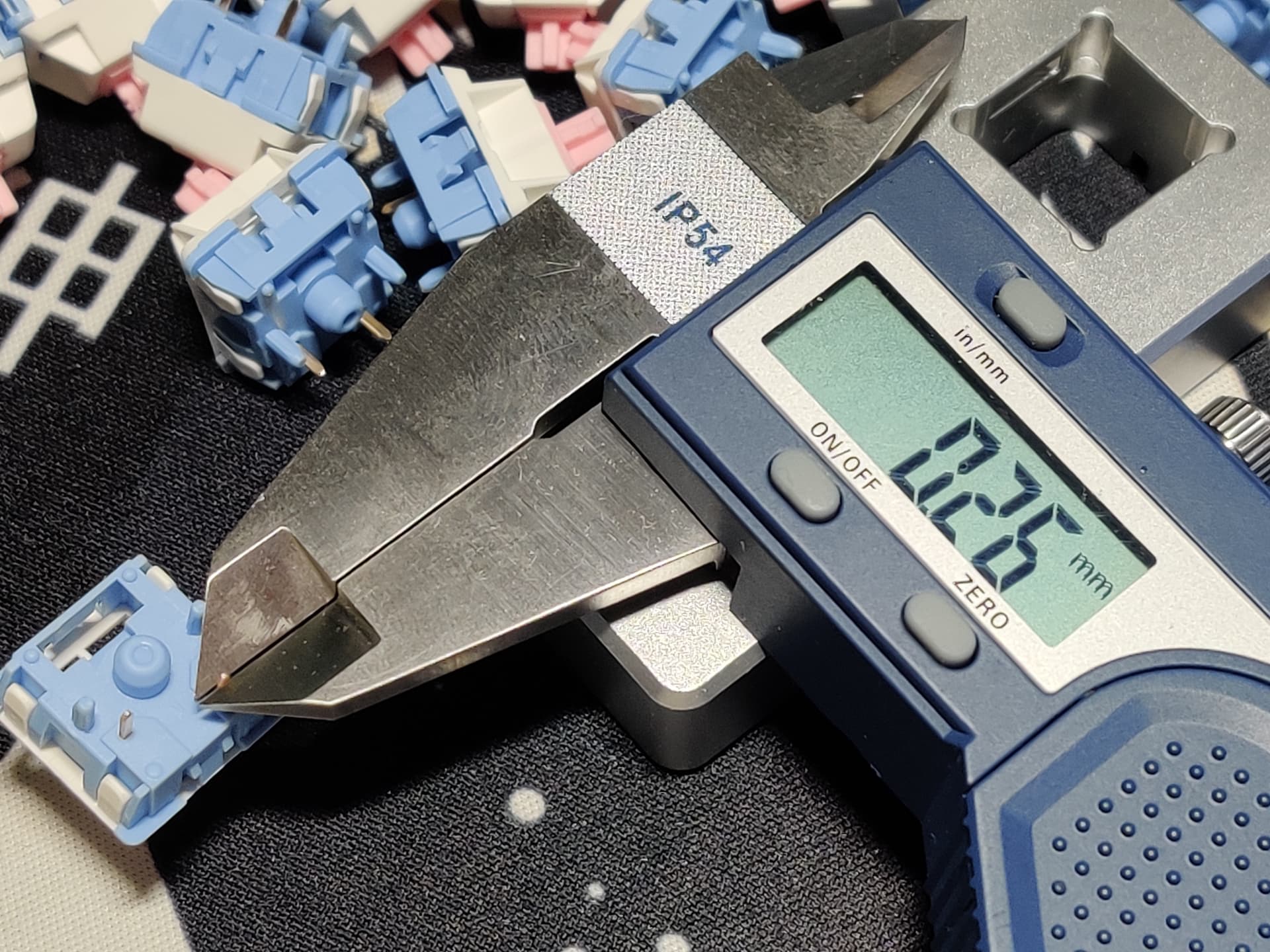

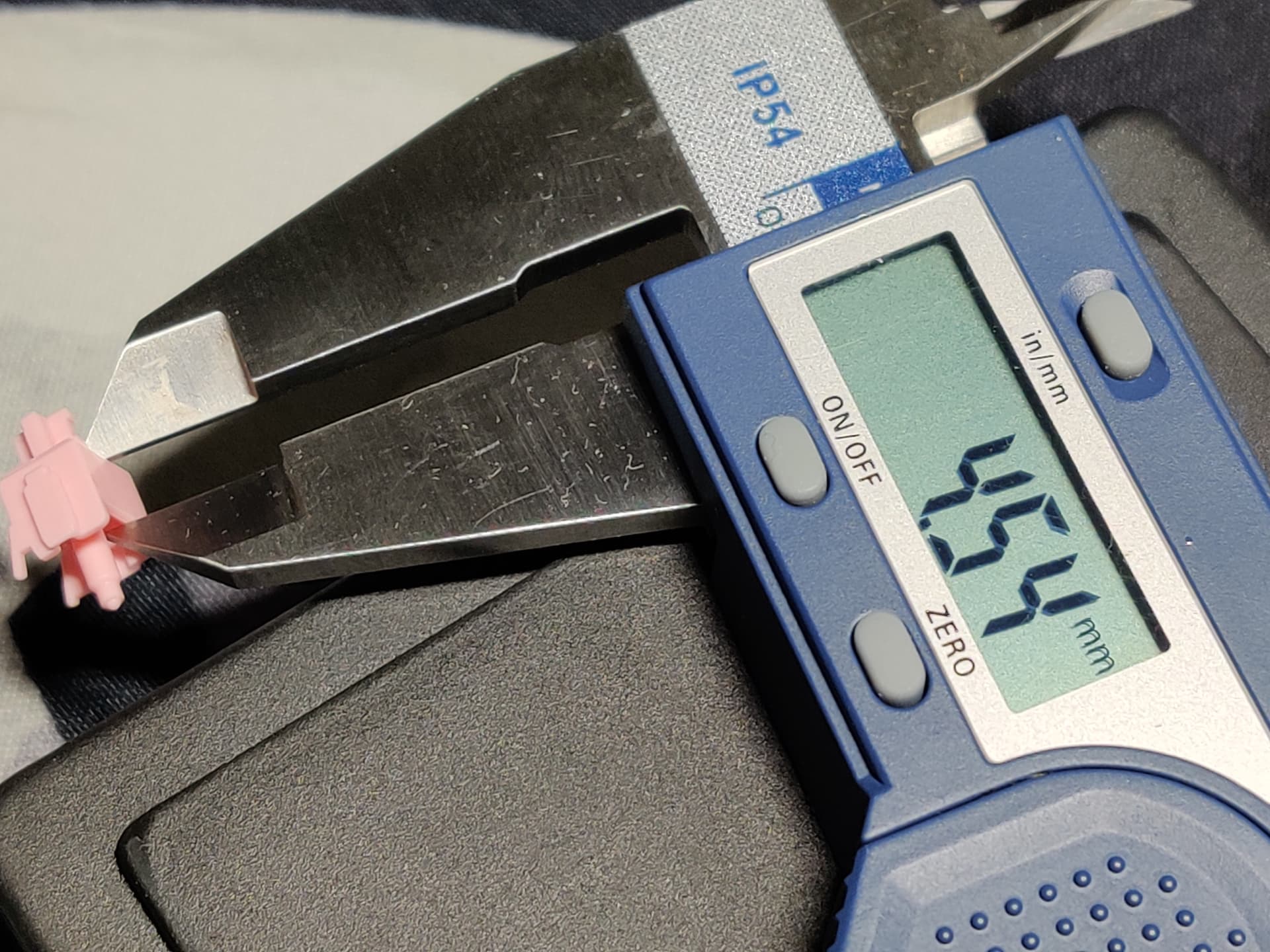

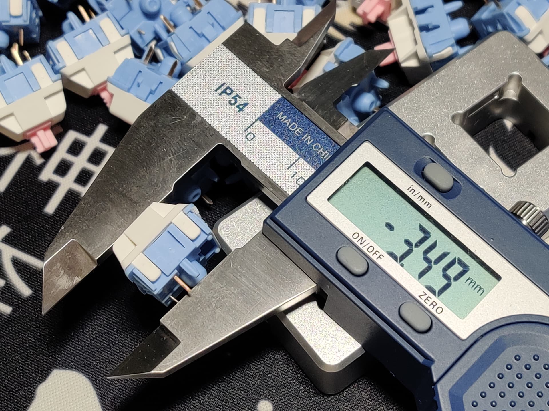

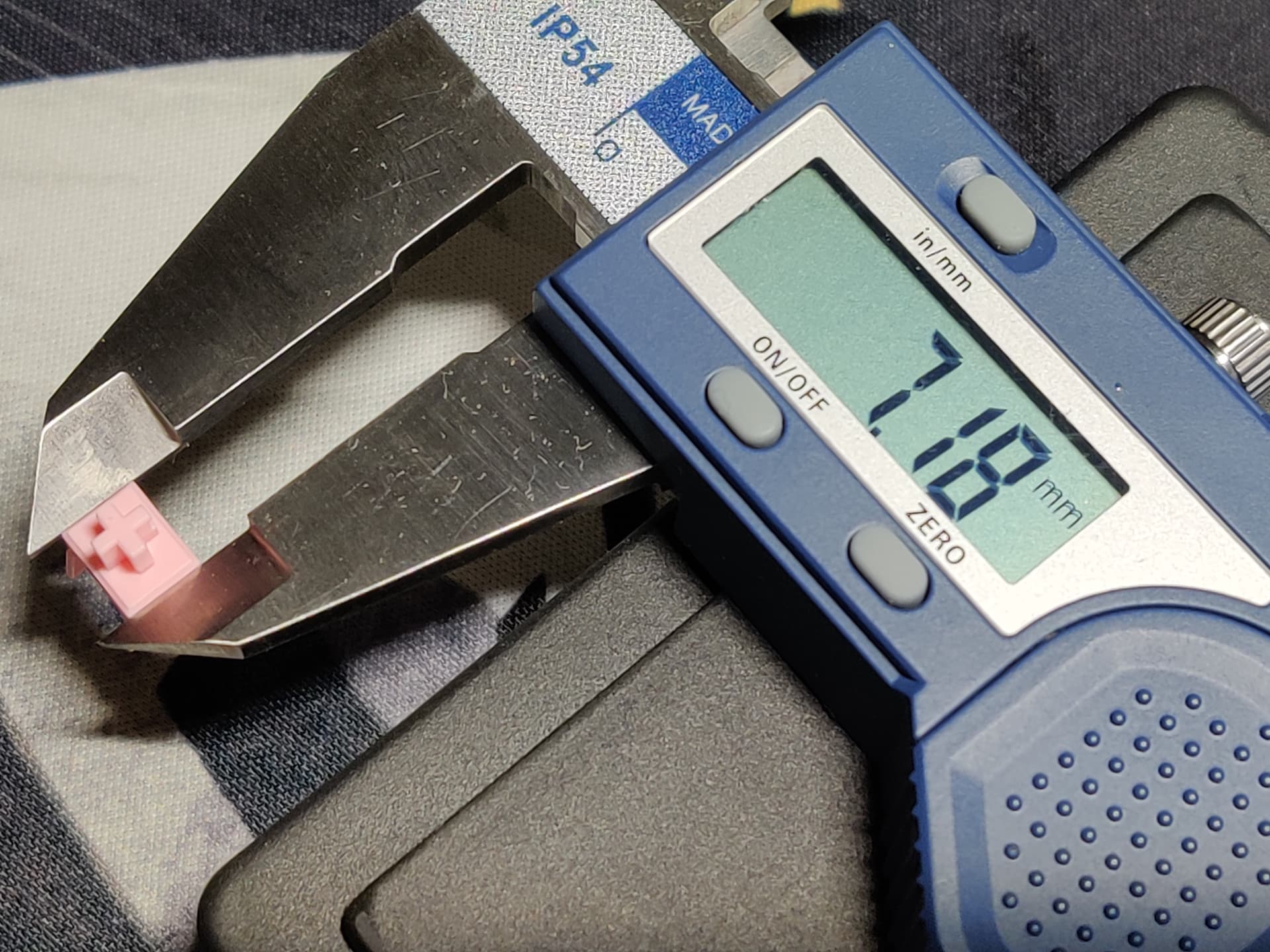

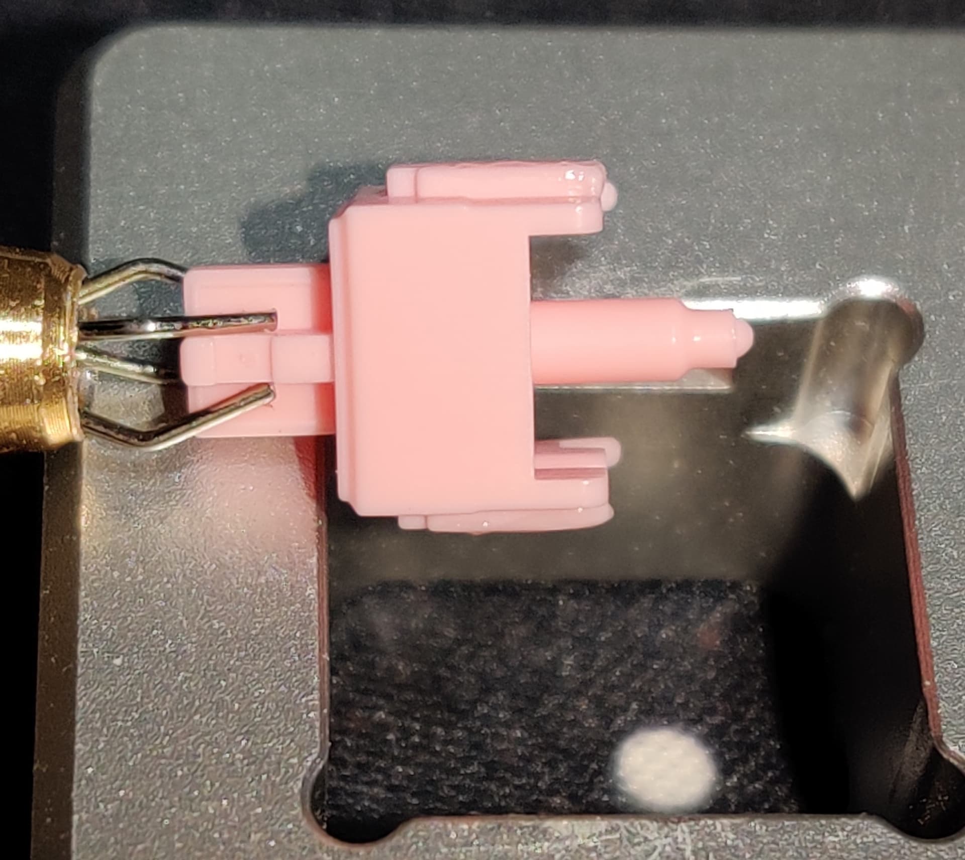

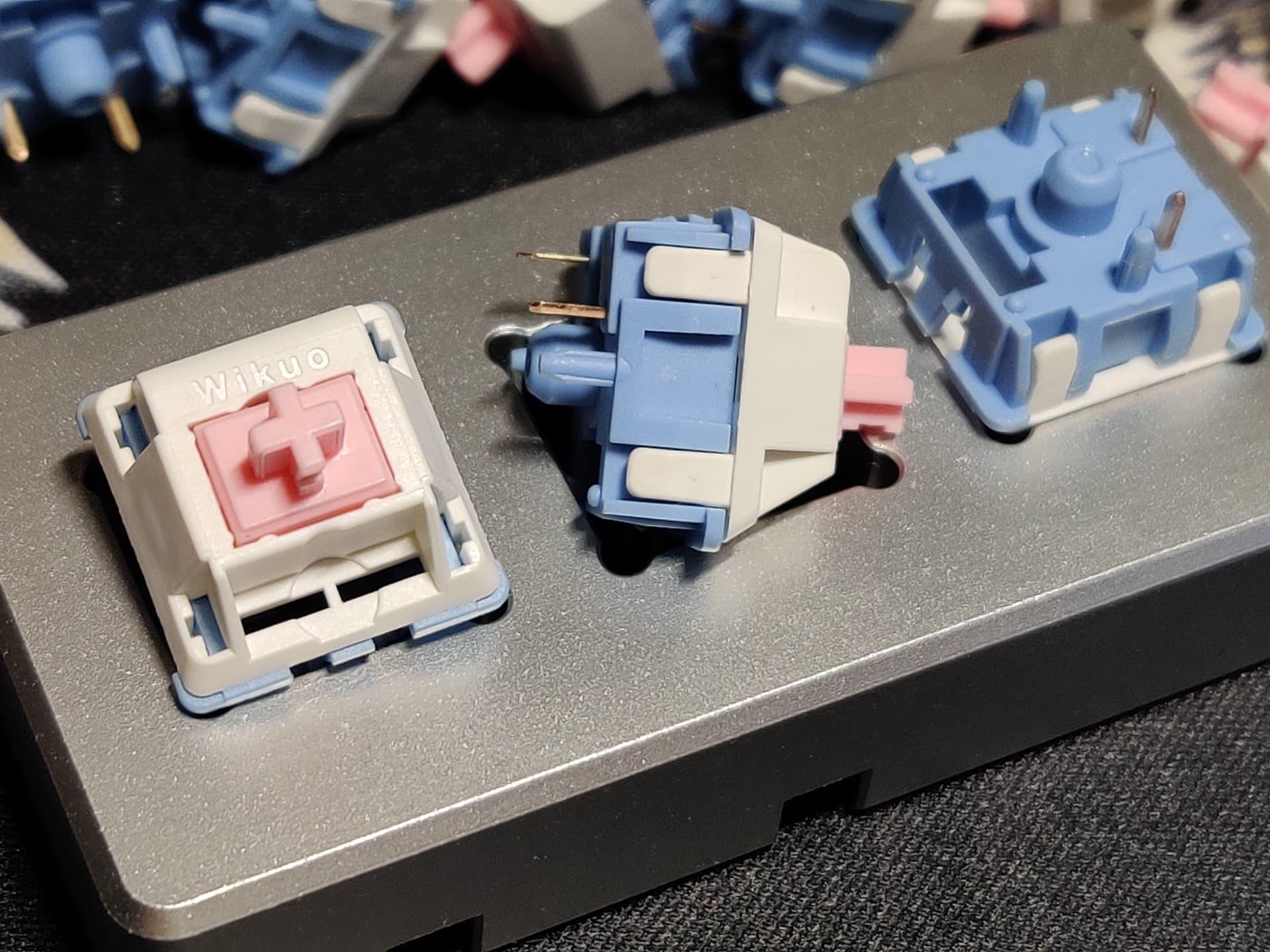

Huh, that’s pretty odd, it’s made of the standard nylon housing, POM stem combo. They do say polymer nylon so it makes me wonder if it has a ton of fiberglass added or if the loudness is down to the stem having a fairly small point it bottoms out on. It could also be a combo of the two. :thinking:

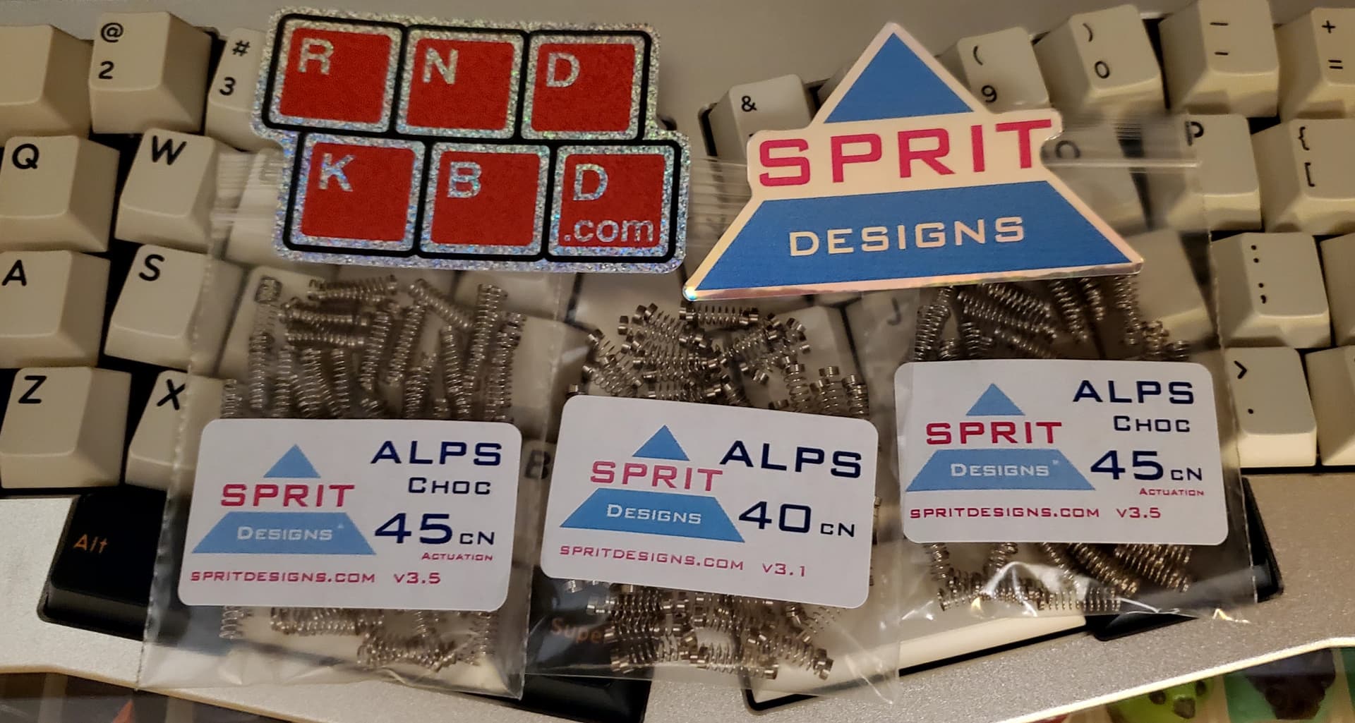

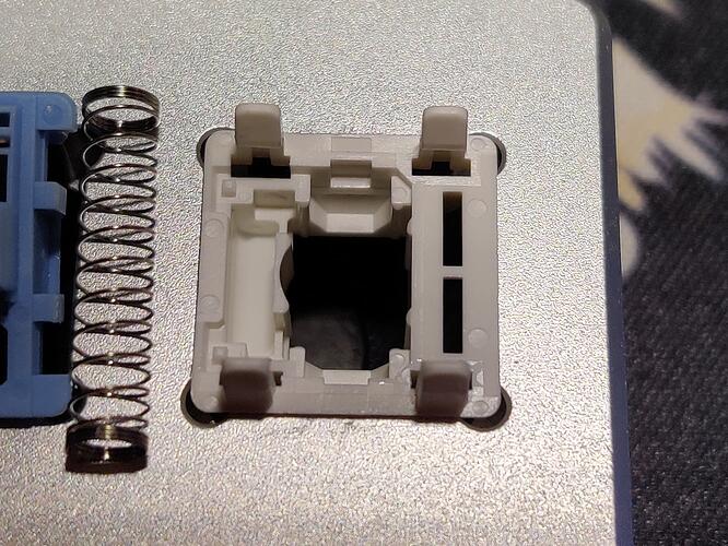

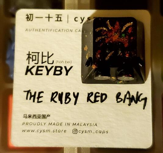

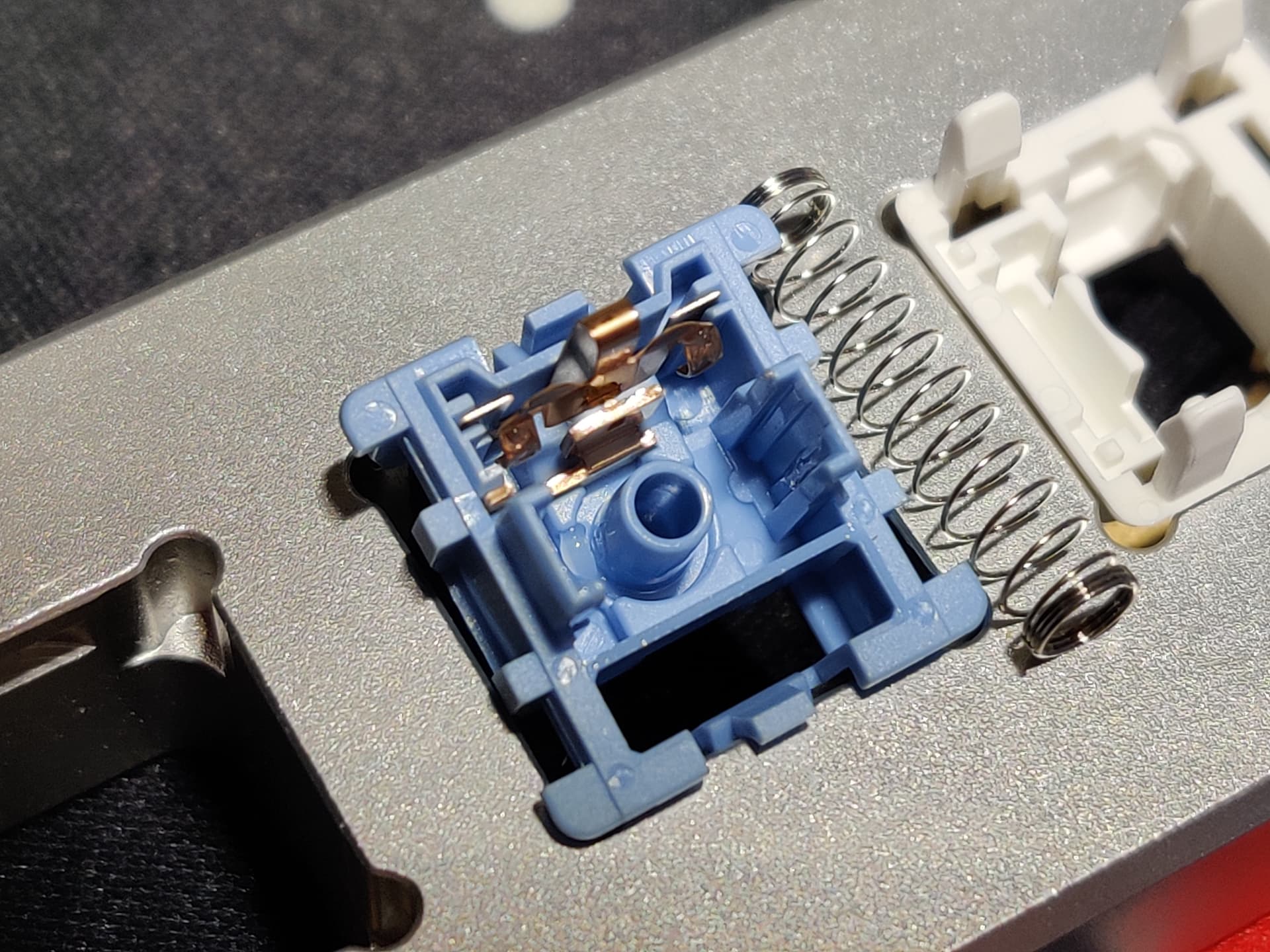

Got my Keyby in yesterday & got some ALPS springs in from RNDKBD today. I hate to support sprit, but as far as ALPS springs goes he’s the only game in town unfortunately. I searched all over for alternatives but couldn’t find anything other than the regular ALPS springs MK.com & RNDKBD has left & the ALPS/Choc springs RNDKBD has. I actually think I got literally the last pack of 40cn regular ALPS springs out there as this was the only one RNDKBD had in stock & MK.com just had super heavy ones left. Thankfully Choc springs are compatible with ALPS so us ALPS enthusiasts are not completely SOL. Although again for Choc springs sprit seems to be the only one making them. Not ideal, but good aftermarket springs really makes a noticeable difference with SKCM/L ALPS IME.
