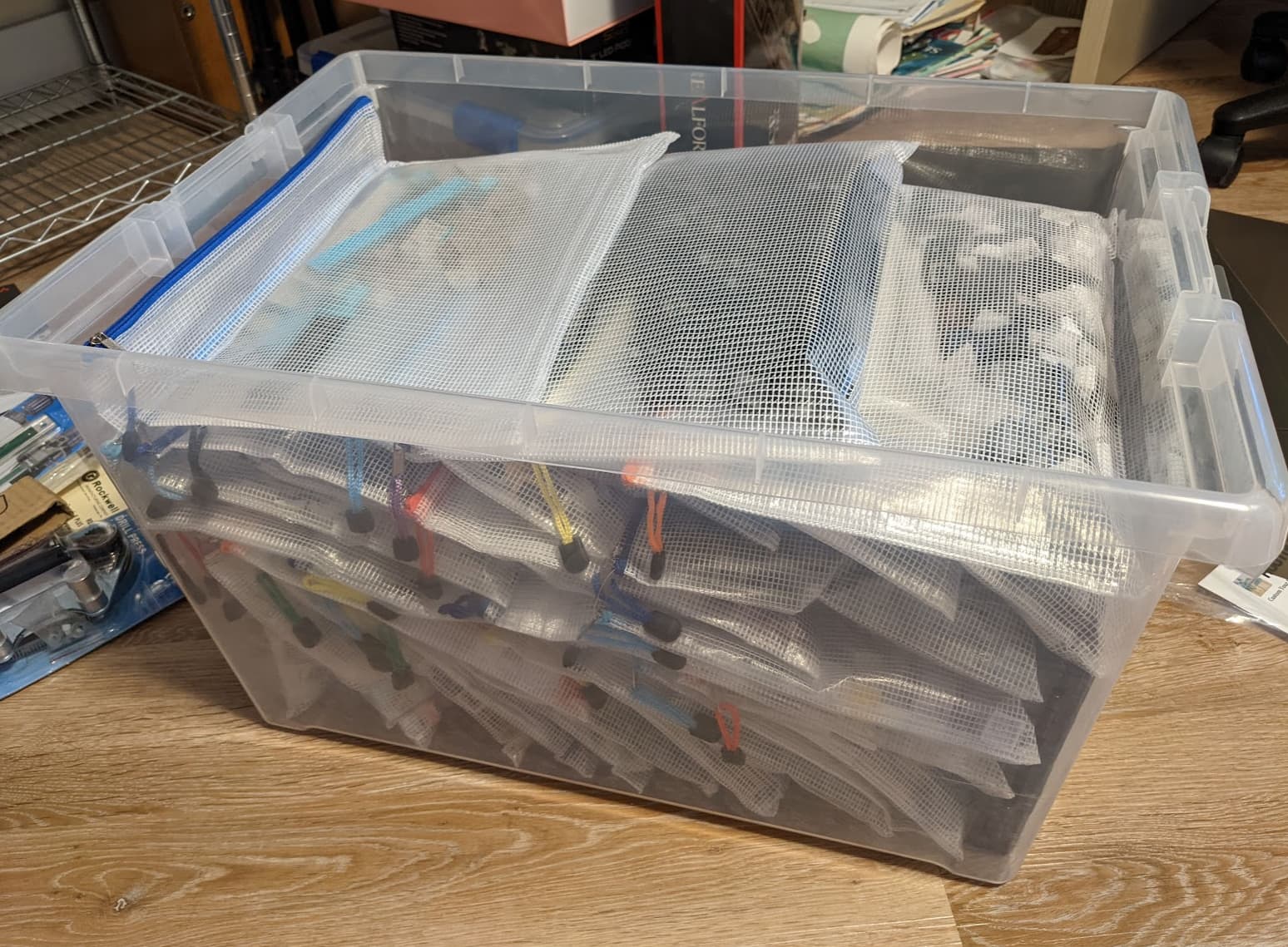

I gave up with the trays just recently. As much as I prefer that method of storage, I just didn’t have the room. So I bought these pouches, which are pretty heavy duty and have zippers.
So each set gets a bag and since they aren’t bulky, I can store quite a few sets in an average sized storage tub.
I dig those bags, pricey compared to just plain ziplocs but they’ll last way longer too. Also a couple storage tubs would take up much less space than what I got going on now. I’m getting close to 40 sets, more like 50+ if I count the sets I have from boards I harvested. Might have to look into these, thanks for the heads up!
This bag holds almost any keycap set out there without taking up too much extra space. Nice and sturdy, too.
Currently on my 3rd pack of 200 count :slight_smile:
I don’t remember when I passed the 1:1 keyboard to keycap set ratio, but things got a little out-of-hand since that point.
I’m afraid to count how many I have in here, but storing them in bags definitely helps cut down on the amount of dead space.
