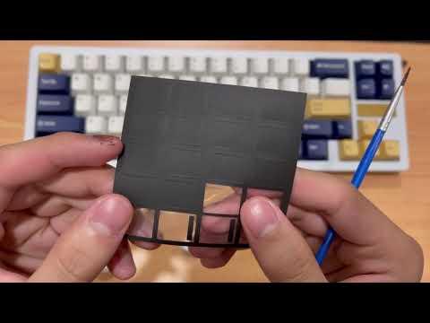

TIL about the leaf shroud mod, linked as a suggestion on Invokeys’ discounted Blueberry Chiffon page. It’s supposed to help with the leaf noise found on many light tactiles:
It also seems like it generally deepens the sound, which opens up more options in that arena generally.
Those leftover film bits keep on being useful… I can think of lots of switches I’d use more after a mod like this.
Woo. That’s an interesting idea. Although I don’t have those left-over pads bc I use TX films, I think regular paper should work just as well as long as the paper is touch the leaf without interfering with its operation.
