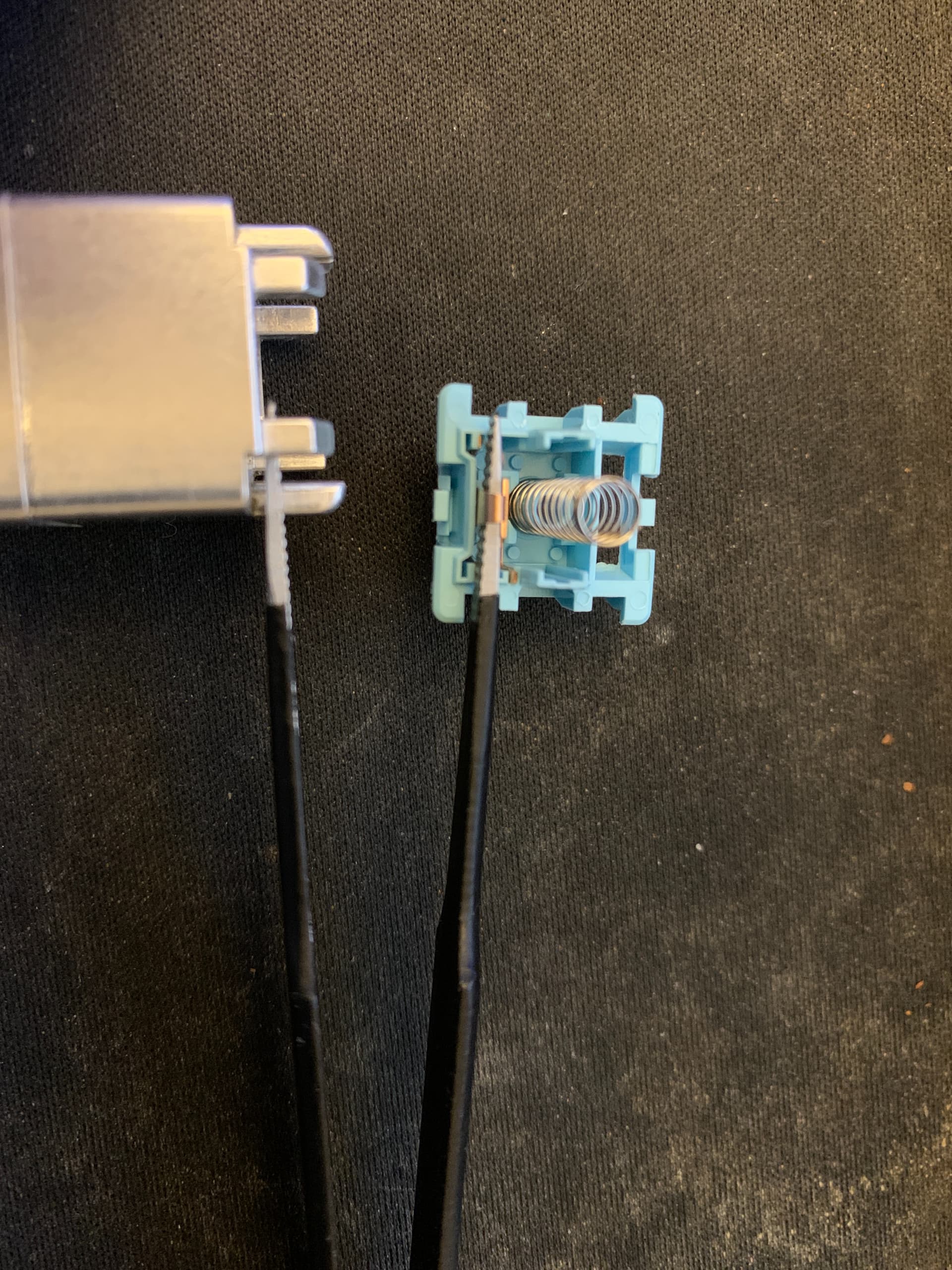

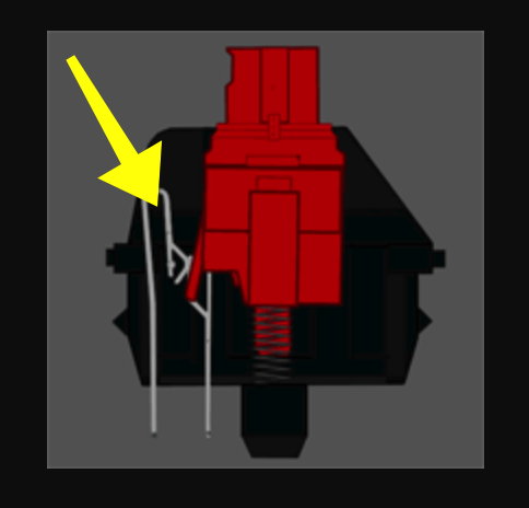

I opened one of the bad switches and the first thing I noticed is that moving the stem barely moved the contact leaf. Second thing I noticed is that the inverted U part of the contact leaf looked flatter than usual.
screenshot_1237

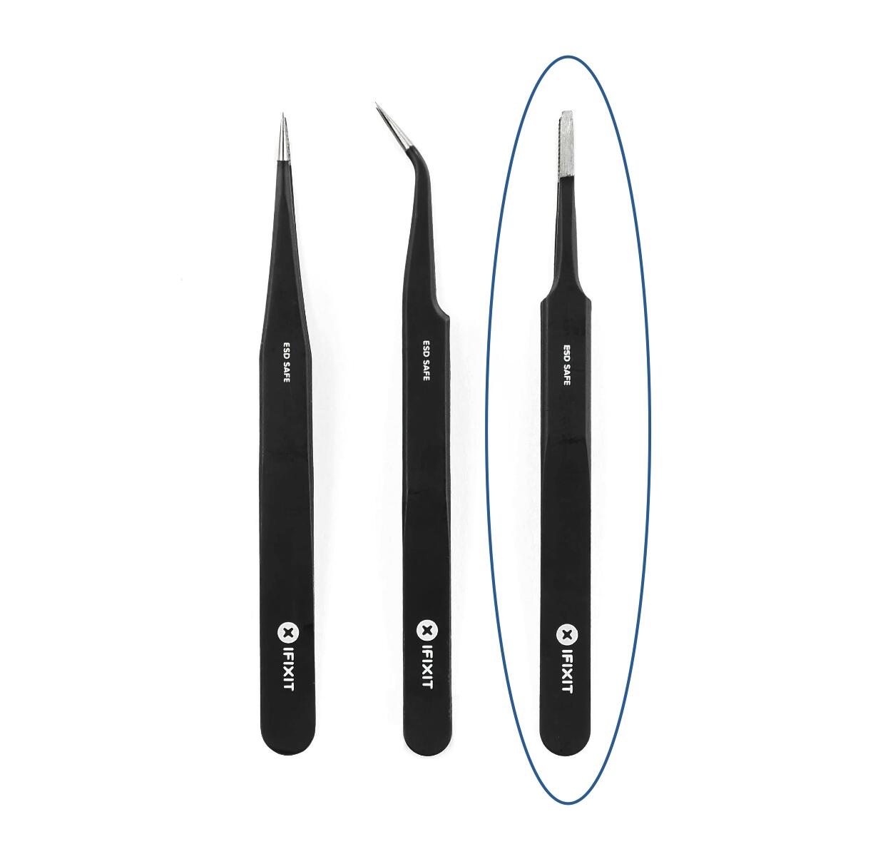

Shape of contact leaf is easy to damage without a proper jig so I took the flat iFixIt tweezer with legs very slightly thicker than the U shape bend and very slowly inserted into the leaf just enough to feel the bend widening a bit.
I then put the switch back together and tested the switch with modified contact leaf. And drumroll… the switch started working. To confirm, I modified contact leaf of remaining 6 bad switches plus 4 switches that failed the first test pass. Every dang switches now register keystrokes cleanly.
Looks like Aflion has some changes to make, not just to the design of their switches but how they run their business. Until then I won’t be buying any more Aflion switches.
Whoa! I might be sitting on 40 or so fixable switches :flushed:
So, insert tweezers into the inside of the U and ever so slightly widen it? Would it be too much to ask you to take a picture?
Tweezer leg width changes so just insert til resistance is felt then pushing just a tad more should widen the U shaped bend slightly.
Oh I see! Thanks that is very helpful!

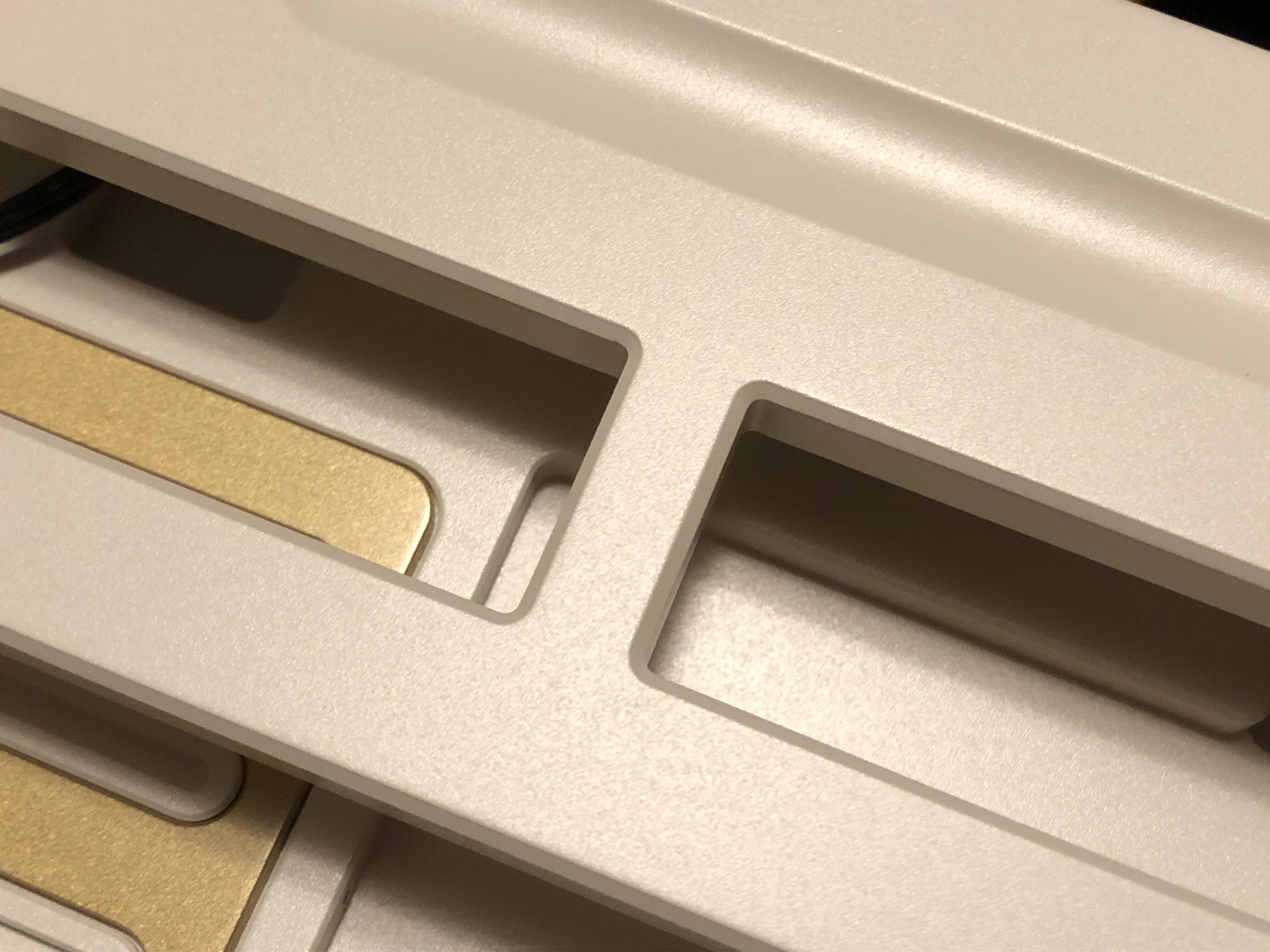

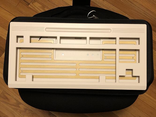

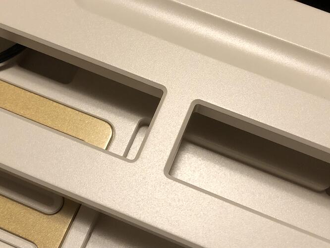

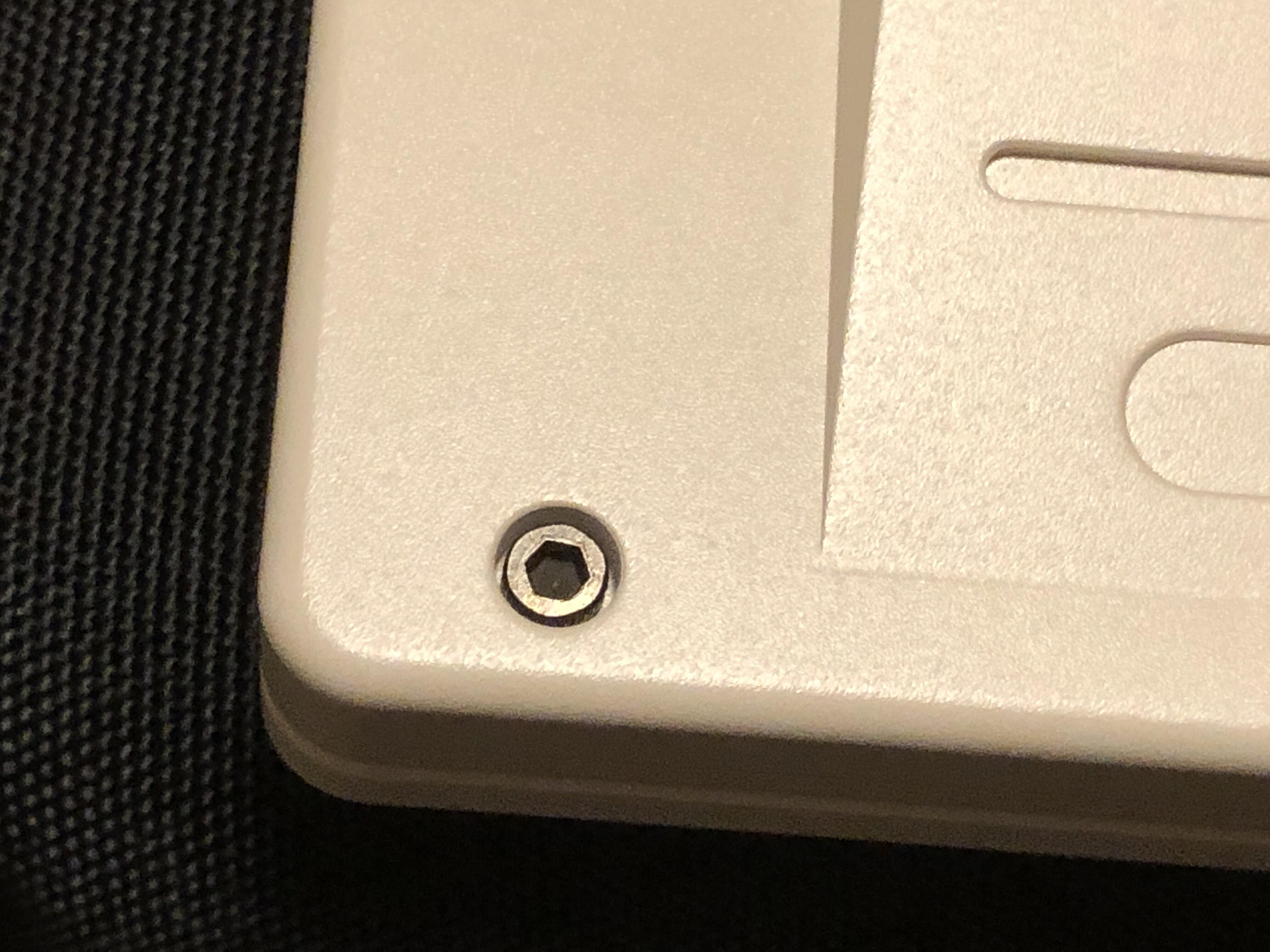

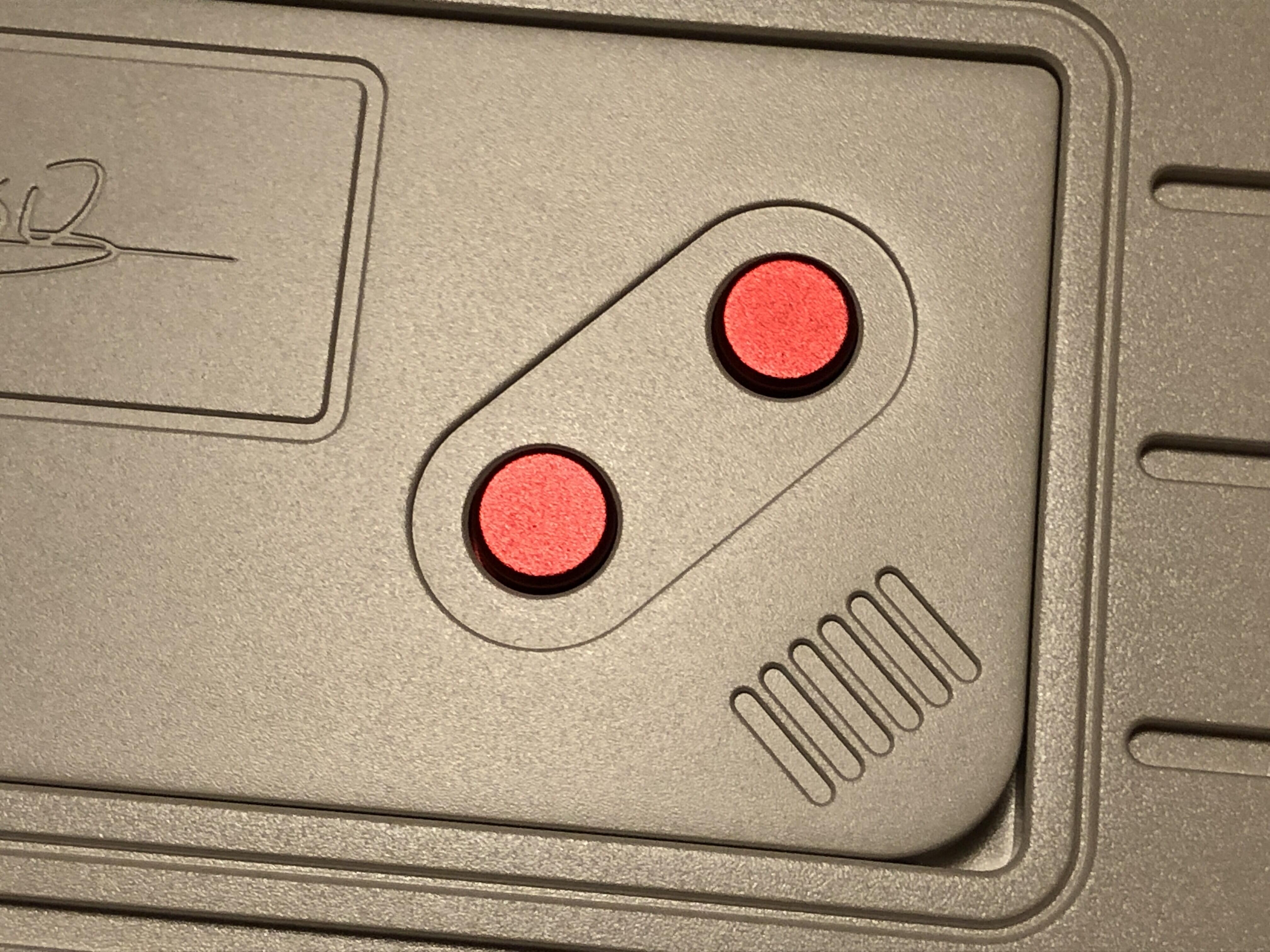

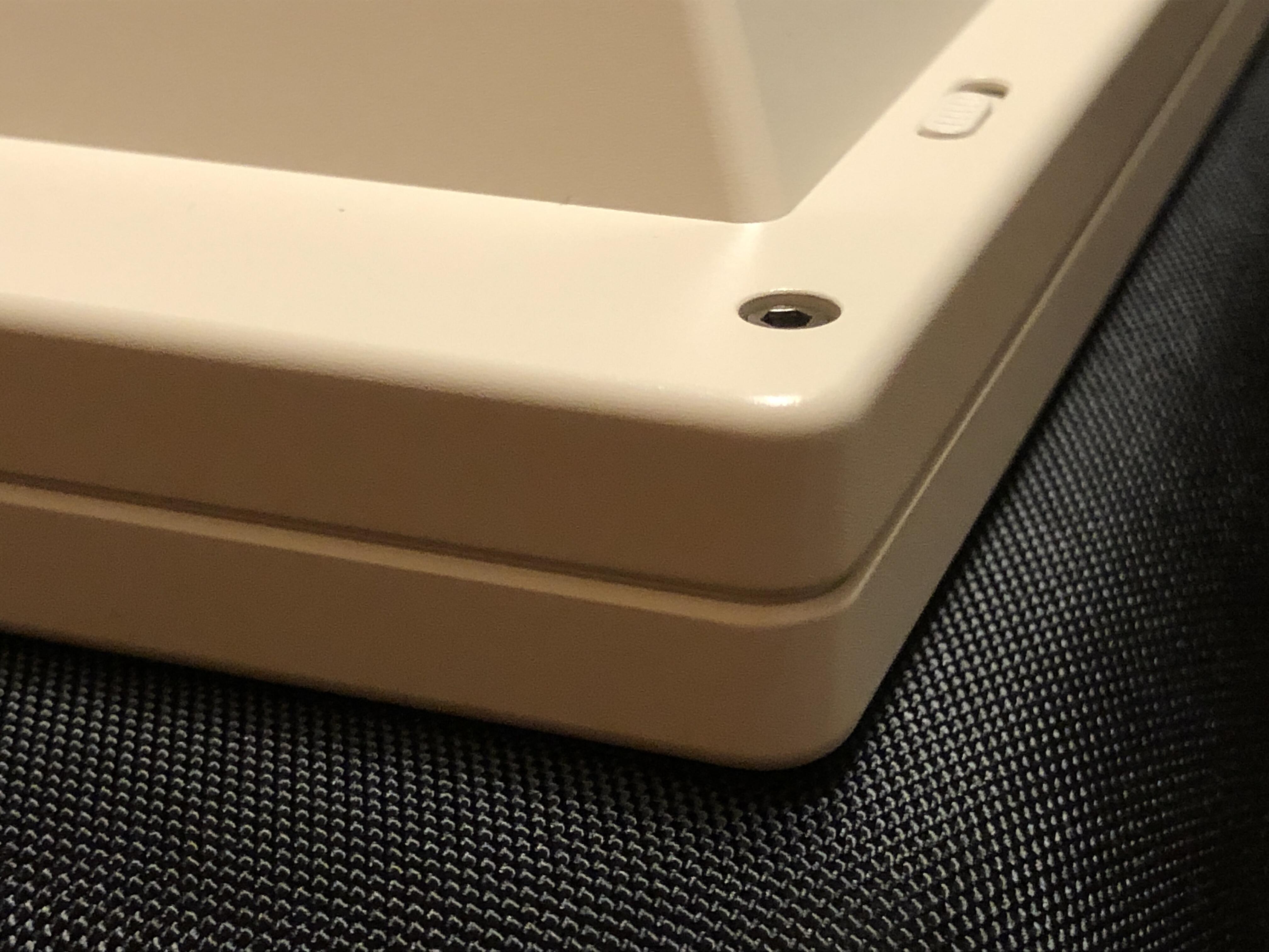

I’ll take some close-up photos of the case when I get home later (graveyard shift tonight).

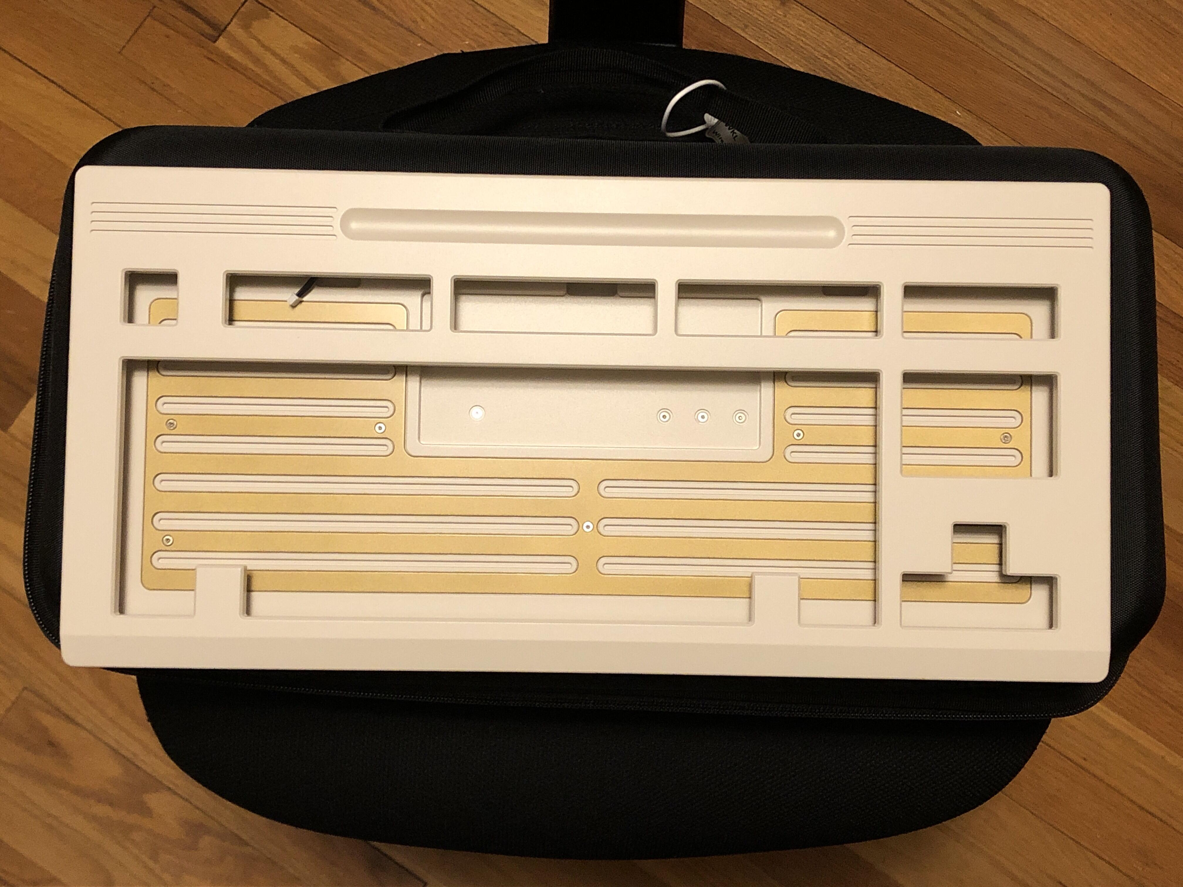

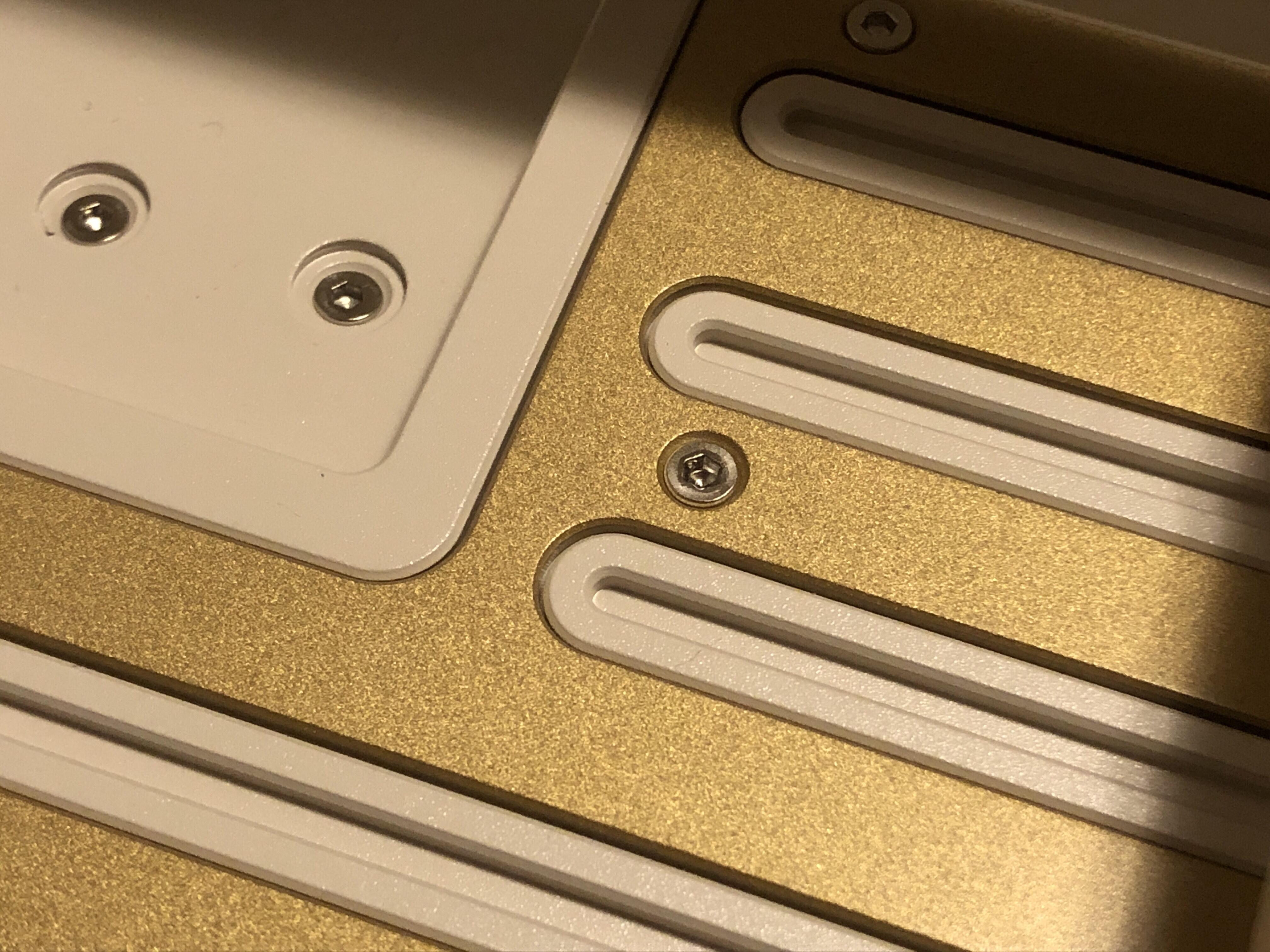

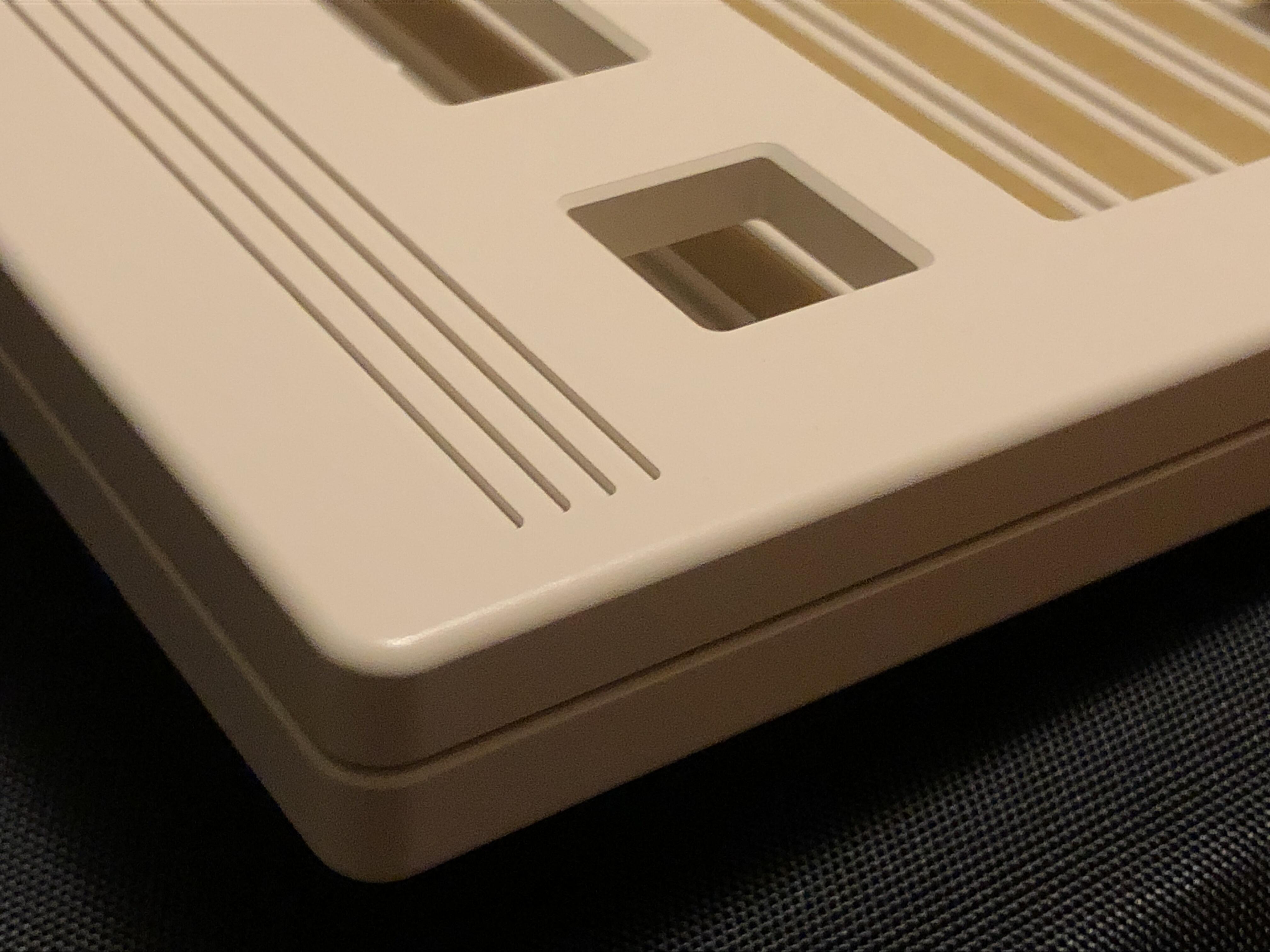

A few photos of my Class80's case
Goodness that is lovely :heart_eyes: thank you for taking those pics!
The choice with the extras is limited and shrinking :grimacing: I’m not sure if I’ve left it too late by dilly dallying
Whoa. Looks more like a tank than a keyboard.
Yo, it’s still available to order, right?
The quality of that board in your photos is surprisingly good to me. Seems well worth the price.
