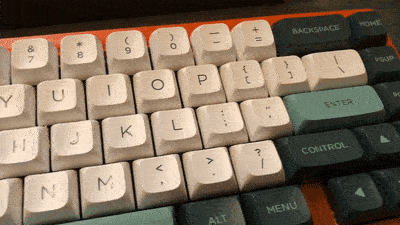

I think these are a PBT blend. The profile is somewhere between CXA and MDA. Quick comparison to CXA here.
Well, I think these look really nice! Surprisingly decent qua-
Facetiousness aside, these seem like remarkably decent caps for the price. Infernal homing-nips notwithstanding.
You might notice, though, that there’s a control key where the right shift should be, and a menu key where FN might be. That’s because this particular set came with two left shifts and three WIN keys.
But hey! It was cheap and looks pretty nice with this case, on this deskmat. The caps are pretty thicc and don’t feel or sound too bad at all:

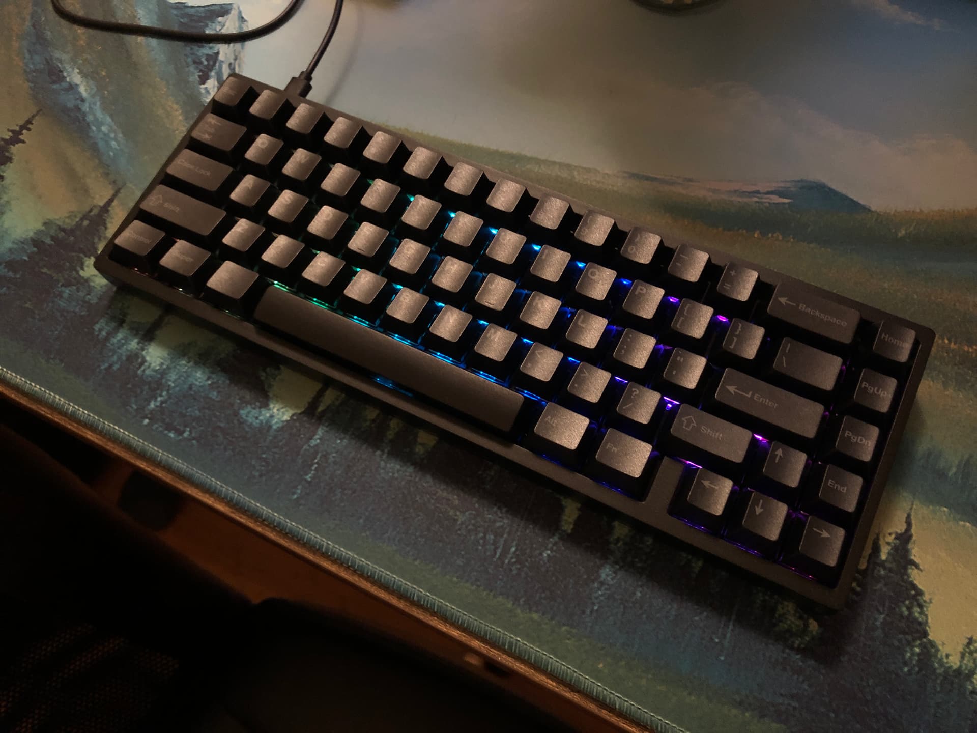

What it looked and sounded like earlier today:
KBD67L
- POM plate
- JWICK Semi-silent linears
- Cherry profile PBT dye-sub caps
- Owlstabs
- PCB foam
Same switches, PCB, stabs, case type, and foam setup - different plate and caps.
