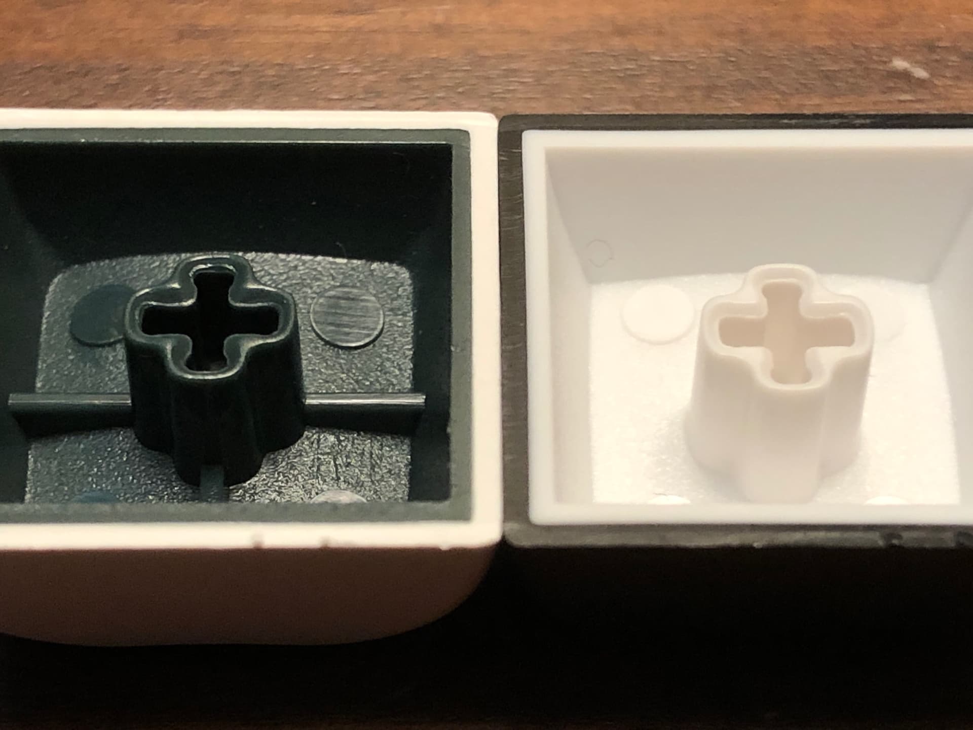

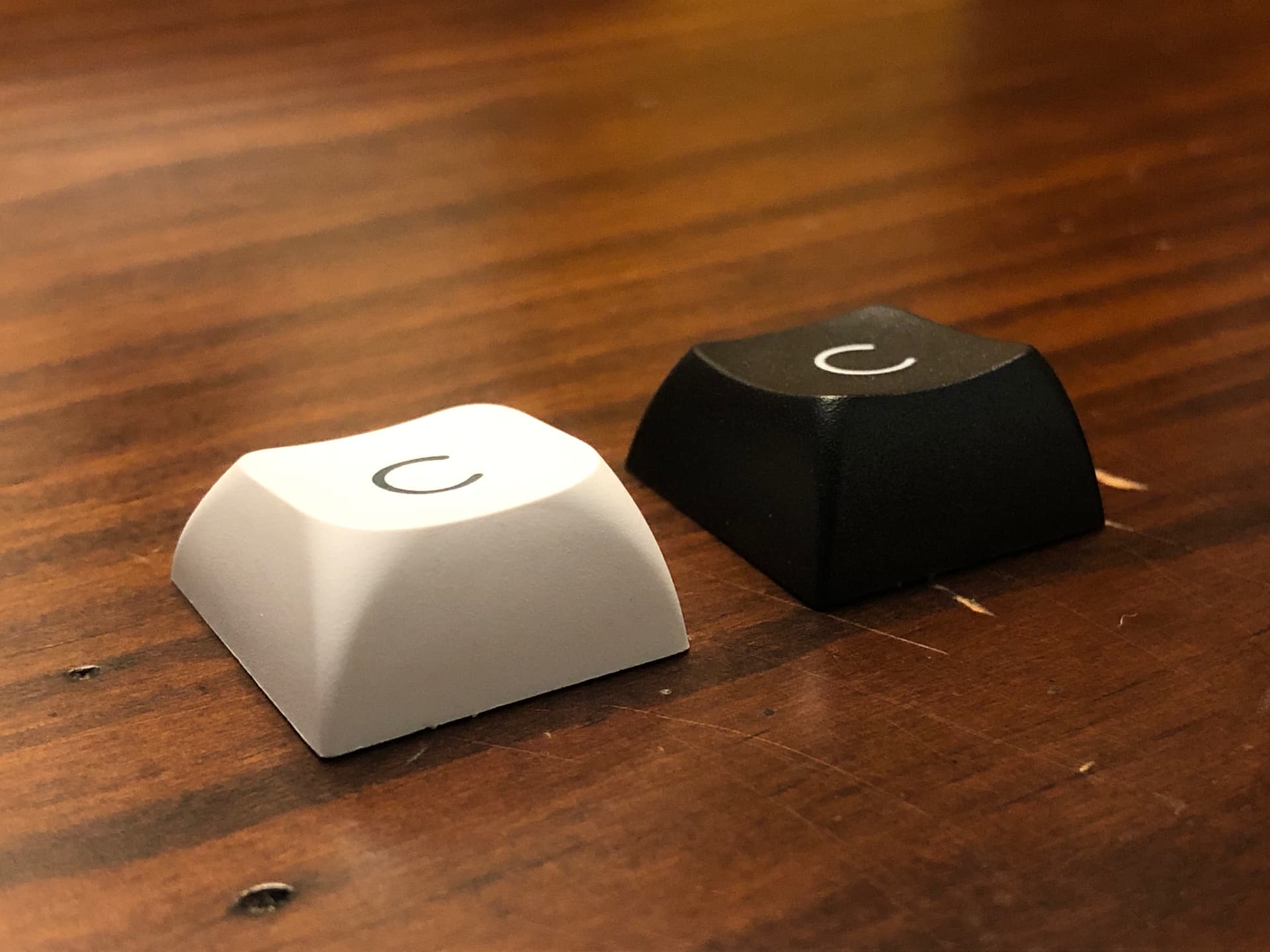

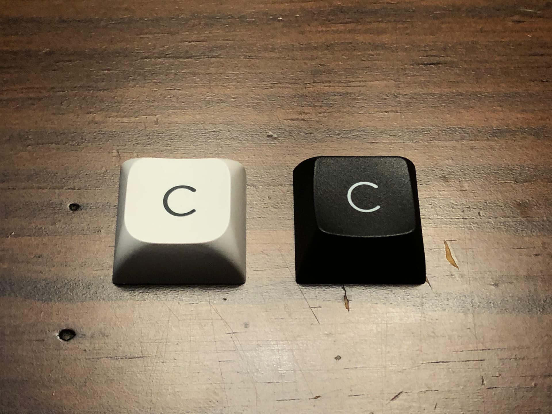

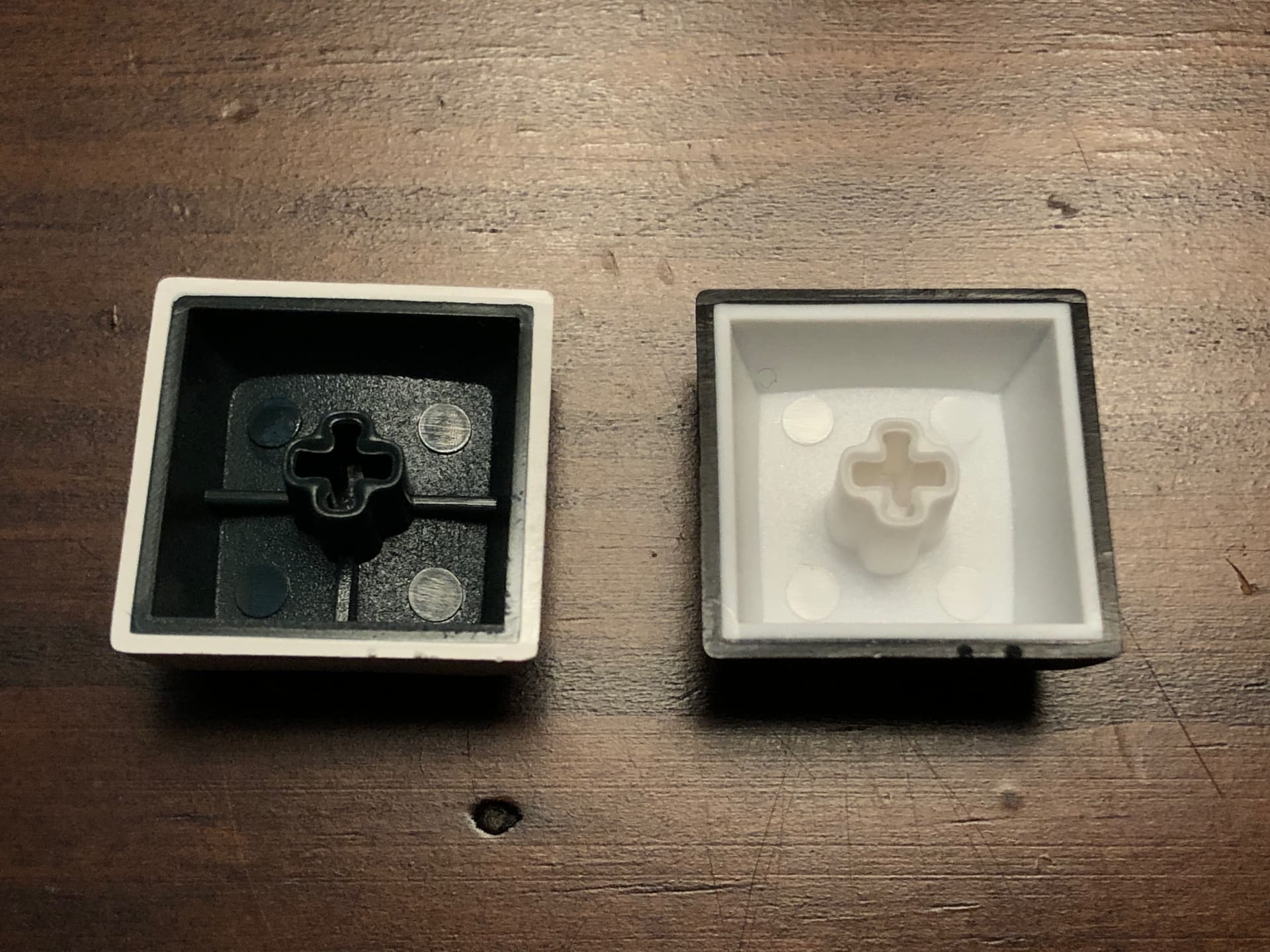

Okay! Comparing XVX to CXA directly…
They have some remarkable similarities…
…but are indeed not the same.
Neat.
Proving myself wrong aside, it is weird just how similar-but-not-the-same these are.
Definitely not the same tooling at all - but very similar features.
