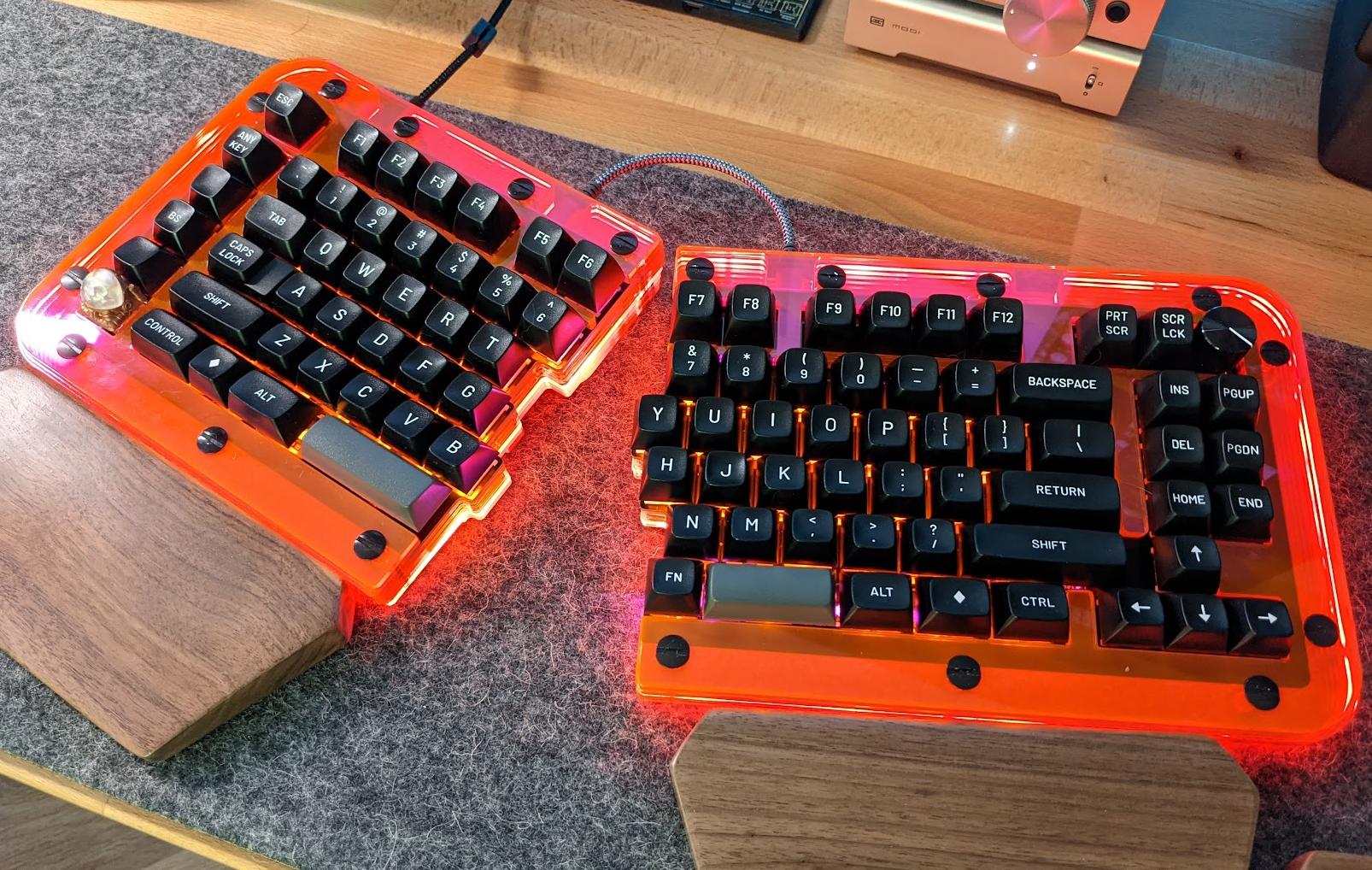

Finished my KBO-5000 today, which really just involved installed the short USB-C interconnect cable.
Build Details
- Keebio KBO-5000
- P3D stacked acrylic case, in high-vis orange.
- Drop MT3, white-on-black keycaps. Susawatari MT3 spacebars.
- Gazzew Boba U4 and U4 RGB switches.
- P3D switch foam.
Mistakes Made
This is the first time I didn’t go with sockets for hot swapping and boy howdy does my planning needs to be better.
- The bottom row was a real challenge for me as I could not find a configuration I liked. I settled on what you see here.
- I soldered the switch for the right space bar in the wrong location, but because I used stabilizers, and wasn’t willing to desolder everything, I ended up cutting the stabilizers out with the wire cutters then shifting the switch over. So no stabs there, and a lesson learned.
- I do NOT like the Function key to the left of the spacebar. I keep hitting that instead of the spacebar.
- Read the note too late that the 2.75U right shift wasn’t support by the case so I had to cut a portion out to accommodate the wider shift cap.
- The switch foam was a little too thick and made it really difficult to solder the switches in.
- The LEDs I used for the back lighting were a little big so they get in the way of some switches. I’ve been manually moving them out of the way where it matters.
Overall though, I’m reasonably happy with this. It’s a very quiet board, but loud AF visually.

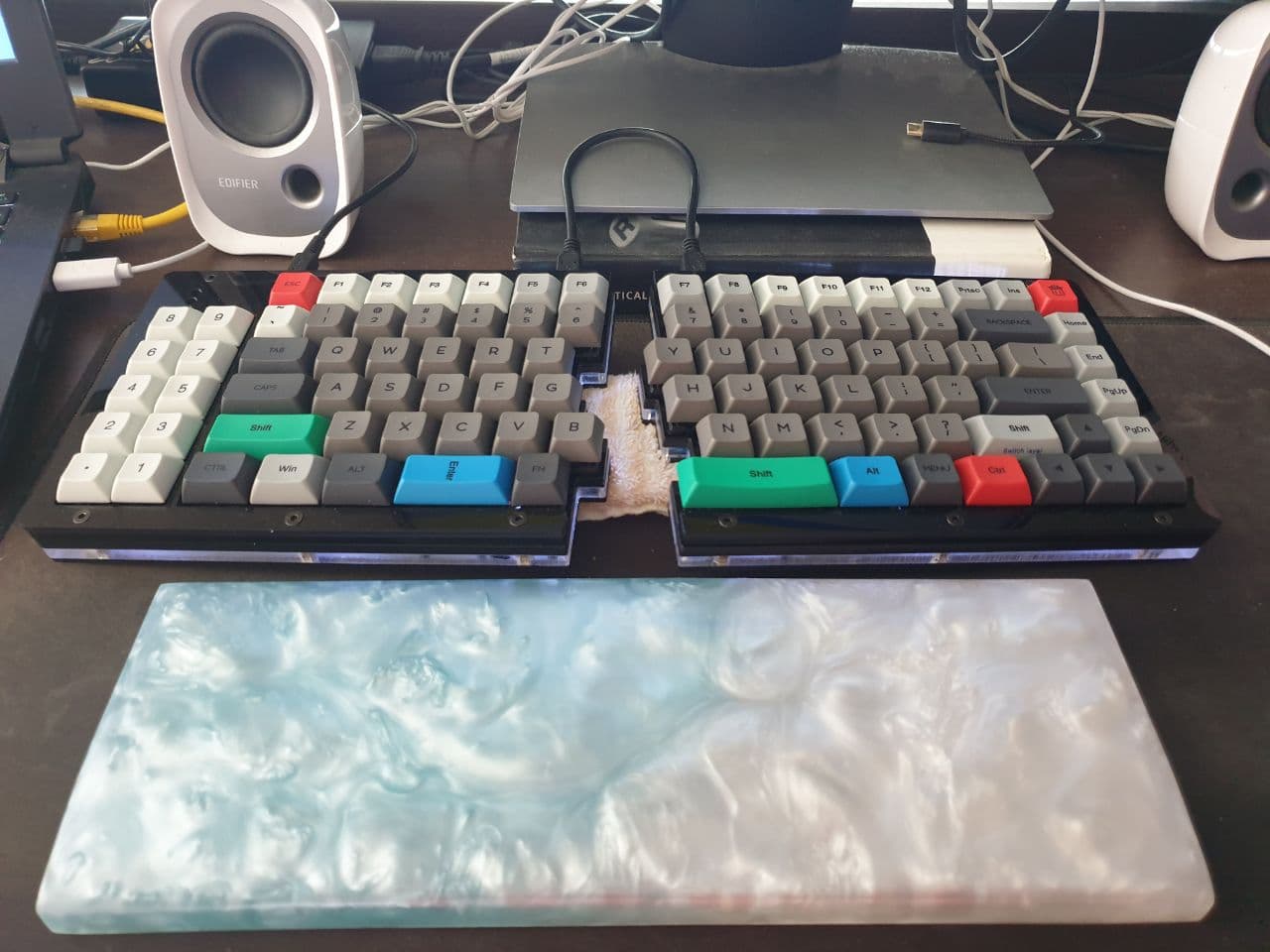

We ended up going for different bottom rows - I decided to put the FN key just at the edge of the left half as I tend to use my right thumb for space usually (a larger spacebar helps!) Plus with so many keys, there’s less need for layers, so the FN is usually used to activate macros and media keys
The keycaps are a mix of two profiles - my brother preferred my DSA keycaps (a DSA Granite knock-off) so I took his XDA keycaps instead. I think it makes for quite a nice visual aesthetic, accented with the colored mods. I was trying to channel some Bloomberg terminal keyboard vibes. Surprisingly, it’s quite comfortable having both DSA and XDA profiles on the same board.
As for the switches, they’re also silent tactiles (Aliaz 60g in Cherry Black housings). I think silent tactiles have the best of both worlds: tactility of mechs and the quietness of membranes ![]()
