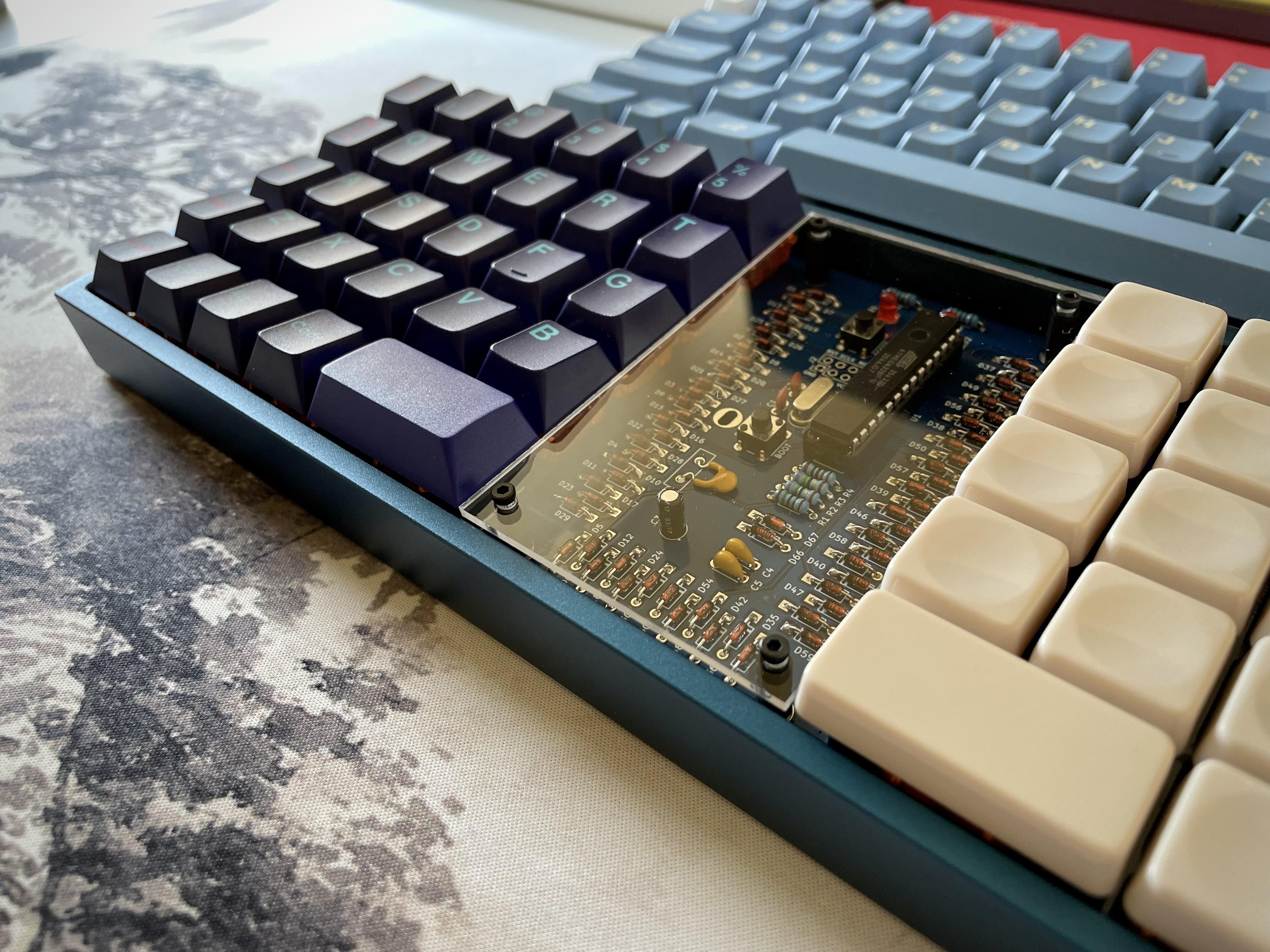

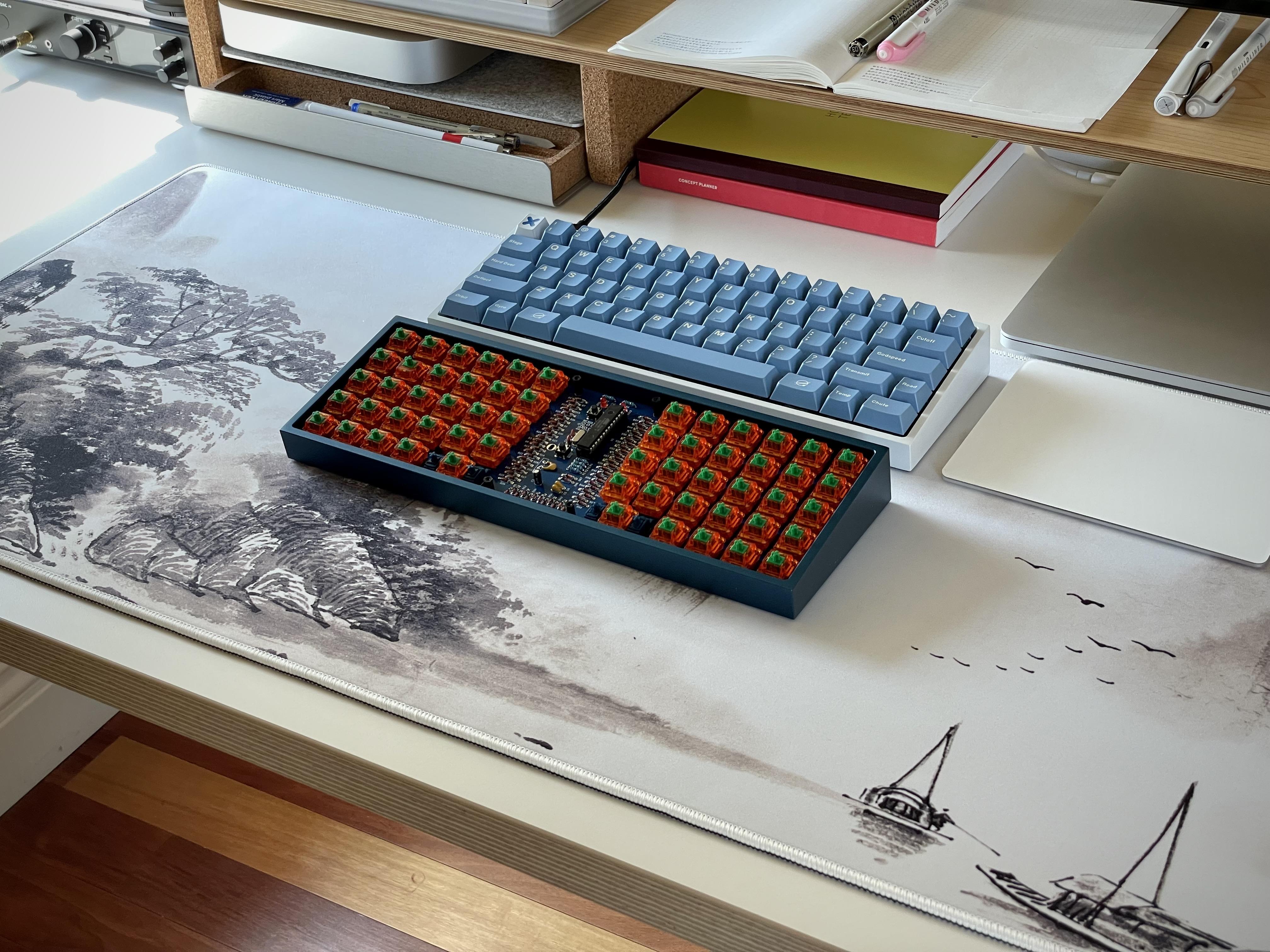

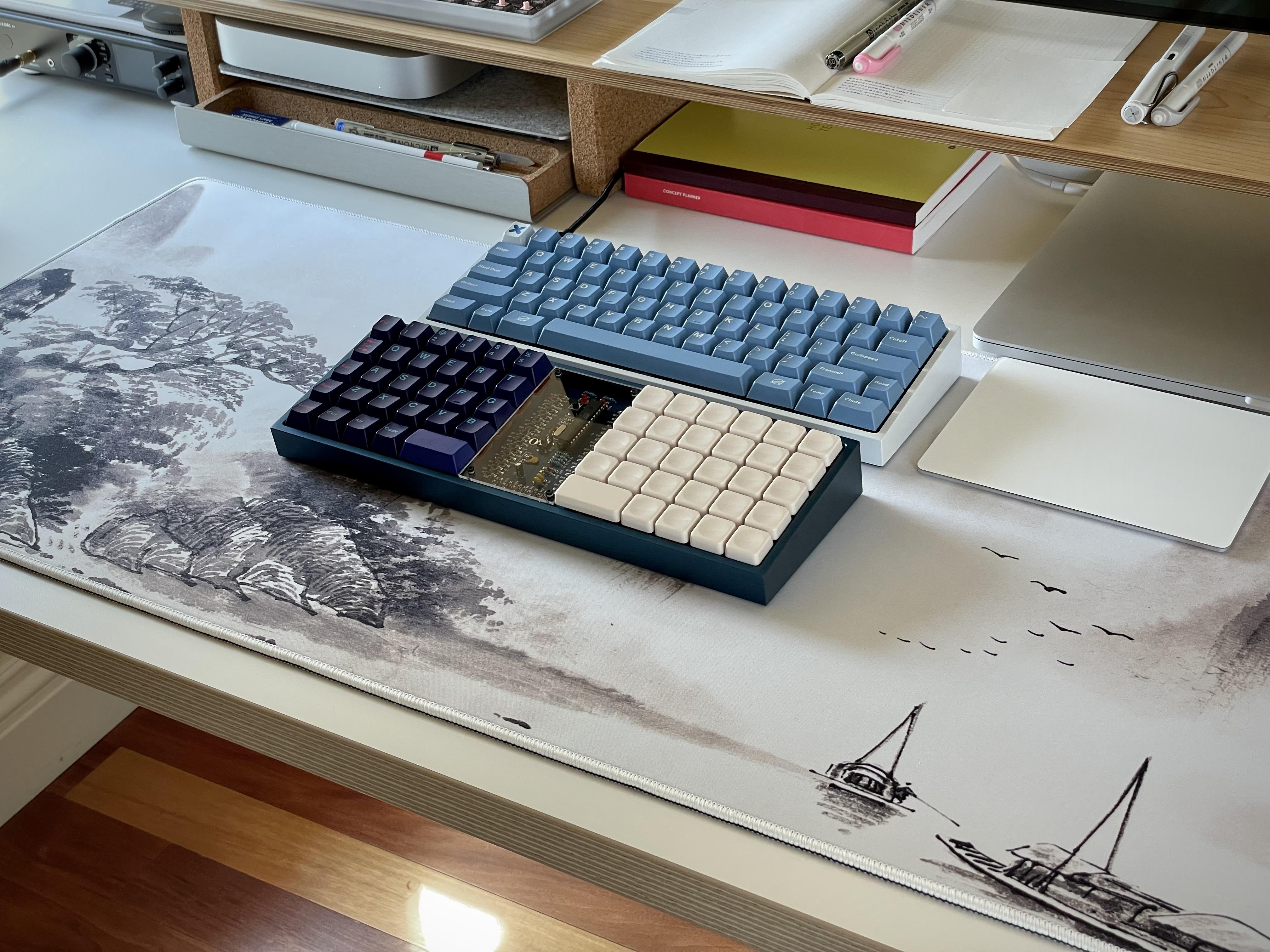

Finally finished @peejeh’s lovely through-hole kit, the Lumberjack.
I’m A/B testing sculpted (Laser) v. uniform profile (Grid) keycaps to see which I like better ![]()
Either way, it’s a such pretty board and a much improved ortho experience over the Preonic!
Build Deets:
– 67g Tangerines L/205g0 F/Deskeys
– Navy C³Equalz X TKC Screw-in Stabilizers
– Ultramarine Klippe T R4

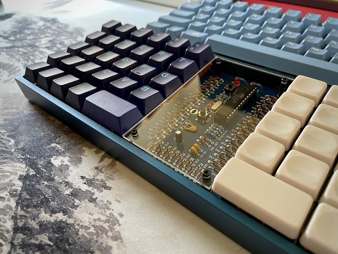

Nice! I see the PCB sits a little higher from the case edge than the Tofu, you might be able to align the component cover with slightly shorter standoffs although the C3 capacitor is the limit to how low you can go.
The grid caps look great but I’m not sure I could type on uniform blanks.
Ah, good call out. I may look into that, although now that I’m looking at it closely, the cover does lineup with the bottom bezel of the keycaps, which is nice too. Tradeoff, I suppose haha.
The blank uniform is interesting, particularly because there’s no homing key (oof!), but interestingly enough in the short time I’ve been running this board, I’ve been more accurate on the Grid side (and I’m a lefty, so it’s not even my more dextrous hand).
Could probably eek out a bit more height by soldering the cap with the leads a bit longer than needed and then tipping over too
