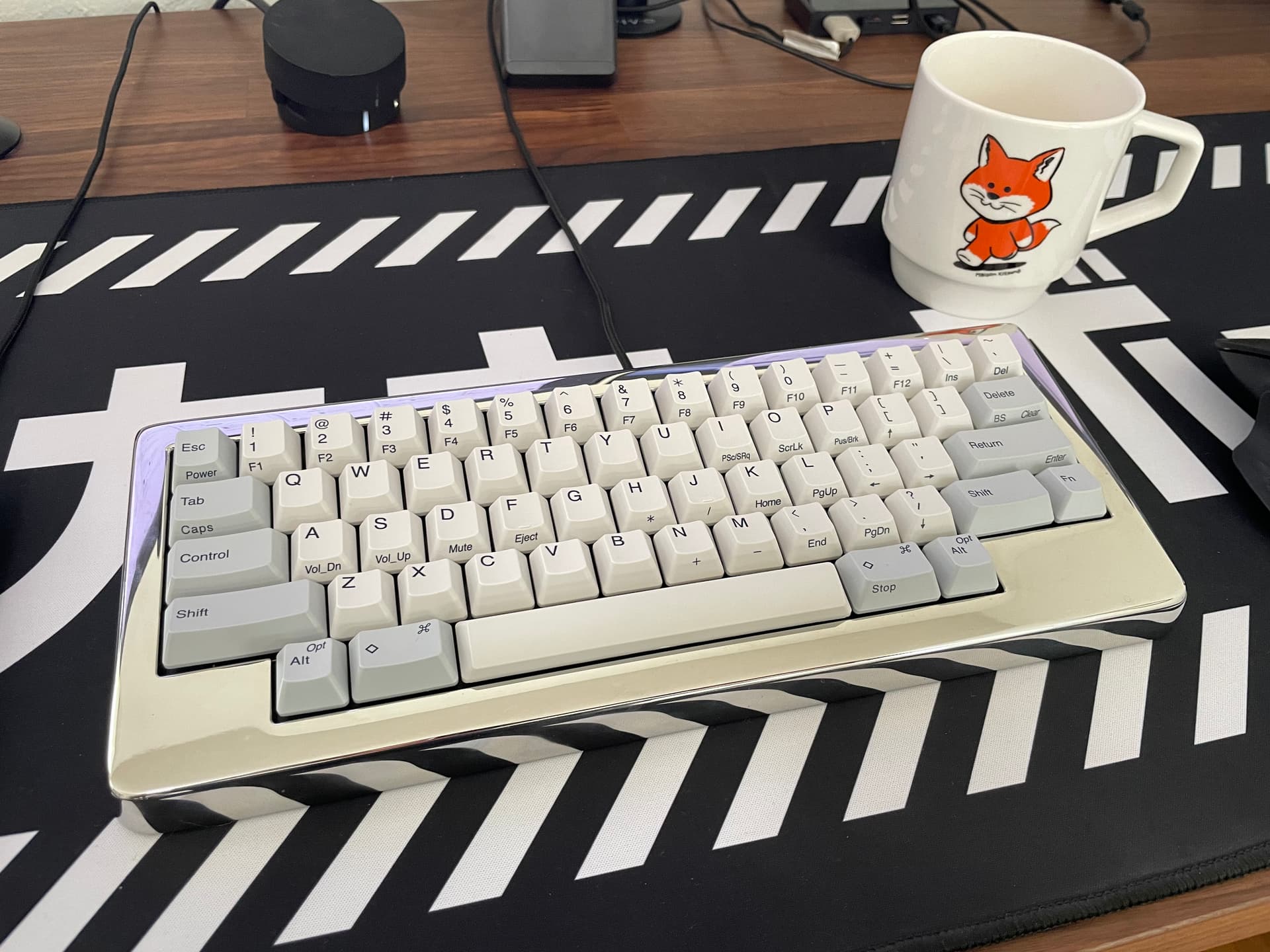

I think I’m super digging beige and gray keycaps on my grail instead of charcoal.
I like your grail a lot, but I also really like your coffee cup.

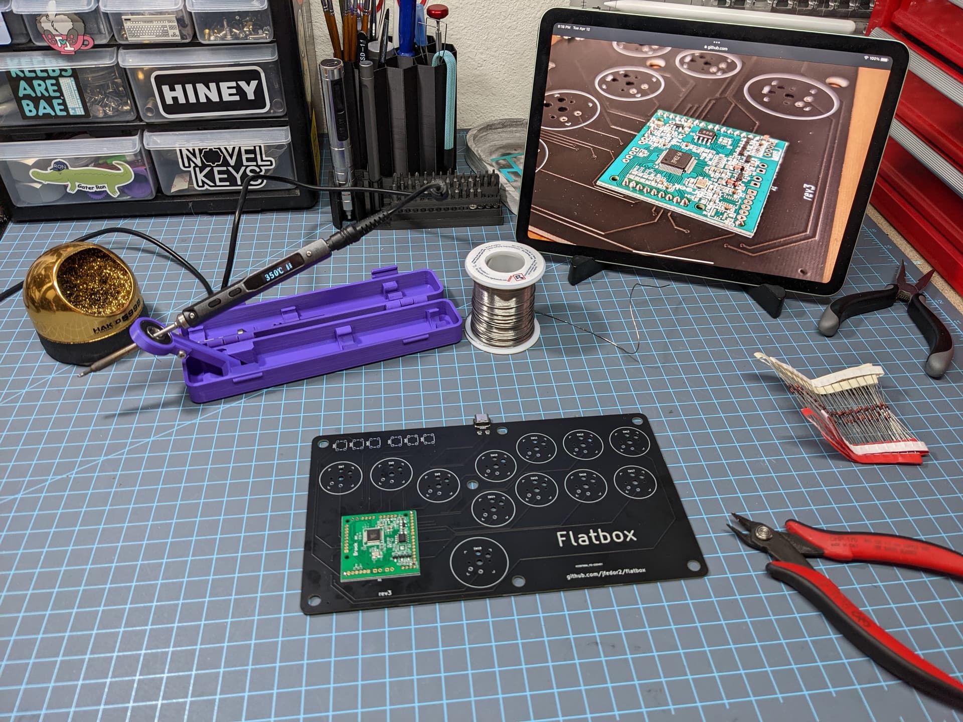

Woah that is pretty cool! What fighting game you planning on using it with?
Tbh, this just started as a cool project I saw online and just felt like making: GitHub - jfedor2/flatbox: Low profile hitbox-layout fightstick
I haven’t really played fighting games in a few years lol, so once this is done (just need to print the keycaps), I’ll probably try out guilty gear strive, or get back into street fighter, or granblue fantasy. Lots of options these days it looks like ![]()
Heard really good things about Granblue. I am tempted to get that Darkstalkers collection coming out soon. Not sure if it is a Switch exclusive or not.

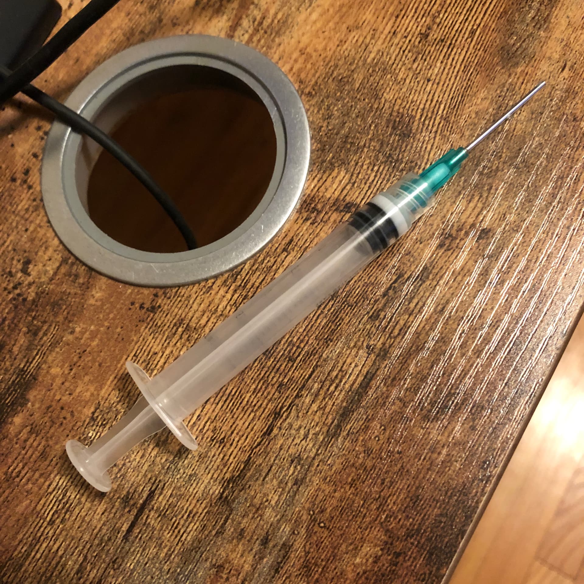

I also tried a new (to me) lubing-maintenance technique after finding my test keeb’s stabs too rattly for switches this quiet - and hey! It’s working out really well so far - quick and easy, but more importantly, they sound nice. Mmm. feelsgoodman
I think I’d originally lubed these with a relatively thin coat of 205g0, so I used a pipette syringe to place some more where I wanted it. This was with switches in and caps off, stabs still in the board, washers still sitting on the stems. I just placed the board on its front and then back side, squirting a dab above the wire on the side where it comes out, and pretty much all around it on the other.
I almost feel silly because this is simultaneously the easiest and most effective method I’ve used - what? no, Windows, I do not want to turn on Sticky Keys, thank you - but of course time will tell how long they continue to remain more quiet than silent switches.
If they start to tick after a couple days like my light application of BDZ did, I’ll let you know - otherwise I think this is how I’m gonna do it from now on… I think I’ll have to try it on a set of dry stabs next, and possibly with other lubes. I know dielectric grease will flow through the pipette, but IDK abt BDZ.
That’s been my lubing method for about a year now. I’ve never had such consistently good results as with 205g0 in a syringe. It’s more forgiving with over-lubing too, which is nice because that’s a habit of mine.
