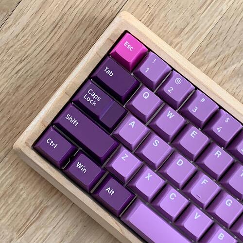

Daily-driver M60-A LNY20
Thank you so much. I’ll dig a bit further in the topic and buy some different ones. To find my taste.
That’s a gorgeous looking setup!

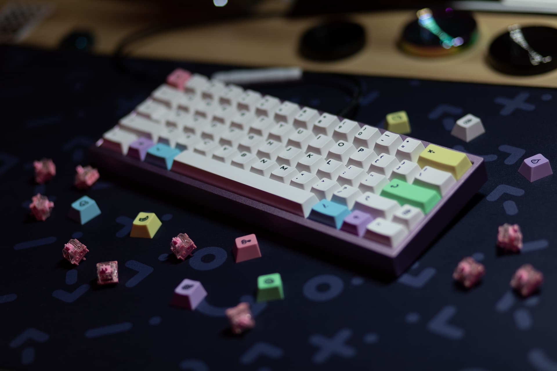

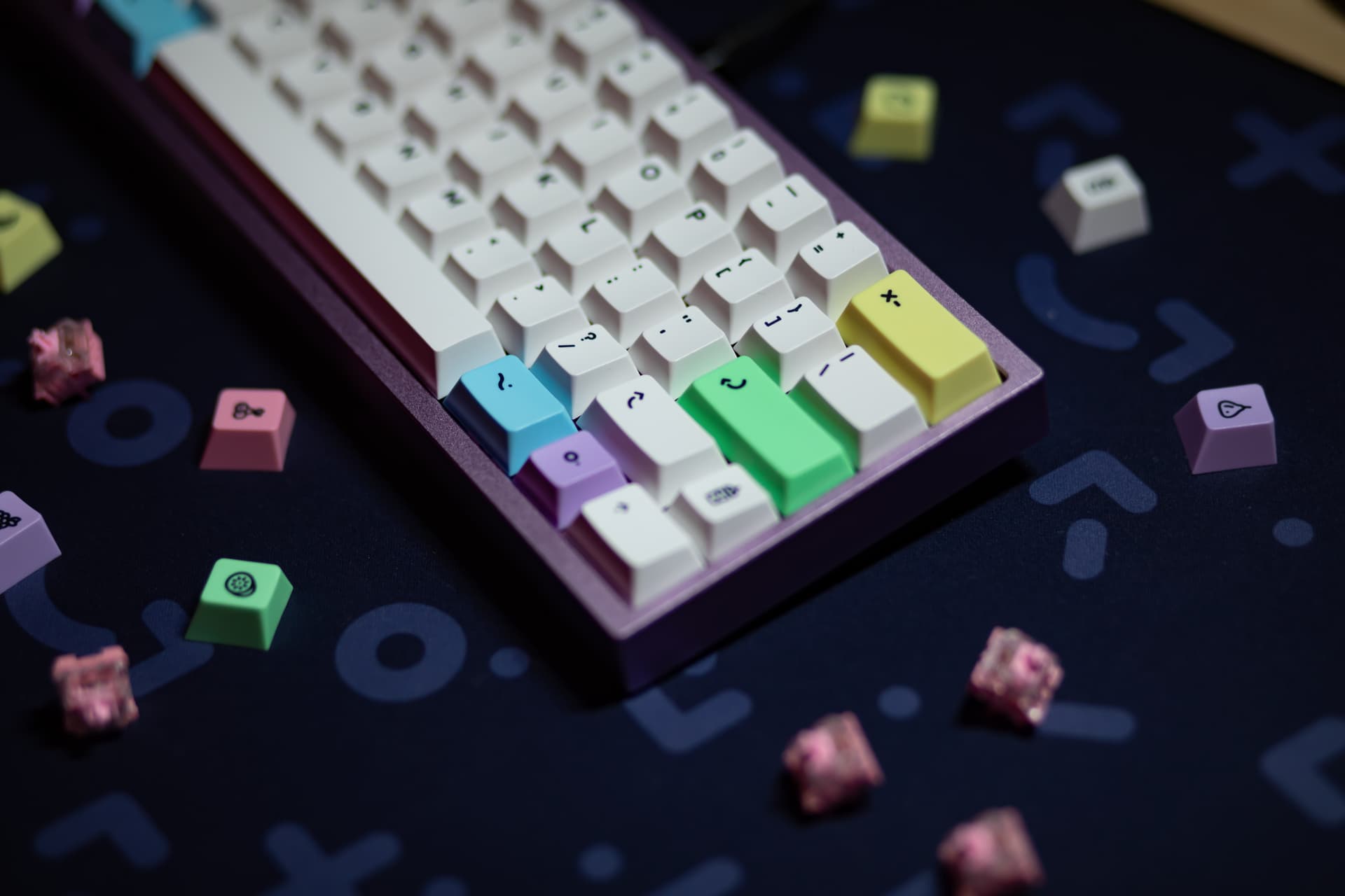

YT short of my current Sat75 build. Penyu switches on CF have an air-y clack to them which I’m not used to, but have grown to really love. Switched the springs to some 63.5g two-stage slow springs lubed real well with krytox 105. These are the first switches I’ve spring swapped and the difference is night and day. I feel like I’ll want these springs in all of my linears.

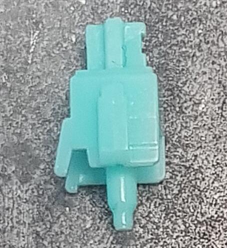

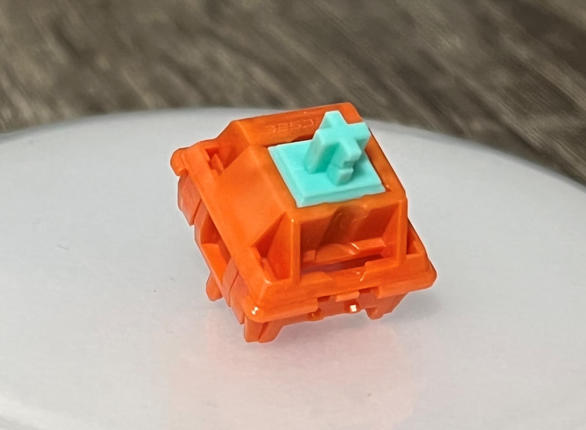

I’ve been using Tecsee Carrot today, and I noticed there’s not much info on this switch aside for some vauge reviews, so I’ve decided on writing a short opinion.
TL; DR: The Tecsee Carrots are great for their price, which goes $26 for 70, noticeably smoother than KS8 Gat Yellows, and have excellent off center smoothness, stem wobble is not on par with top switches but is decent.
I’m sure it’s an overall better switch than most of the market linear.
I should note I’m not a linear fan, I only have 1 board with Gateron Yellow KS8, so smoothness isn’t something that’s important to me as, I’ve used the Carrots stock.
In terms of smoothness:
Those switch are great, I don’t have much to compare to but they’re definitely smoother than well used stock Gateron Yellows KS8, or Gat Yellow KS8 lubed with probably-not-genuine-GPL105 oil I got from KPRepublic, which I had both on a board.
When trying to compare them to switch samples I have:
They’re smoother than Akko’s, Gateron KS8 and the Milky, about as smooth as Polaris Grey but much better off-center.
But not as good as Durock POM/Linear, Boba Gum, Ink Blacks or Aqua Kings.
*They are factory lubed, I didn’t open more than 2 switche but it seems thin, in comparison Durock Linears are socked.
Factory lube is great, I’ve yet to test how it fares with lube, but it’s already seems much better than JWK’s terrible factory lube.
Stem wobble:
It’s decent, when compared to higher end switches such as Durock POMs/Linear line they’re infirior, but better than budget switches such as Gat yellows or the regular Akko CS line.
Despite the price diference, the Ink Blacks and NK Cream wobble is worse, while the Akko CS switch with the boxed stem is better.
Stem is long pole and prodruding, no interference when north facing with Cherry profile.
Off Center press:
I’d say it’s excellent, better than most linear switch samples I’ve tried, only ones better are the Durock POMs, Boba Gums, and Ink Blacks, but not by a huge margain, at least from my experience.
This makes for a very enjoyable typing experience, it’s importance is not that far behind smoothness, the lack of off-center resistance like in a lot of switches makes it feel significantly smoother and actually lighter than it’s reported bottom out force (67g).
Sound:

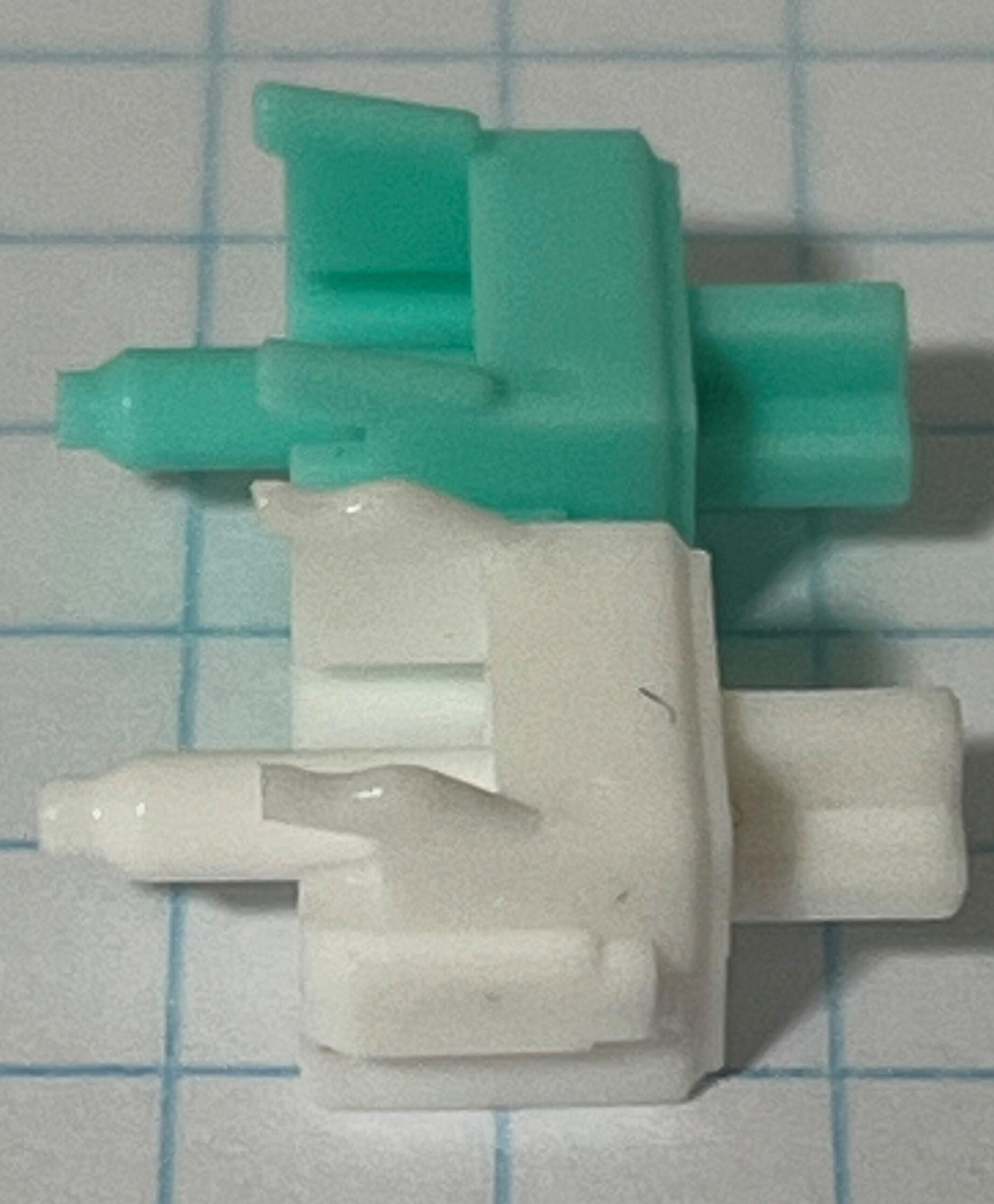

This is where it gets tricky, the sound is nice, it’s a long flat bottom stem on a PME housing, but past versions had a rounder stem that had marbly sound while the flat stem producing lower pitched sound.
Compared to an older Purple Panda pack I have which leans more towards the marbly and higher pitched, which I prefer.
Also, some switches have a tick when typing on them, every switch made have a sound of the stem hitting the housing sides but the PME housing producing sounds similar to stab ticking, not all switches have this but I do notice it on some random switches, I’m sensetive to this kind of sounds though.
Pricing:
I think they’re great for the price, I got 90 for $26 on an AliExpress sale, original price should be 70 for $26.
They perform better when comparing against other samples of more expensive switches.
