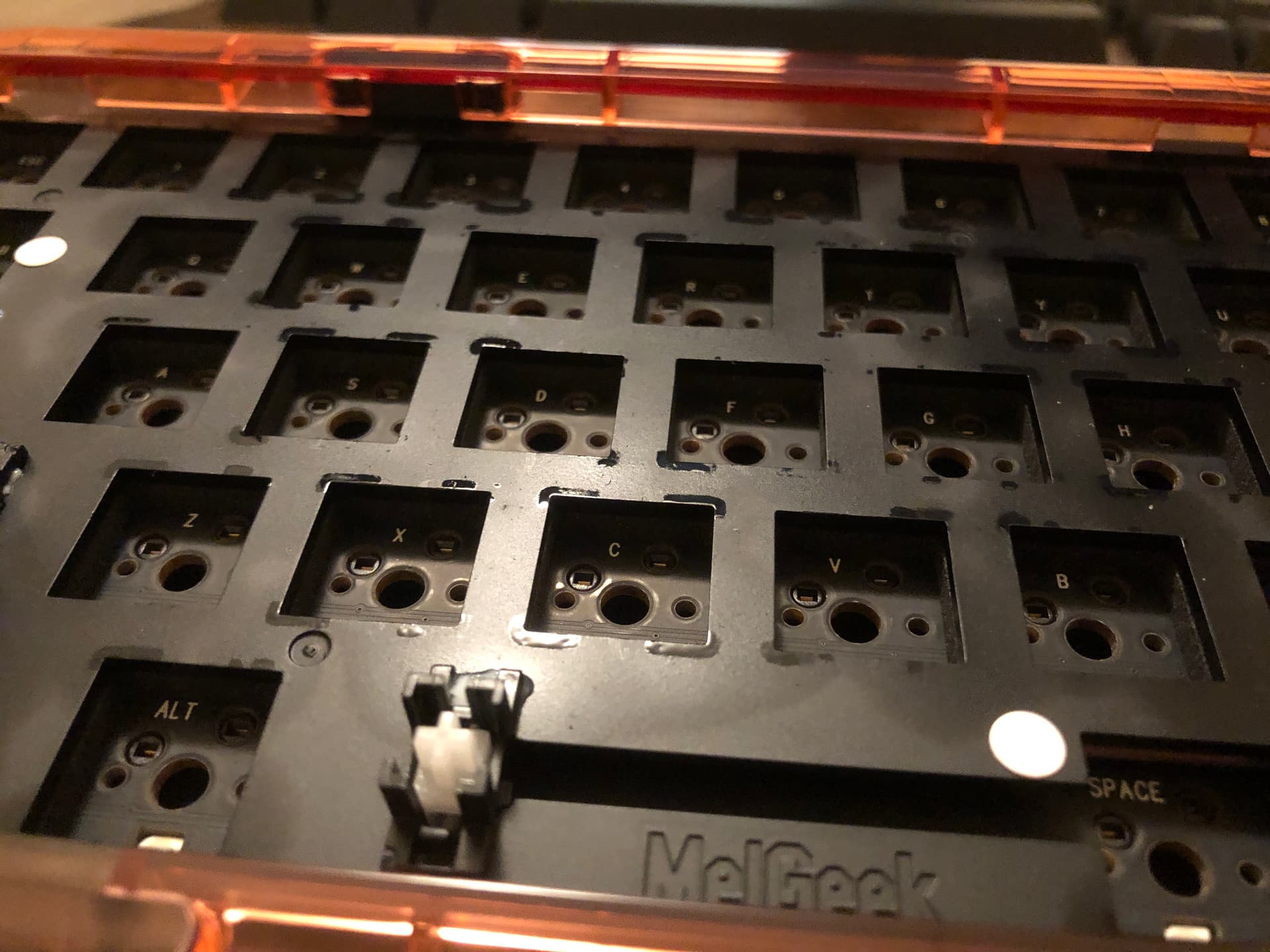

Can confirm about Gat Pros - aftermath of removing Yellows from the Mojo:
That’s one moist plate

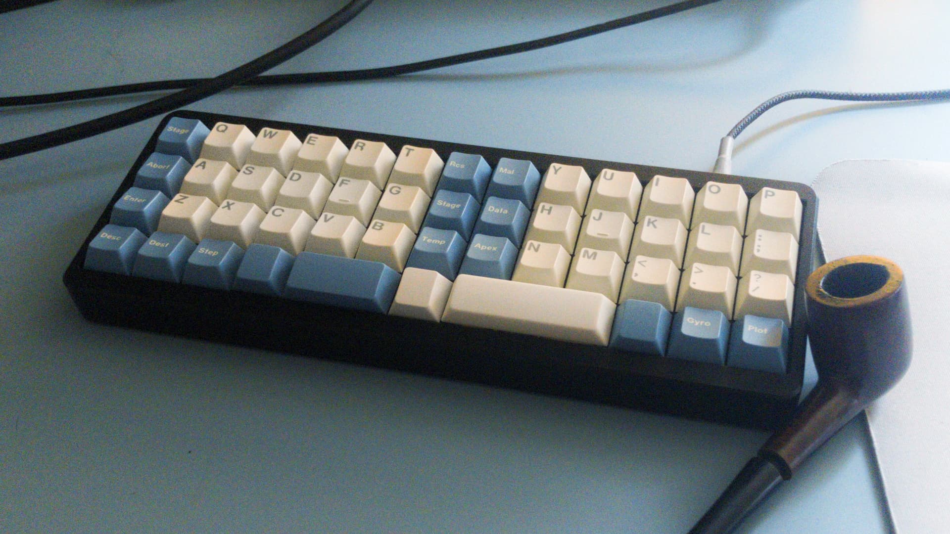

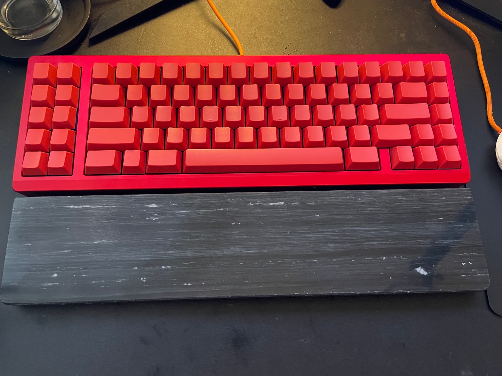

Oh, 13x4?
Indeed! Makes for some interesting layout options.
It’s an ortho pcb for minivan cases (12.75), so the key spacing is a little squished. If I use a 7u space I need to use shaved keys to the right and left.
Thanks — where did you get it?
Still trying to get used to the tactility of bobas.
It’s not plugged in since I’m taking a break back to the world of light linears. It feels so different, and my typing speed immediately loses 20-30wpm when typing on my e8.5.
Originally on rainkeebs.mx, it’s a Minibaen. It’s now open source and easy to have manufactured:
Thank you so much, this might just save me from doing a PCB from scratch.

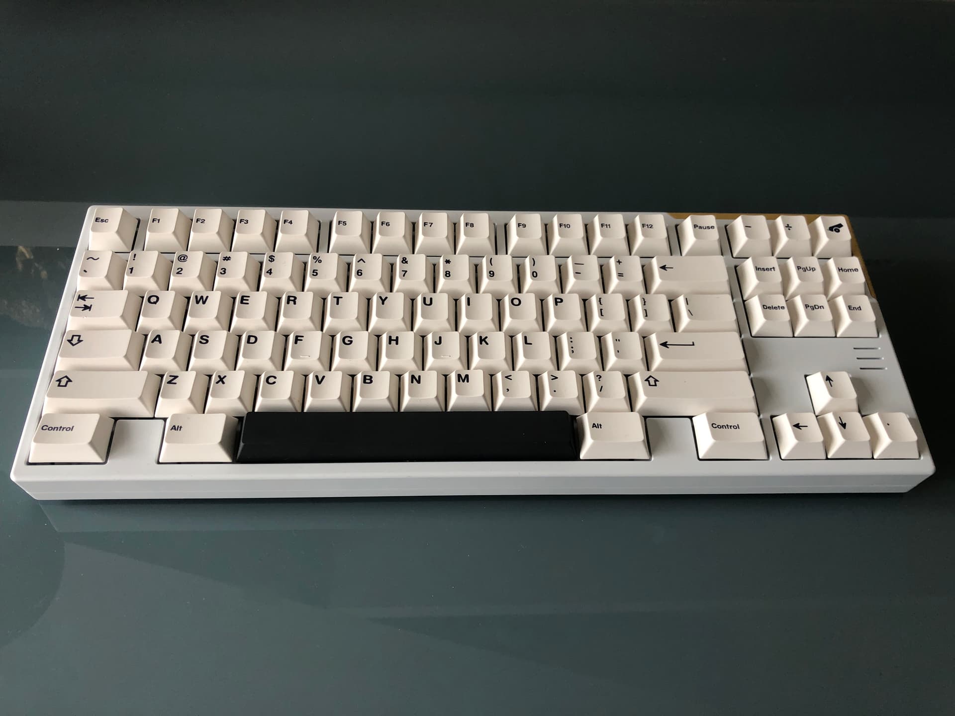

I was not liking the sound or feel of the dcs caps on this board, too rattly for me. I swapped them out for red riot. I like the blanks for this form factor because I can have the f keys on the left but they can be the correct row profile, but I forgot the reason I haven’t used this set much is because sorting blank cherry profile caps is a pita. The story I heard when these shipped was that they are actually double shot with the same color and JTK had to sort them by had and basically said “never again” and won’t do blanks again. I like the way this sounds and feels a lot better.

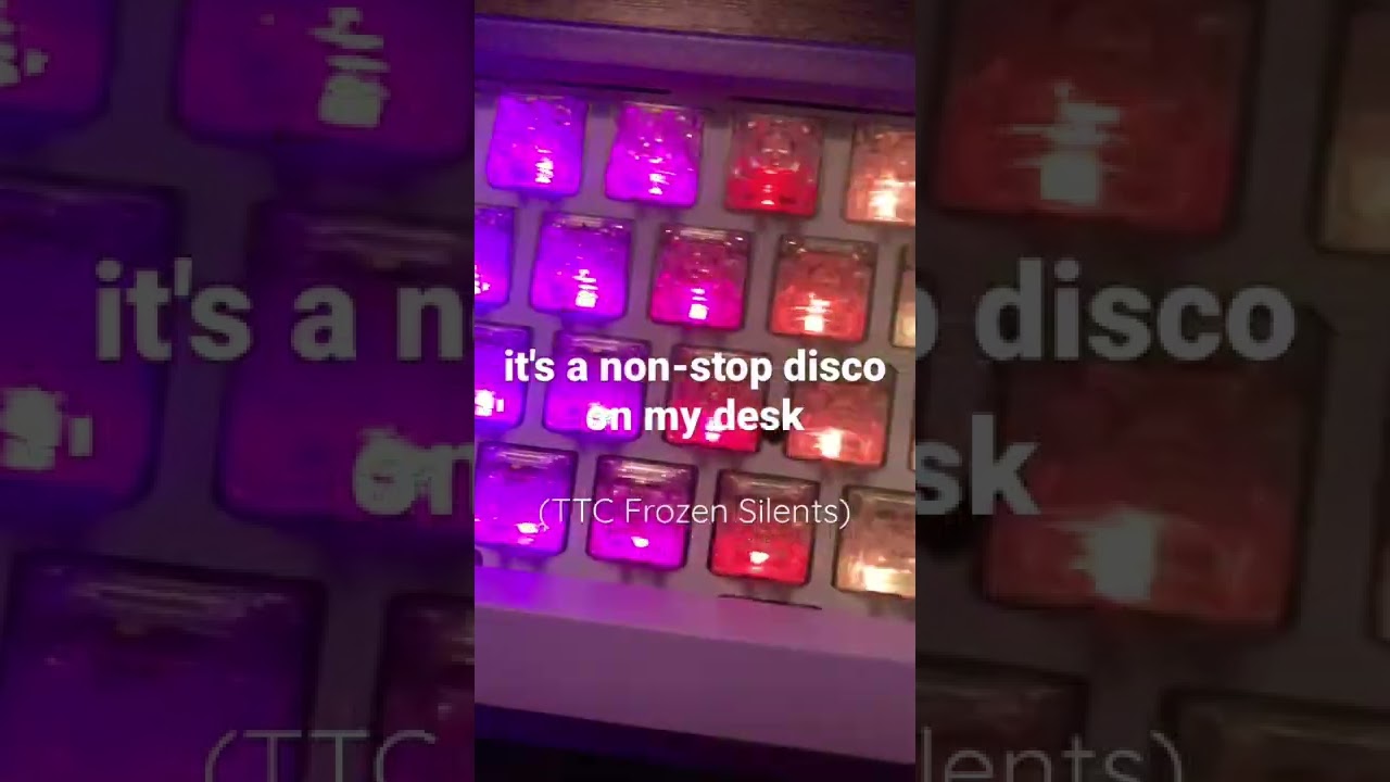

Trying out some new switches; sound recordings in a bit, couldn’t resist sharing the dance party.
Edit: here’s a recording of them in the Portico:
If you hear ticking, that’s actually my un-tamed fingernails that need trimming. ![]()
These TTC Frozen Silents are really quiet silent linears; performance is pretty comparable to the Deep Seas - maybe a touch softer / more quiet, but quite a bit more firm than a Bobagum.
I’m guessing the stems are polycarb; most of the keys wouldn’t stay on them without a touch of PTFE thread tape on the cross-mount - that did the trick, though.

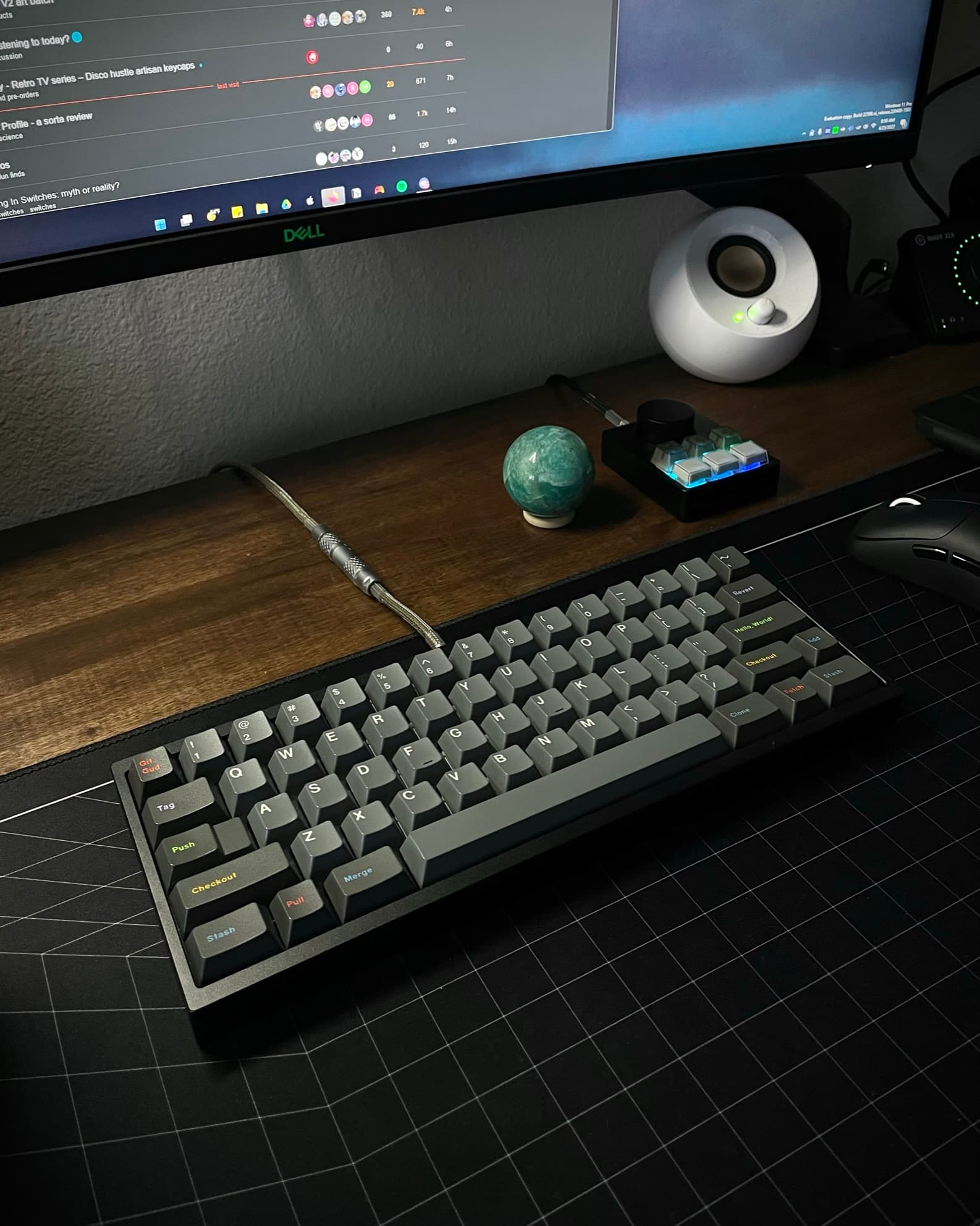

Added a Ciel to the family. First intro to gummy o-ring mount and it’s a really nice one. If you have stabs/switches ready, this is such an easy to assemble keyboard. Love it
Wow, looks even better than the pictures in the product page! May I ask how you got one?
Mechmarket
A bit more than I wanted to pay for it unfortunately, but it did come with some stupidfish foam, an extra FR4 plate, extra o-ring, and it got to my doorstep 2 days after purchasing since the seller wasn’t too far from me–so I’m not too mad! Little gift to myself for landing a new job.
I know you’re still on your hunt. Hope you’re able to snag one somehow! Would recc. inquiring in the discord if you haven’t already. A seriously impressive board for the price.
