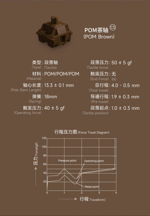

Finally getting around to putting these in a keeb and typing with them - Akko POM Browns
I’m hekin’ impressed. This will be the next switch to get the full review treatment from me, but I can tell you now this is already one of my very favorite light tactiles. I’d call these uncommonly clean for the style, especially considering the POM housing - and this applies right from the package.
So far I’m getting the impression that most of the headlines / video titles I’ve seen about these are correct; “better brown” seems an apt description so far. When these first came out I really didn’t think I’d like them - but darn if they’re not a new favorite. I probably would have picked KTT Mallows as my favorite stock light tactile - but unless I find some unexpected deal-breaker about these, I think I’m going to have to give that honor to the POM Browns now.

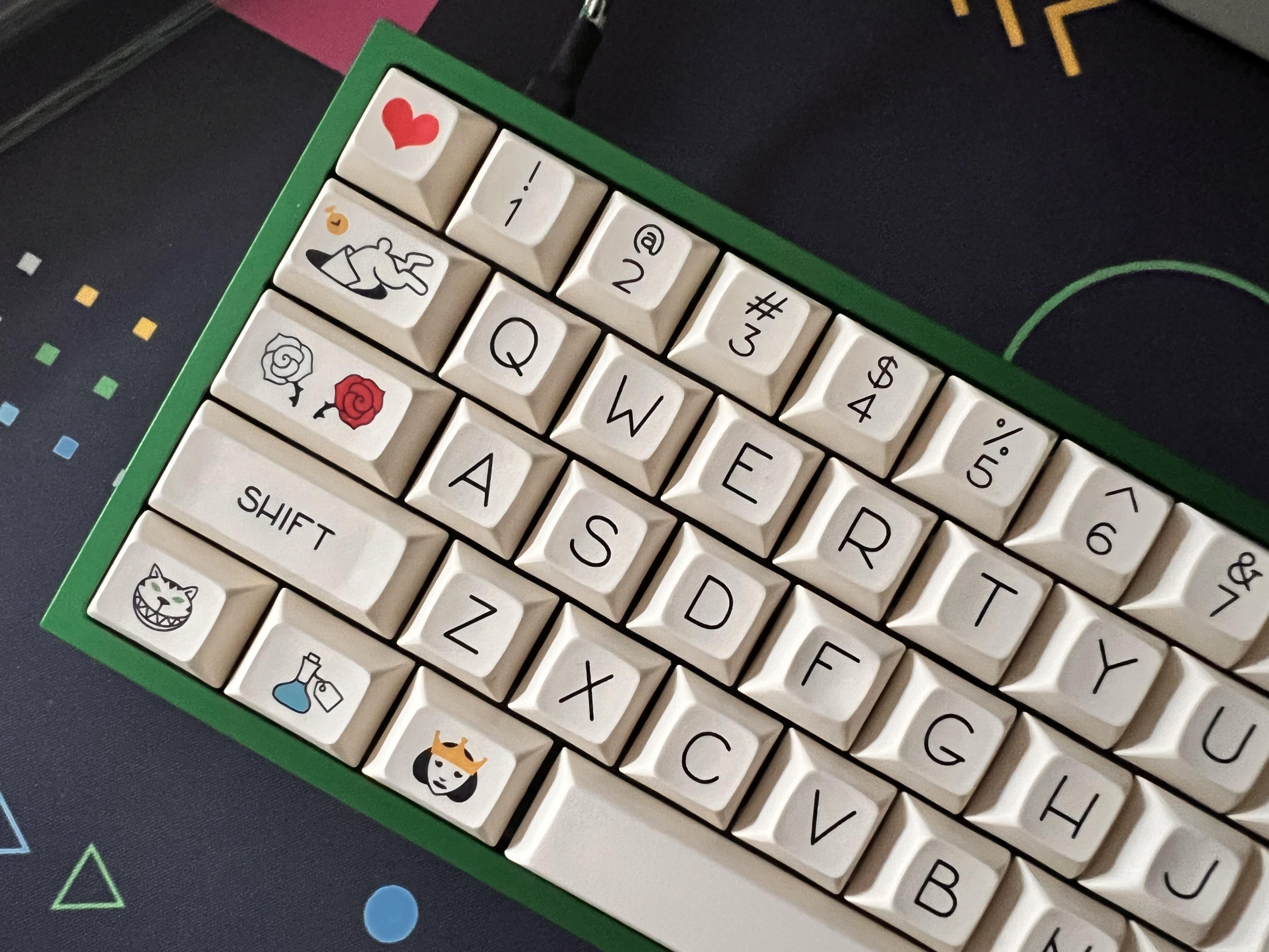

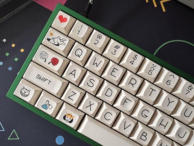

I’ve been wanting to get Unalice since it was in pre-order. Found someone selling at a criminally low price on mechmarket. So happy I snagged it!
The legends have such a classy art deco vibe and look perfect on DSA. Very nice.
I like the font on that one. Kind of a whimsical Gorton like font.
It also shows off something we don’t see too often: SP’s awesome dye-sub chops. I remember Norbauer talking about it a few years ago but I hadn’t really seen much SP dye-sub (outside of SA-P) but since then I’ve come across this set and DCS Delftware and they do a really nice job.
Yes, they can’t do all-over (or reverse) dye-sub and yes, “they ship in bags” and yes, the SA queue is 2 years at this point but what they do do, they do really well.
