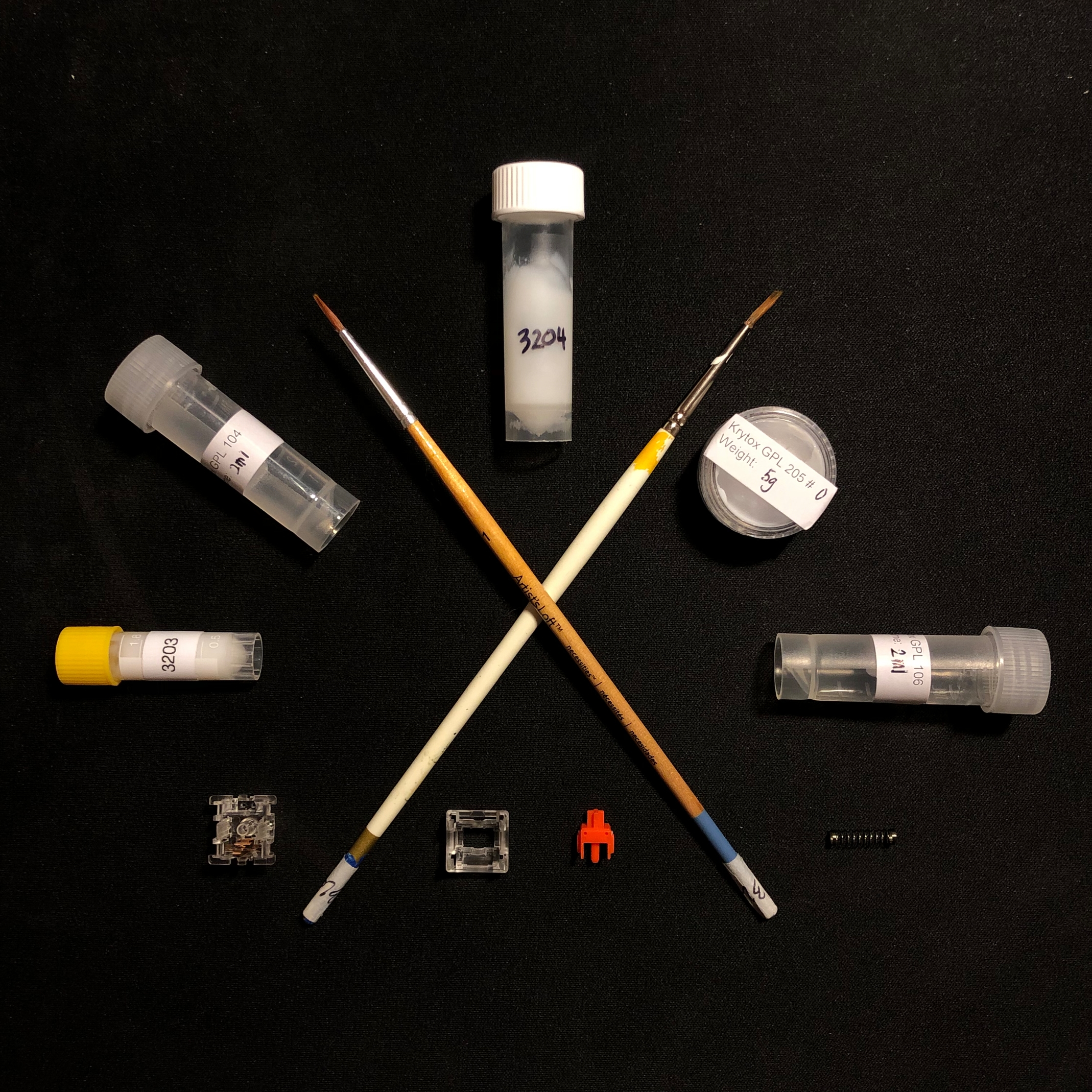

To answer the original question, I keep 3203, 3204, 205g0, and 105 in my regular selection. I think they all have their place - 3203 and 3204 I find to be slightly more finicky to work with than 205 but is still relatively approachable. I also find that they have the least influence on the sound of a switch, whereas 205 will almost always lower the sound profile. It’s great for taking a good budget switch like a Gateron milky and making it really, really good.
For springs, I’ve used both 105 and Gazzew’s “donut dip” method and found them both to be pretty effective. I’d still like to do a side-by-side with a couple of crunchy springs to see if there’s a clear difference between the two.
