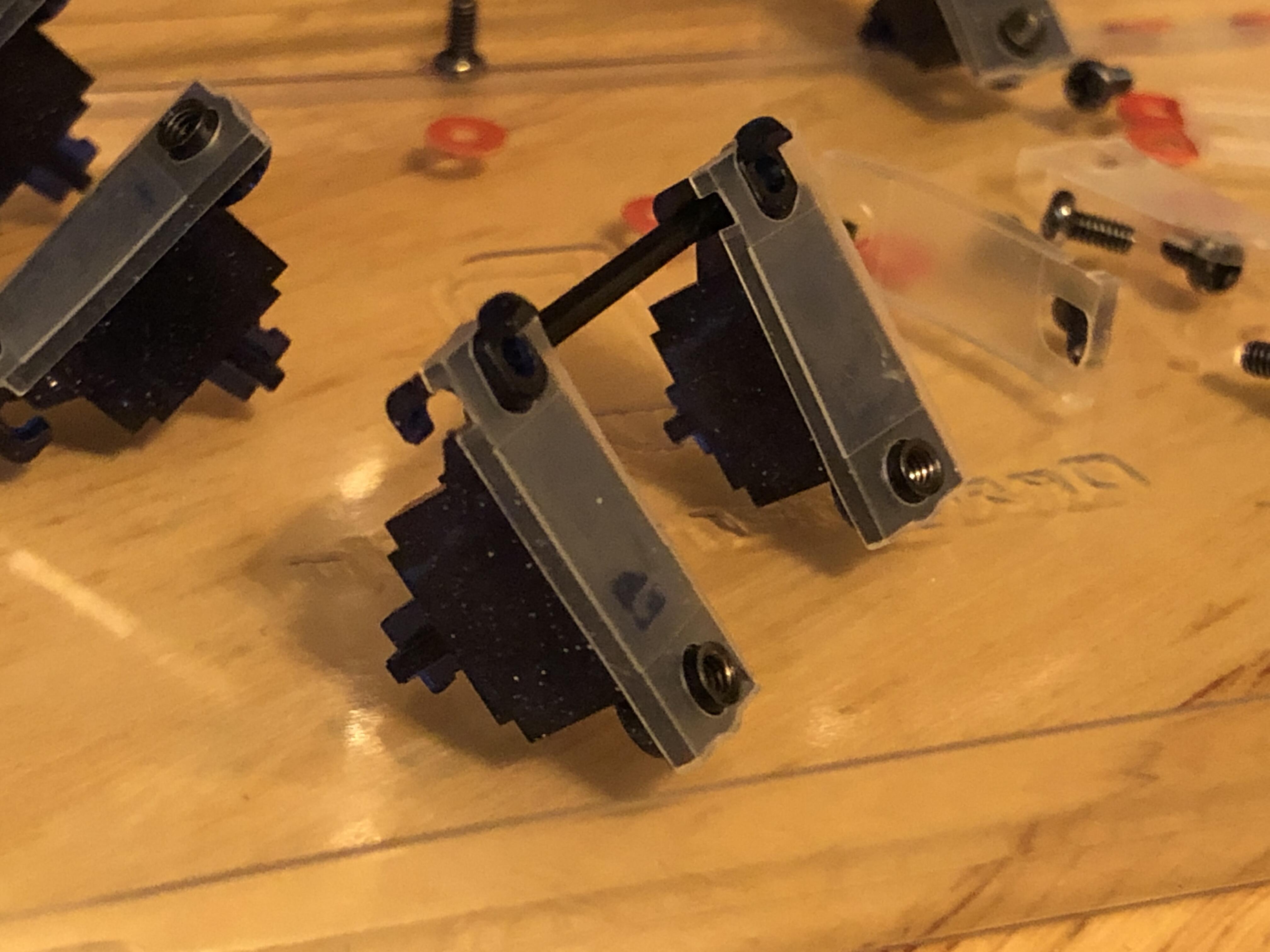

I’m loving these stabilizers so far, more than I thought I would. I did not love these silicone socks, though - they made sticky kissing noises with the greased stems, no thank you

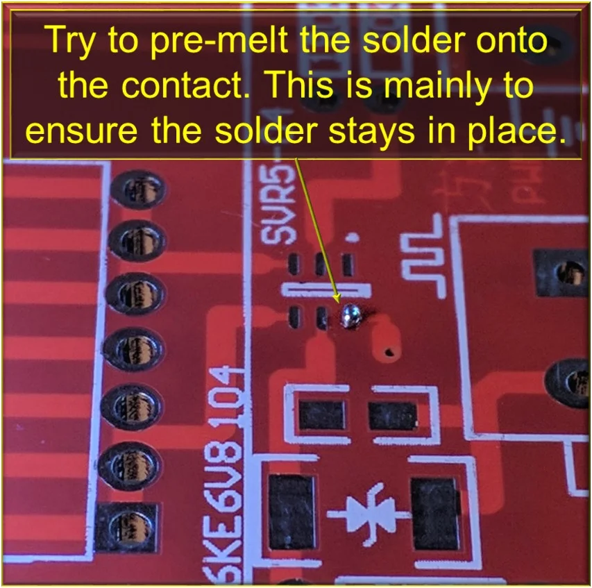

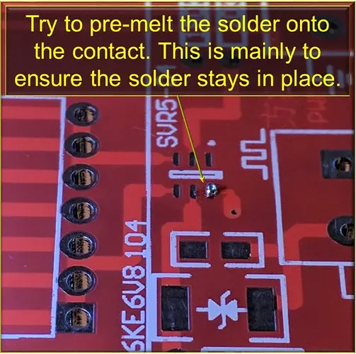

You soldered the capacitor on its side. :grin: But hey, if it works, it works.
Next time, look up SMD soldering on YouTube. It is not as hard as you think. Start with heating and soldering down one side, then the other side.
Oh, I know - ha - with what I had on-hand that was the only way I knew to get adhesion between the pads; I have nerve damage in my hands that complicates precise movement, and the only iron I currently have is one with a broad, not at all sharp tip; comparable in size to that entire component. :stuck_out_tongue: This experience makes me want to add a sharp tip to my toolbox just in case.
Looking at guides, though, I might have had an easier time if I’d used more solder when priming the pads. I was afraid of over-doing it but it looks like I could have been plenty more generous with it:
from instructables
Oh, I do these things most of the times with a broad tip, which transfers heat better.
Don’t worry about melting the components. These are designed to withstand direct contact with molten solder for a certain amount of time.
