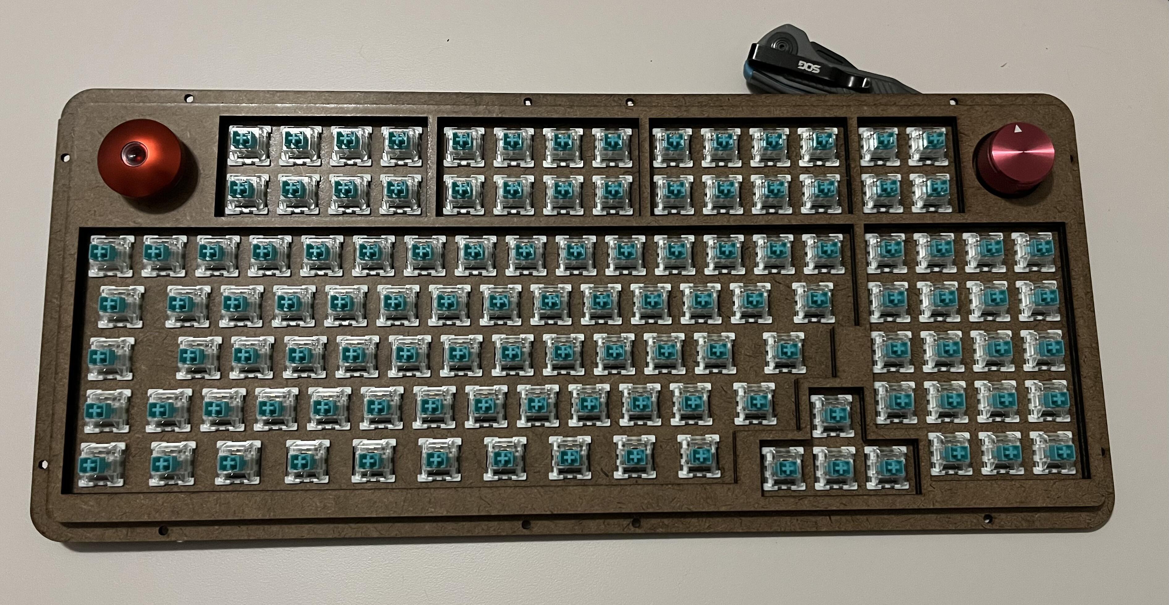

Lasering done (probably), though I had to babysit it all day and had to pull the switch plate after one pass when I’d have preferred two, because the second pass was starting a mm or two off from the first. I think something might be up with the belts or a stepper motor, as this is a new occurrence, and it was pausing more often than usual as well.
Had a little bit of tearout knocking out the switch openings, but the switchplate held together. My goofy ass also forgot a non-symmetrical bottom plate needs to be cut with the masonite upside down. I’ll see if the hollow feet can cover an offset, or else pick between redoing it or having the “burlap” side visible.
I also got the switches installed and dry-fit the encoder and the big dumb button, so I can start to get a feel for what this thing will look like when it’s done.

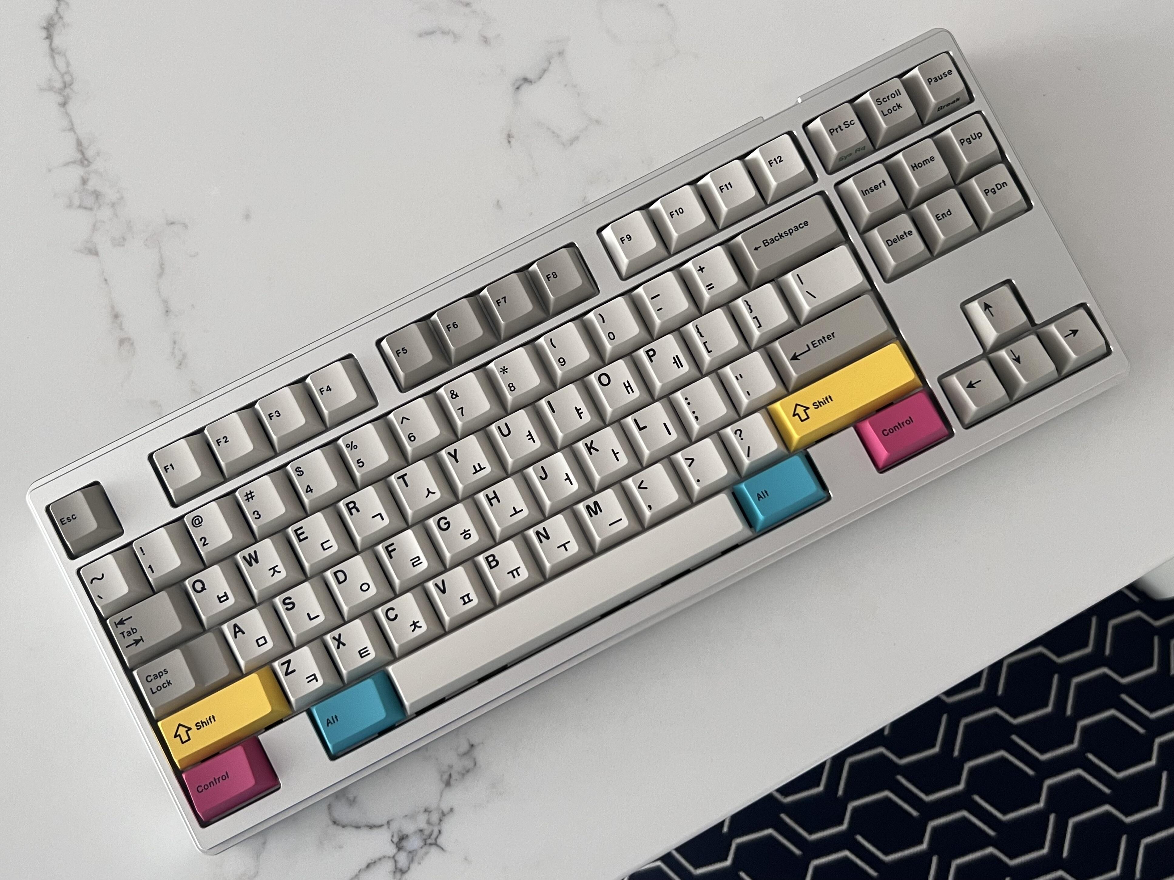

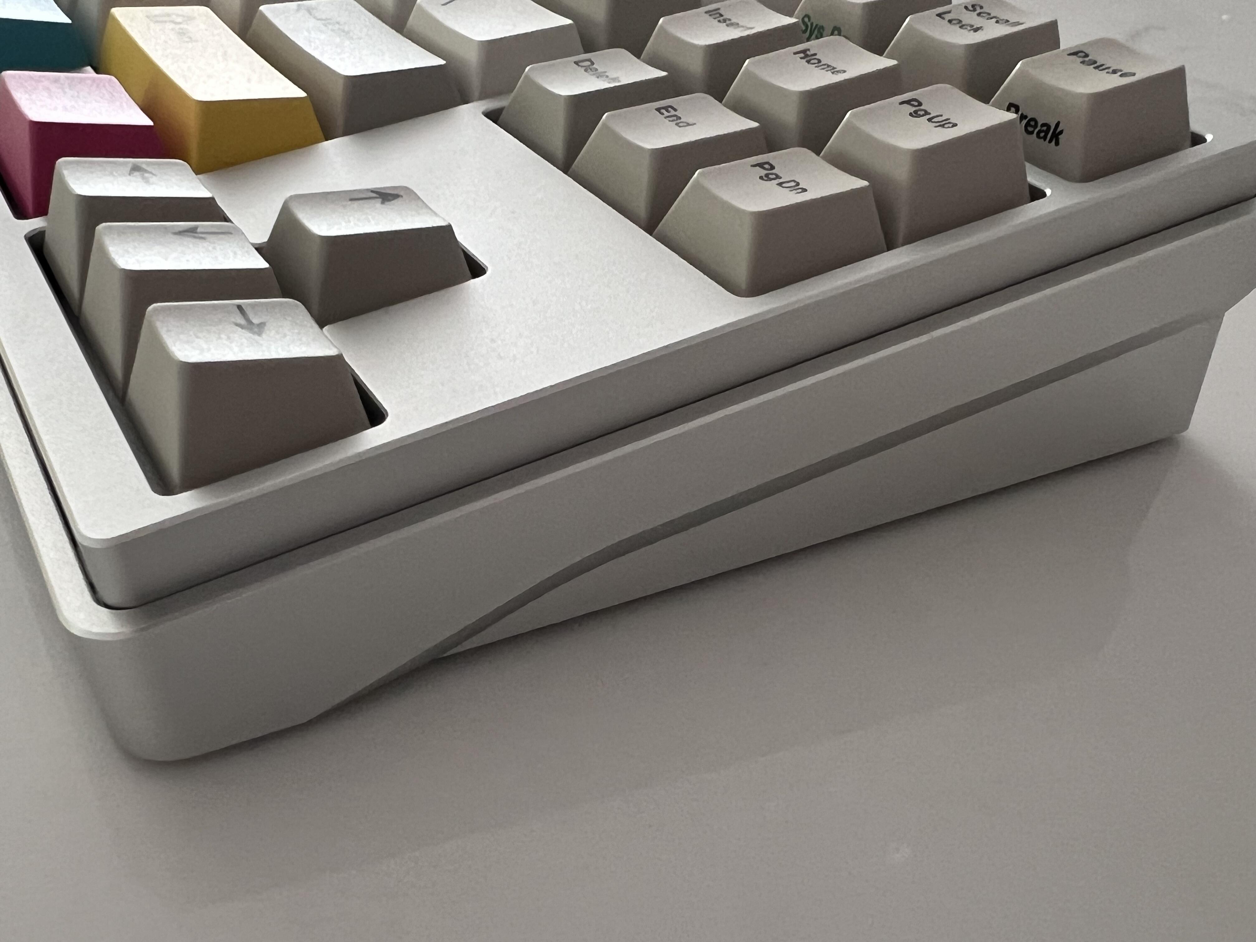

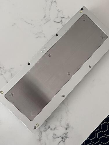

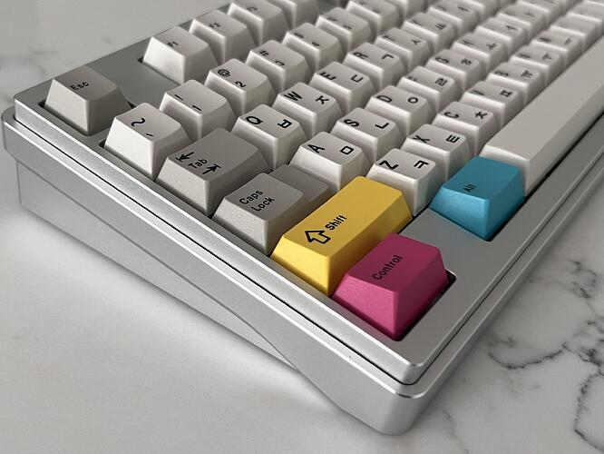

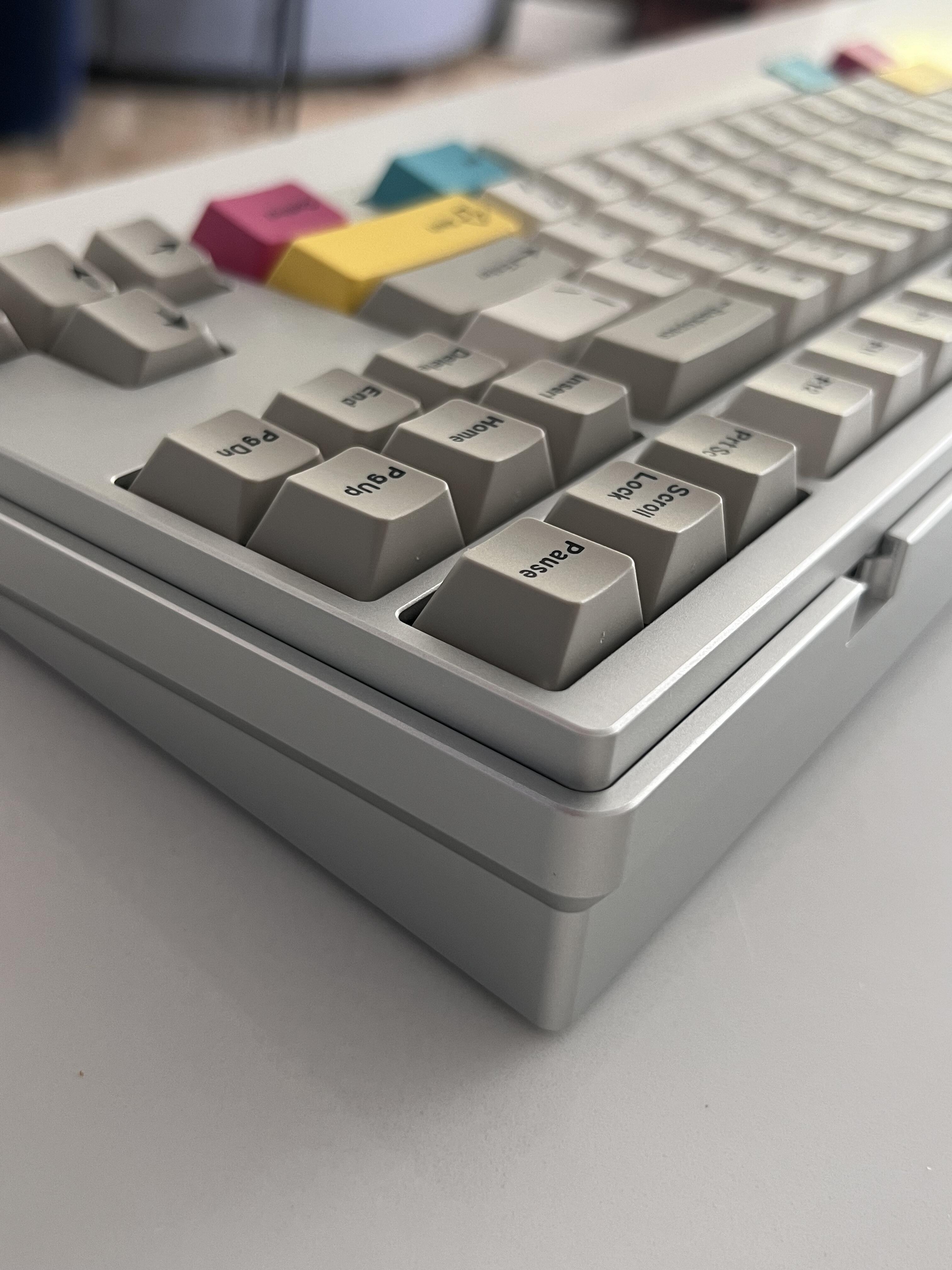

I wanted this board for 10 years. I had been watching someone selling it for almost 1/2 a year. Price kept dropping. I kept lurking. Finally, the price failed to drop for two listings in a row. I figured he had hit his lowest limit. But what the hell, never hurts to ask. He sold it for what I wanted to pay! Hell. Yes.
So today I built one of my grail keyboards. It’s a TX-84 v1. Silver with stainless steel weight. This board was absolutely pristine. Came in the original packaging with everyone still wrapped up. Two plates, two PCBs. Everything unused. Heaven.
I still opted to build it with a Hiney pcb so I could have USB-C and more modern software for programming.
I used my snow crash linear switches. The typing sound is crazy. These switches are appropriately named crash. If you like linear switches, you can’t skip these. You have to try them. If you don’t like them, you can sell them to me. :grinning:
KKB Jindo for the extra Korean flare.
At some point I’m going to post some family photos of my boards. TX hold a big spot.
Lovely looking setup
Really nice board, too bad TX does not make keebs anymore.

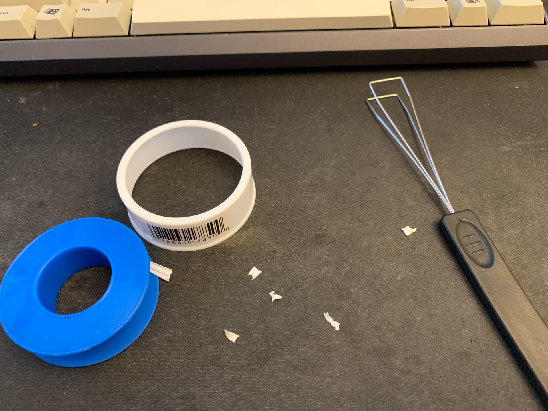

Some teflon tape bits to tighten up keycaps. Doesn’t take much. A few mm will unroll to long enough length. Difference in sound and feel is noticeable enough to encourage me to do a full board eventually but I usually start with modifiers as I use them like fidgets.
Can you show this, at least a photo?

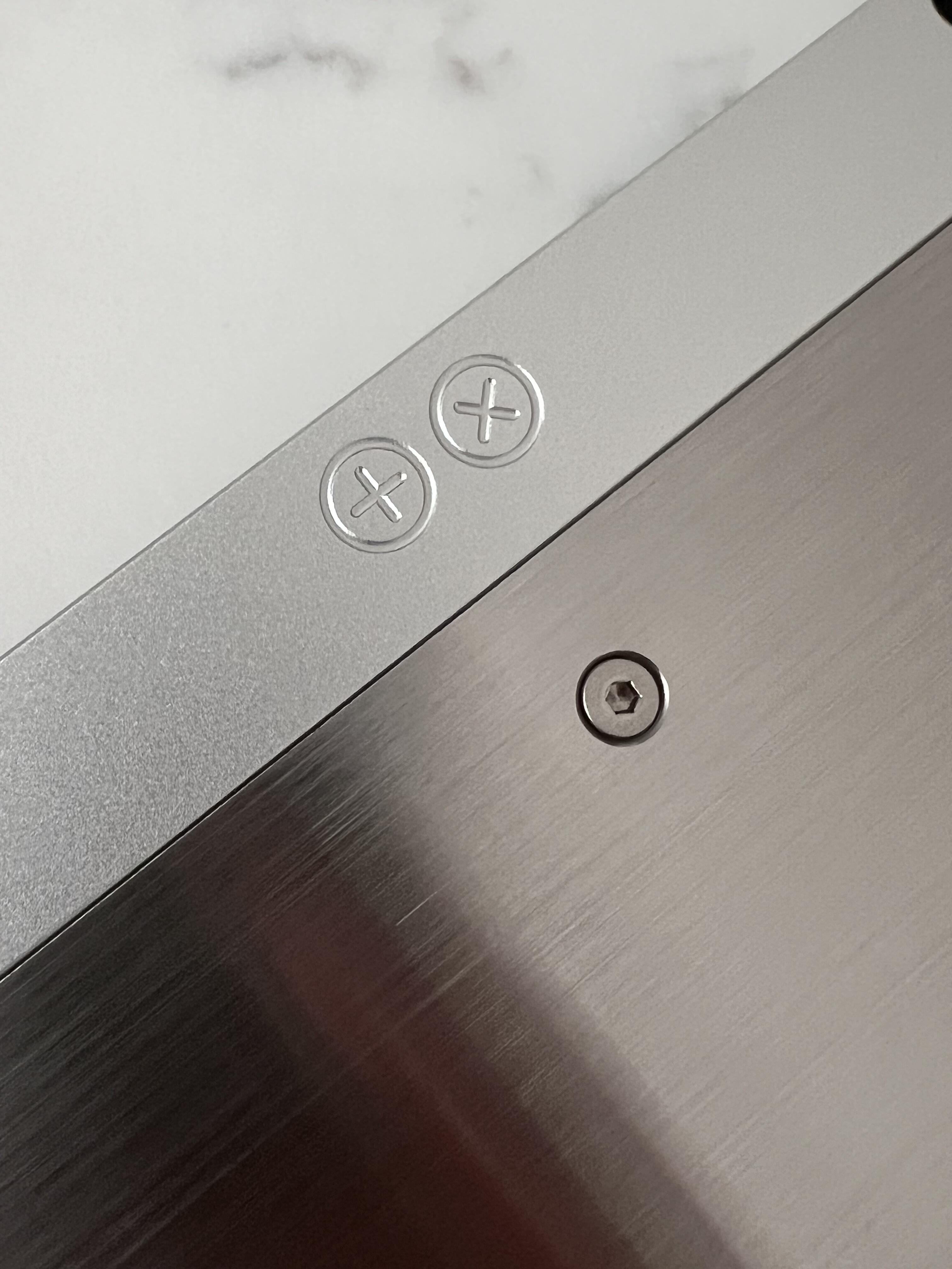

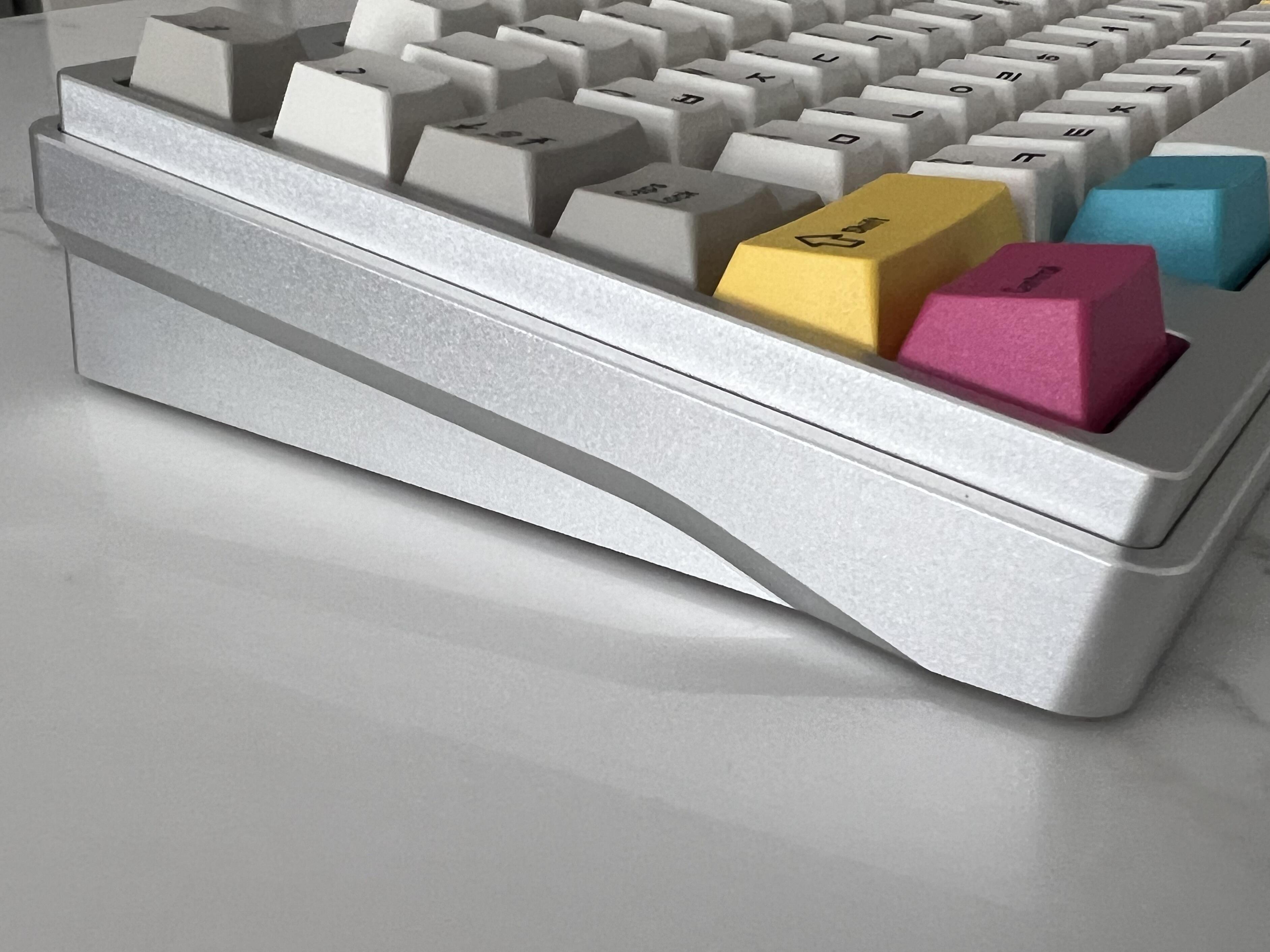

Here is the story of this HIBI MIA. I put it together to see whether it works – it does – and was a bit surprised by the fact that its screws appear to be regular Allen screws from the hardware store, without any branding, and it didn’t even come with a tool. Also the white USB-C cable seems to be rather generic, although one might have expected a Botanical themed cable as well.
Judging by the fact that one of these things usually seem to go for around $150, it puzzles me how little love was put into it. In fact, not even the case that it came in fits the Botanical aesthetic, as it is purple. I might be spoiled by other manufacturers, but this piece of hardware sadly feels disproportionate to its price.
I’ll be putting it back into its box and try to sell it, to recover the costs that I ultimately ended up paying for what I had actually ordered – which was luckily well below the price that this item usually goes for.

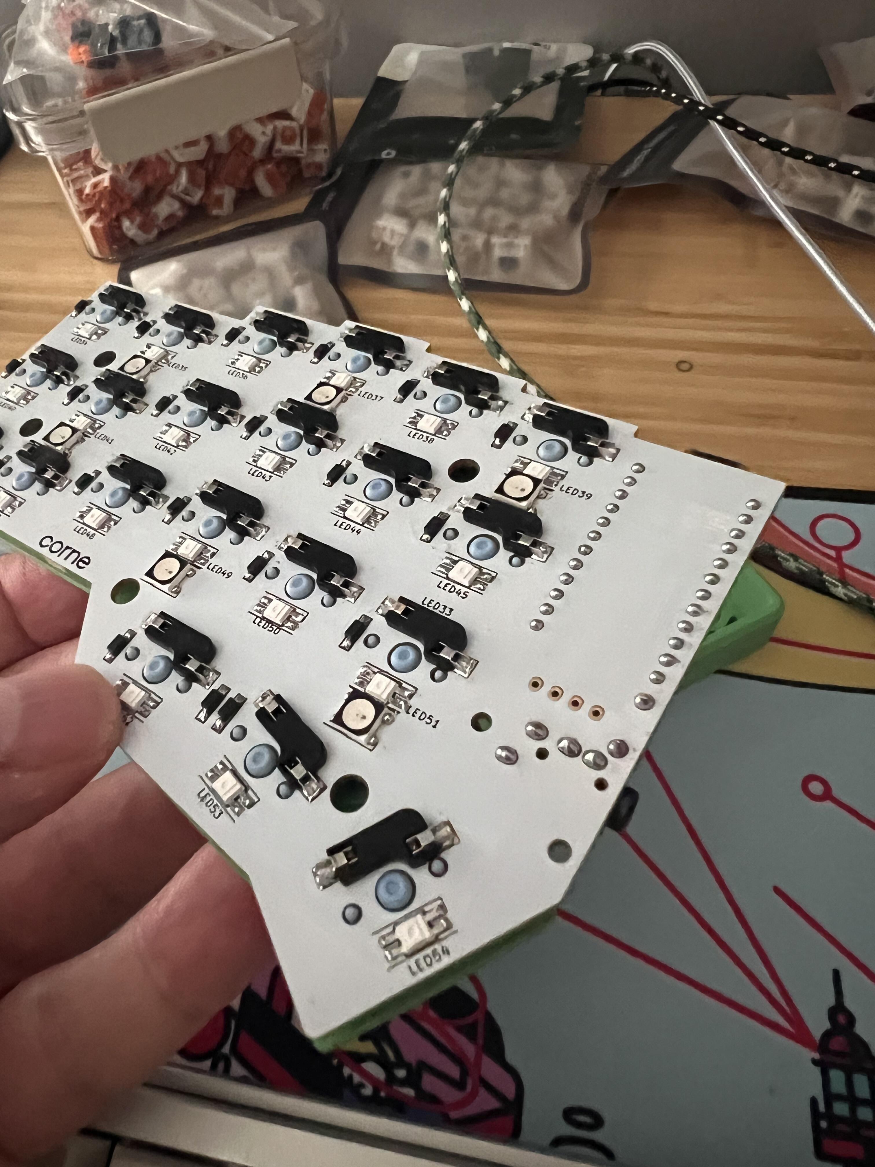

Brother-in-law loves ortho boards so I built a Corne for him. This shit is for younger eyes. Really annoying to have to get out my phone magnifier for every single diode.
Amazingly, it all works.
Also, I borrowed his pencil soldering iron. I might like it better than my hakko. Definitely better for this smaller work.
You did an amazing soldering job!
I second that, soldering is on-point! @pixelpusher what case are you going to be using?
He has been 3d printing a long time and he has some nice printed cases. Just need to source some standoffs and it’s good to go
Nice! Looks like you soldered on the LEDs too; any tips for that? I think I mucked up my first attempt, they all turned kinda different tones like I may have heated some for too long… So hard to stick down.

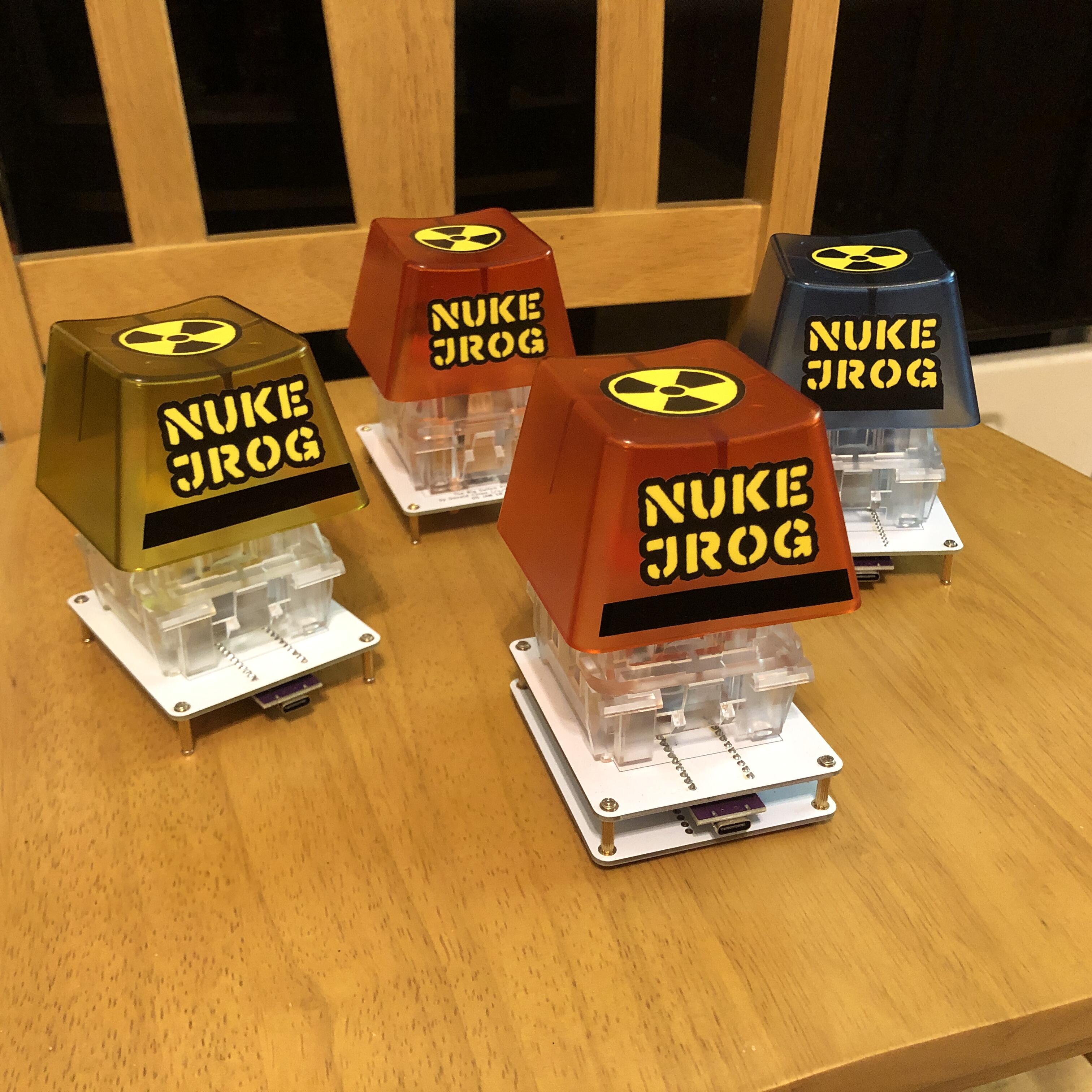

A quartet of gag-gift big switches, tailored to an inside-joke held by a certain team of IT folks. Three of them still need their bottom plates - oops. >.> Jrog was the username of one locally infamous member of this IT group.
These giant one-button macro pads send ALT+F4 when pressed.

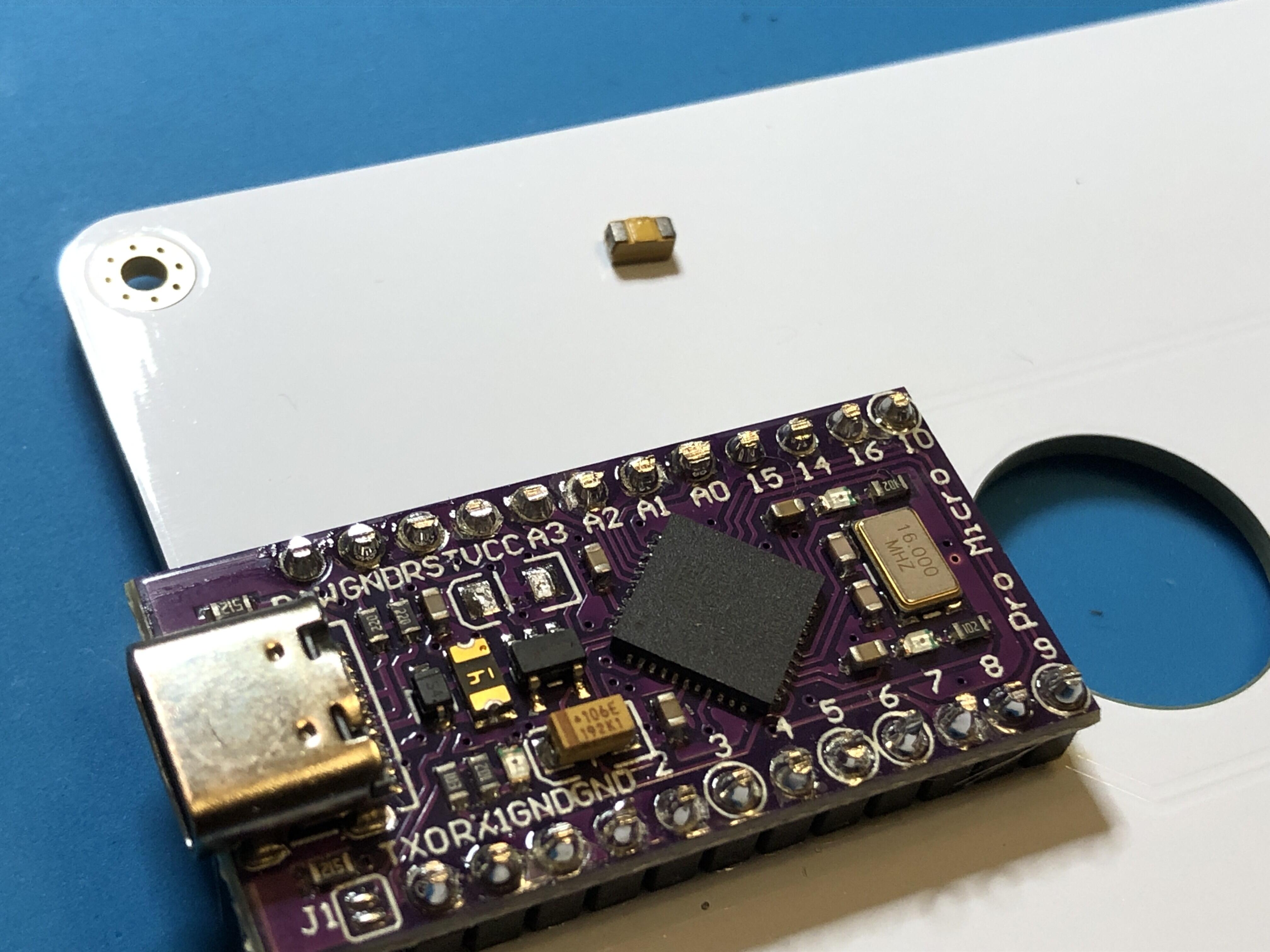

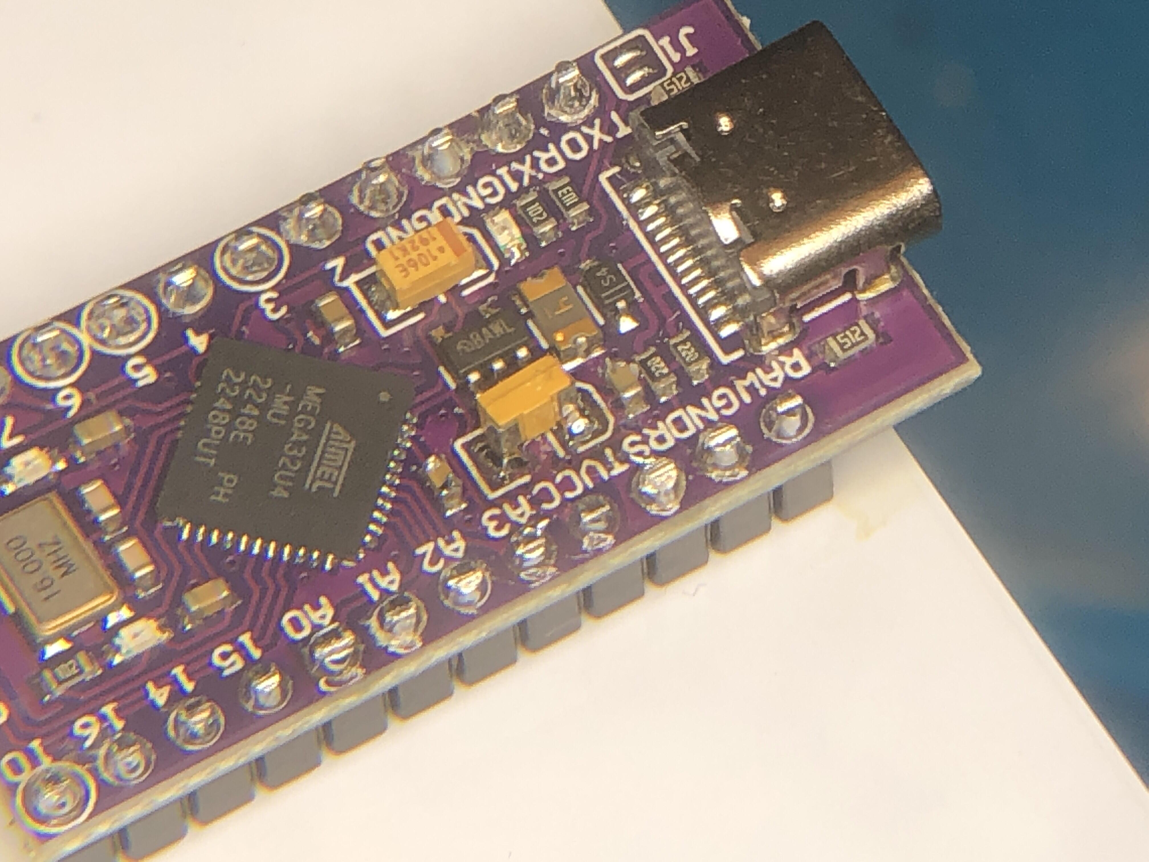

I made a pretty big goof while trimming the pins on one of them:
D’oh!
Far from ideal, but somehow functional. A small miracle considering my shaky hands and broad-tipped iron.

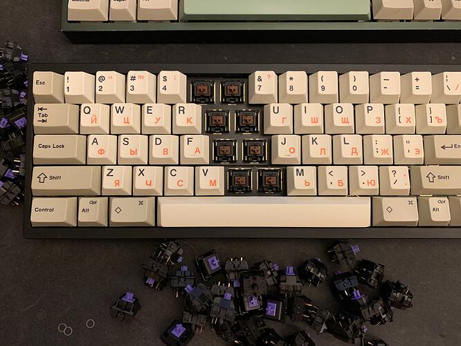

I think my set of Cherry MX Brown is finally ready for daily rotation, replacing super marbly Vertex V1 on Polaris. Amazing feel that I doubt will get tired of easily.
UPDATE: On random try, I found that Cherry MX Browns sound better and smoother in Brutal 60 (typing angle 7.5-degree) case. With Polaris, I’d occasionally feel scratchy as the leaf goes over the bump. Very little of that with Brutal 60 if at all.
FYI, Polaris’ typing angle is 6.5-degree, a full degree difference. If you’ve been using a scratchy set of MX Browns at a lower angle than 7.5-degree, try raising the typing angle.
