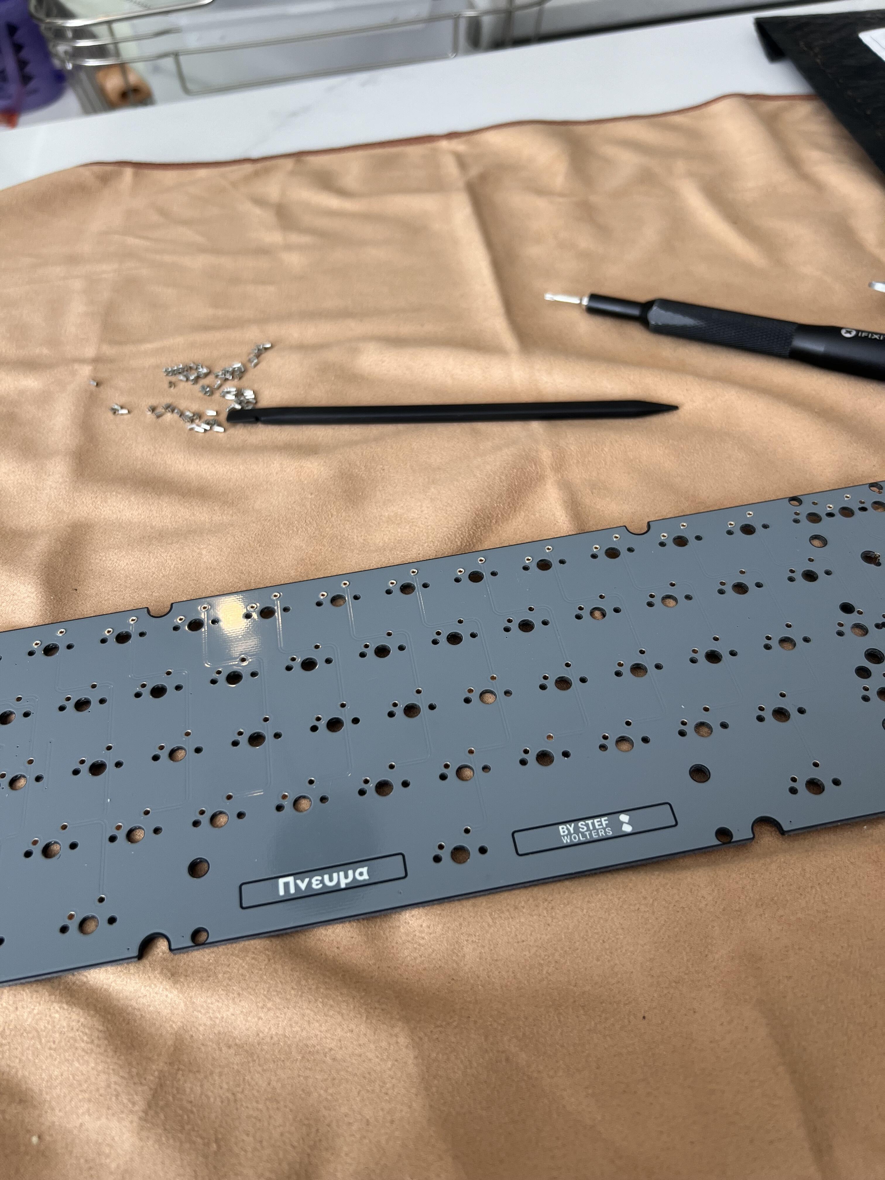

Mill-maxing my Pneuma. Companion by my side as always.

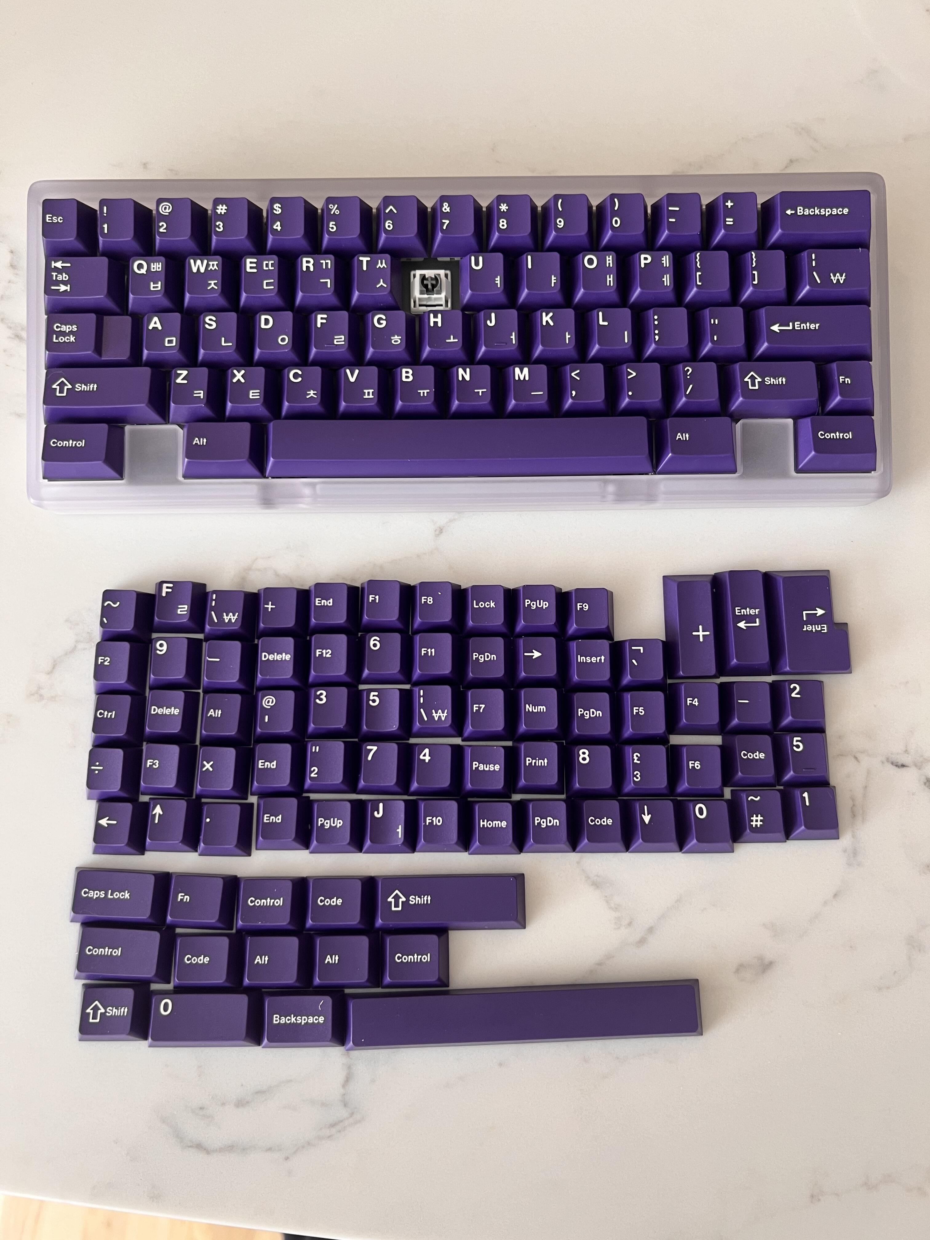

Nothing like a long day of building to have this at the end of the road
Y me :sob:
The HumanitY :frowning:
SorrY mY friend. In troublYng tYmes like these, I trY to look on the brYght sYde of lYfe.
Sorry man, that is horrifying. Have you used the set before? If not, did you buy it recently?
First time mounting. Got them just a week ago so I’ve reached out to Omnitype. Hopefully they can supply an extra Y
I guess I can always use them with weird key there. Or use the modifiers as a mix set. The purple is quite nice
Fingers crossed they can. It is a really nice shade of purple.

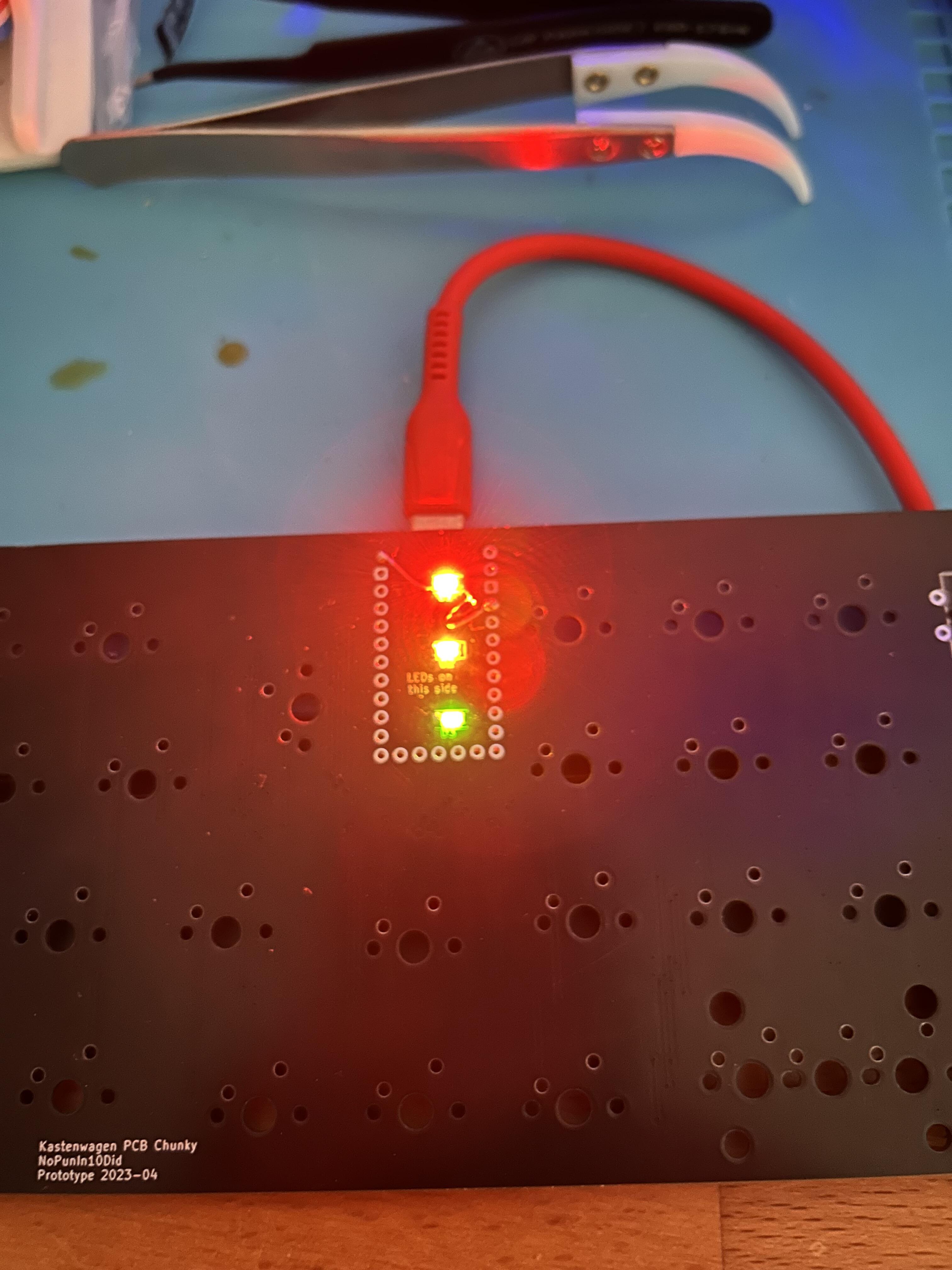

Finishing touches on my Kastenwagen Helios Port, all LEDs working just fine. I had some issues in de-soldering hence the bodgewire, AliExpress only sent me red and yellow LEDs, no green ones so I ordered them locally (for 10x the piece) on eBay.
Now that I know everything’s working, I can clean up everything and push a fork of this to GitHub (it’s also a ISO port by NoPun for anyone interested)

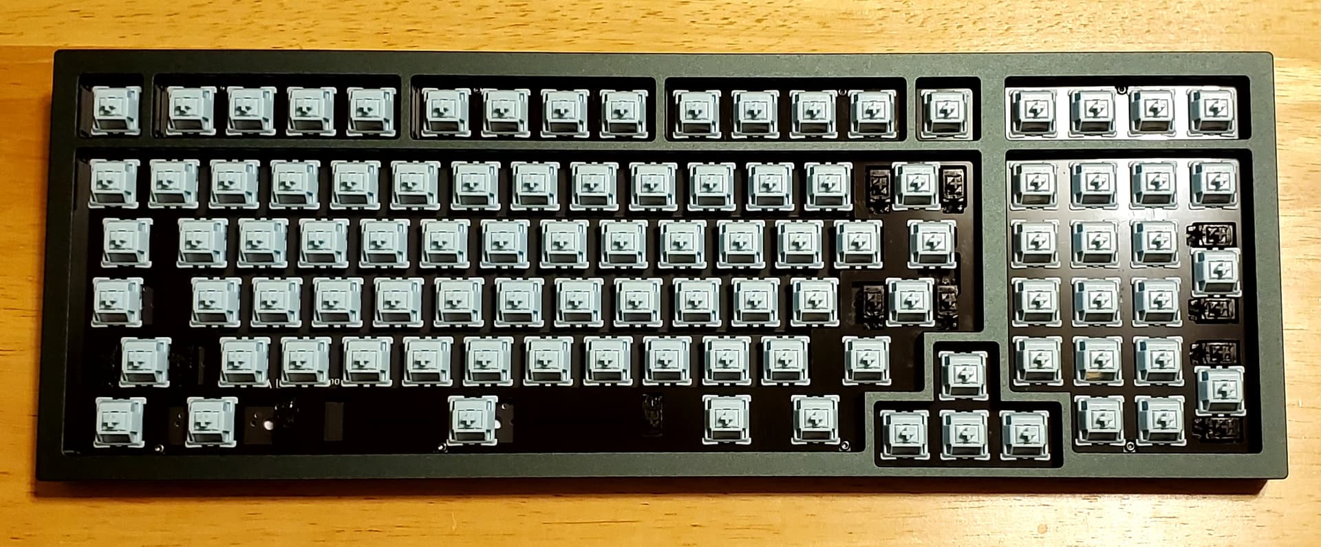

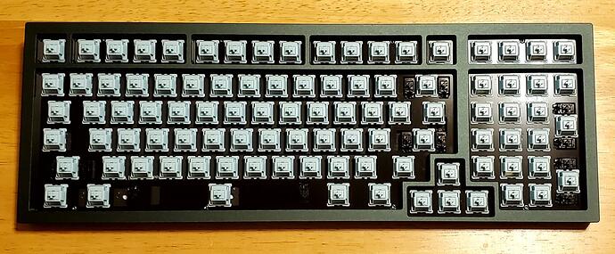

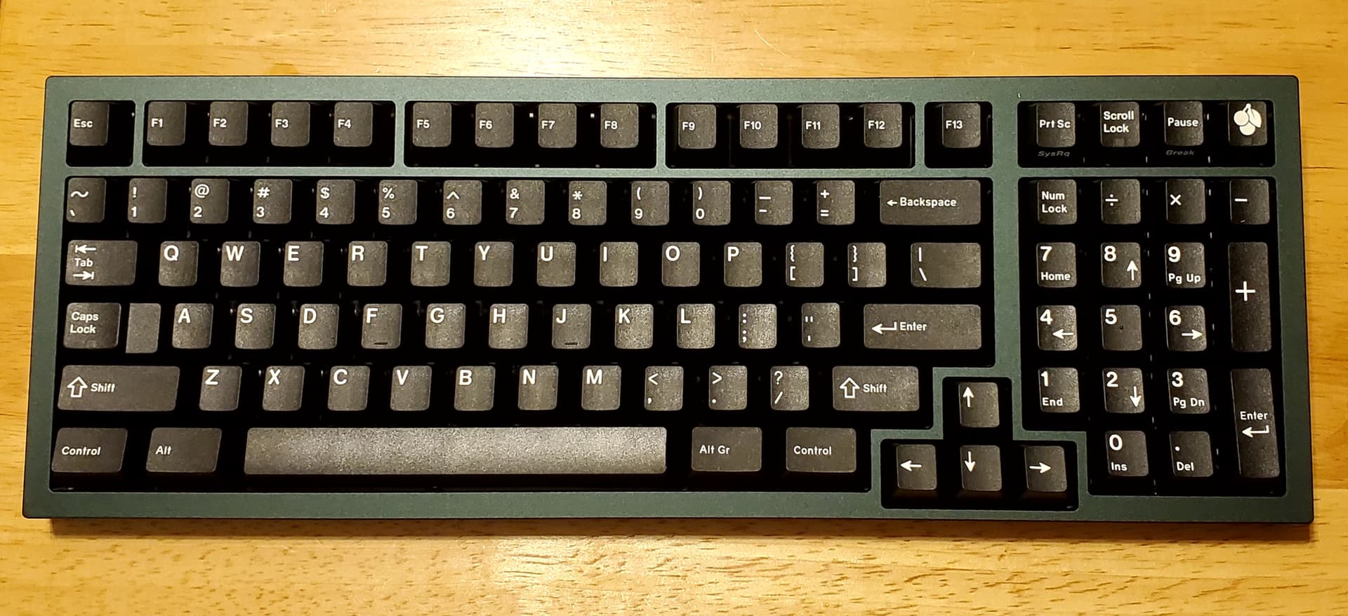

Built up my Brutal 1800 V2 tonight, super happy with how it turned out! I ended up using the POM half plate, TX AP clip in stabs, Gateron Sea Salt Smoothies, none of the foams, & the poron gaskets. Overall it makes for a very nice typing feel, not too soft & not to stiff, it’s just right for my tastes! The sound is really good to which I was a little worried about going with long pole switches in a bigger case & not knowing how well the Zinc weights affected sound. Seems like the zinc weights temper the sound about as well as brass or copper & the tight internals keep it from being hollow sounding. Now finally getting to use this a little bit I almost feel like I ripped Ck off geting it for $125! :rofl:
Seriously though these Brutal V2 boards Ai03 designed are a massive upgrade from the V1s & well worth their regular price. I would easily recommend the V2 1800 or 65% to anyone who was interested in either. Hopefully they upgrade the rest of the series & stick to the design cues from Ai03. A V2 Devastating TKL or Malicious Ergo made in this same style would be killer boards IMO!
On paper, the sea salt smoothie has a slightly heavier spring and a smidge more travel distance. Is that what they feel like in reality? Love the dark green case.
Honestly pretty much the same as regular smoothies. Neither change moves the needle enough to be really noticeable IMO. However if you prefer the slightly heavier weighting &/or longer travel I would say grab the Sea Salts over the regular Smoothies. The quality of them is just as good as the early batch regular Smoothies I got. Also thanks! I’m really happy with the board overall but the color in particular I think is super nice.
Was about to ask how you have it built after seeing it on their Discord! Have to get around to using the FR4 half plate I picked up for a secondary build of my v2 65 (currently Haimu Skies in alu full). It’s been a mainstay for me.
