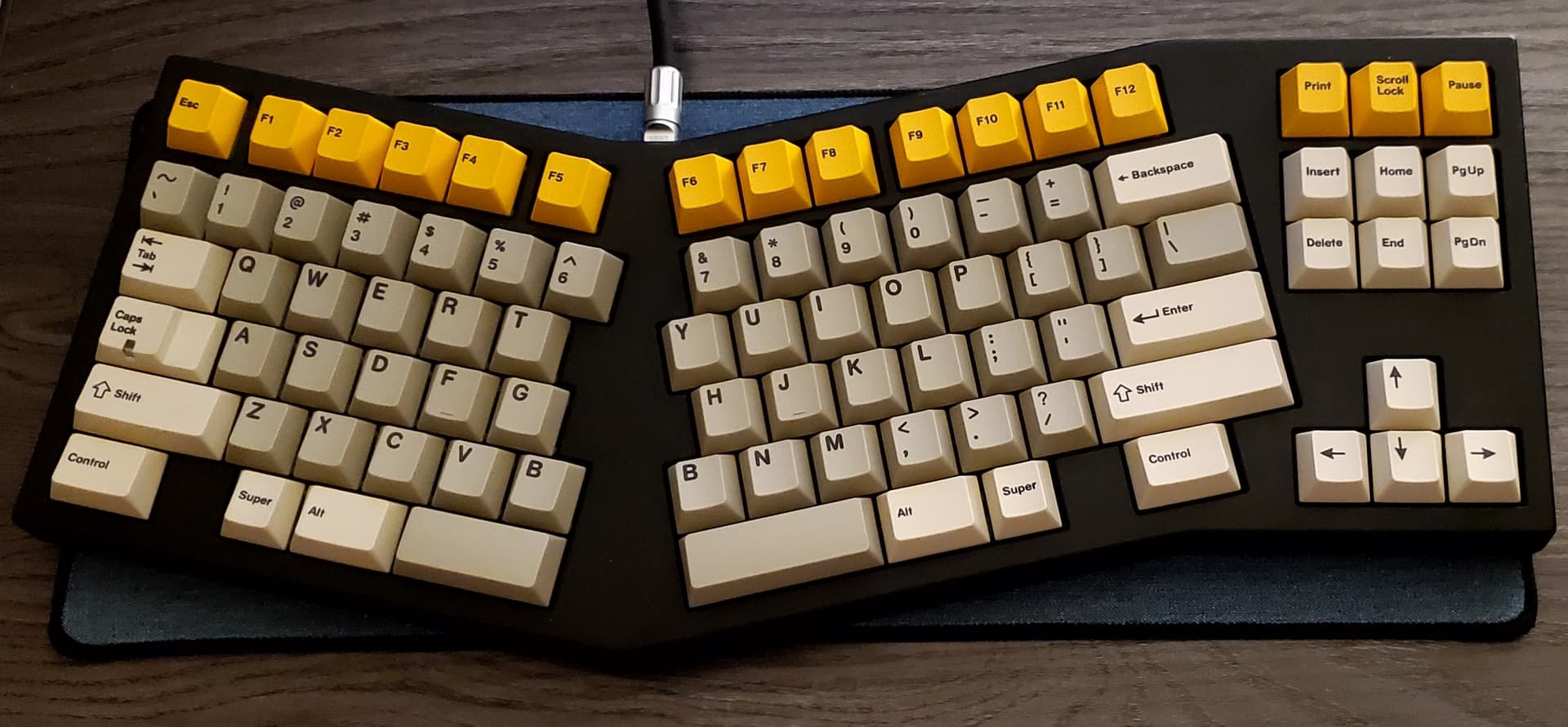

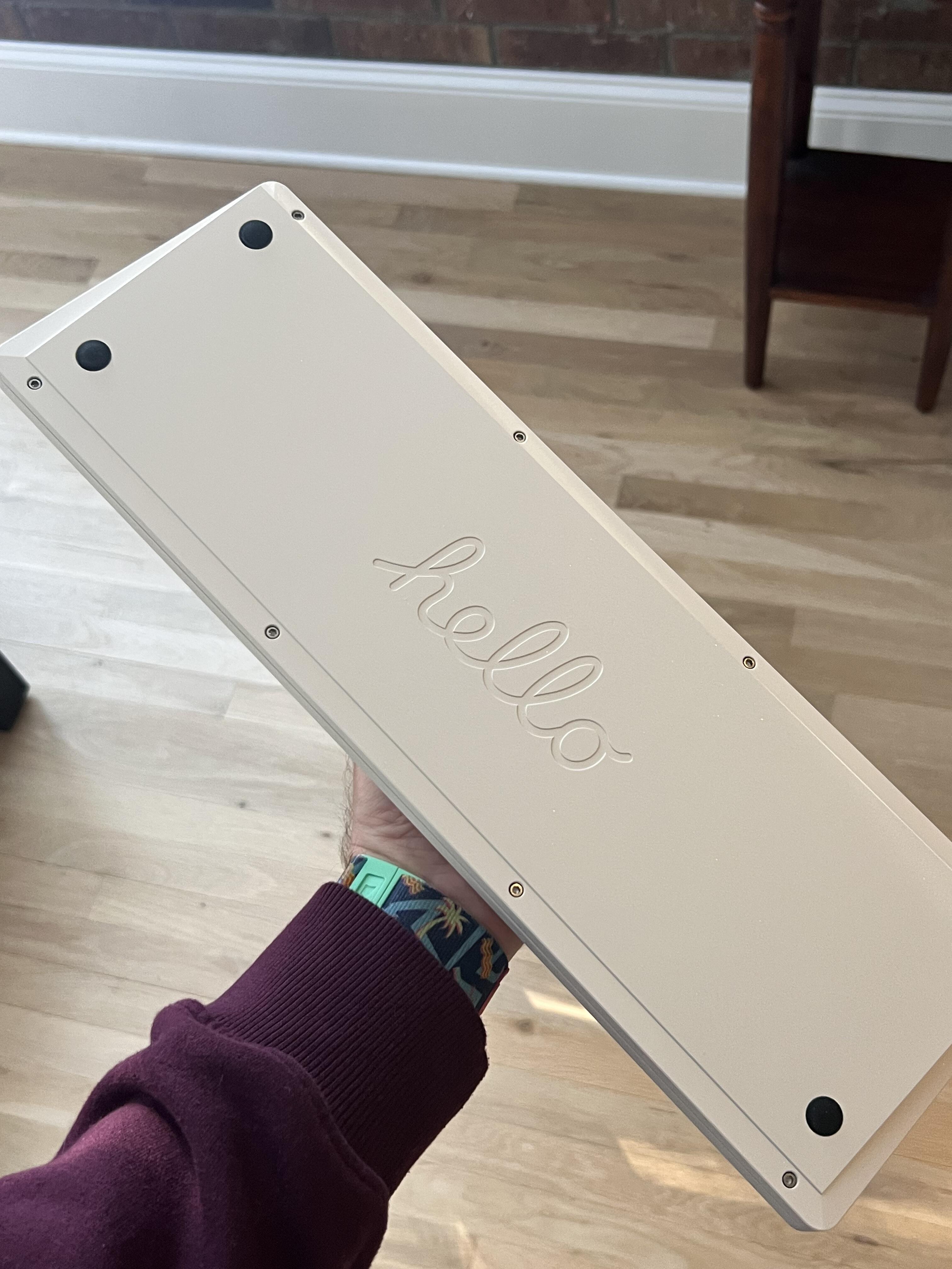

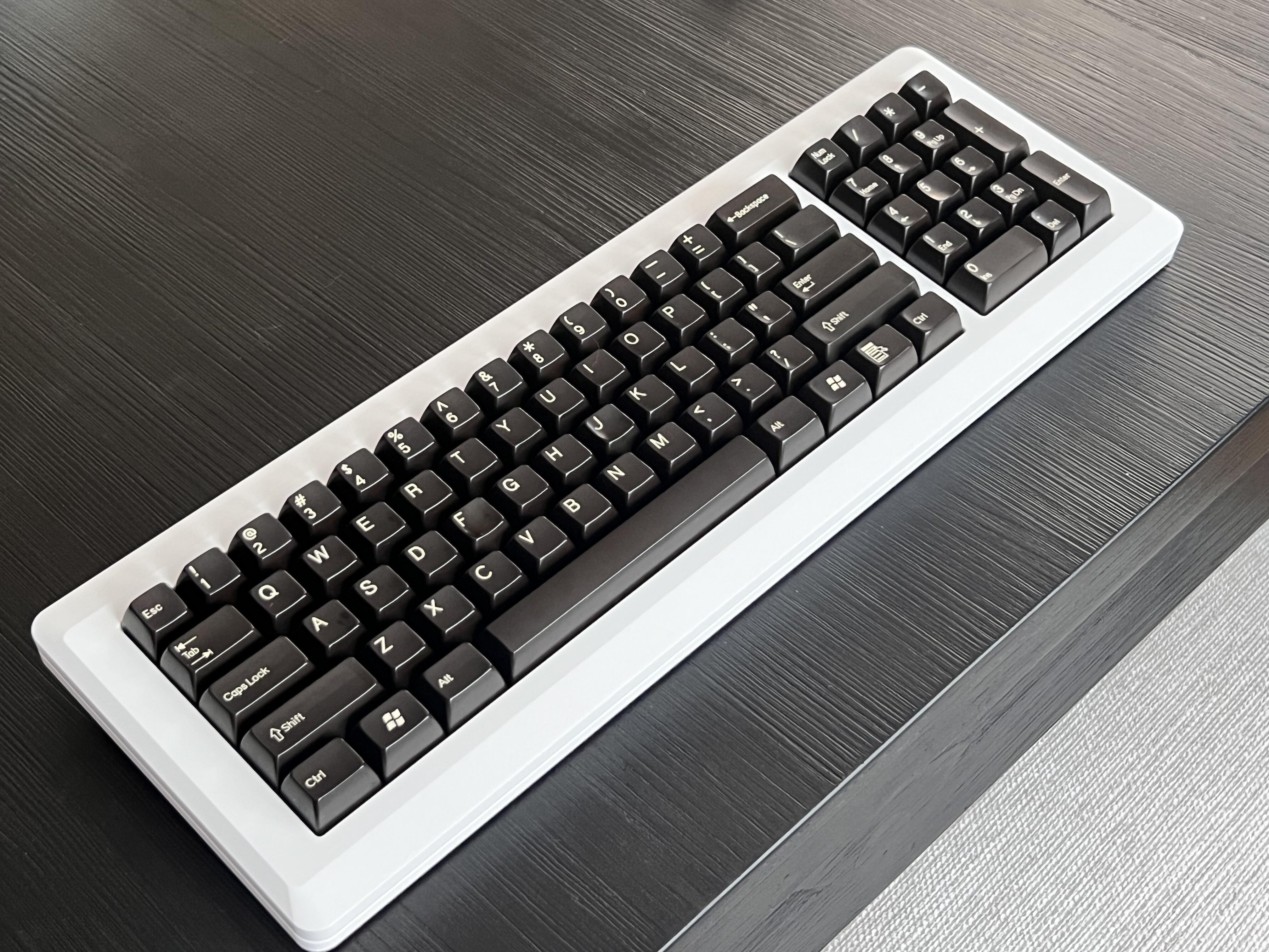

Built a rm8 from notfromsam today.

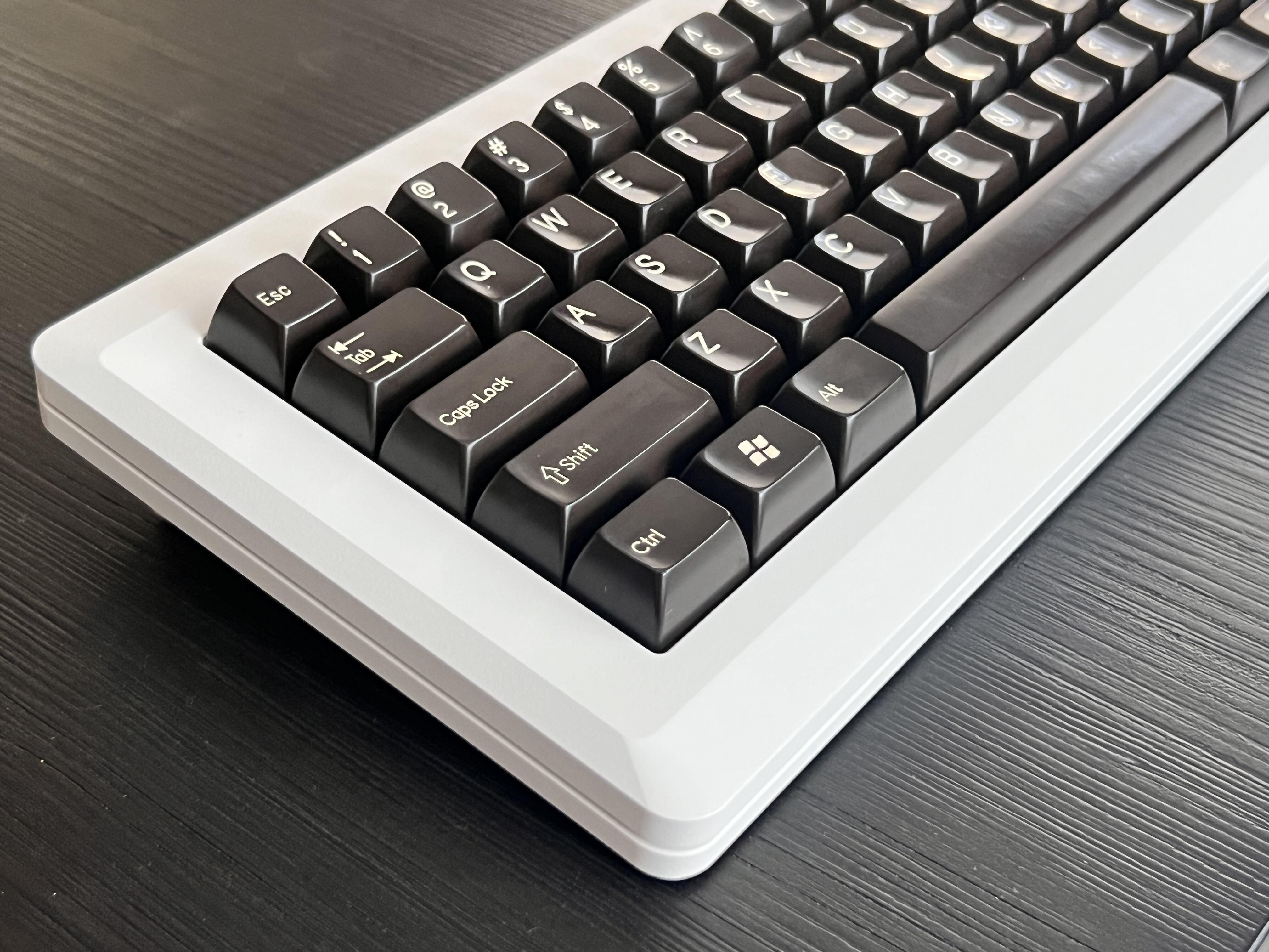

I didn’t realize it had a 1.2mm pcb. Luckily I had a few extras and some shims for the standard leftovers I own. Lichicx yogurt silent linears in this hotswap for now. Similar in feel to the silent Lucy. A bit noisier spring, but overall pleasant. Essentially 4mm travel is appreciated as well.
I really like this form factor. Same idea as the m0lly I recently built but a bit slimmed down. This one doesn’t allow for a traditional split right shift so I went for the Filco SA build with a 6.25u space bar. I adore these keycaps in looks and feel. I haven’t had them on a keyboard in years.
Although I have other final plans for this, I do like the look.

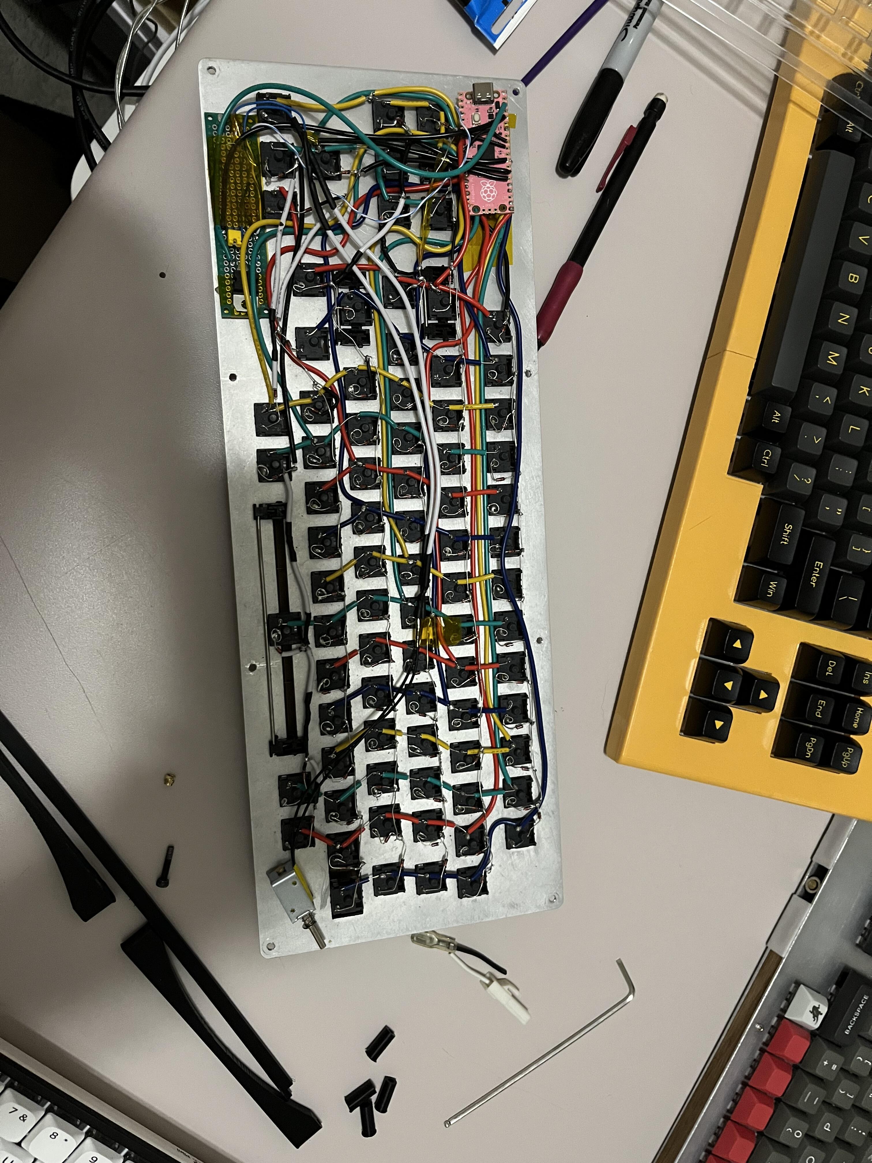

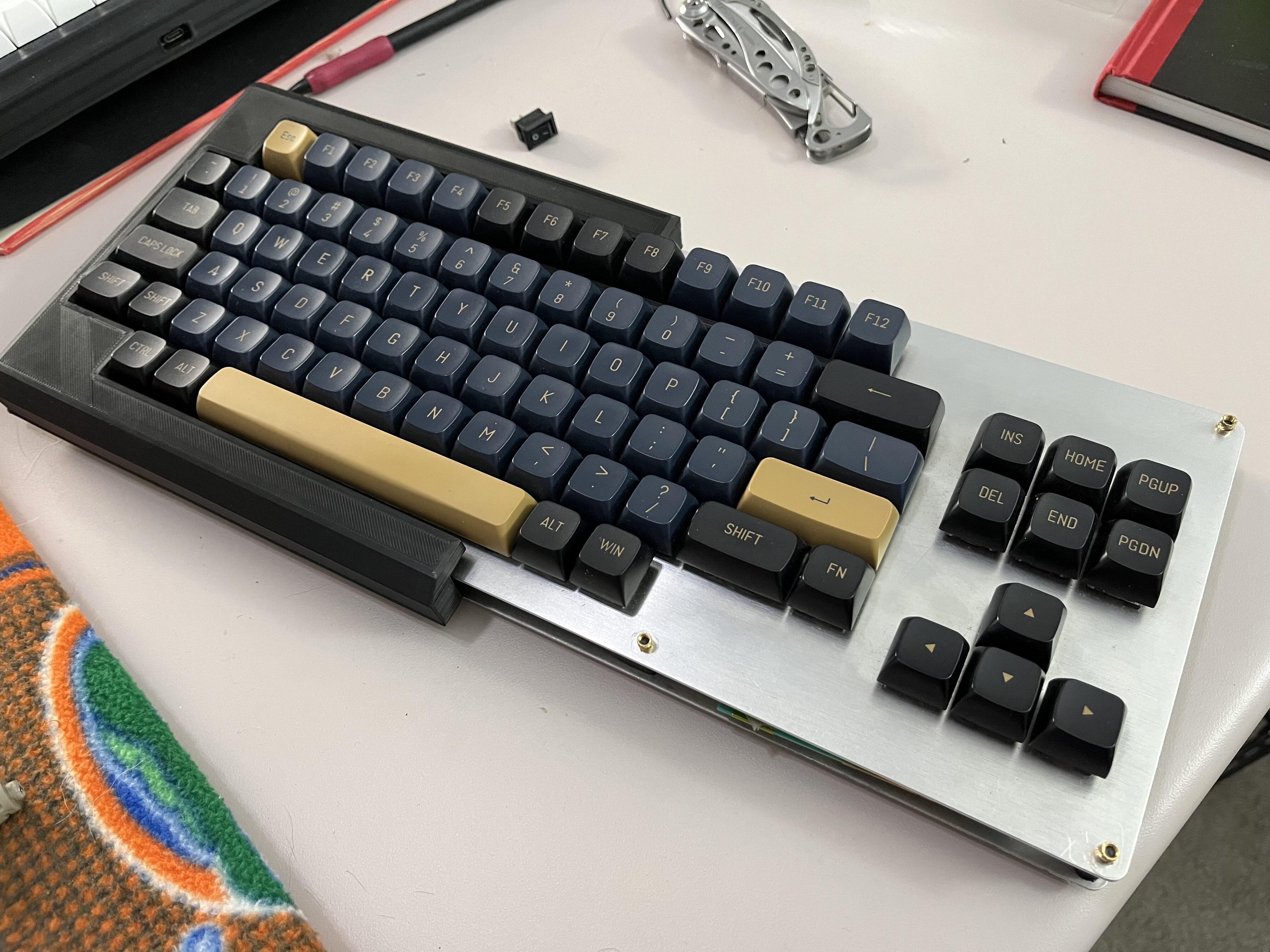

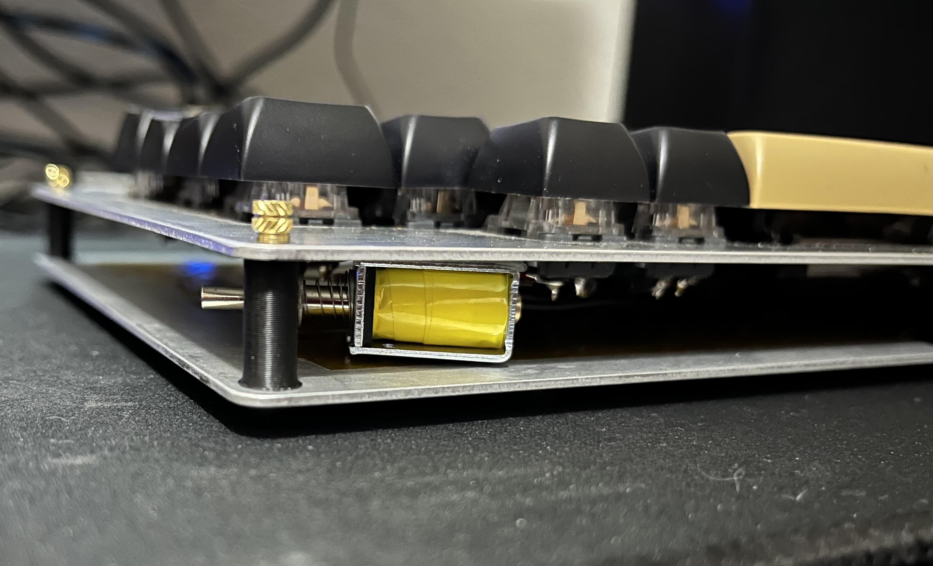

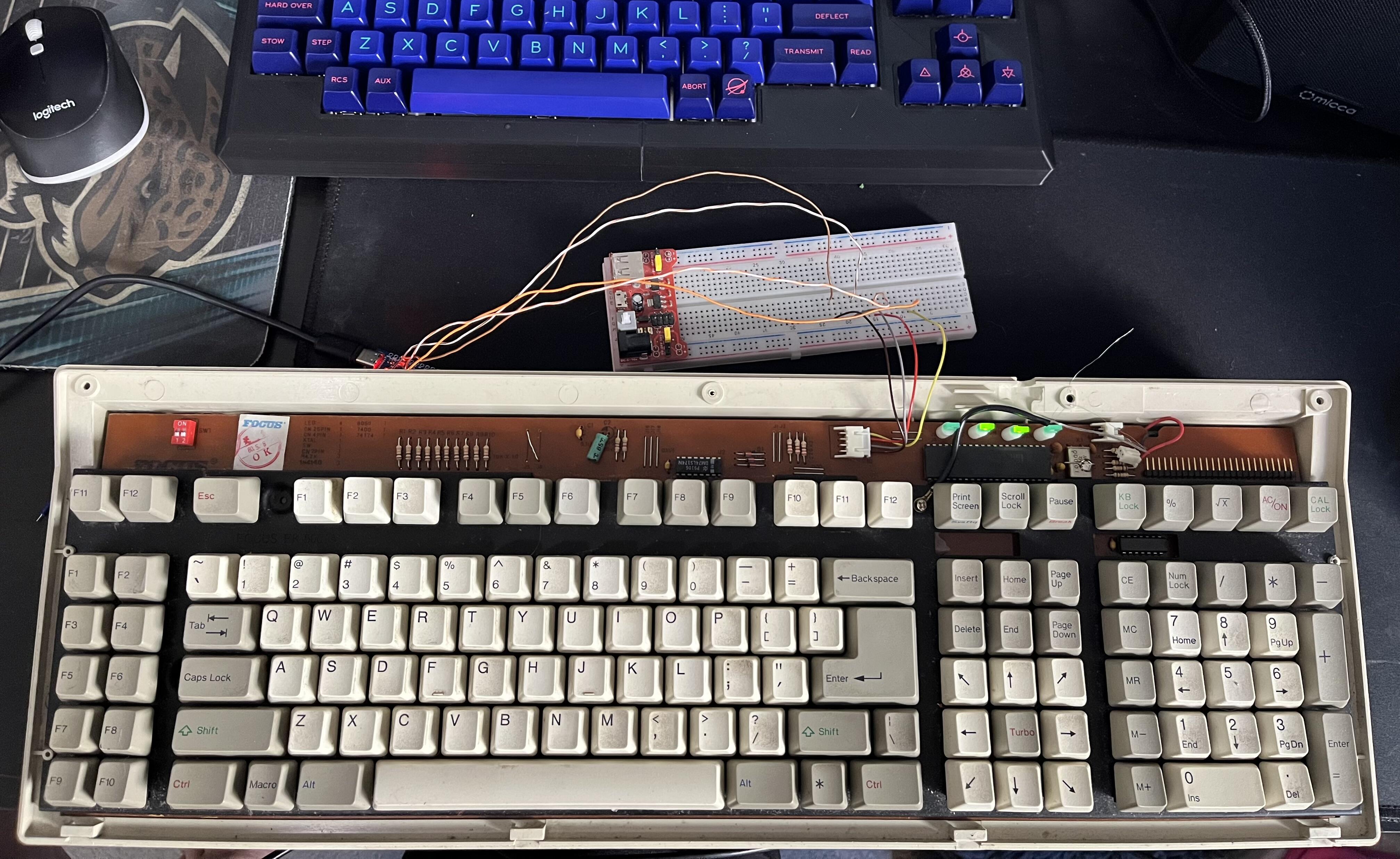

Well, I’m off to bed, but proof of concept is complete. The solenoid works and seems to fit. It’s just running off 3.3v from the RP2040 so it’s not terribly loud, as least as solenoids go, but I will still install a hardware cutoff switch for it when I 3D print the new case.
SOUND TEST.
That came out great!

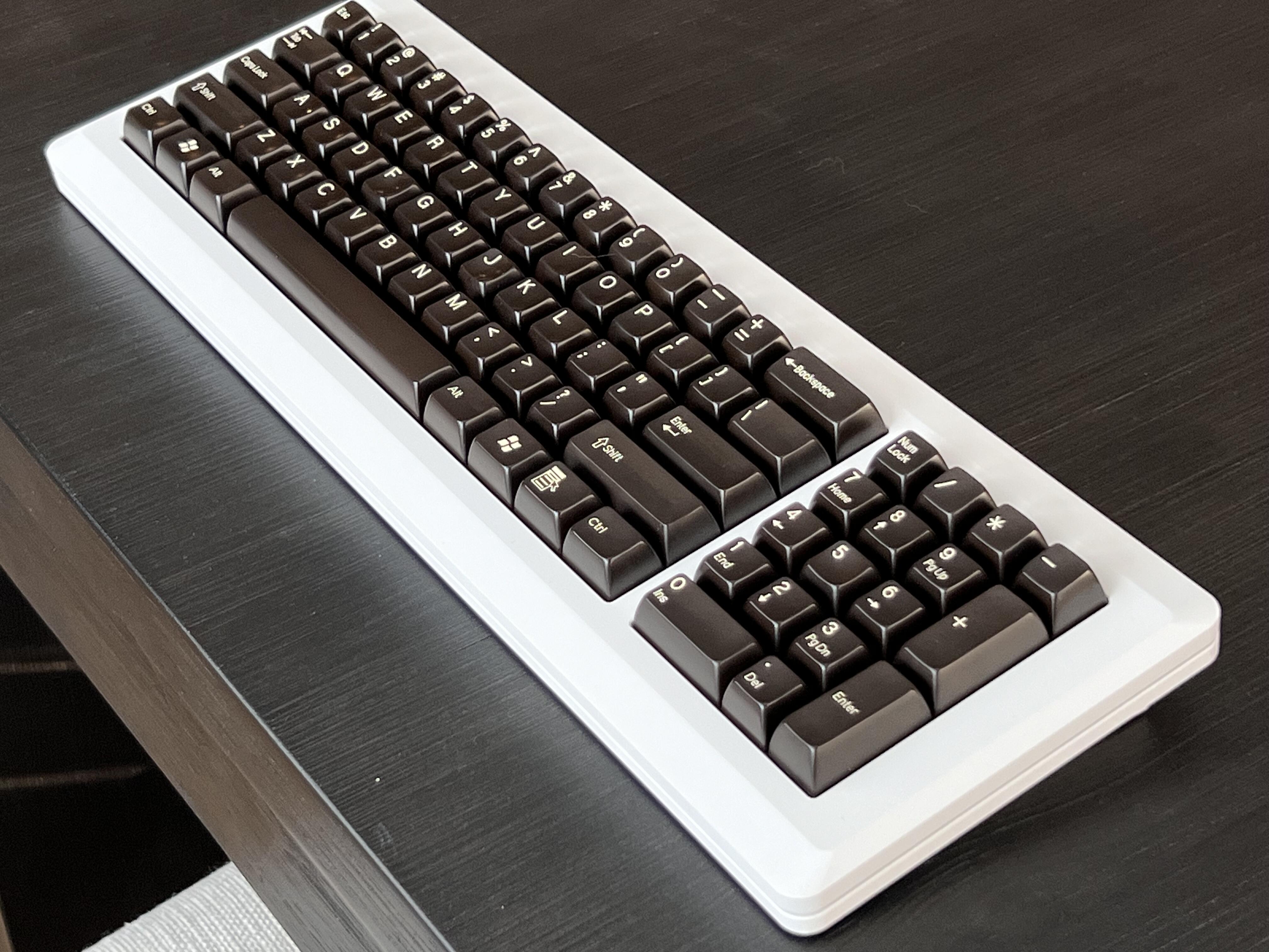

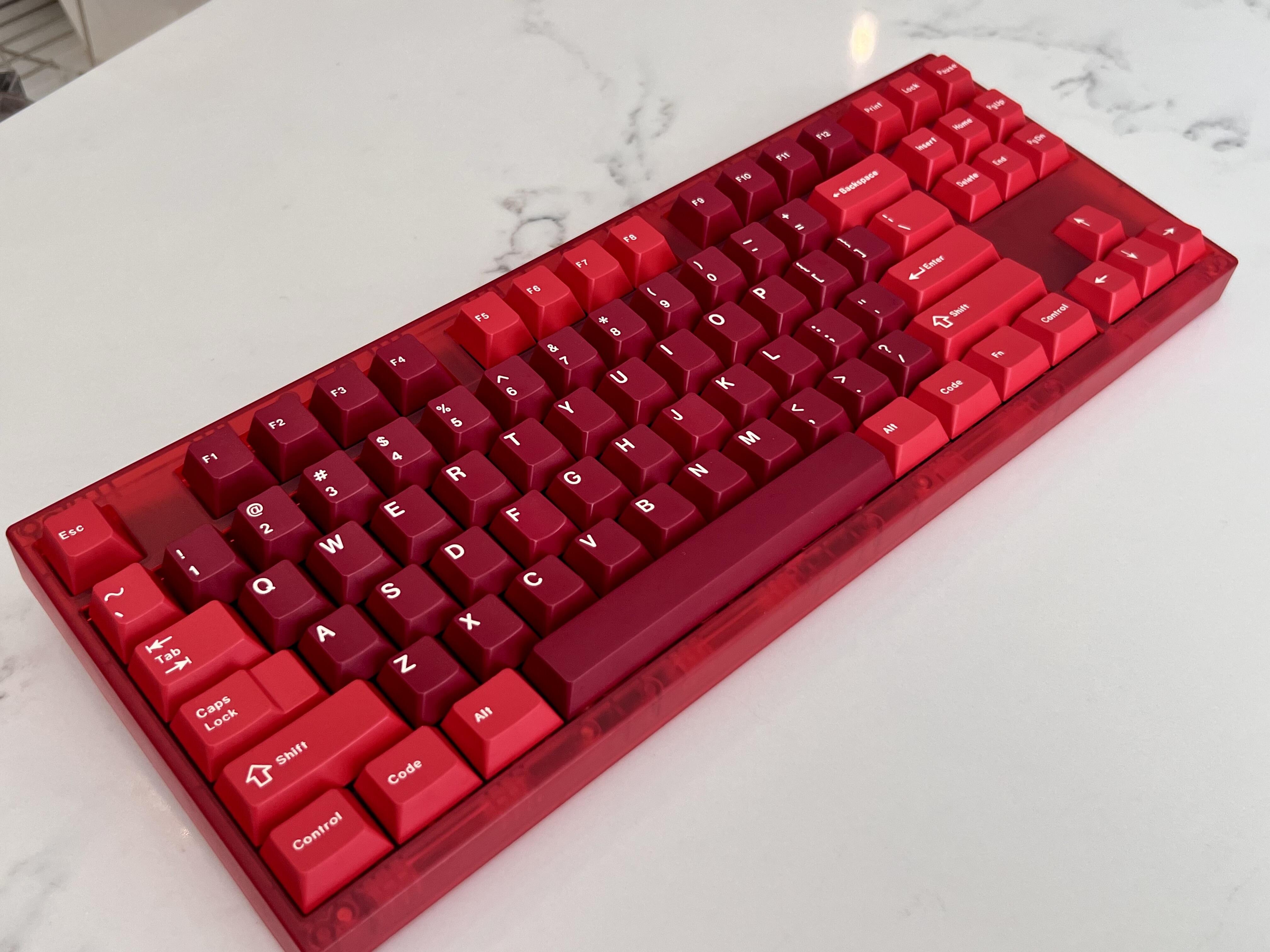

Today I built my Black Friday purchase, a Swagkeys transition lite from Divinikey.
Easy to build and sounds really nice with the included foam. I tried a few different switches. First build was top mount Gateron Sea Salt smoothies. I recommend the case foam for long pole switches. Makes for a nice deep thocky case.
This build was gasket mount with Kailh midnight silent tactile switches. No case foam on this one allows a bit more flex from the gasket mount.
Stabilizers are designer studio adaptive, and perform flawlessly. However, a bit of a “hmmm” moment when I unsealed the package and found a total of zero 2u wires. Oops. Someone in QC sleeping. I have lots of spares so it didn’t slow me down too long.
The only issue I found was that the json file on swagkeys website and discord for the 6.25u version simply doesn’t work. I did find that the 7u Jason file works. I’ll just have to not remap the bottom row ever. :stuck_out_tongue:

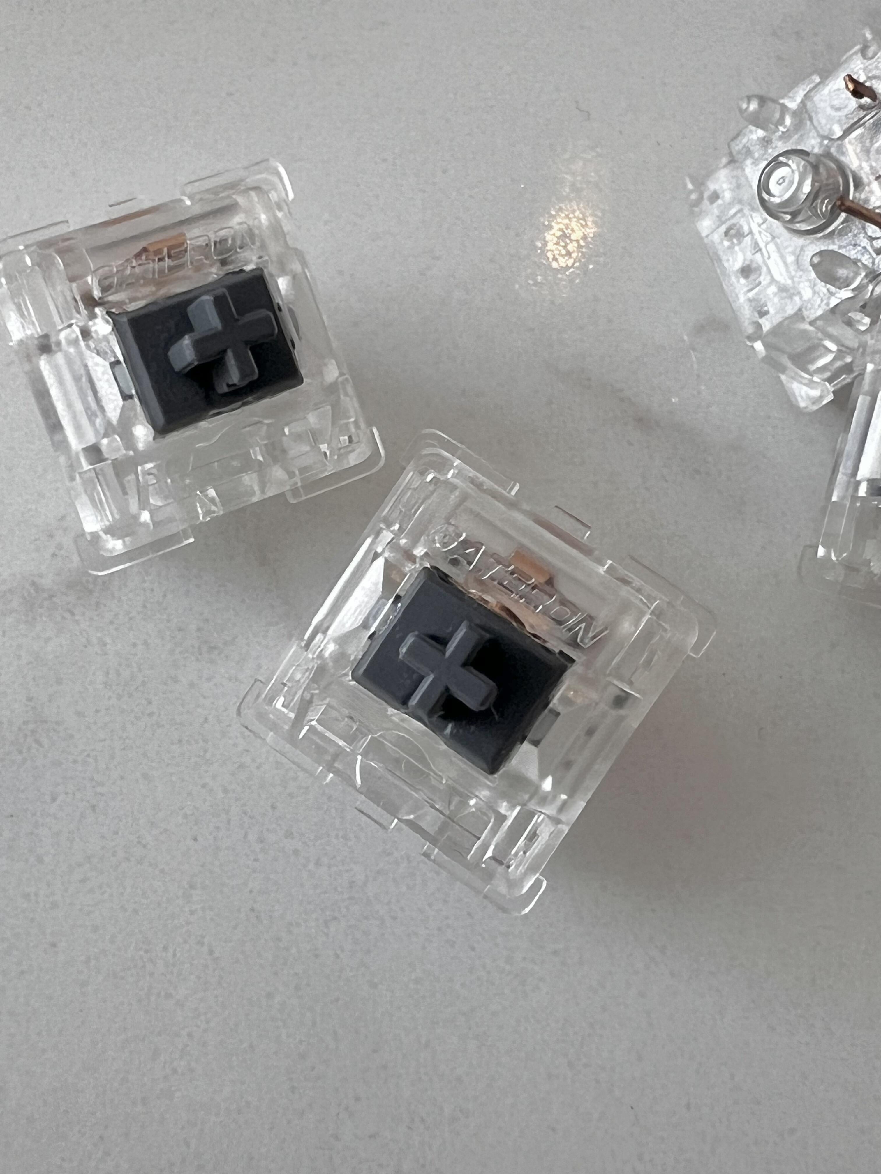

Looks great with Jamon! Also how did you like the sea salt smoothies? Mine from CK had that really good factory lubing that allowed me to use them stock, curious how your batch was before I go & order a bunch of them. Nice to hear the DS adaptive stabs work good too! Got two packs from DK while they were discounted & plan on using one of them for my Virgo. Did you lube yours? I am planning on lubing mine, butextra opinions before you do whatever is always a good thing IMO!
The sea salt smoothies were good and consistently lubed. Very nice switch. As you said before, they are pretty much recolors of the regular smoothies. I don’t notice a slight increase in travel or a spring difference. I’m inclined to think they are simply recolors and the specs are just not accurate.

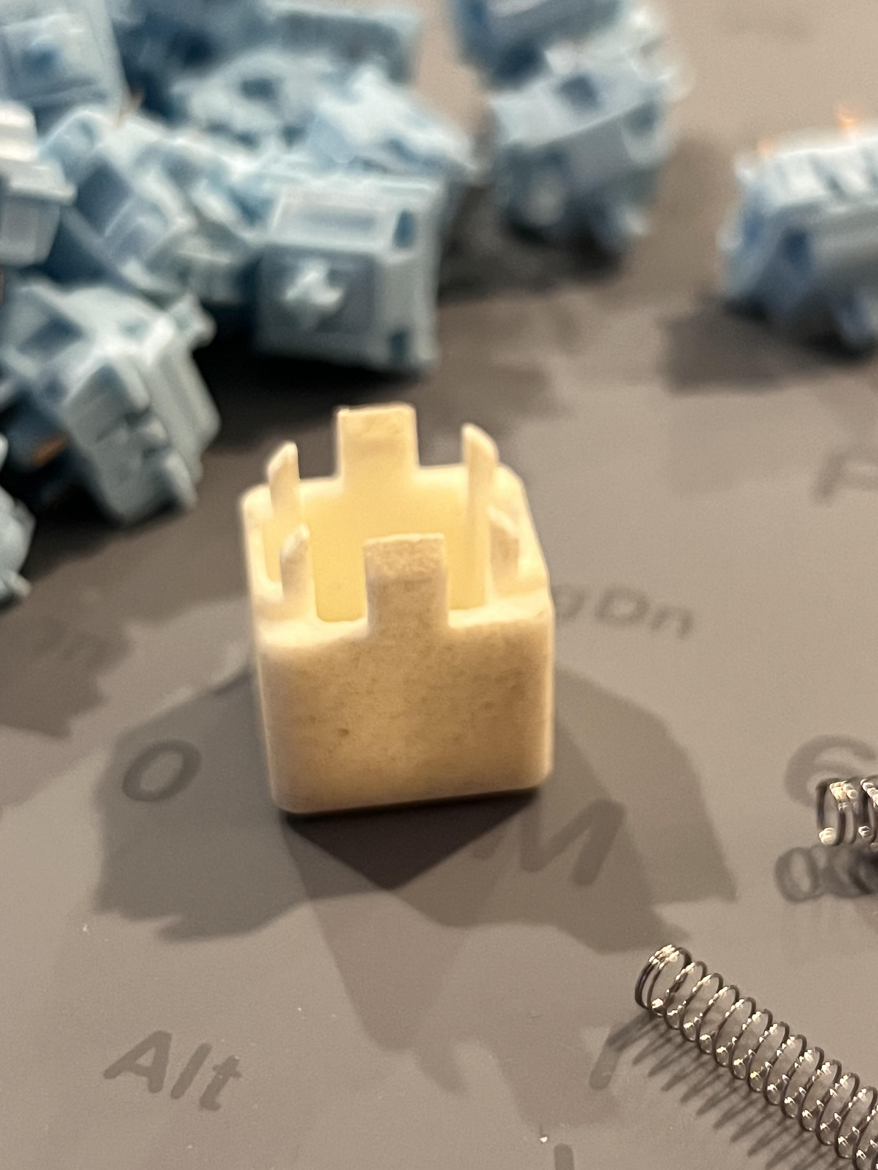

Spring swapping sea salt smoothies. Just thinking about this switch opener and thought I would share. I ordered this for $4 printed from shapeways in 2016. It’s probably opened 10k switches to date. :rofl:
To be clear, I own 6 other switch openers. However, this is the weapon of choice. It never grabs the housing too firmly, so it’s quite fast at the job. The downside is that there are a few switches it just won’t open. But I have other openers in that case.
It’s kinda odd to me. I think some people who make tools don’t actually use them. Similar story with my wing latch switches. I own 3 of those openers. The best one is built into a $10 plastic lube station I got off of Amazon. The other two are junk.

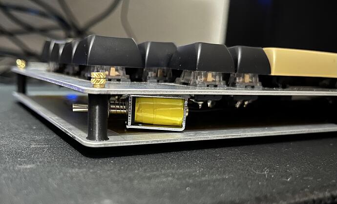

First half of the case is done for the solenoid retrofit. TBF, said “case” is really more of a glorified skirt that will be held onto the structural sandwich with some heat-set threaded inserts. I kinda enjoyed typing on it with the little solenoid clack-clacking away. It sounds less like a big Selectric typewriter and more like a movie sound-effect for a telegraph in an Old West town, and I assume it will be yet more muted once the case is on, but it remains disproportionately fun to make every switch a clicky switch.

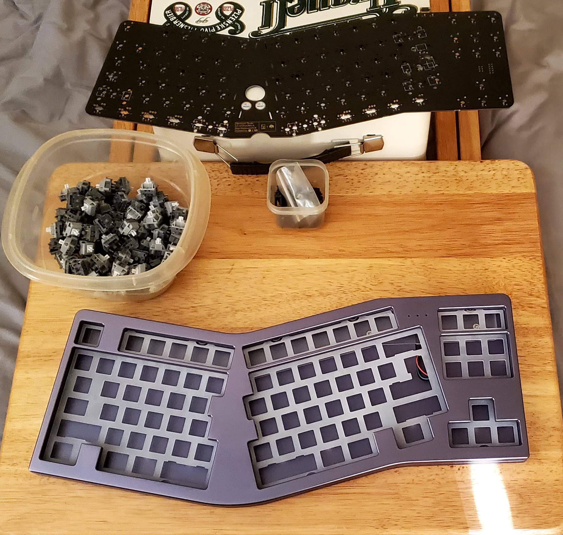

It’s time, finally gonna build my LZ erGhost! Decided on using the PC plate, Stabies V1 nylon stabs (I’ve had them forever now & think using them with a board that only requires 2u stabs should mitigate the issues I’ve heard about them), & HMK Canglan V2 switches. Will report back later once I got it finished up!
Edit: Finished up!
Got lucky with the stabs & the v1 Staebies are working out good for me. Although almost ran into major problem. When I got it all soldered up & went to test it, the JST port on the PCB fell off from me inserting the cable! I was barely pushing on it & it shocked the shit out of me. Thankfully it was just soldered onto the PCB super poorly & all the pads stayed in tact. So I was able to clean up the pads & drag solder it back on. It seemed a lot more stable after that, but I dabbed some hot glue on it also just ot be safe. Not like I’ll ever be able to get a replacement PCB for this, so figure better safe than sorry LOL!
Test the crap out of those stabs before you commit! I have them in a soldered Meridian build which is also all 2u and they ruined it thoroughly. I wouldn’t say they were overlubed, yet even after a while in which lube would have surely migrated and thinned, they still partially bind on press. The lighter the key, the worse the binding.
Will do, thanks for the heads up! I know I could be asking for trouble with these stabs, that’s why I have never used them yet. The only reason I decided to go with them is because all my good stabs are earmarked for upcoming builds (TX & Knight) or ones I haven’t tested yet (Maiz & Designer. Any other stabs I got either are ones I don’t want to use (looking at you Durock V2) or need cleaned + re lubed. Kinda lazy I know, but I’m hoping these will work here. I guess worst case I’ll just use some my good stabs & replace them later.
Similar experience here. Thankfully it was a hotswap board. But I tested several times and after fully built the space bar would bind sometimes. I threw my staebies in the trash. Unfortunately I have some QMX stabilizers that perform about the same soldered into a board. :rofl:
