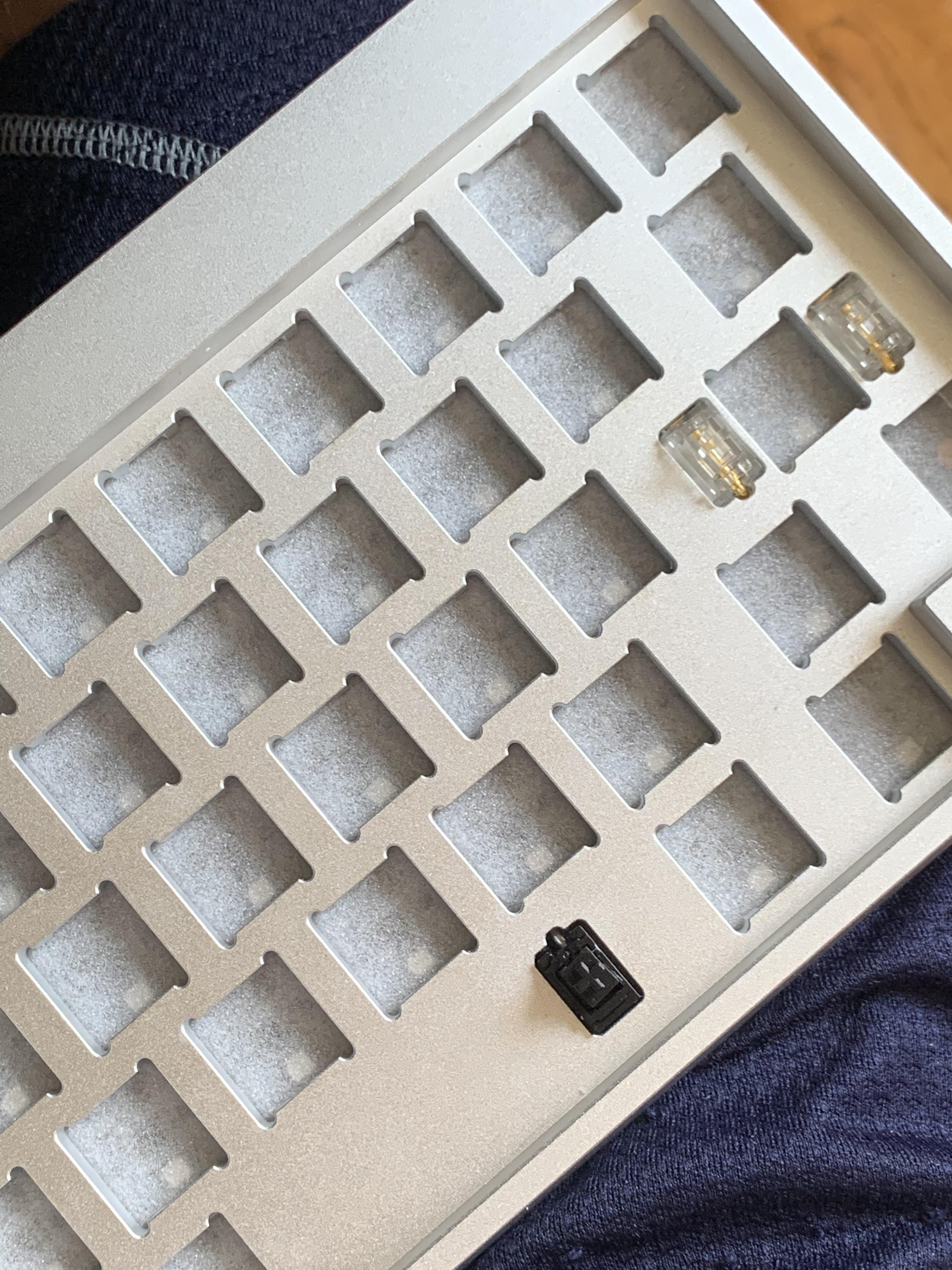

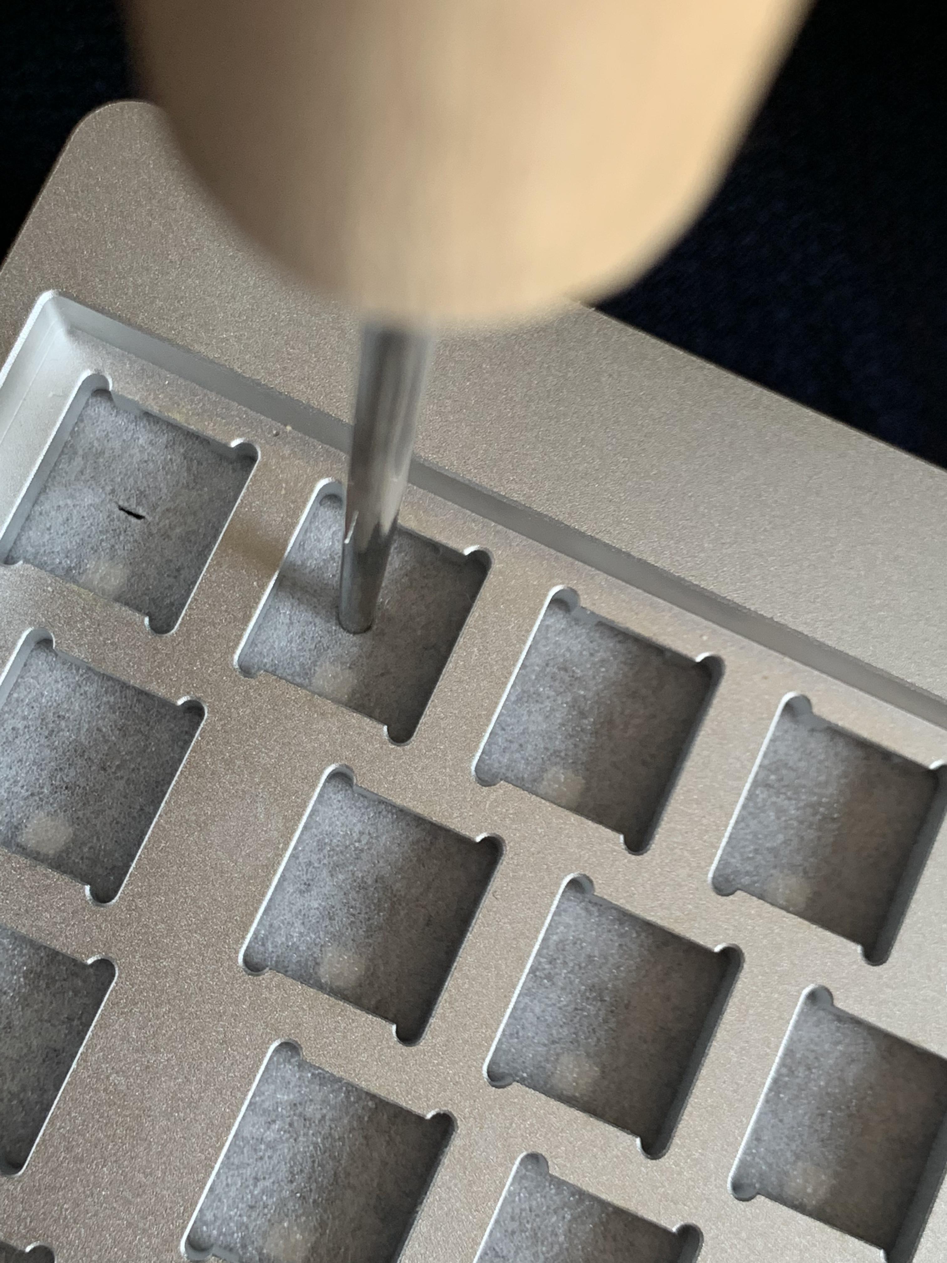

same as @fatalruin. would like to see the internals and how you’re making it fit for now pre-drilling.
Dang that looks awesome, do you have a link? I’ve been looking for something like that

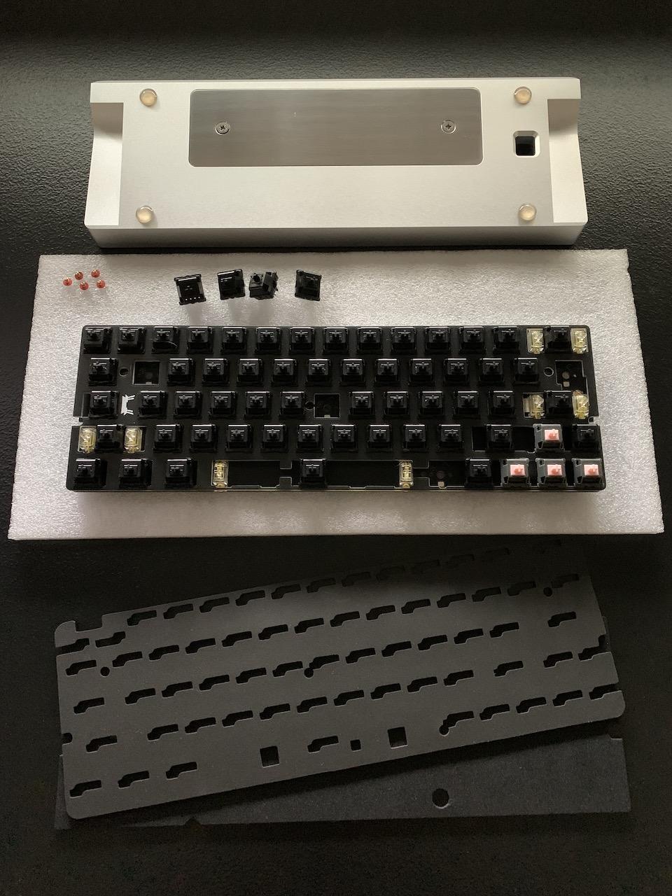

PE foam modded my m60-a
I’ll have to tune the stabilizers another day. I left foam under them and shift & enter are too mushy. Sounds nice. Actually a bit louder yet deeper in pitch.
Foam diffuses the leds very nicely. This is a very fast and easy mod on this particular keyboard. I reccomend trying it if interested.
It’s super cheap but works well if you take off your caps.

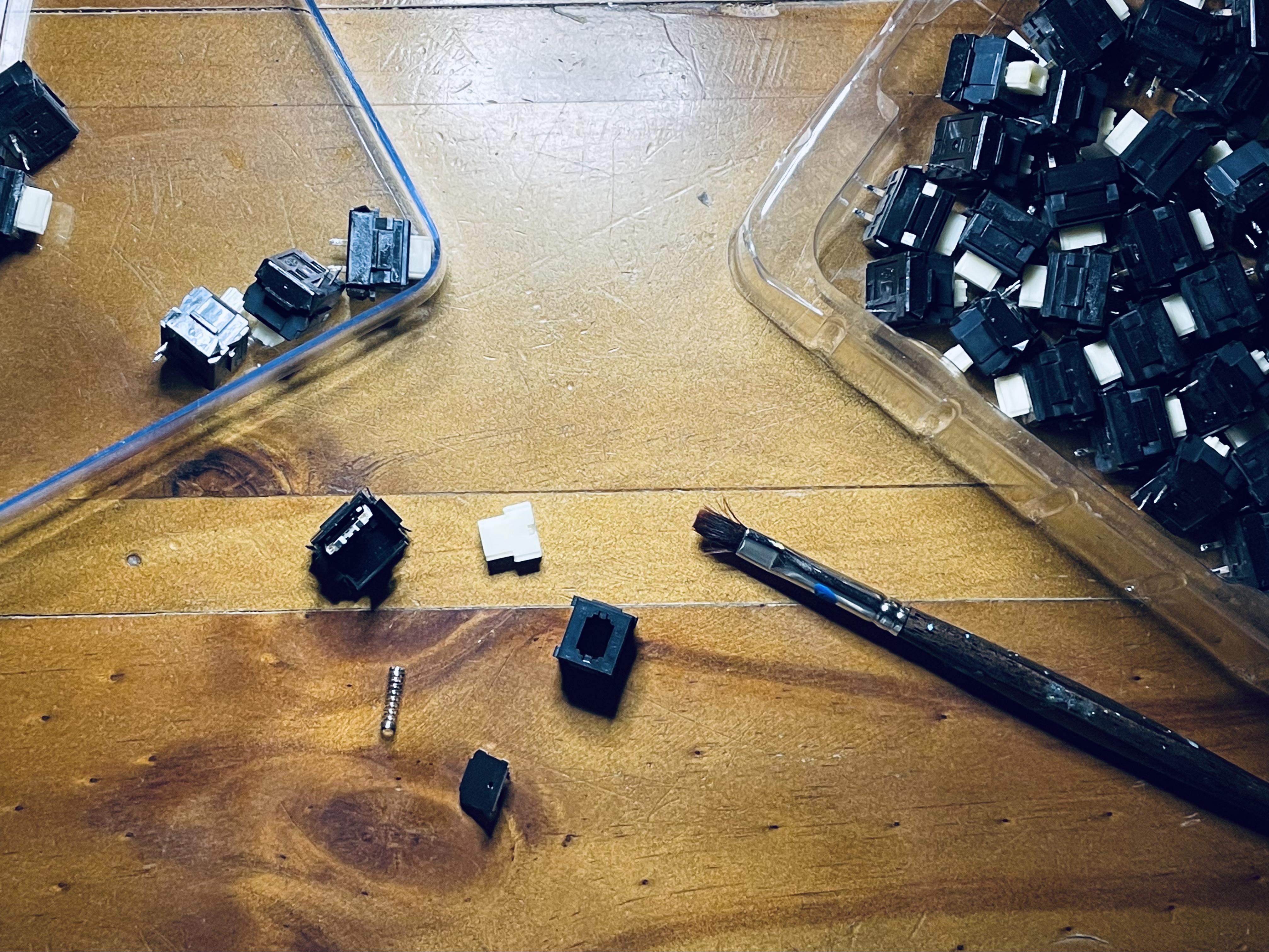

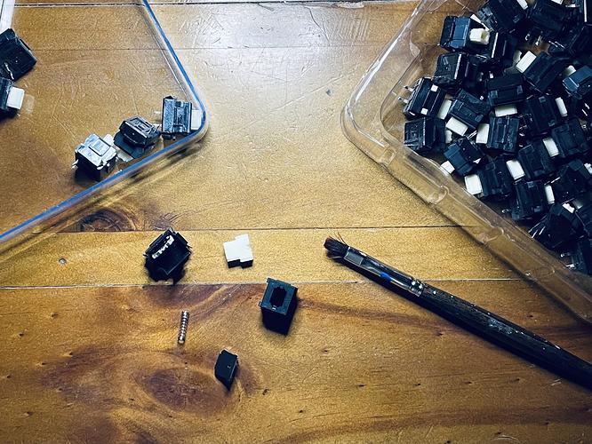

I timed my switch lubing session today, thought I’d post here in case (1) it’s useful or (2) it’s anomalous (in which case, I should likely evaluate my process
). I don’t recall seeing any timings on Keebtalk to compare to, and while this is definitely 100% not a race, I think it would be nice to have a general ballpark figure for how long lubing takes, right?
(Caveat: I was simultaneously watching the Niners game towards the tail end of the session, but I don’t think that affected my timings too much.)
27 Linear Switches
0:15 – Disassembly + Bag-Lubing Springs
0:30 – Lubing Bottoms
0:20 – Applying Switch Films (Deskeys)
0:03 – Placing Springs
1:10 – Lubing Stems + Assembling Switches + Adjusting Films + Testing
Total Time = 2 hours 18 minutes
a) There are obviously economies of scale with lubing more switches at a time, but it also obviously increases the total time, and ~2 hours is a solid chunk of time as it is.
b) I am a recovering perfectionist, so in addition to the usual due care in applying the lube, I do take the time to half-open every switch at the end and adjust the switch films so they all sit flush with the switch edges.

Do you ever test the whole batch for consistency or is this just me? Like I purposely lube a single switch with the upmost attention to detail as a sort of high-water mark to hit when lubing the rest. I tend to lube lazily near the end I guess.
I feel ya, the tedium creeps in
Re: testing: Yup, I test every switch with headphones on for push-feel consistency, and I test random ones with my headphones off for sound-consistency. I haven’t had to repair/re-lube any switches for a while now (knock on wood), predominantly because my process (incl. amount of lube, order of lubing parts, etc.) has become fairly consistent.
Reducing the batch count (e.g., 70 to 25) has helped with maintaining consistency, because there’s less ennui towards the end. I also think the timing of a lubing session makes a difference. I try to do it when I want to zone out and clear my head, and sort of like vacuuming, the monotony helps with that.

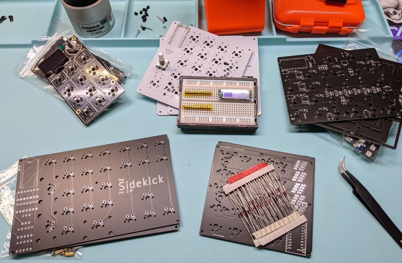

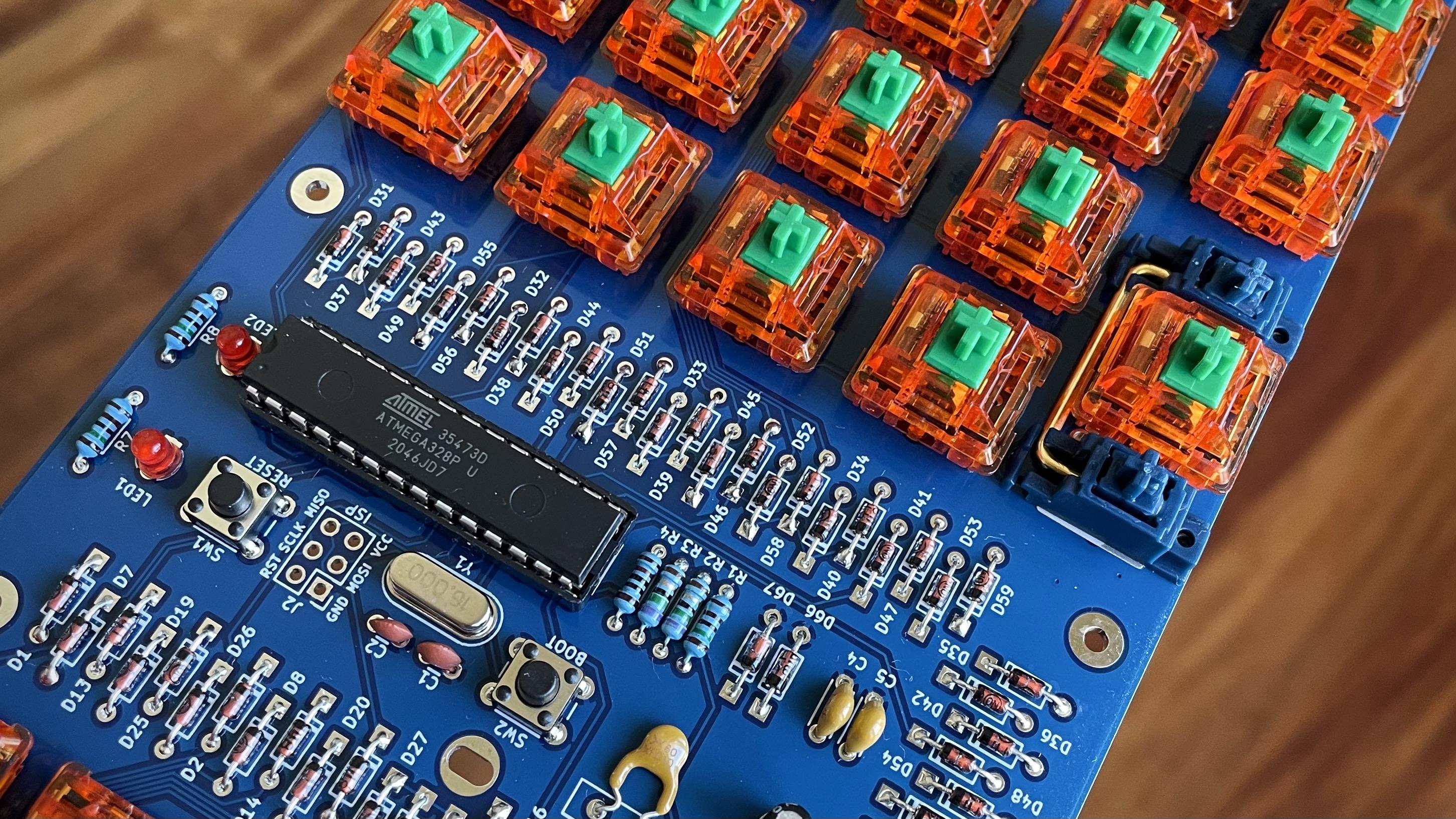

It’s a Macro-pad Sunday extravaganza!
In which I try to finish all these or go mad trying.
From Top to Bottom, Left to Right;
- Adafruit Macropad
- Doodboard Duckpad
- Mechwild Murphpad
- Clawboard The Sidekick
- Key Hive Maypad
I’ve got one more to finish too, but I need to order some parts to complete it so it’s not in this weekends attempt.
