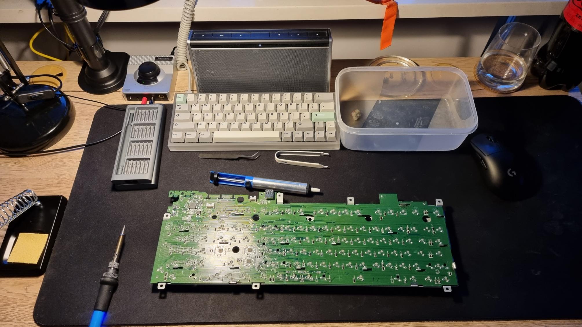

I also started with de-soldering - once you get through that and jump over to soldering it will be like easy mode!
Looks like I was playing Baby mode with the Pain 27, can’t imagine what an entire board would be like…

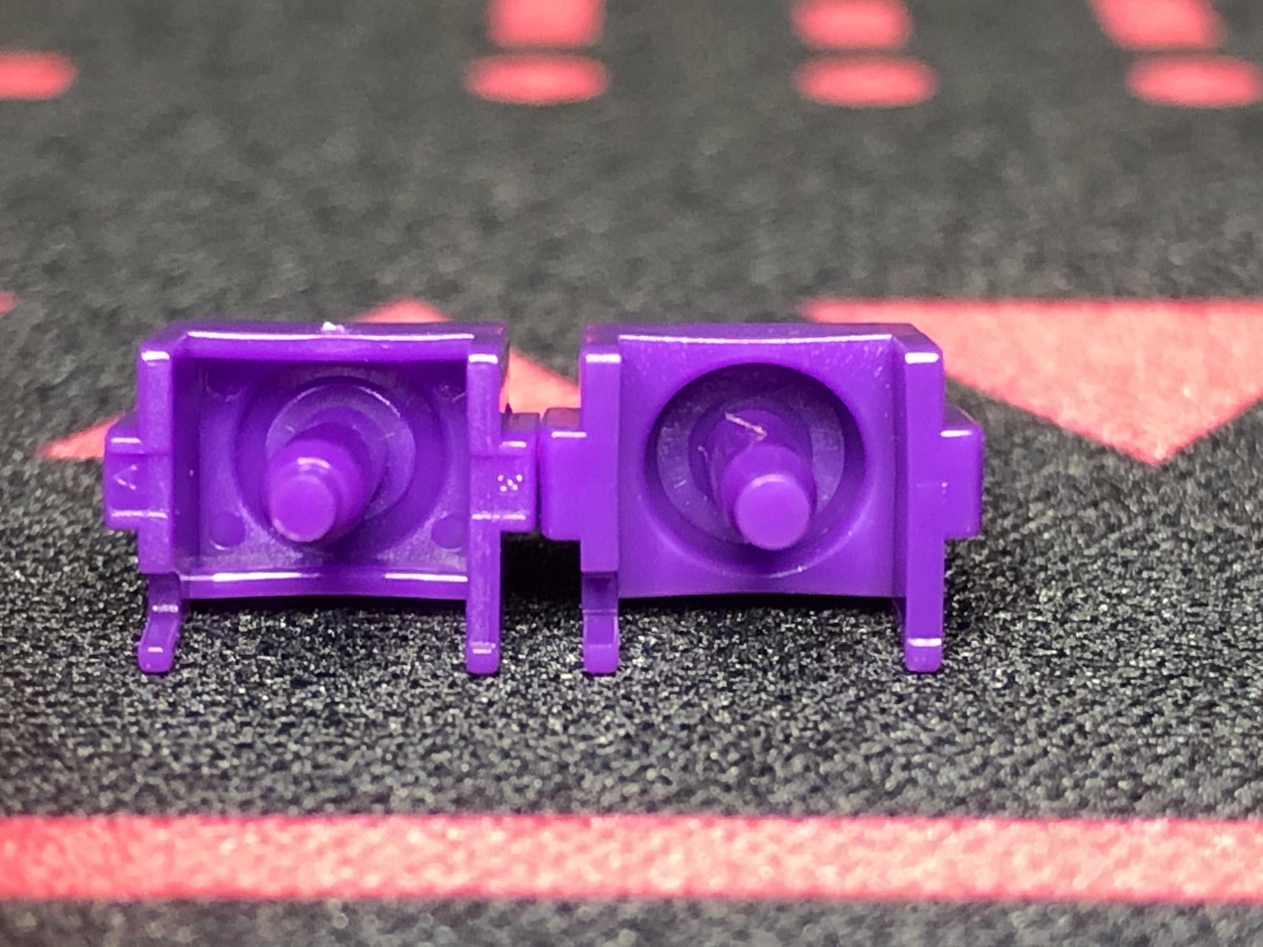

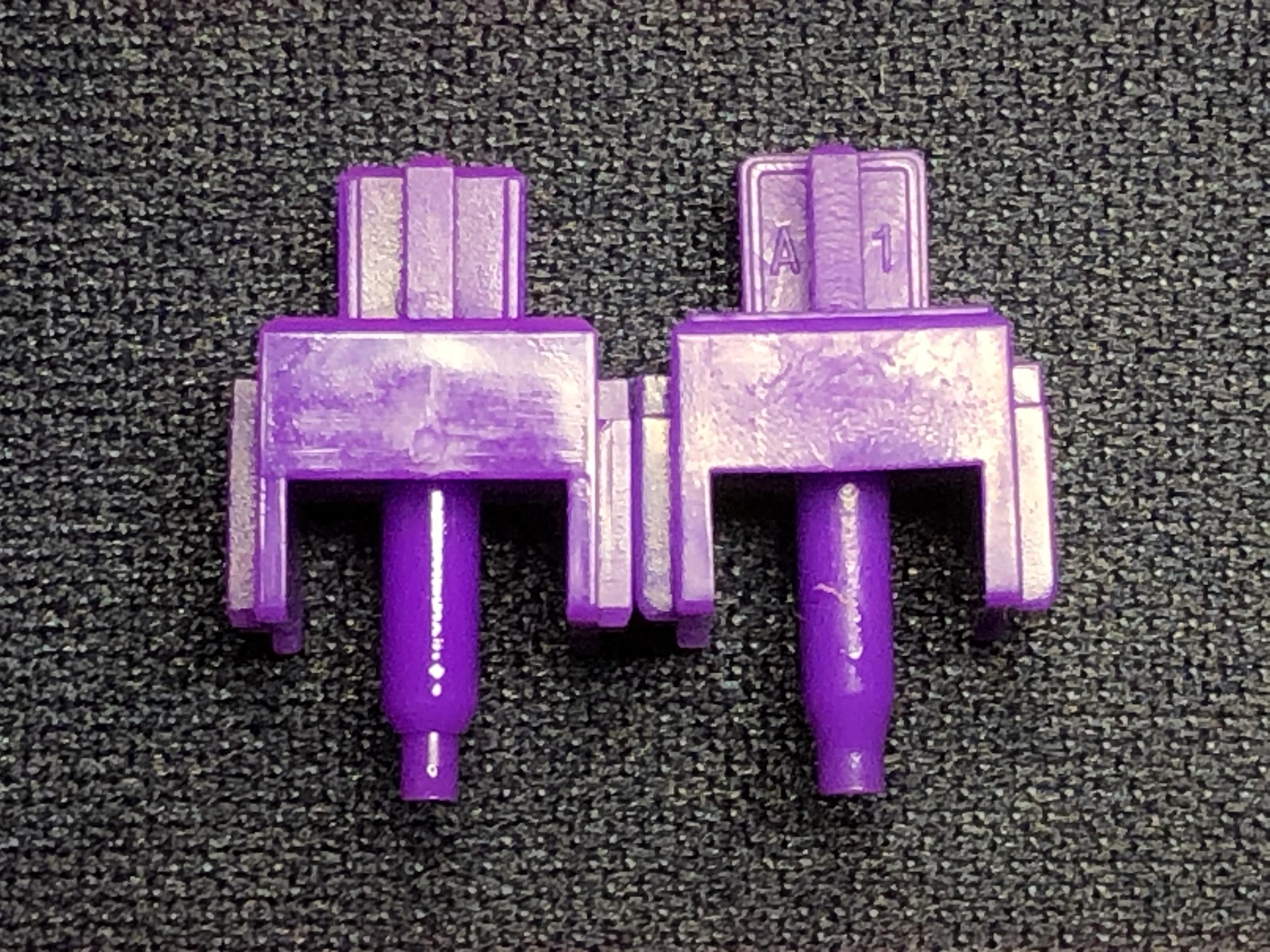

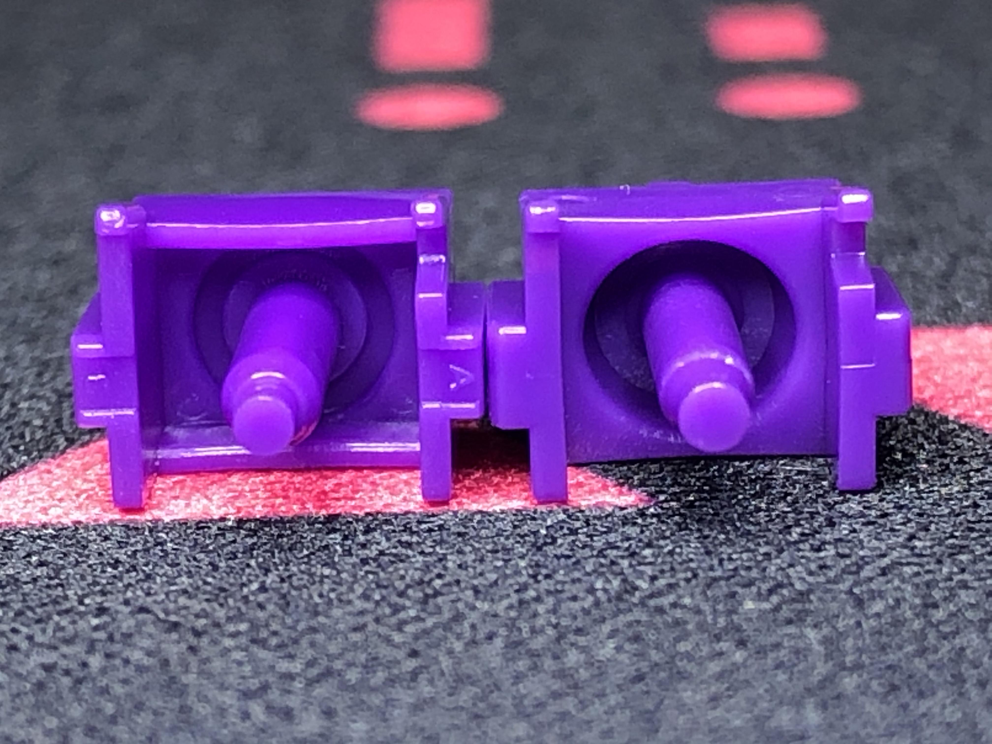

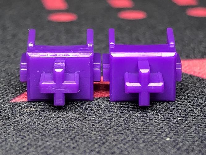

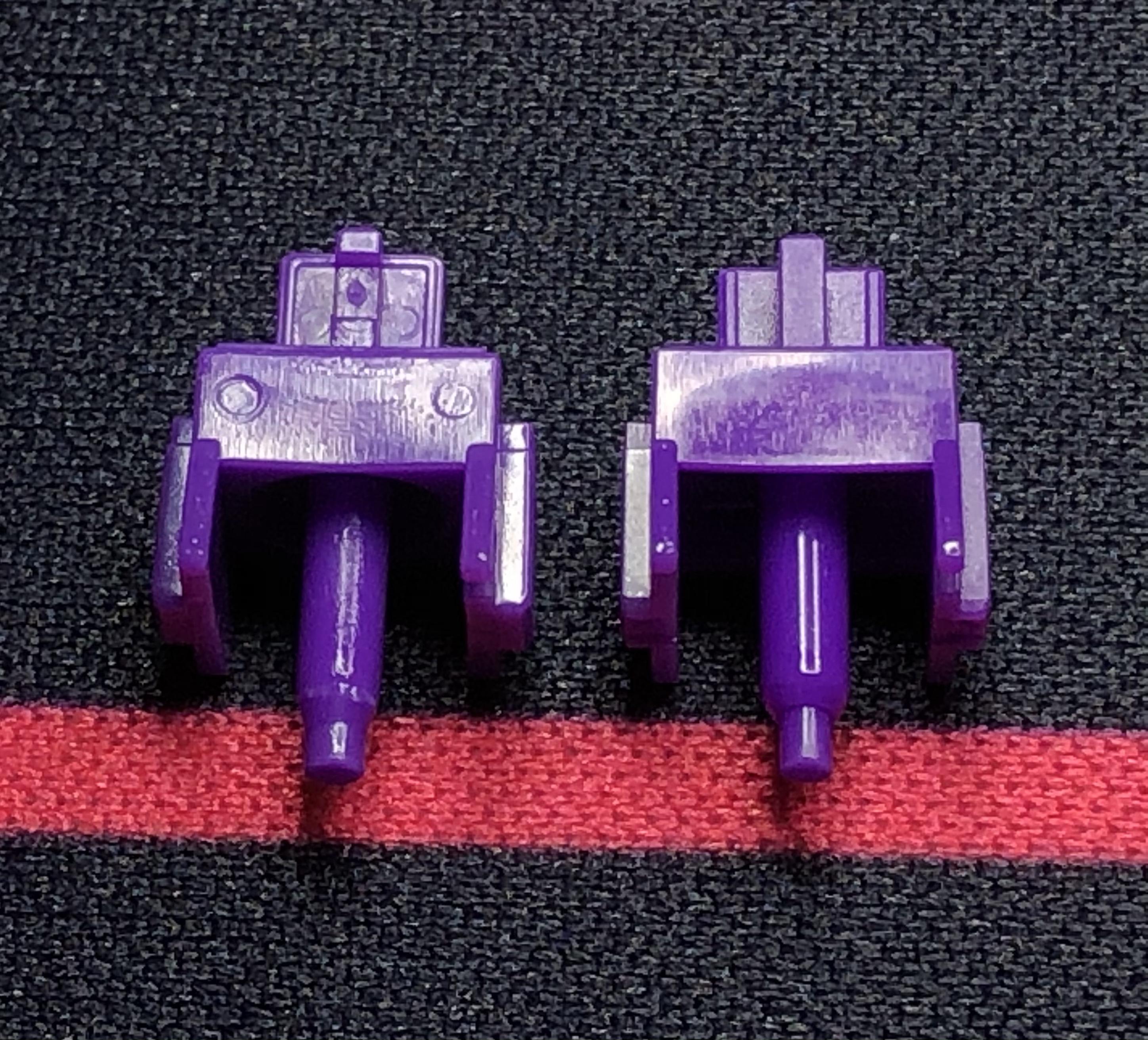

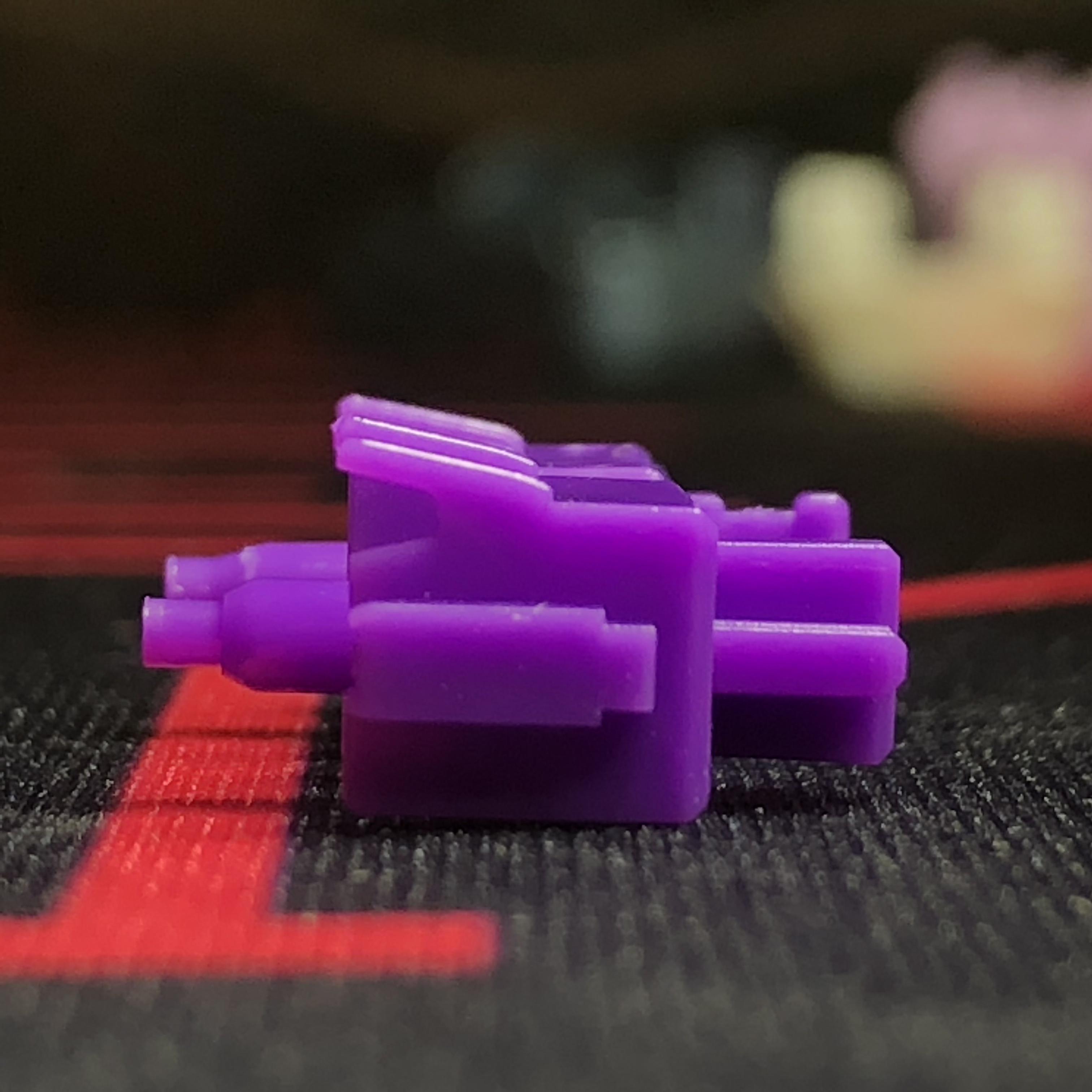

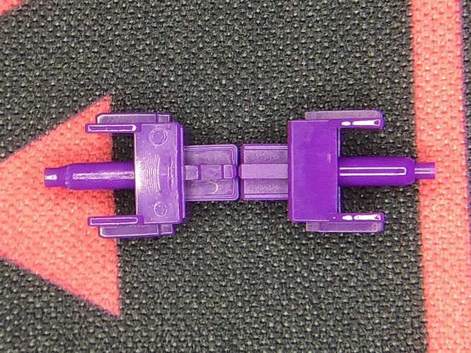

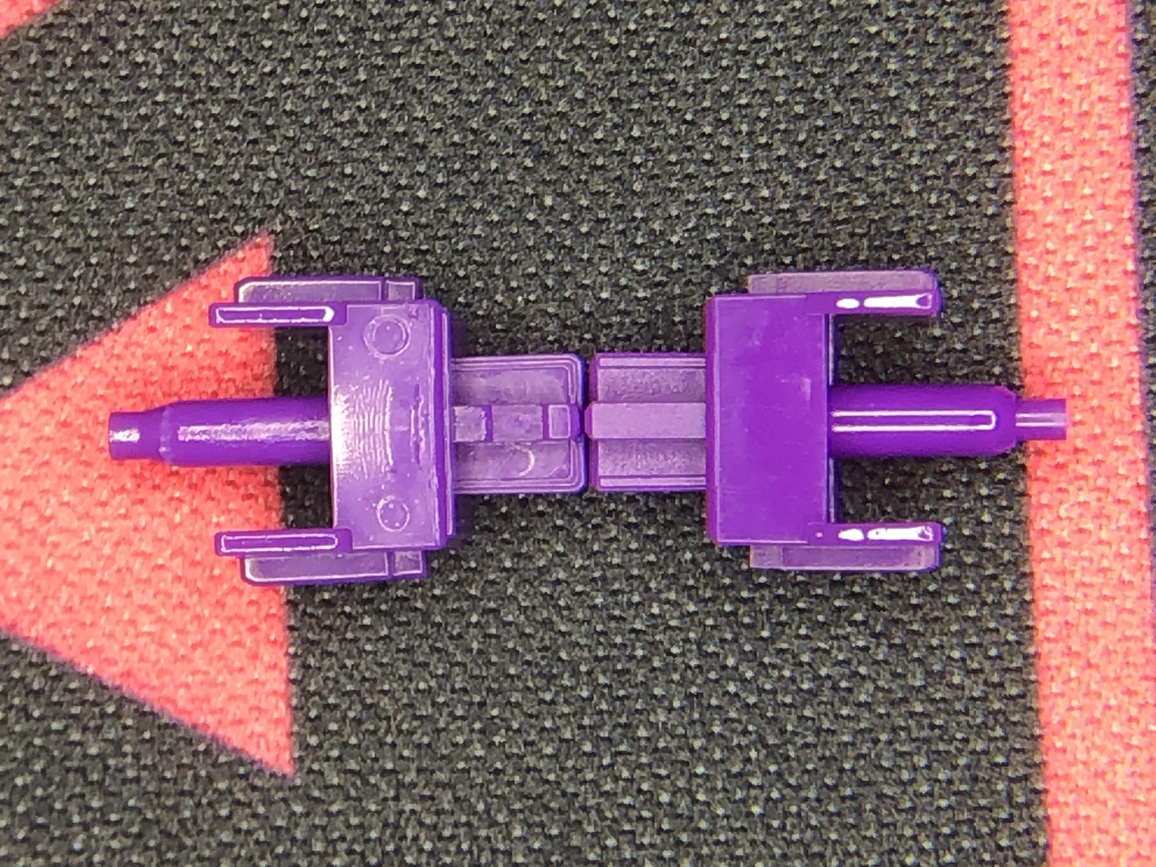

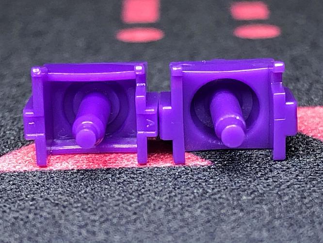

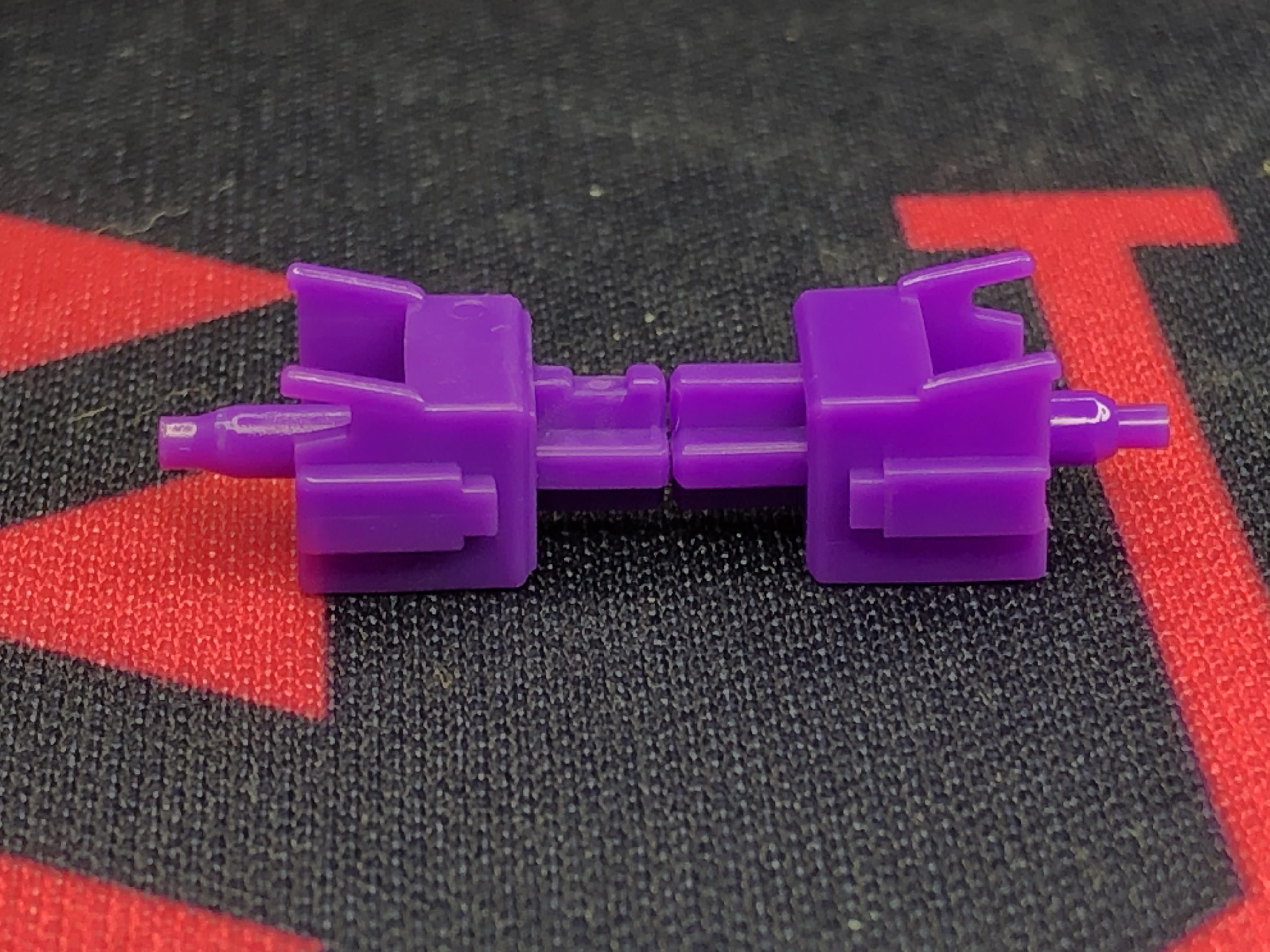

I happened to compare the stems from my *nixdork LTs with the LT stems I got by themselves from Gazzew directly months before - they’re very similar when it comes to points of contact but very different when it comes to details.
*nixdork on the left, “naked” on the right
End to end.
Comparing the legs; older one’s pole seems a hair longer? Maybe not.
Fronts again. *nixdork still on the left.
Closeup at the top cross mounts.
The undersides - the *nixdork is on the right this time. Clearly different from this angle.
Flipped over, a bit different focus.
Backs - *nixdork on the right again.
I’m guessing one of these two are in the stock / complete Boba LT switches that some folks already have their hands one, and presumably will be more widely available soon - though I’m not sure which. If I had to guess I’d say the one found in the *nixdork, especially since it has the same lavender bottom the Boba LTs do, but who knows!

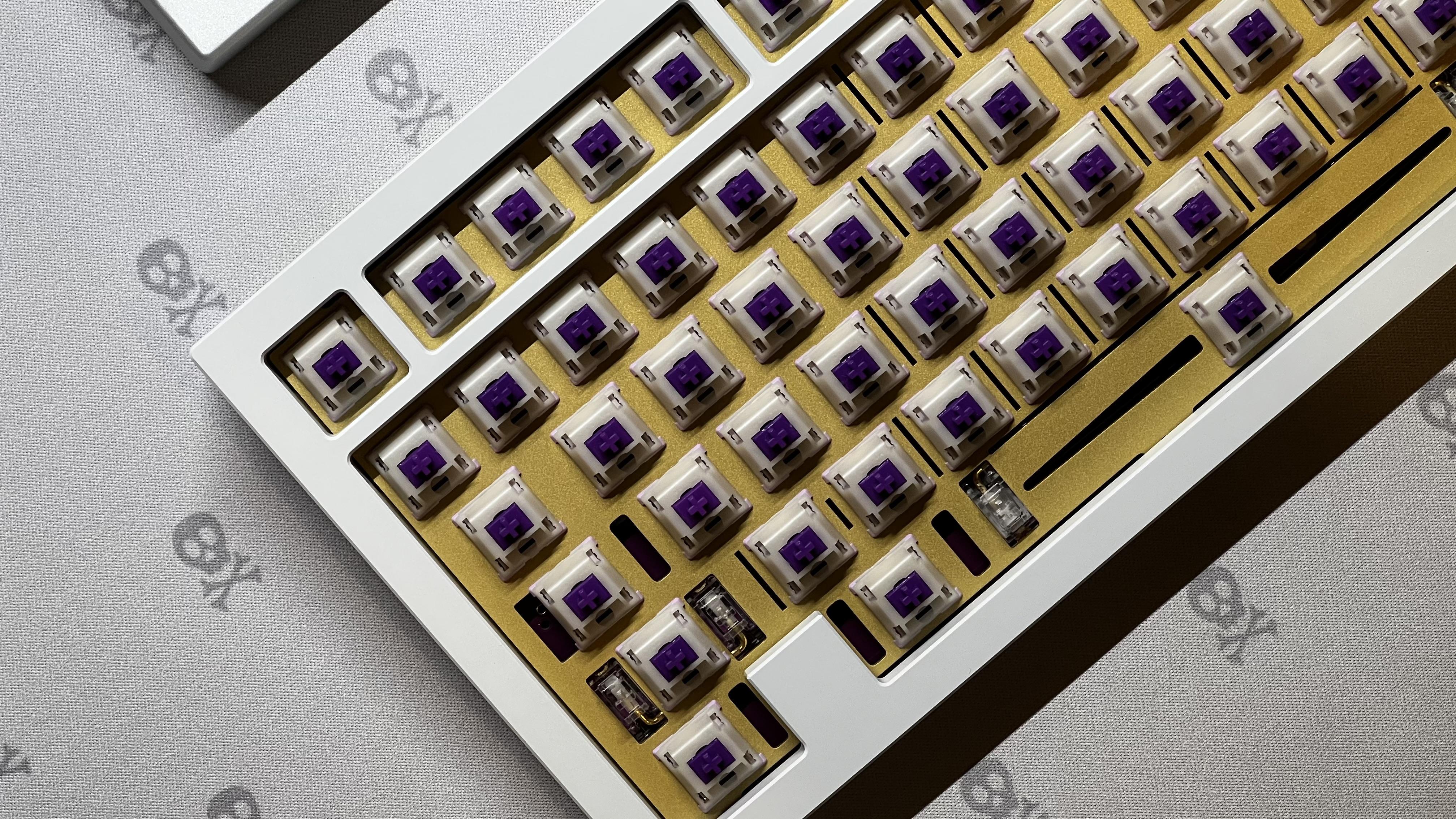

Okie dokie, I put the *nixdorks on a brass plate. These are very nice.
It feels soft (but not mushy) against the brass plate with a wonderful deep tonal quality. It sounds like a tactile but feels like a linear (win win!). I’ll see if I can rig together a recording setup.

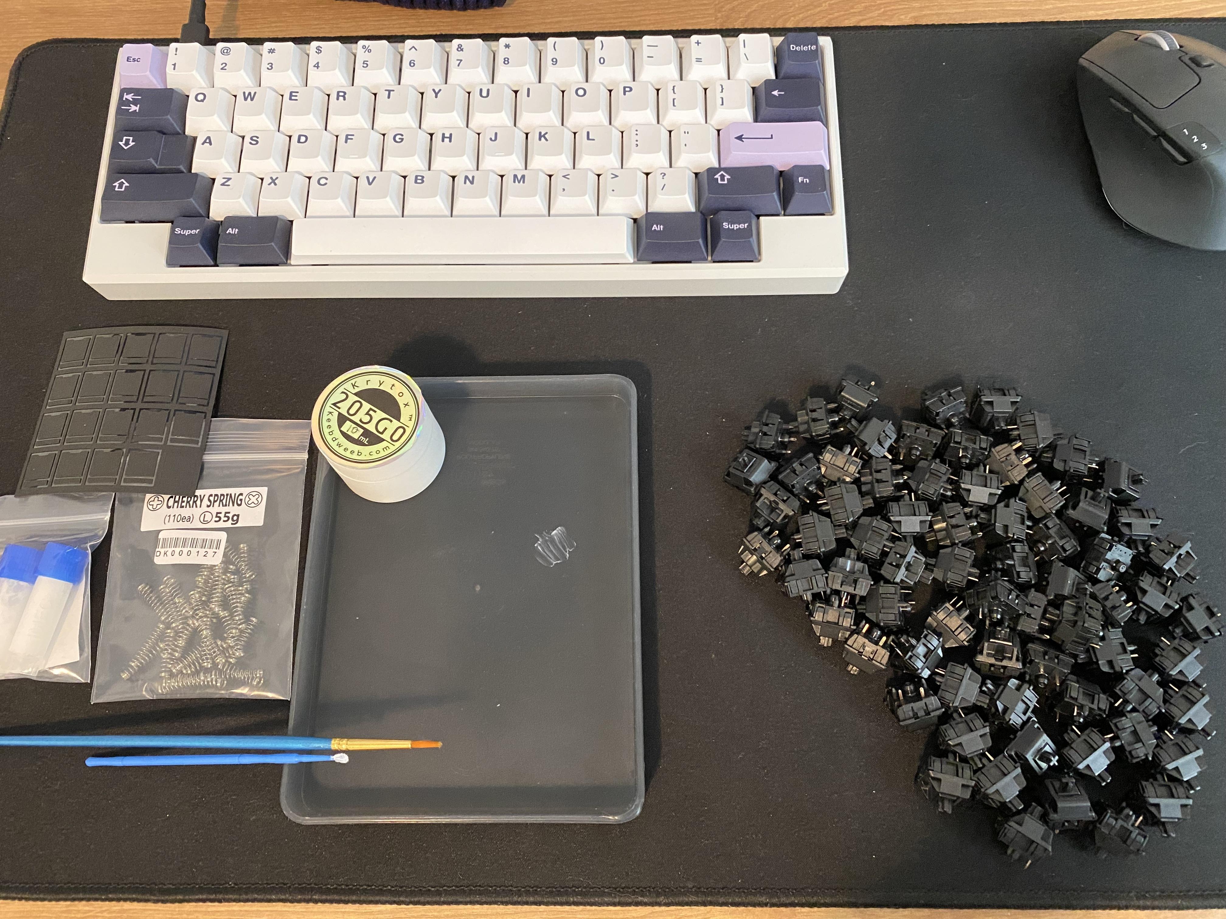

Small victory: took me two and a half weeks but I finally finished spring-swapping, lubing, and filming my polished MX Blacks. I’ll do a more proper write up of the polishing process and results when my brain is a bit clearer but I’m really happy with how they came out. Now that they’re finished, I can work on (again, probably slowly) assembling my Kei!
If you’re going to be soldering polished switches with a plate that doesn’t allow opening switch tops, be sure to test each before soldering. I use a hot-swap board to do this.
As to why, polishing and cleaning may have moved polishing paste residue onto contact point which needs to be removed (using alcohol or water). Only had this happen to a few switches out of hundreds but it could happen.
That’s an excellent point! Thankfully, my rolling wave of indecision plays in my favor here because I really only use hotswap or millmax boards. Still, that’s a crucial call out for anyone else going the switch polishing route. I’d be…less than happy if that occurred if I was soldering and would feel the same for anyone else in the same situation.
