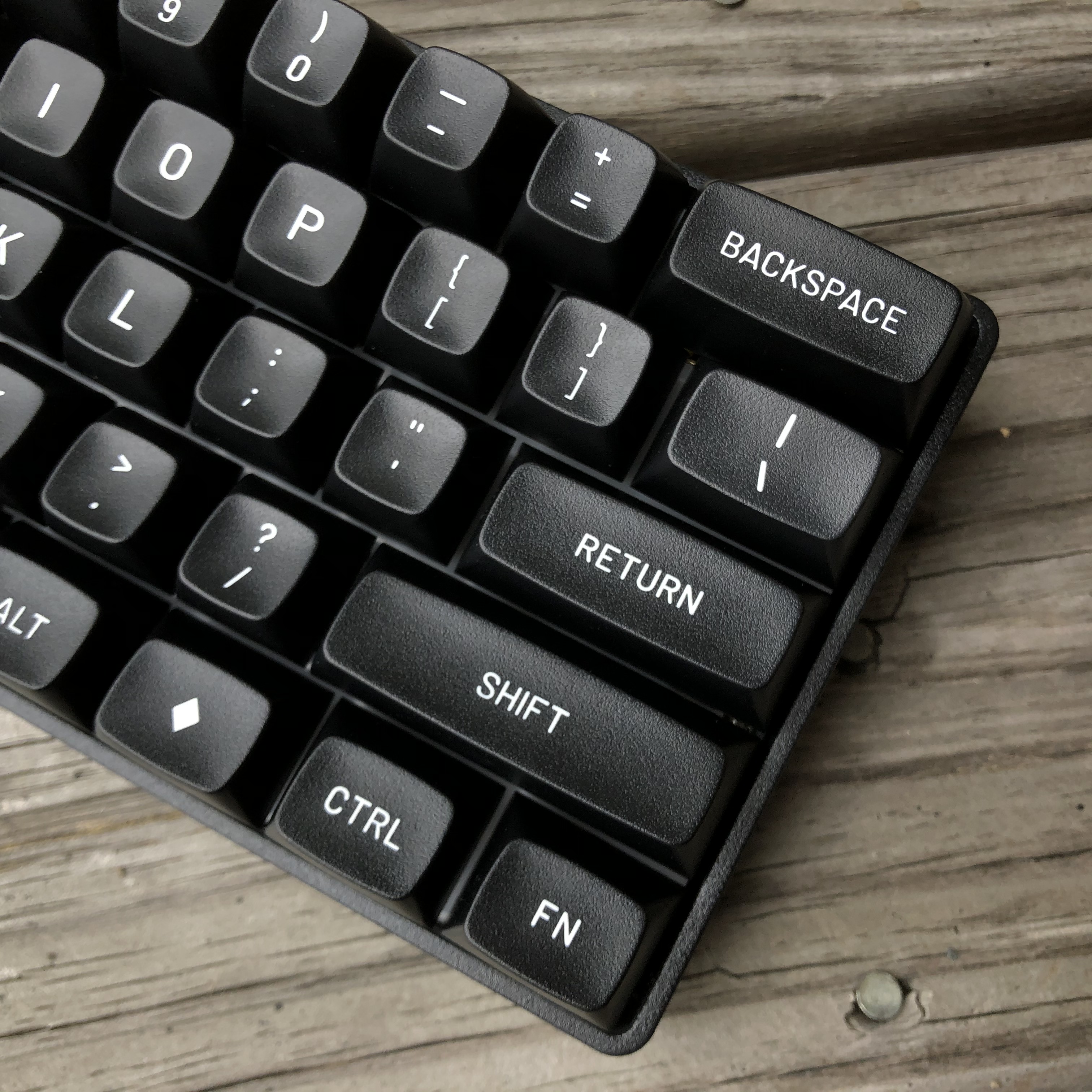

Technically this was on my workbench a few weeks ago; I’ve posted a new build log to switchbox.studio alongside a minor style update.
This minimal 60% with smooth, strong, silent tactile switches is a perfect remedy to the rattly slabs of plastic provided to the IT department.

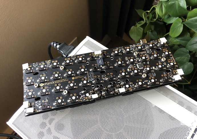

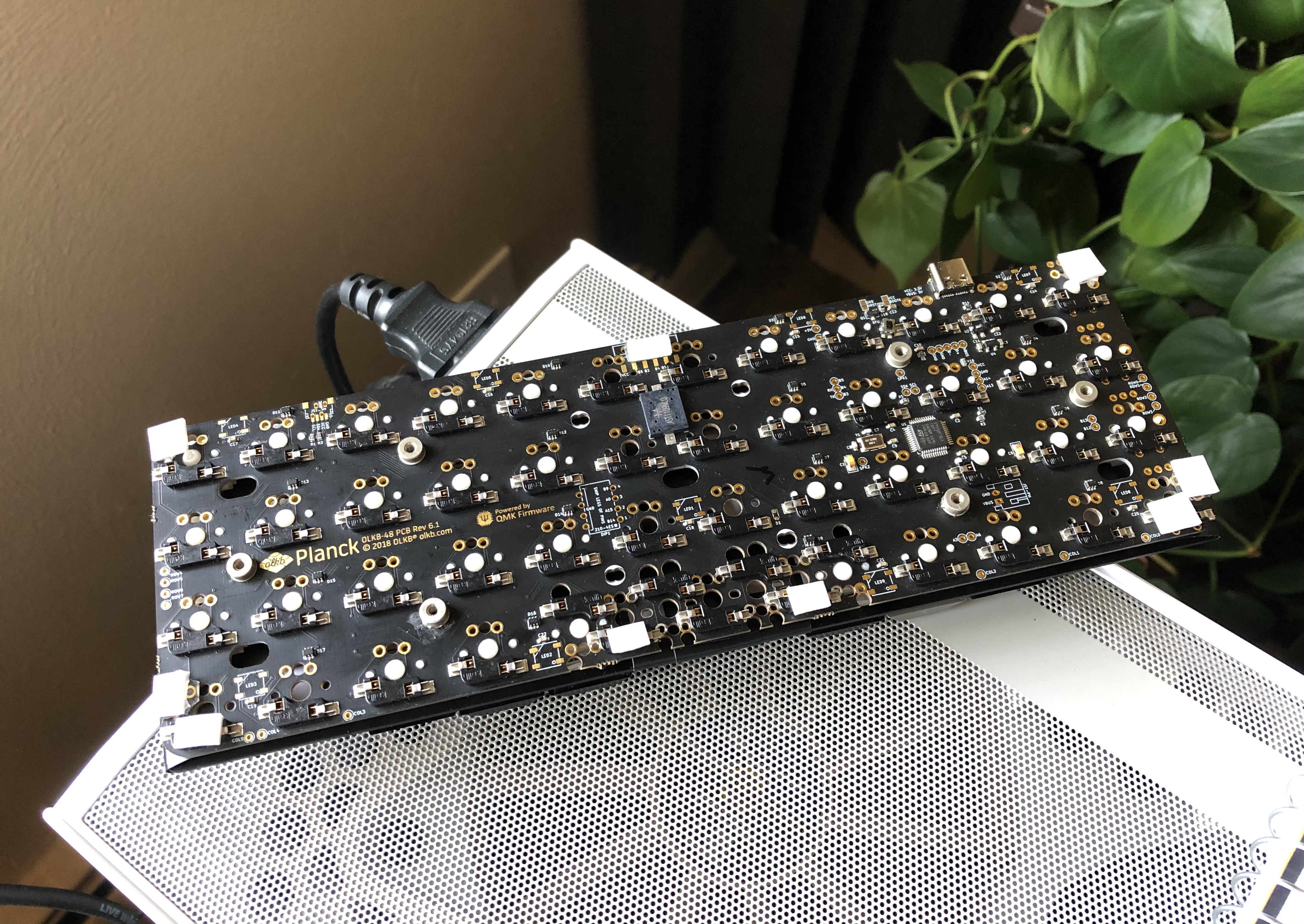

Poor man’s gasket mount Planck via rubber bumpons and double sided tape. Kinda jank, but it isn’t visible and the board sounds a million times better now.

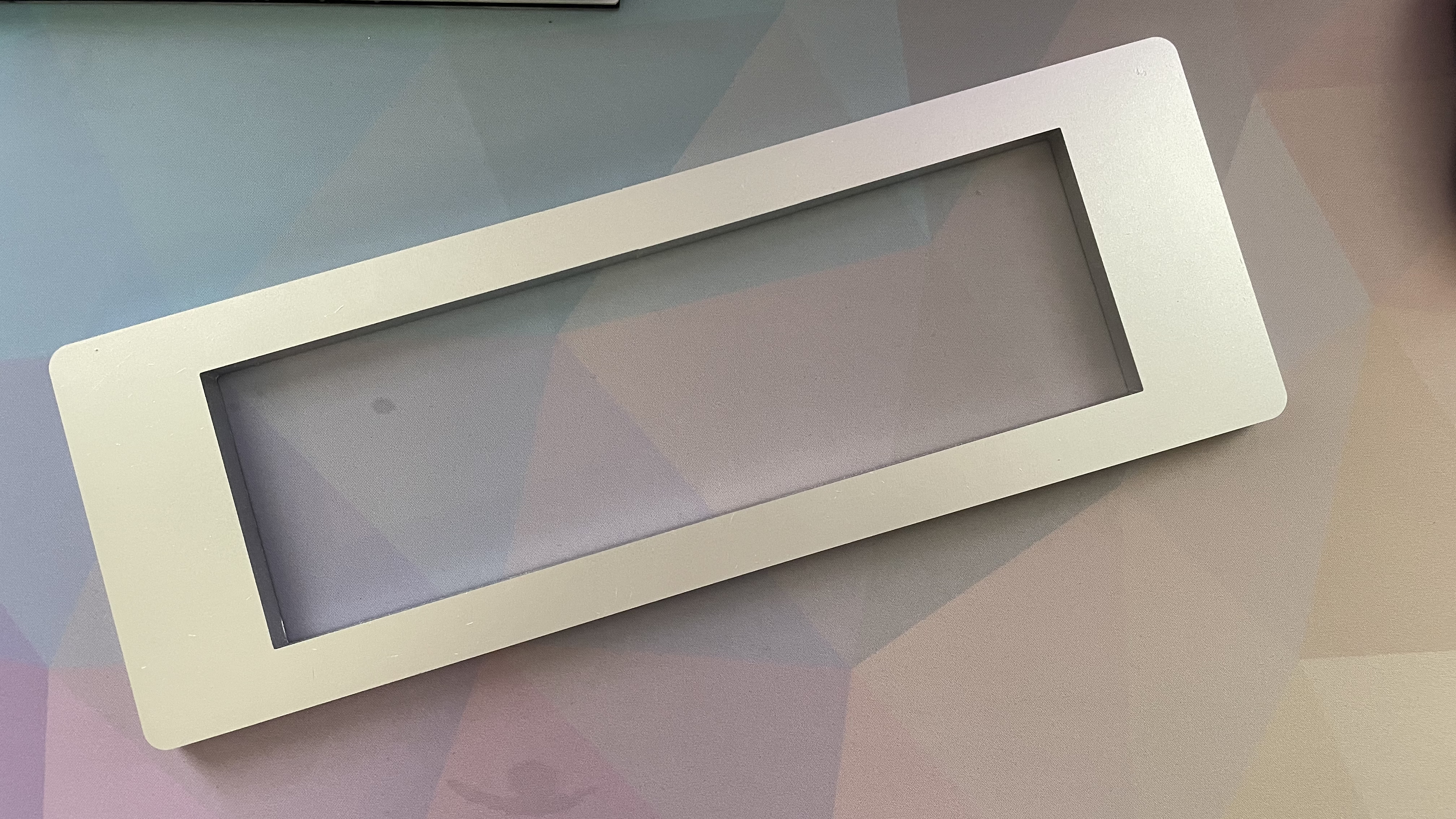

On the workbench today - the beginnings of a very rough, draft of a faux-Extent with simplified construction. I can’t afford a real one and it is doubtful it will ever run again.
Already a beaut of a slab, where did you get that cut/what tools are you going to use to get it in working order? looks like a helluva project.
Someone mentioned in a discord I am in that they teased a second round on Facebook :man_shrugging:
For the prototype I am using primarily mild steel to keep the cost down. I painted it to prevent rust. That is a laser cut half inch thick top plate. I plan to tap holes in the bottom to attach a simple Delrin/POM tray mount to it with a channel for USB.
I don’t have a lot of time to work on it so it will be awhile.
If the prototype works out alright, I will do it right with stainless steel and bead blast it, etc.
By the way, the top piece alone weighs 2.6kg (5.7lbs) so I doubt anyone would want this it is too heavy to be practical. Just a fun project to work on over the summer.

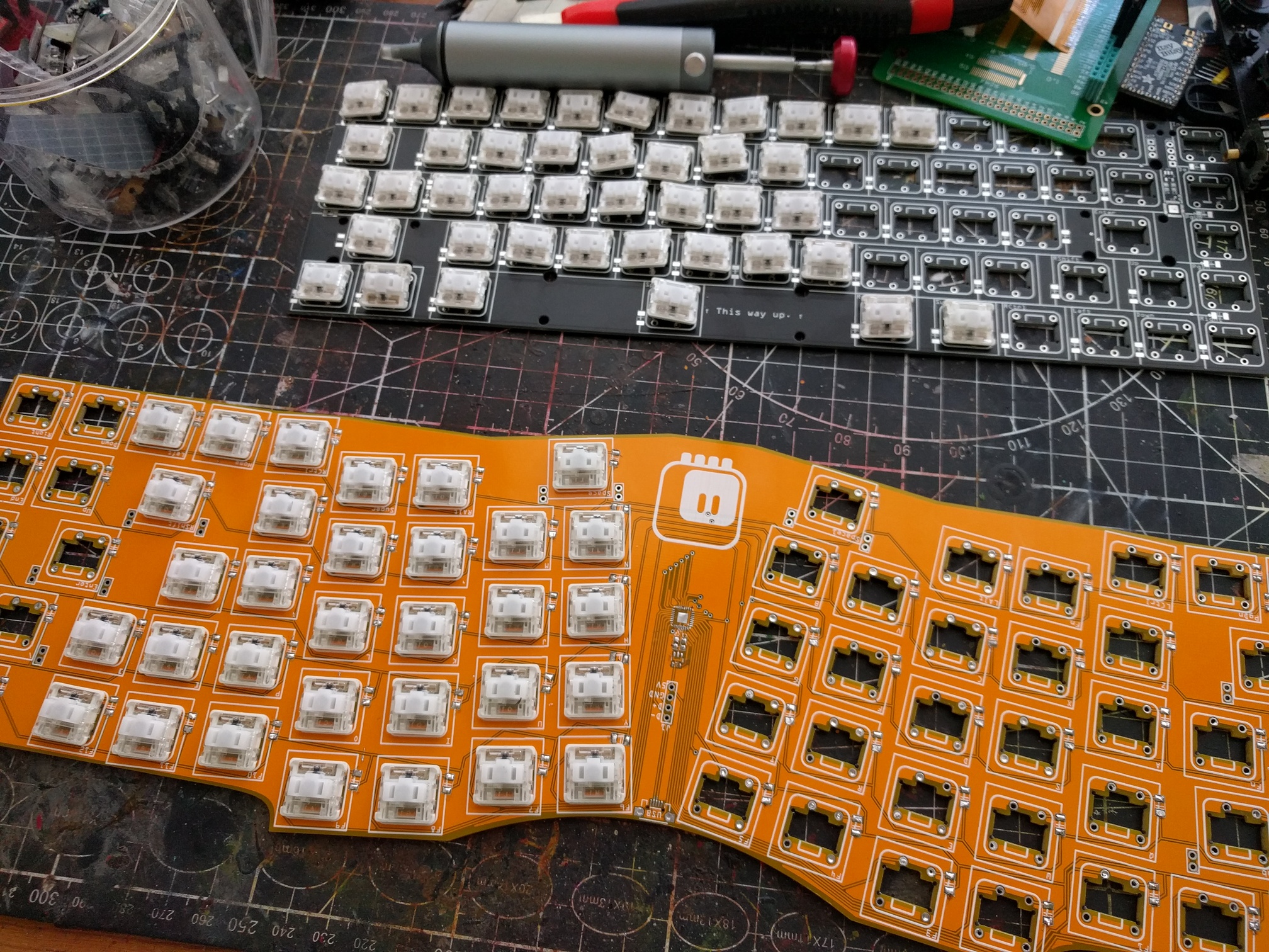

Transplanting switches from one failed project to another (older) failed project, because I think I have an idea about how to rescue it. My fingers already hurt from prying the switches free.

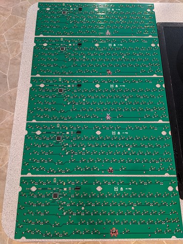

The adventure of these nt980 pcbs were on a different post but finished flashing and soldering them this morning.

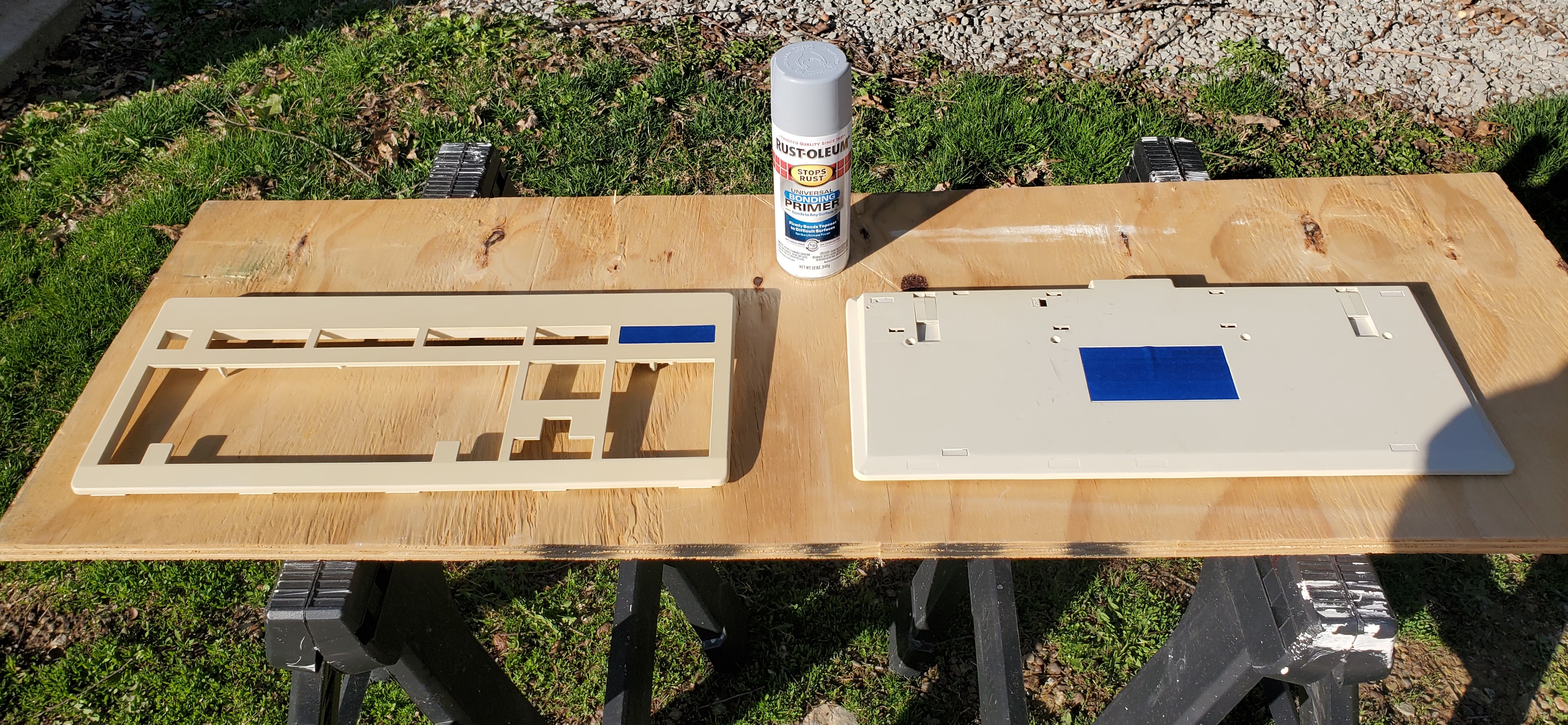

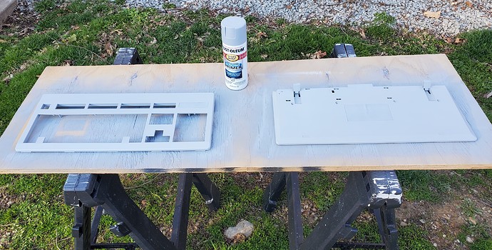

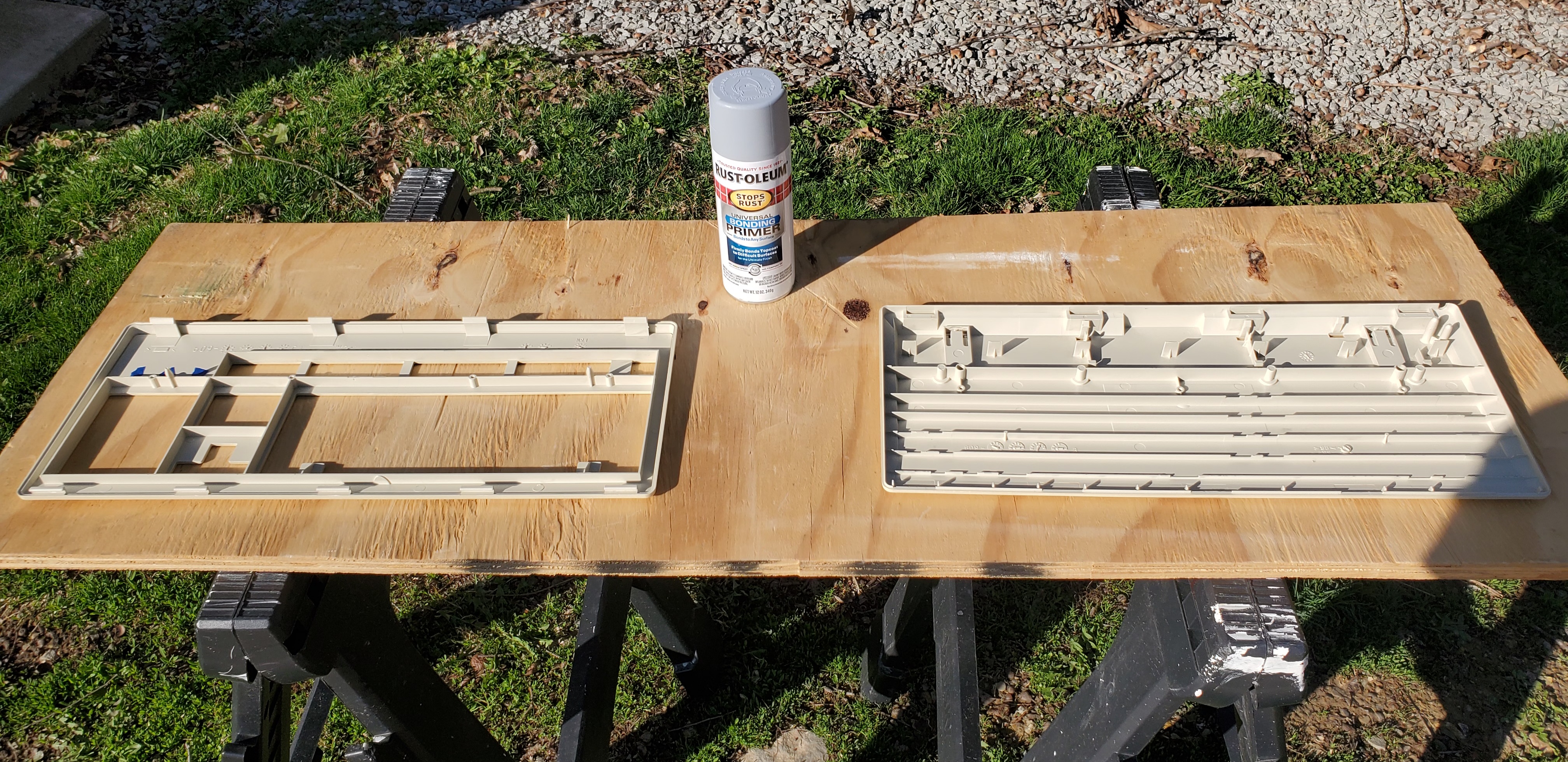

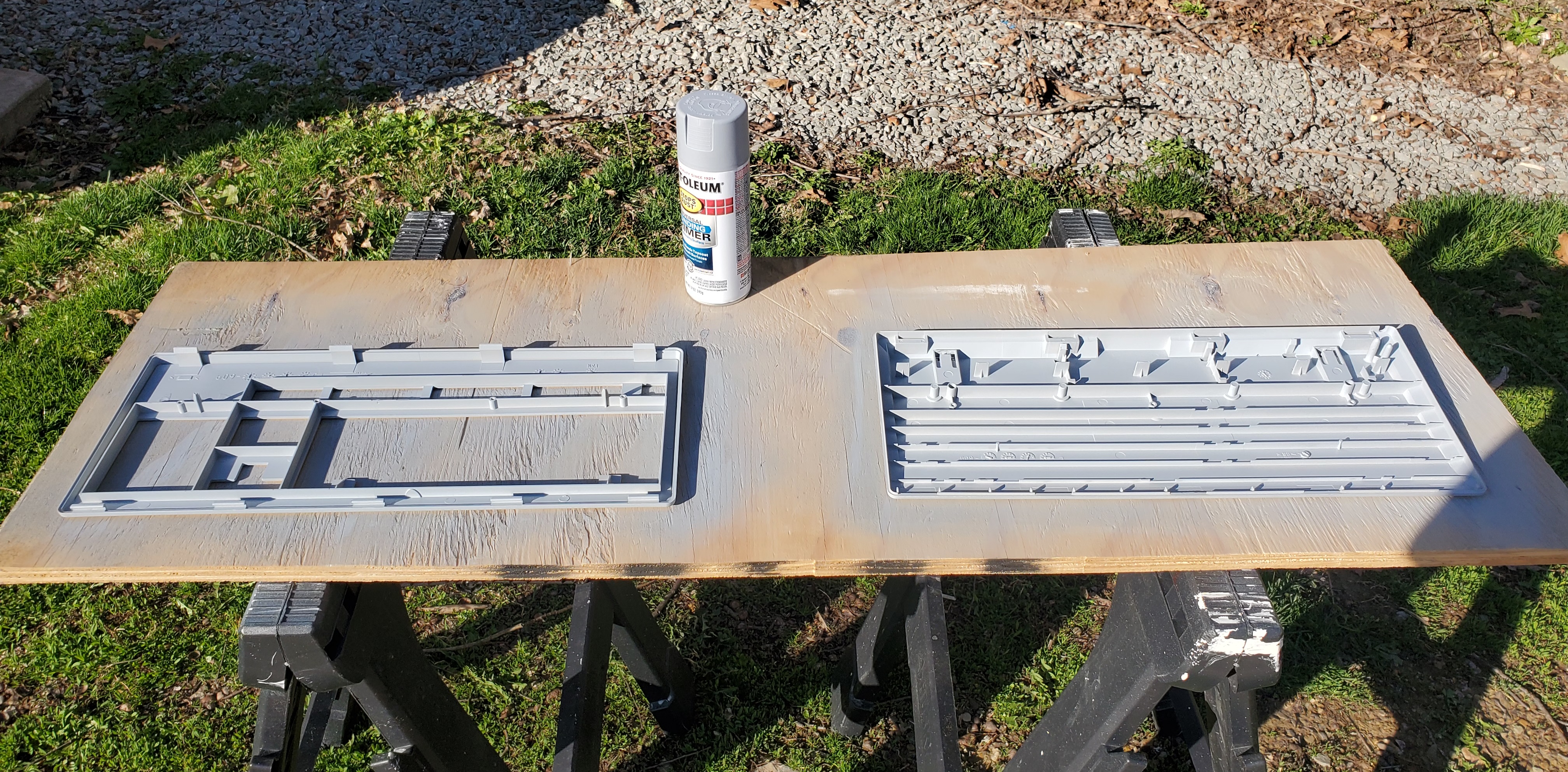

Got the case all prep sanded & washed off, then the painting party has begun! Got the first coat of primer on the inside of the case, next will be the outside. Then if I can get away with one coat of primer I’ll fine sand it & wash again, do 2 to 3 light coats of the paint I got (Smoke Grey color, very close to NCR grey), another fine sand & wash, then 2 to 3 light coats of a satin clear coat! I’m hoping that process will make for a very even & durable coating.
Edit: Outside of case primed now too, gonna let it cure overnight to see if I need to do any wet sanding of the primer before I start applying the paint coats. From the looks of it I shouldn’t have to sand, the primer went on very good & held perfectly thanks to scuff sanding & washing the case before I started the priming. Getting excited now that I can see how the paint job will cover! More updates to come tomorrow!

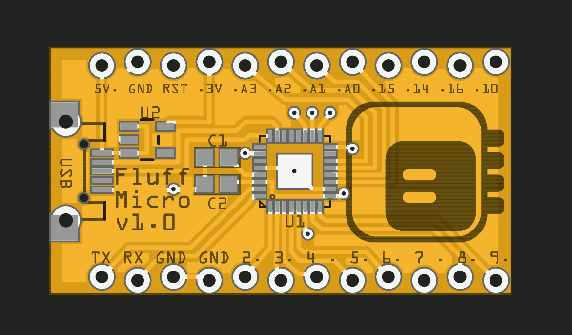

I have a couple of PCBs for keyboards (not designed by me) that use an Arduino Pro Micro, but I prefer to use my own software that I wrote in CircuitPython, so I came up with this dev board, which is pin-compatible with a pro micro, but uses a SAMD21 chip, which can run CircuitPython.

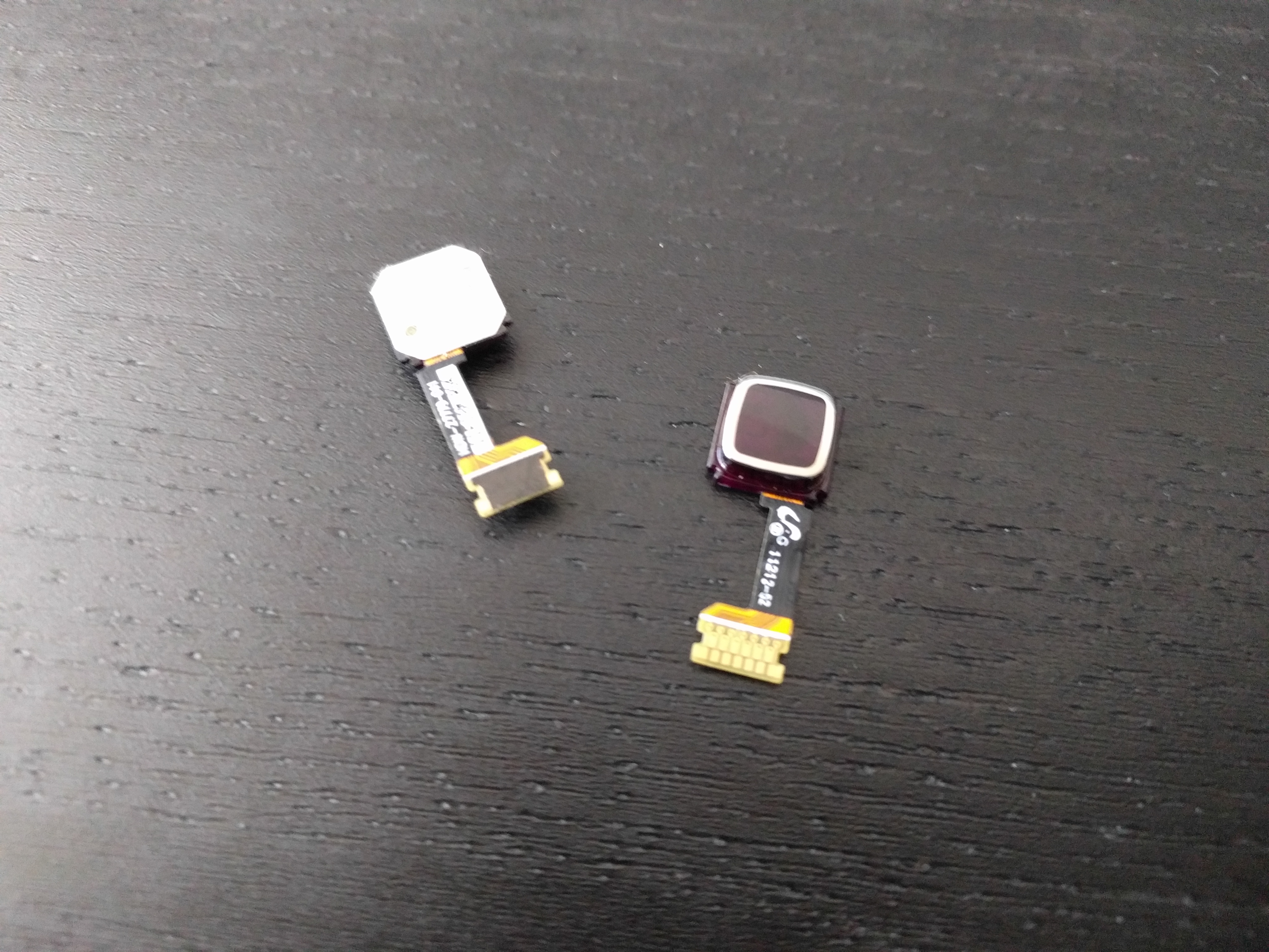

Got a couple of replacement phone buttons, to see if I can guess the pins and figure out how to read them.
