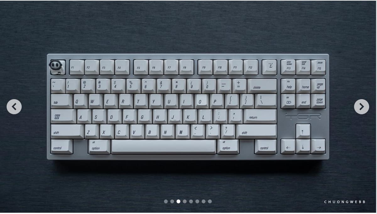

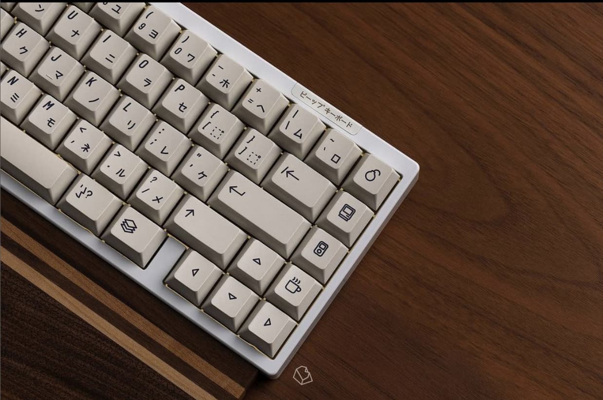

I don’t have many details. But they already exist. I’m keeping an eye out for them to pop up on the usual stores but nothing yet:
https://www.instagram.com/p/CrU3uCwvQvt/?utm_source=ig_web_copy_link
Wow. That looks great.
Well, maybe not the dash keys. 2048 legends were better.
FYI, this was on Biip’s Instagram several months ago. So there may be something in the works from him as well:

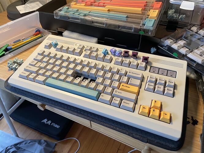

No pictures, but started breaking down some ink black V2s for lubing and films. Also, been thinking about the big switches I got, and if I will need to do any major mods to achive maximum thock. They have a lot of play in the stems and that bugs me.
Class80 build…London Fog switches and Staebies stabs (is it just me or these harder to put together than others?). Going for the thinner plate foam and PC plate, and will see how that feels/sounds.
I’m ever so slightly regretting not getting the red one, but if I remember correctly it might not actually have been available anymore, so all good :wink:
EDIt: remind me to never buy a keyboard with stick-on gaskets again, or else have a beta blocker before putting them on… :crazy_face: :laughing:

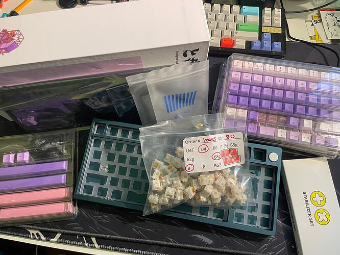

TGR Tomo build ready to go:
  1. TGR Tomo Case
  2. Hotswap PCB (until I find a switch I want to make permanent on the soldered PCB)
  3. TX stabilizers.
  4. U4T switches (until I find something else…probably going to try Blackberry switches)
  5. KAM L’il Dragon keycaps (what I have available. Trying not to buy keycaps right now). Not sure if the pink and purple is going to work, but they don’t look bad side by side.
Goal of the build is to make it noisy, “clacky” (higher pitch/tone, I’m not a sound guy), and fun to type on.

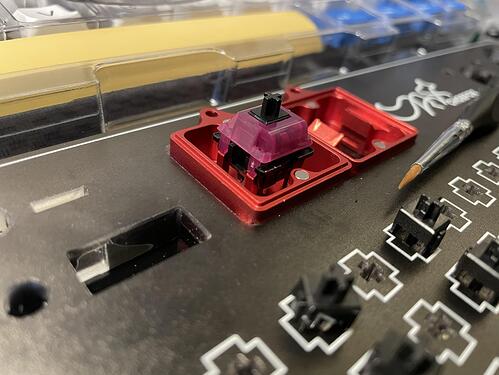

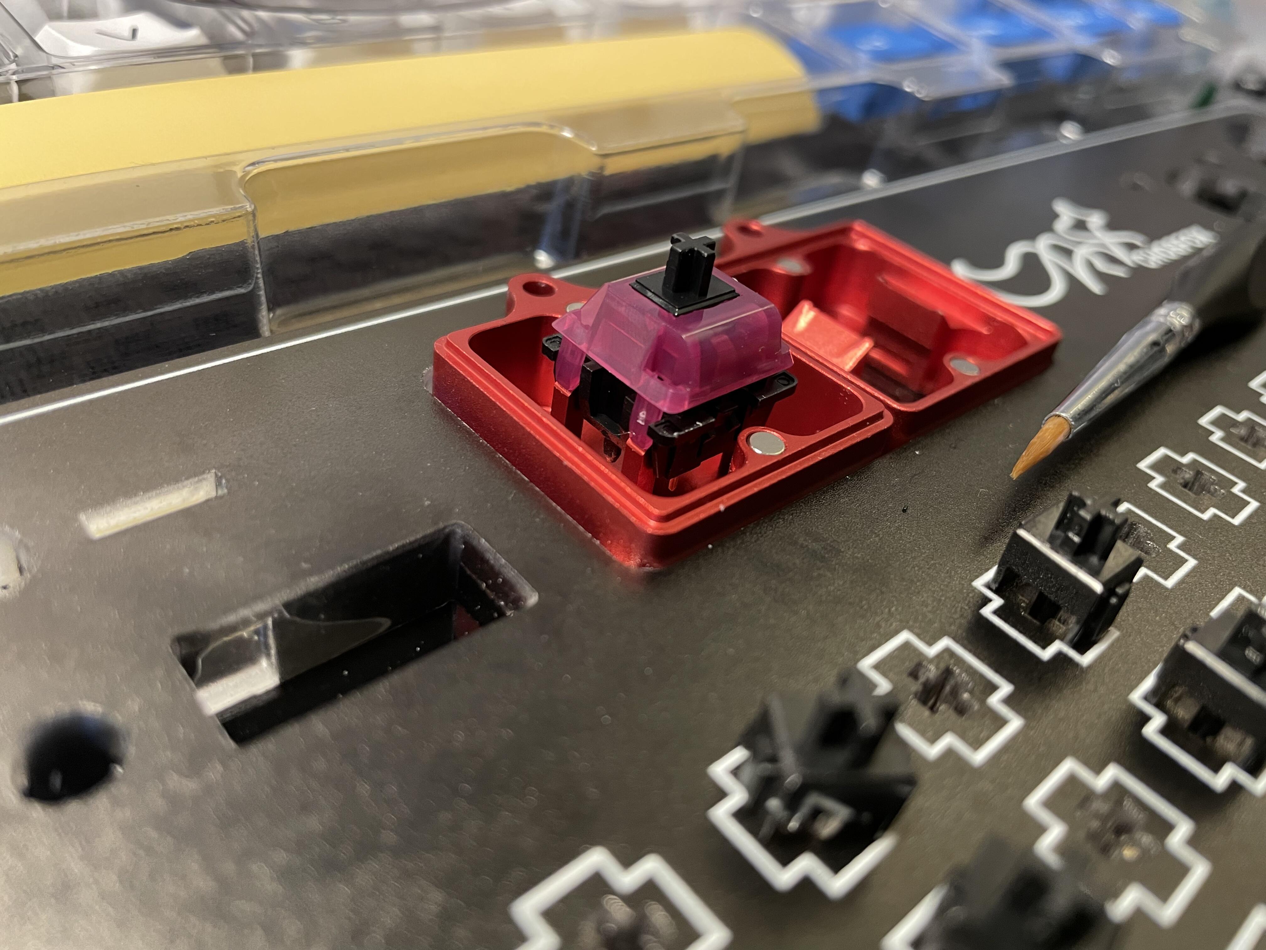

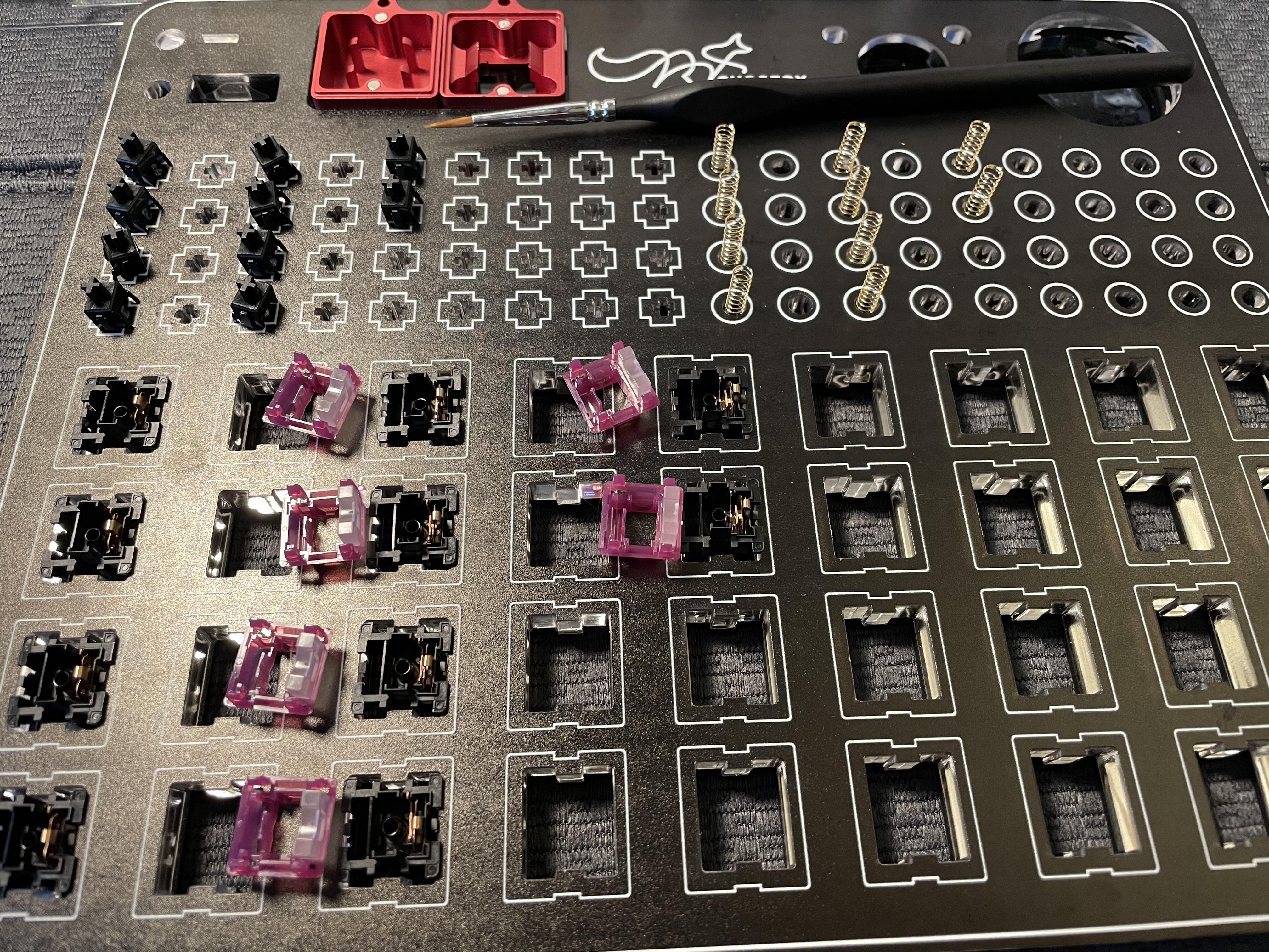

First switch lube effort! Black Lotus on the lube station…please tell me there’s a better way to open switches than those little switch openers - I tried two and they’re both annoyingly only half opening the switch (none of the pretty dangling open like on YouTube, Hmpf :wink:).
Other than that the actual lubing is quite meditative :man_in_lotus_position:
Ps: I know the stems are supposed to go in the other way, I just find them easier to pick up this way…

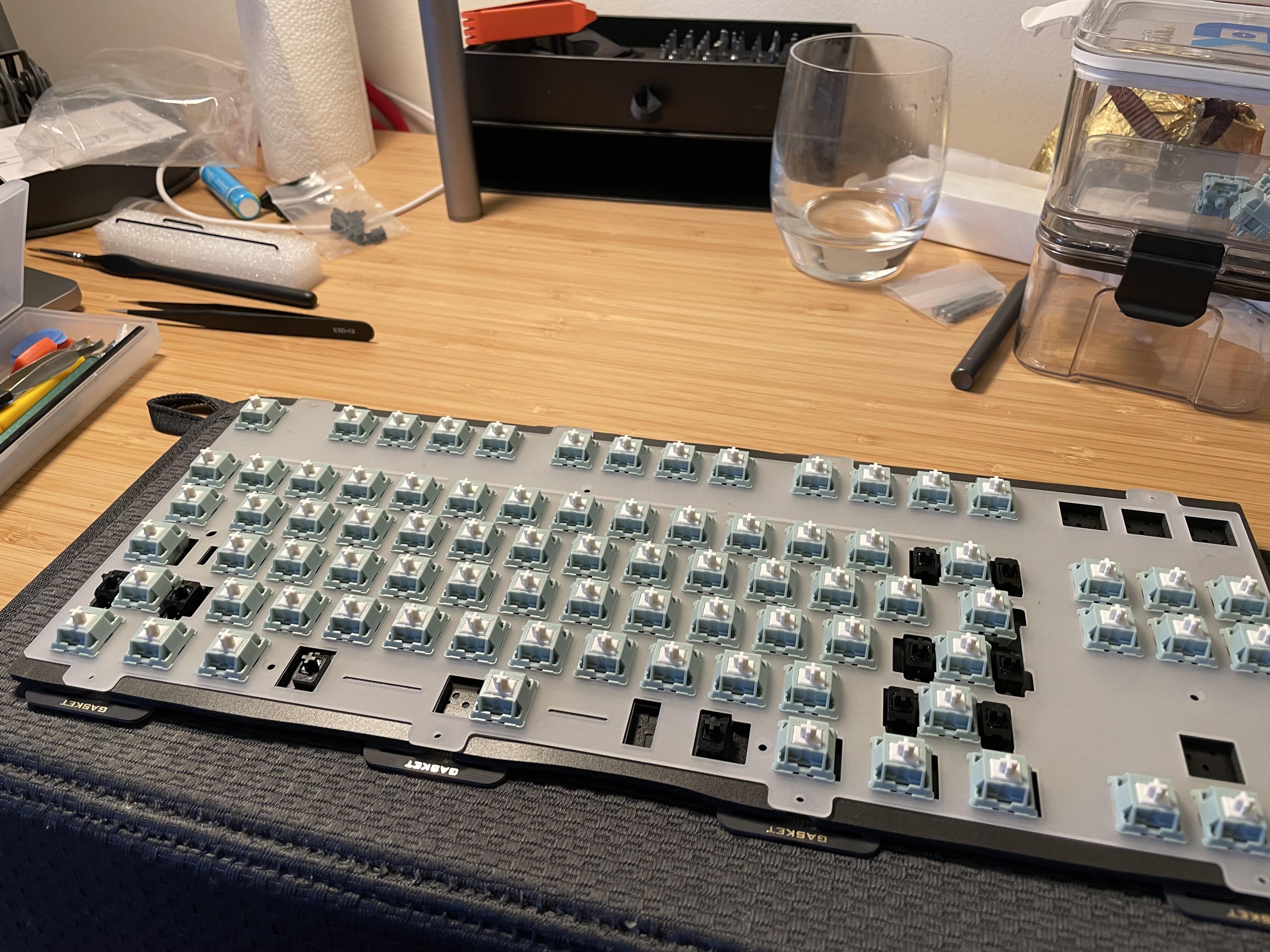

Still lubing…but TIL that (at least for the Black Lotus switches) I like to lube the stem and the bottom of the spring (forgot to bring the spring oil, so 205 it is).
  • lubing everything (top and bottom housing, stem, both ends of the spring) basically takes away any character of the switch
  • lubing top housing also takes away too much of the character
  • lubing bottom housing doesn’t seem to do much at all
  • and I am undecided whether lubing the top and bottom of the spring has any discernible effect. At least it’s not so noticeable that I’m opening up the first batch of switches again to change it.
Also learned that I totally see the benefit of bag lubing the springs with oil…
…and that I might need some sort of magnifier (gulp) :scream:
I also want a new switch opener :innocent:
Now need to finish the second half of the lot :wink:
