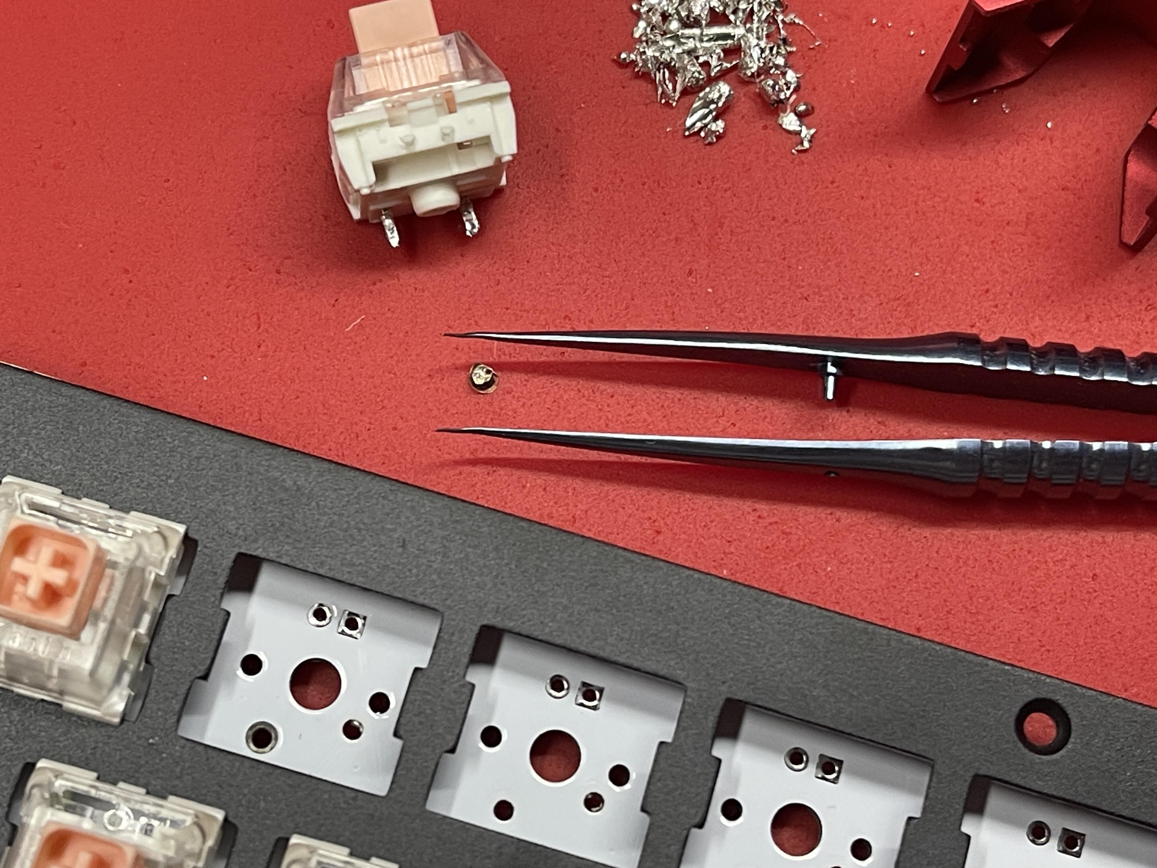

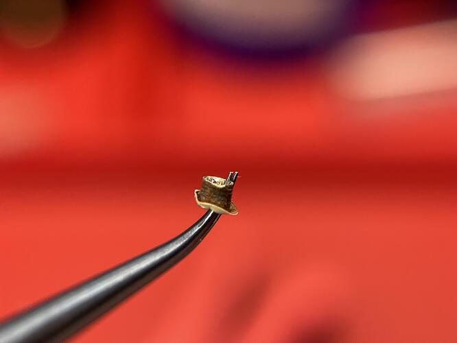

Pad came out with switch. Solder had migrated downward rather than getting sucked out.
Came out just like the other switches, but upon looking at the switch I noticed a lot of solder on the pin…
Glad this board was cheap enough to learn on!!! ![]()

On that note - the situation of solder flowing down instead of up and out can sometimes happen with even really nice gear - it will usually provide some resistance when trying to pull when it does. If that does happen, add some more solder back to the joint - it will be able to transfer heat to the solder down at the bottom and make it a lot easier to remove without frying the pad.
Oh, also - that board may still be salvageable. Try bridging that connection with some other nearby ones with some tweezers or loose wire with it hooked up to a tester. I was able to save one of those Hades boards that way, with an albeit messy improvised bridge made of wire.

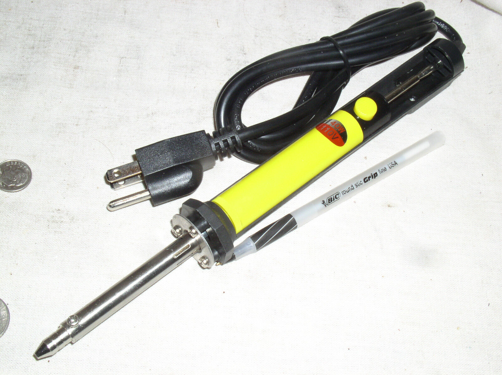

Yes, avoid these cheap yellow tube desoldering irons by all means.
They literally melt upon use.

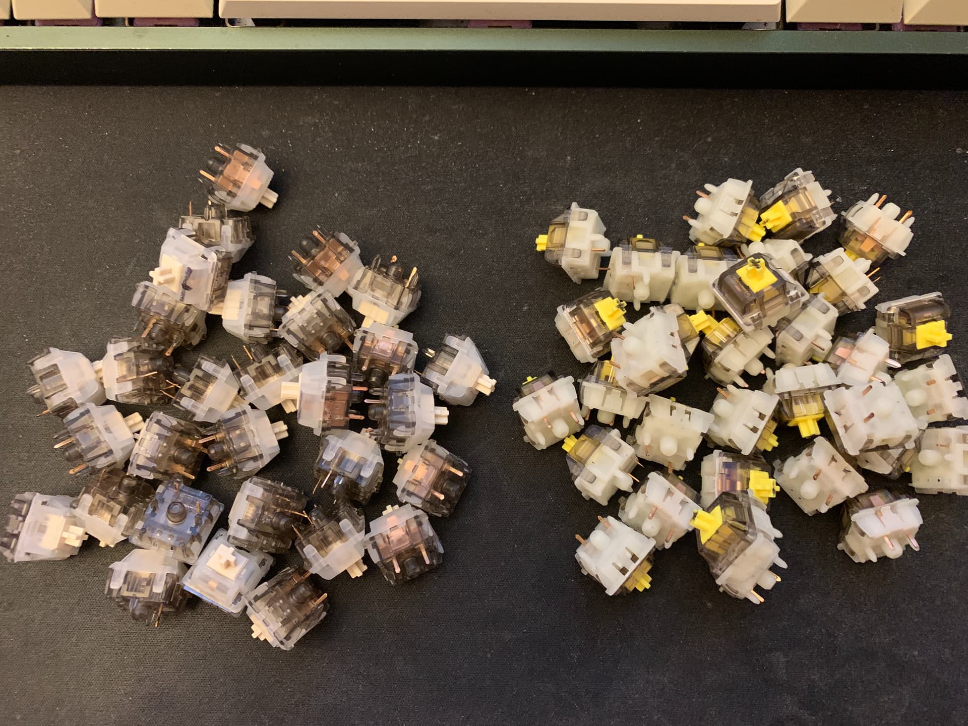

Halfway through making Cthulhus.
- Left-pile:
- Cthulhus made of Ink v2 bottom
- NK Cream stem
- Milky Pro KS-3 X1 top
- MM Switch 53g 3-stage spring
- Right-pile:
- Milky Pro KS-3 X1 bottom and stem
- Ink v2 top
- TX 60L spring
I was going to use New Nixie top and Kailh Black v2 stem but 1) products of this combo seemed better and 2) I’m still enjoying New Nixies as is.
Milky Pro KS-3 X1 with Ink v2 top frankenswitch sounds pretty good, similar to Cthulhus sound on the tester although noticeably different in-use.
