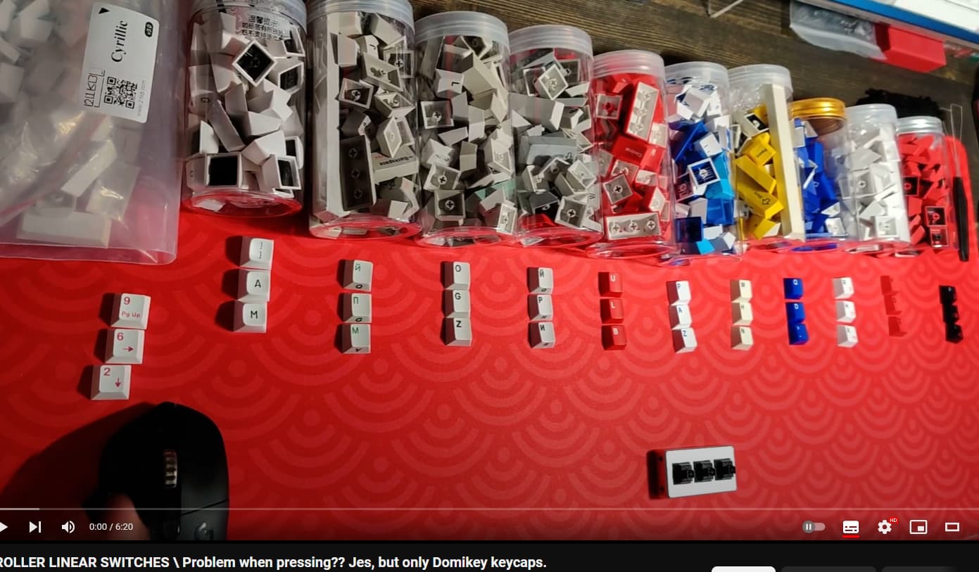

Since the keycap, when put on the stem, the thickness of the keycap, the material of the keycap, I noticed affects the stem. Its dimensions inside the TOP case change. Therefore, there is a problem with keycaps from Domikey.
The thickness of the abs keycap is usually thin and is 1.4 or 1.6 everywhere
But the thickness of PBT can be 1.7 or even 1.8
And pressing on roller switches is completely different.

I compared so many things)))
Although the old video is already being released at the moment. Since I already have new keycaps. Manufacturer or material.
Nice, I’ll definitely check the videos out!

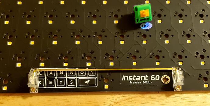

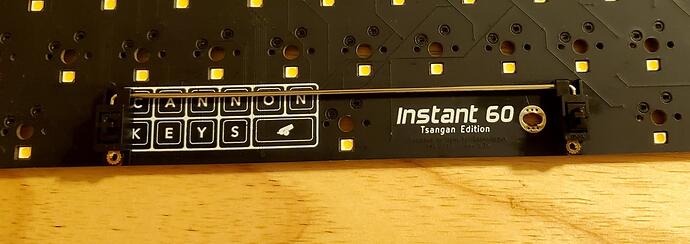

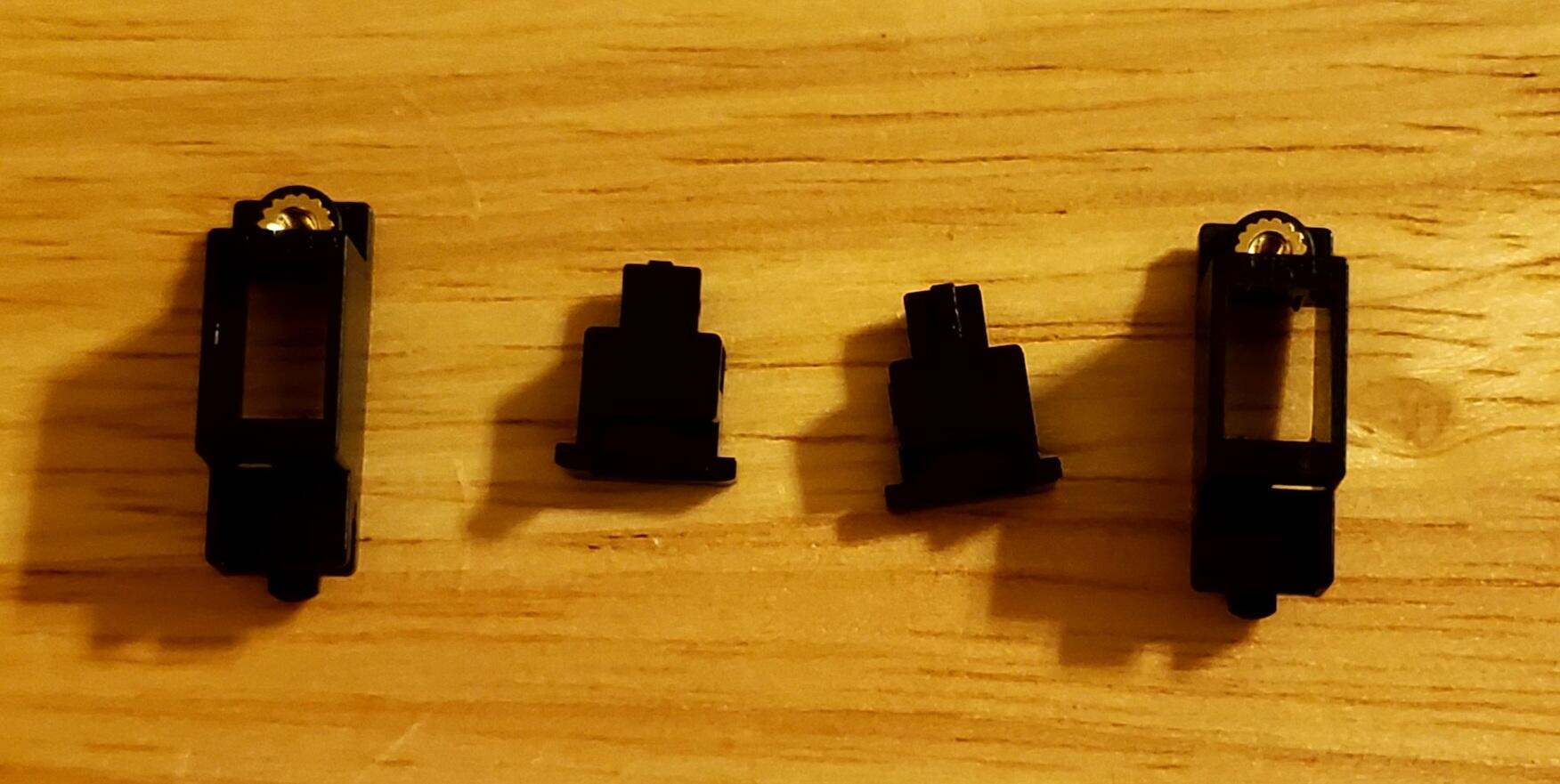

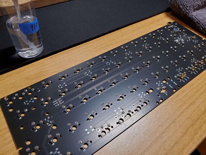

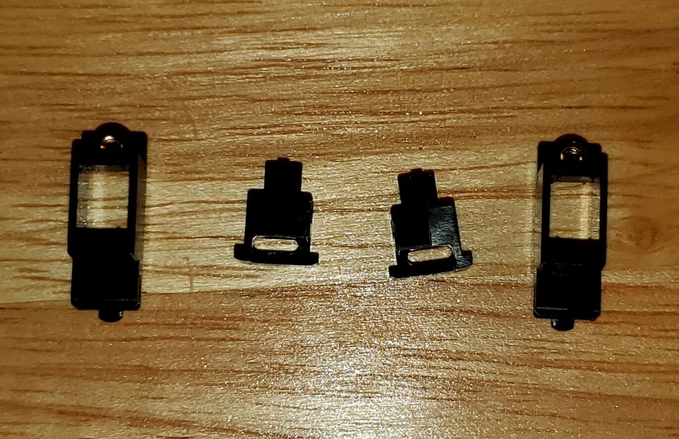

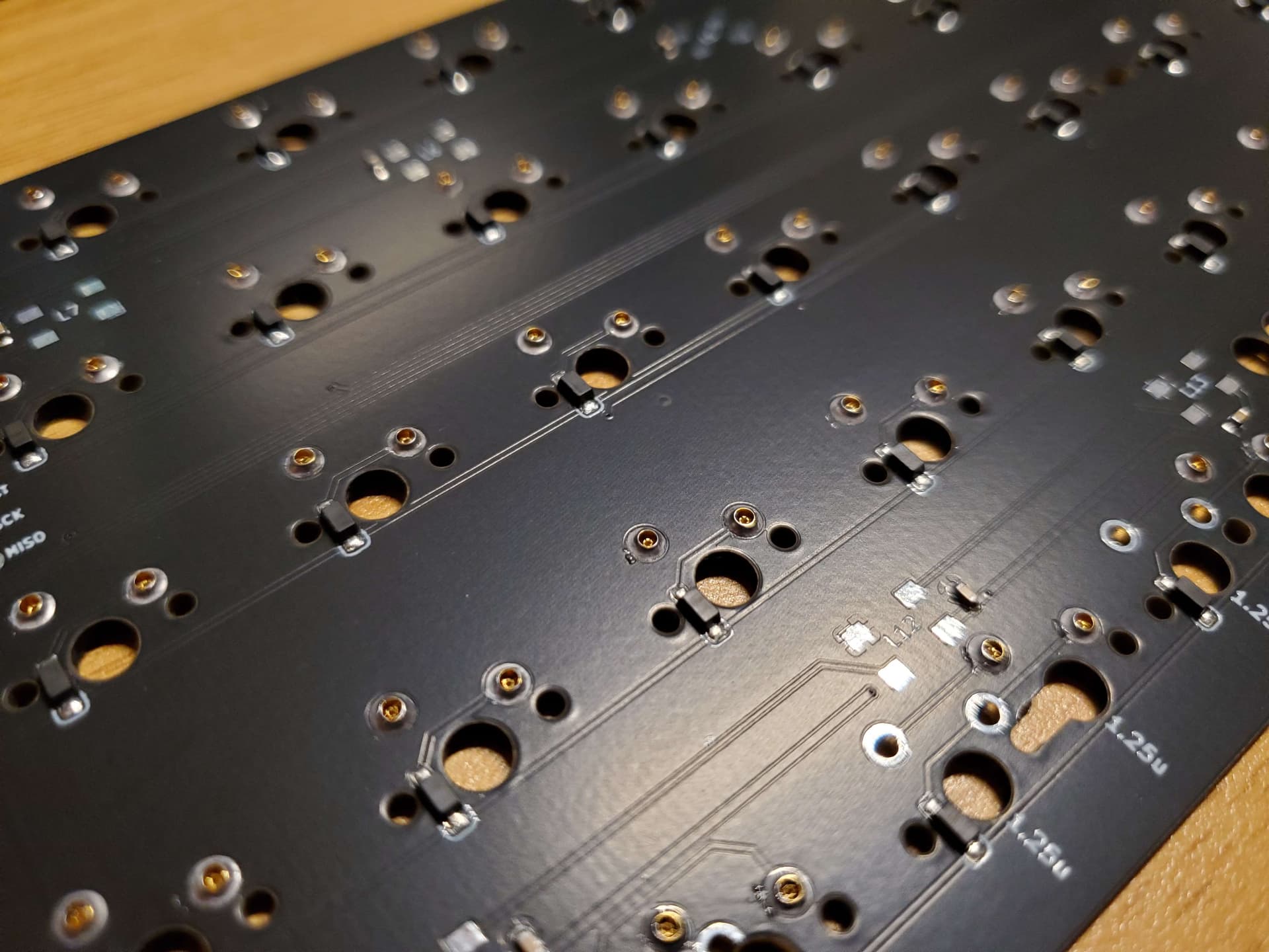

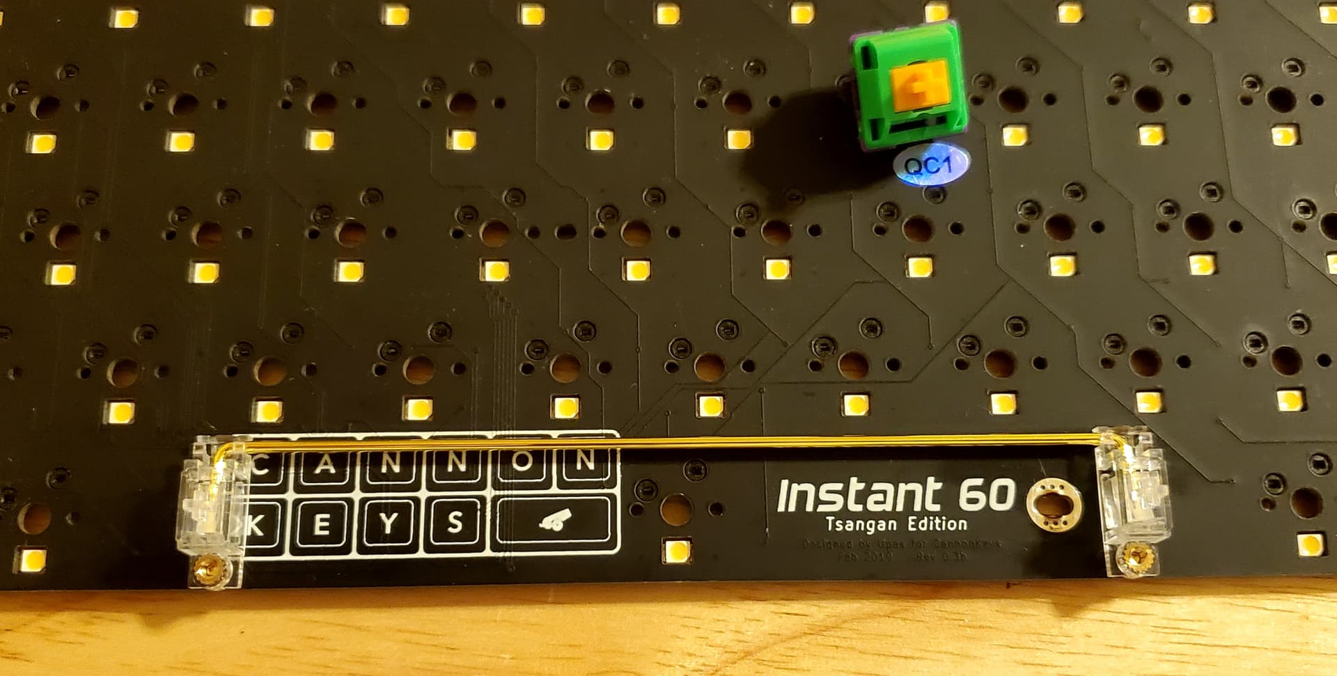

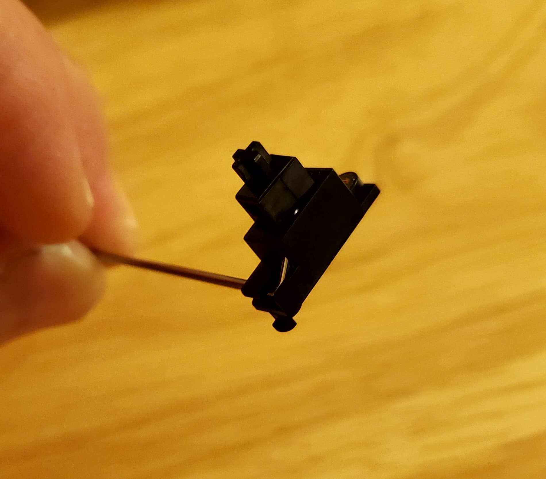

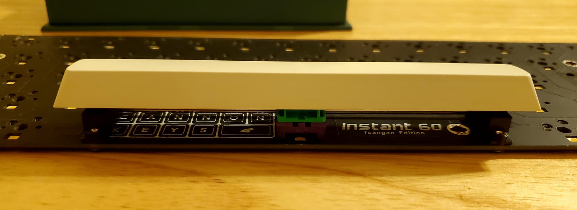

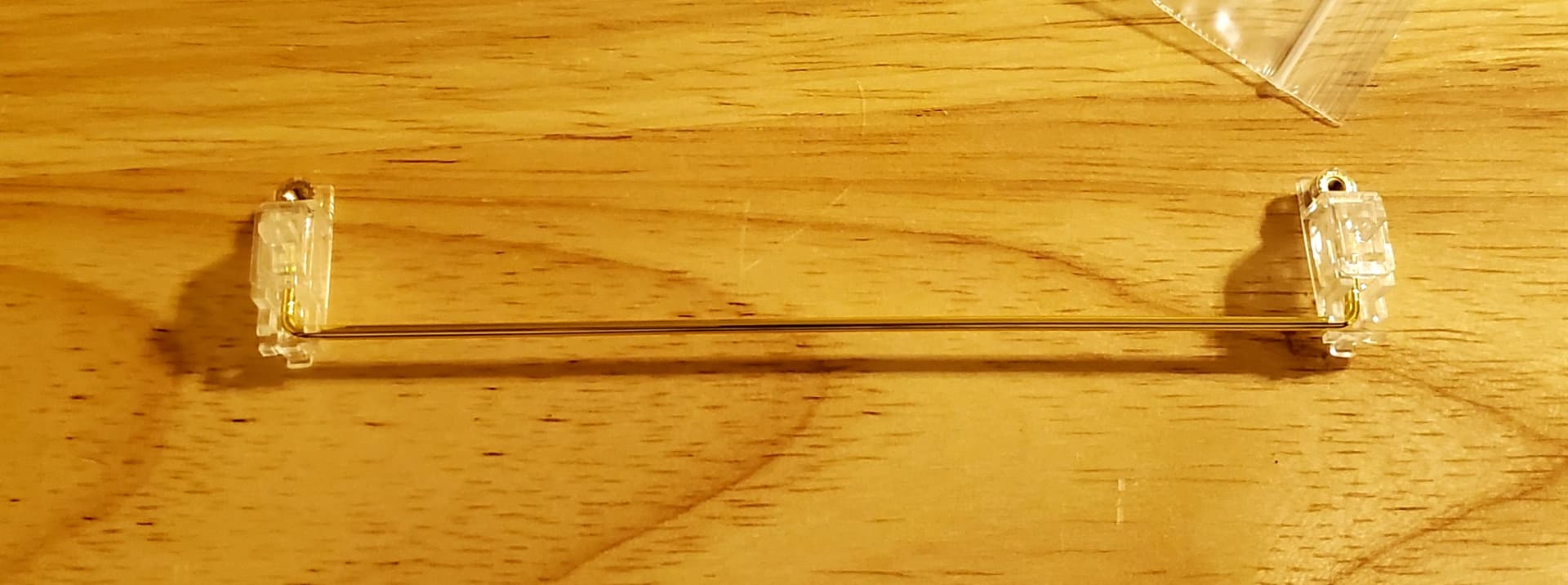

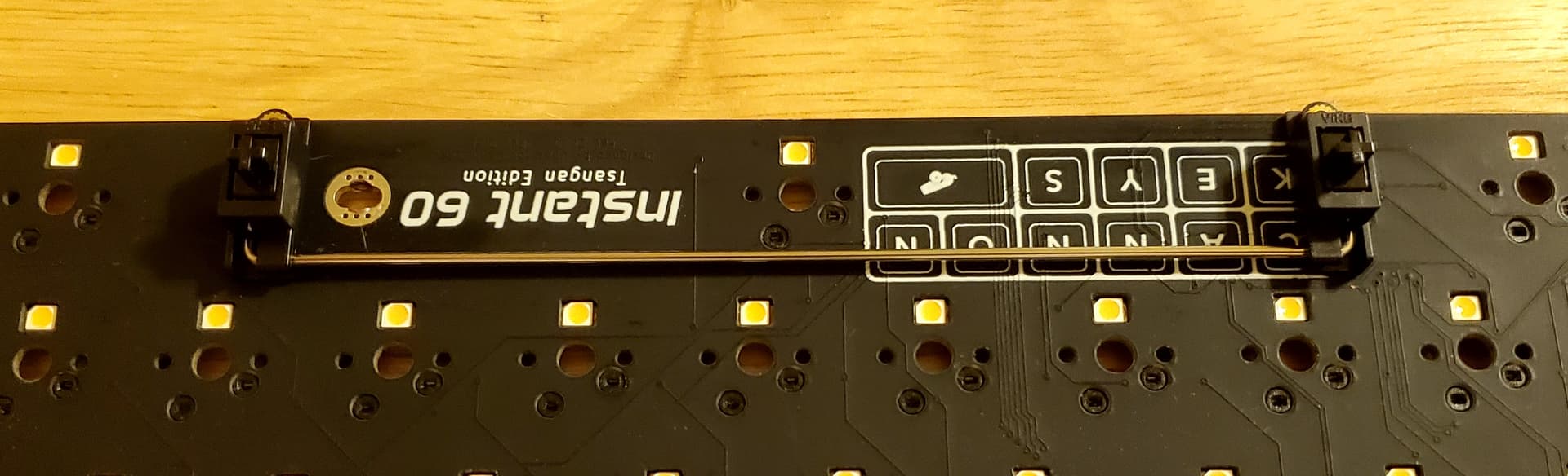

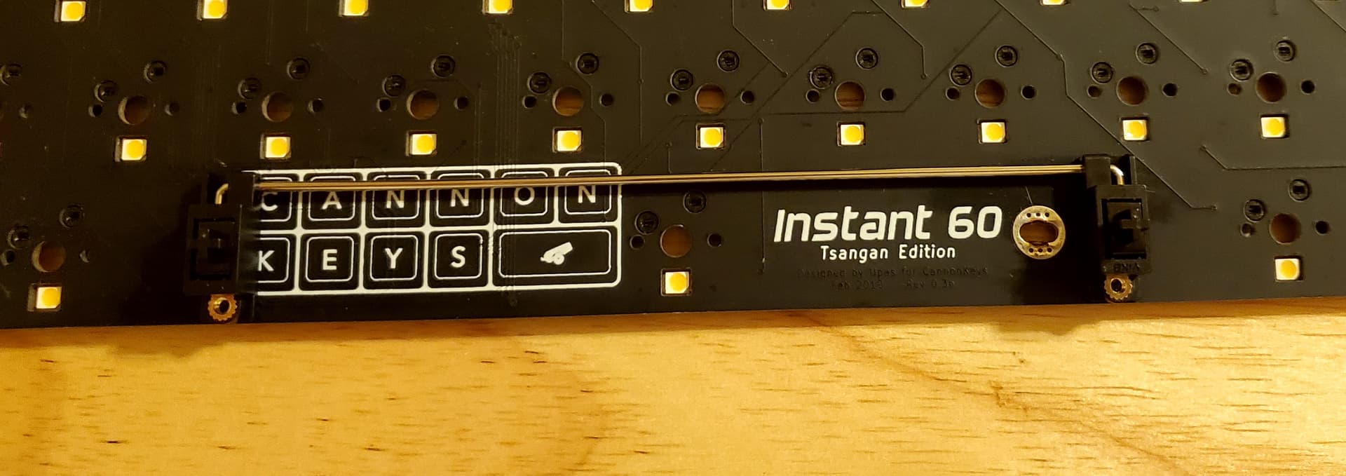

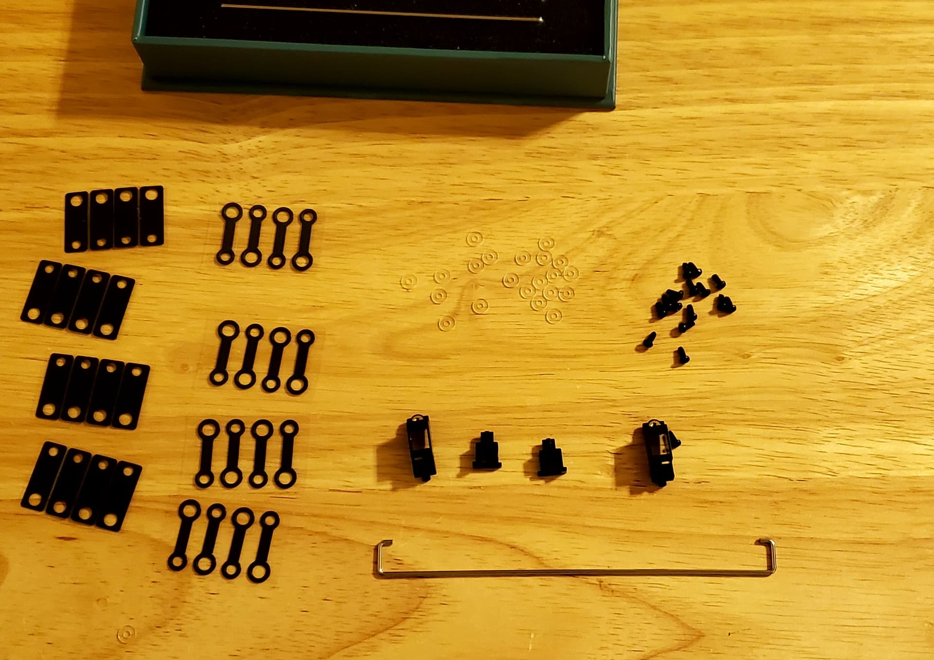

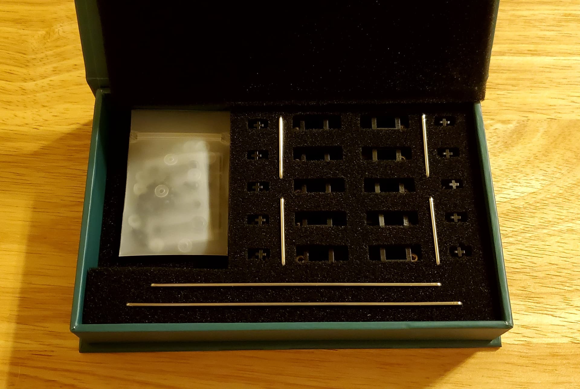

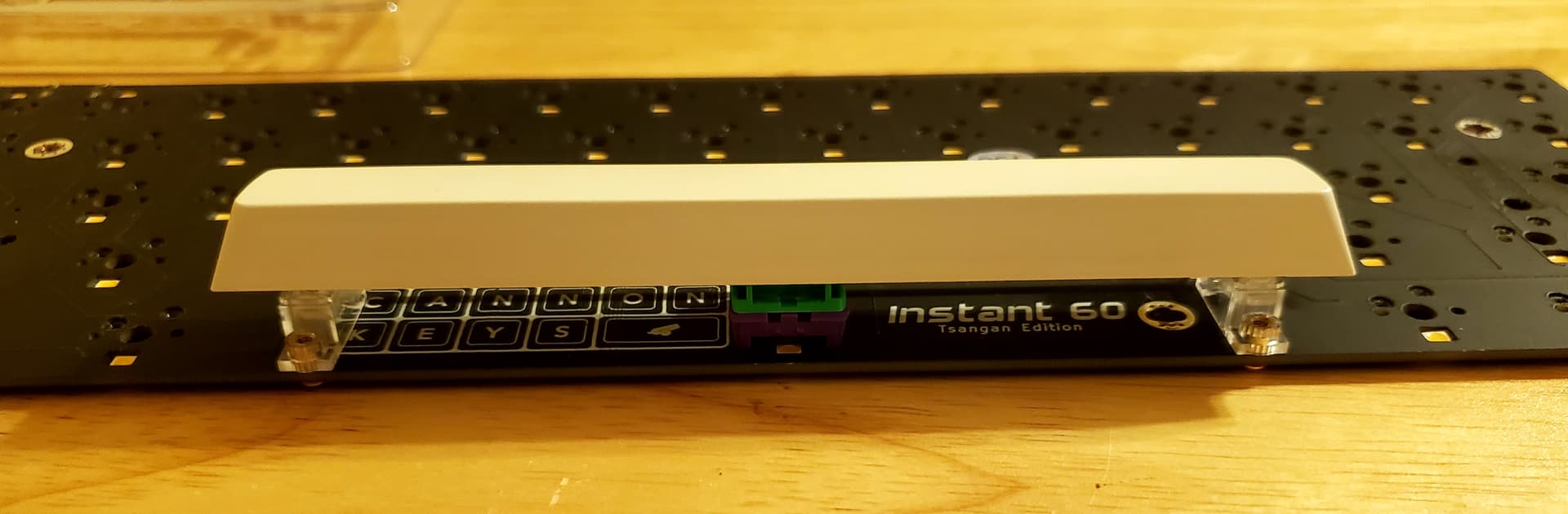

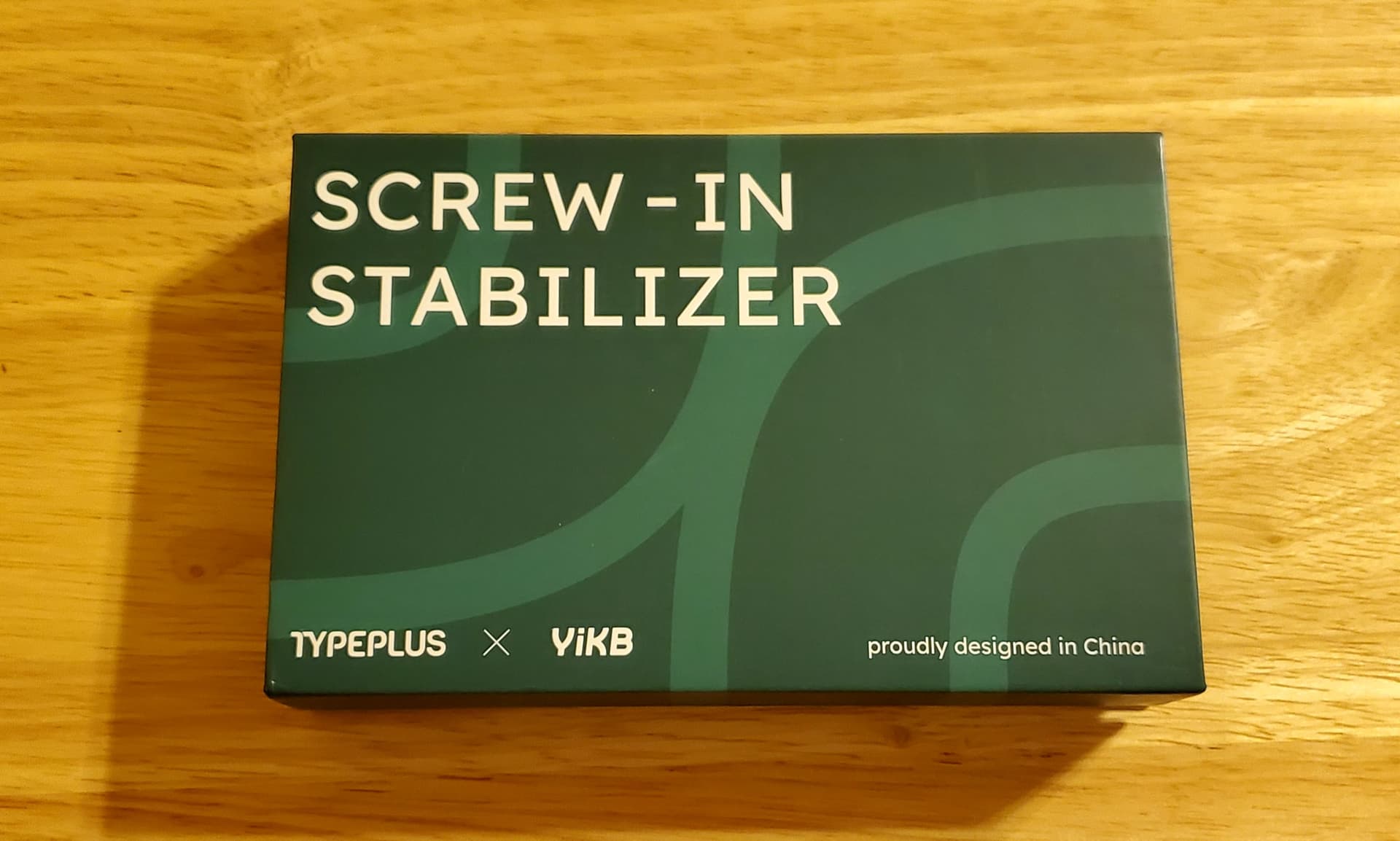

So I finally got to do a little testing with the new TypePlus stabs. I just mounted a stock 7u one to a HS PCB I have & compared it to a stock SwagKeys Knight stab. Overall the TP stabs performed just fine, but definitely had more noticable rattle vs the SW stabs. Lube will be needed to see actually how these TP stabs perform in a build. I expected them to be a little bit more noisy than the SW stabs just because the slider is all one material (most likely POM). Other than that though I like this design, the way the wire goes in to the housing/slider I doubt they will ever have issues with popping out. Even if they do these will be much easier to fix when installed as the wire clip is facing straight forward on the same plane the wire sits. Instead of being pushed in from the top like conventional stabs. The one big improvement I noticed these make is they have much less N/S wobble than a conventional stab design. While this never really bothered me I figured it was worth a mention as I have heard the N/S wobble as one of the bigger complaints about TX & SW stabs.

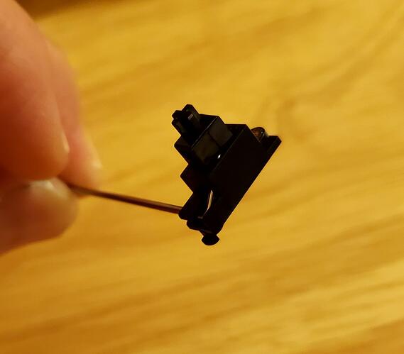

These TP stabs have distinct right & left side housings + sliders because of the way the wire is shaped. So putting them together is a tiny bit trickery than conventional stabs. You have to insert the end of the wire, rotate it into position so it’s sitting properly in the slider’s pocket, then you push the wire straight back into the clip on the housing. I think because of this design we’ll have to careful when applying lube to the wire pocket on the slider. It seems like it could be easily over or under lubed. Gonna take a bit of trial & error to find out how much lube is the right amount for these. All in all I really like this new design. It doesn’t make any strides in being quieter stock than the conventional design, but it has advantages in the stem wobble it allows & also seems like wire popping should not be an issue with them. Will have to get them in a proper build to really form an opinion on them, but first impressions are strong!
Edit: I guess I should also mention they have no binding or dragging feels when pressing the space from all kinds of different weird angles too. So if that’s how they are stock I’m gonna say they’ll be just as good as, if not better than conventional designed stabs in that respect once lubed. Also they come with extra screws & washers. Which is a huge bonus for me as I’m always dropping them & losing them in my carpet till I vacuum & hear them being sucked into the vacuum. ![]()

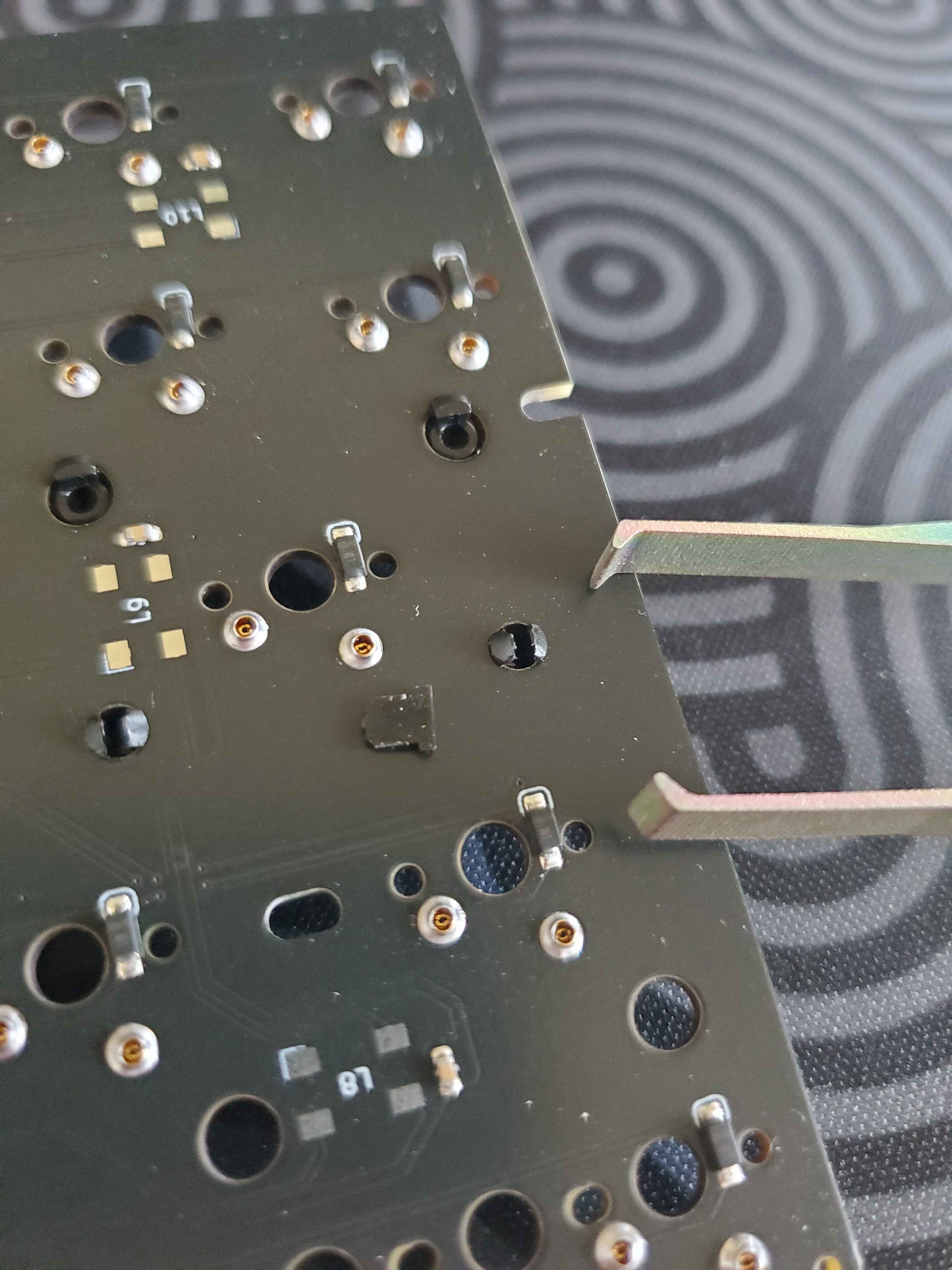

Just realized my switch pullers are 100% perfect for pulling out the clip in stab locker tab thingies!

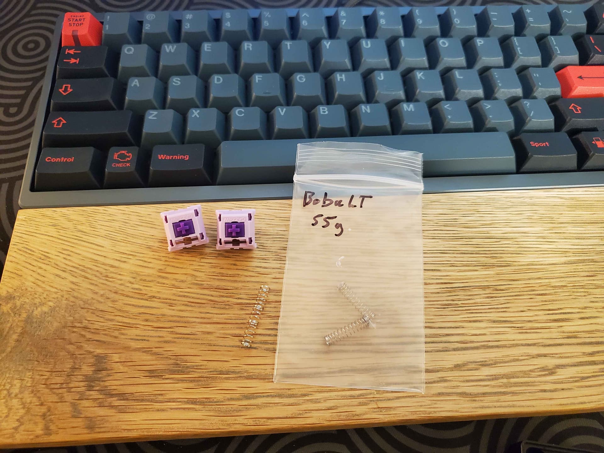

Really hate how mushy the Boba LT feels with stock 55g springs, paired with the super short activation I’m really not liking these switches.
They feel much tighter and poppier with some 3stage 62.5g springs. Hoping I like them enough to keep them after this…
Update:
Well, I swapped out all the alphas and mods. I get much less accidental keypresses and they actually sound cleaner/less rattly (consequentially feels deeper without the rattle). Definitely lost the mushy shallow actuations. Wild what some springs can do. Makes me wonder if I would have liked the 65g variant. But I do like the poppiness of the 3stage springs over anything else.

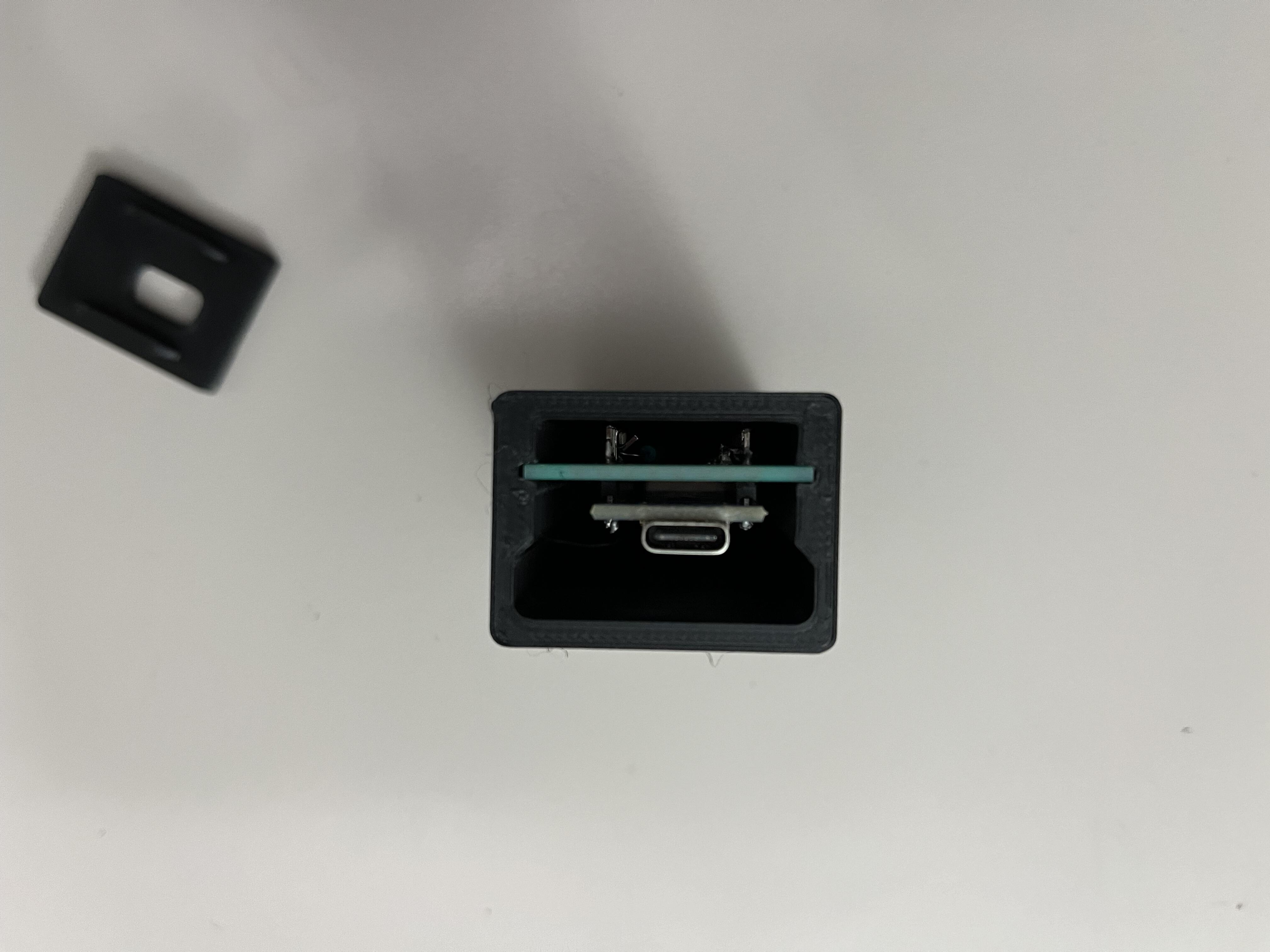

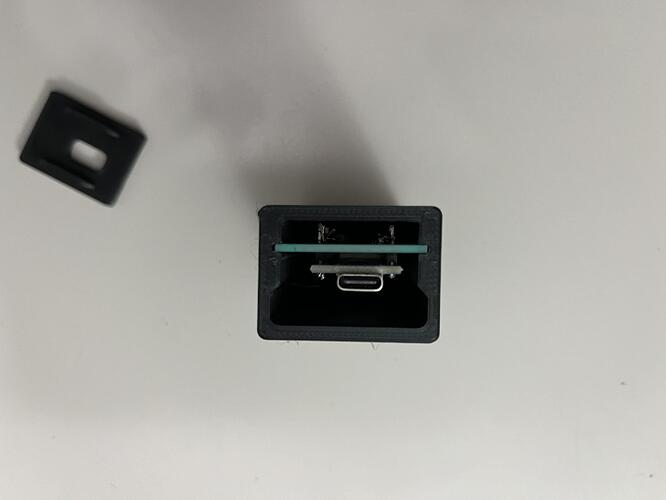

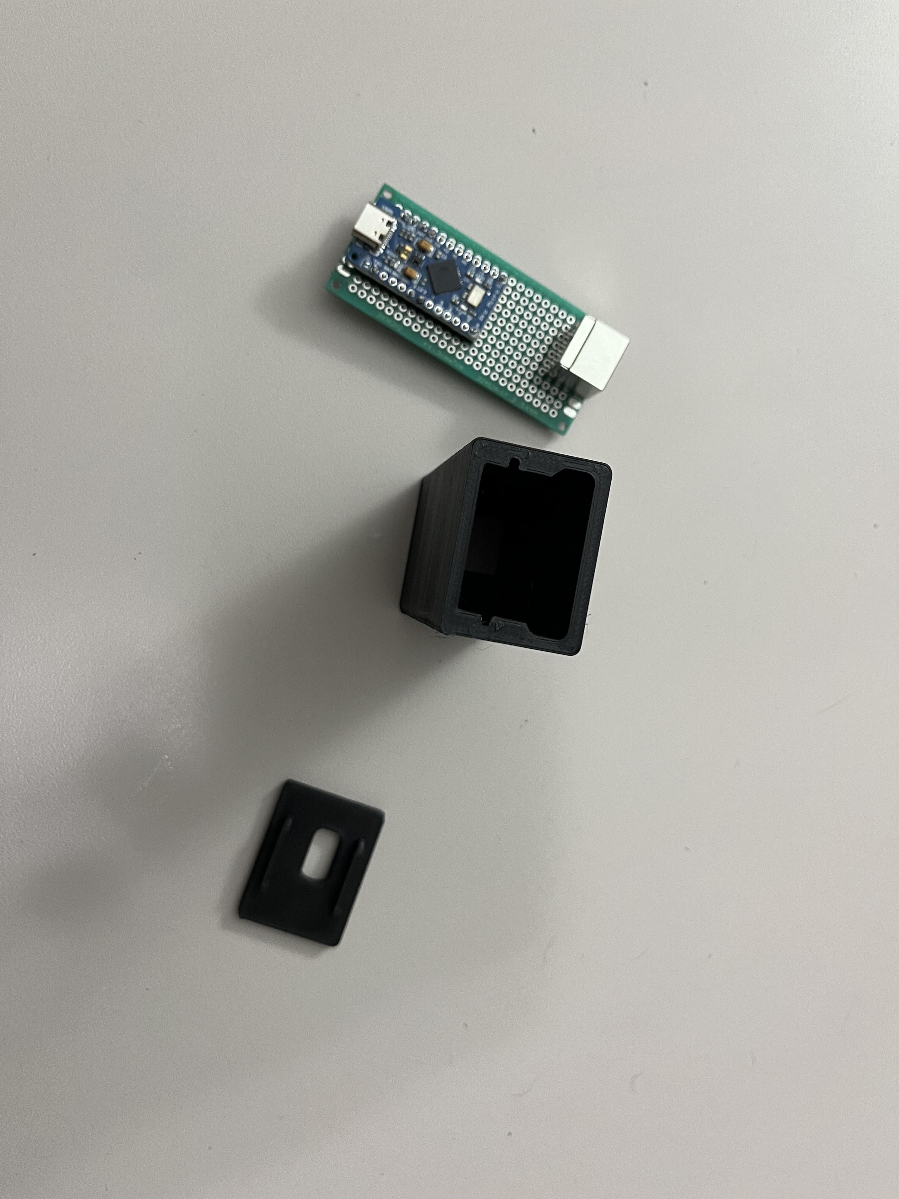

Actually finished this one up a few days ago. Mounted a Pro Micro and a PS/2 port on a bit of perfboard to make a Soarer converter, then designed and 3D printed a quick case for it. It works well.

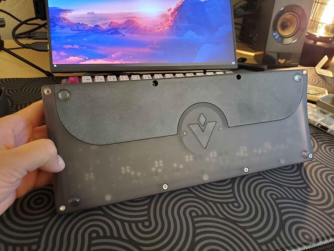

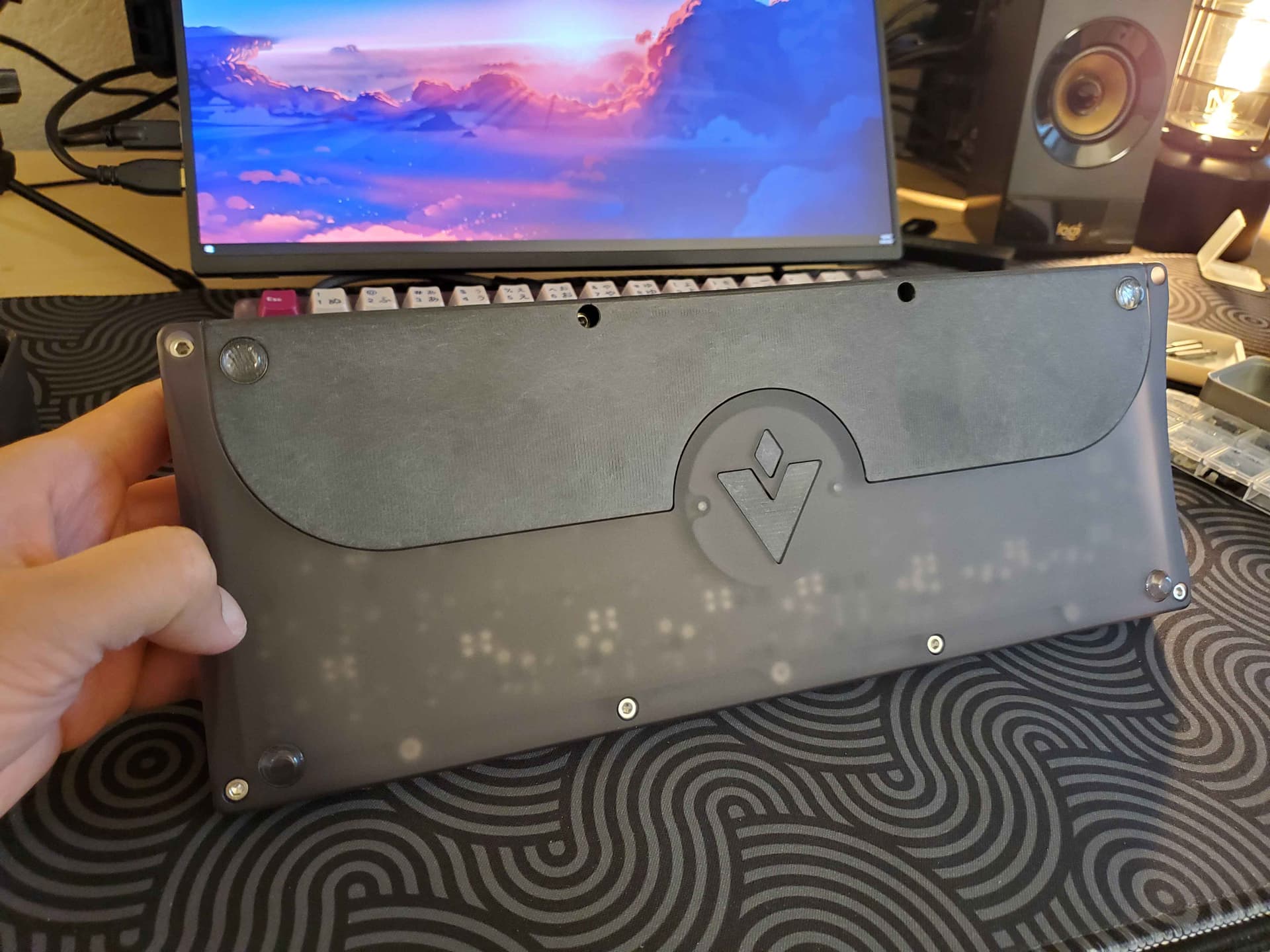

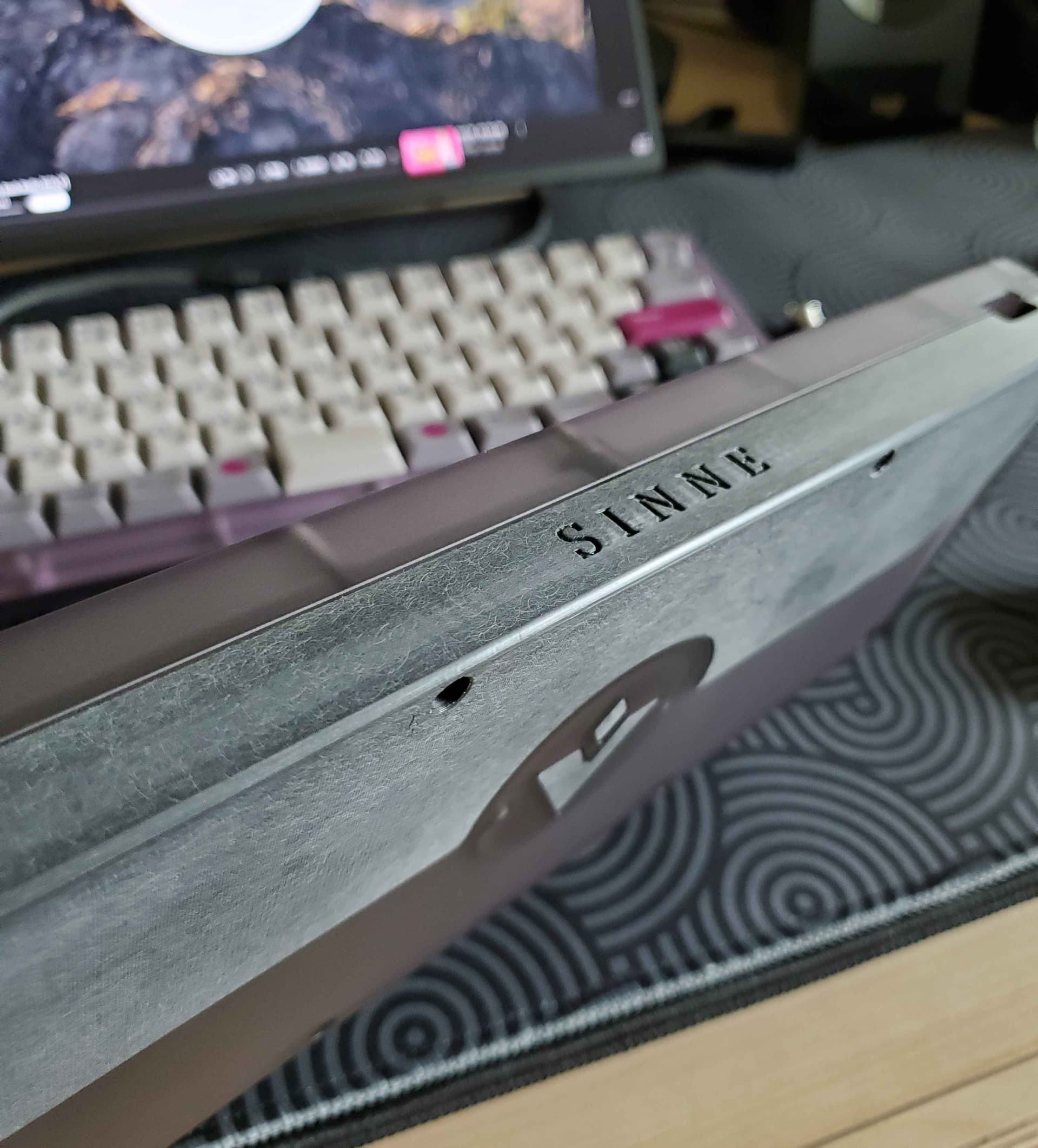

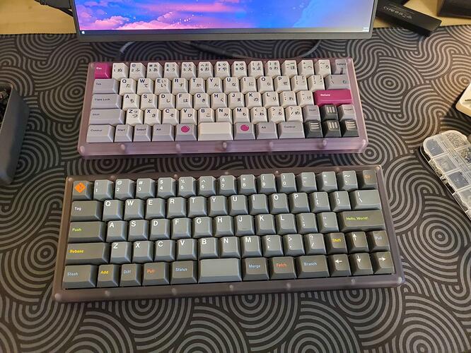

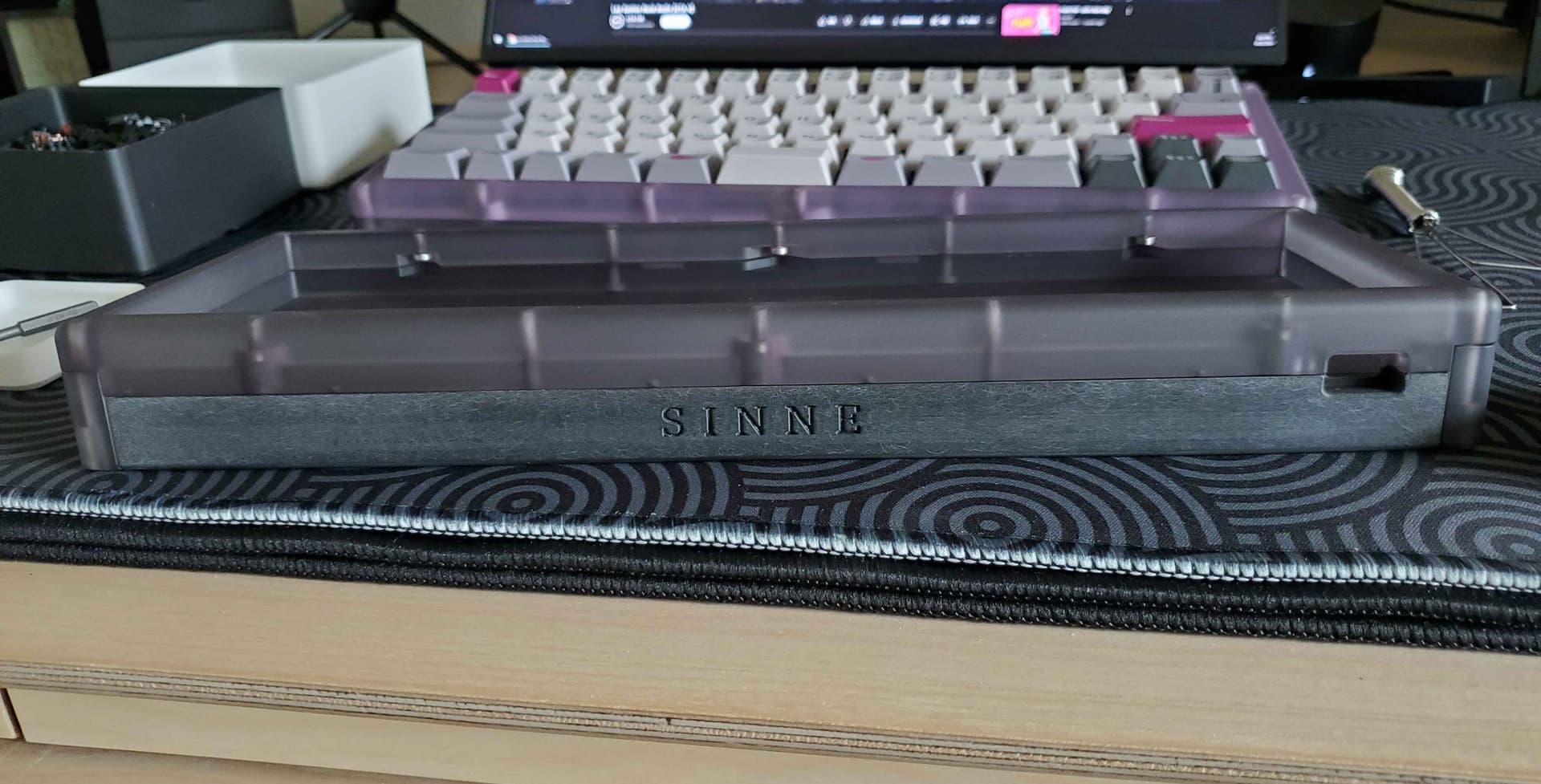

I 3d printed some weights for the rejected Viktus Sinne top and bottom set that I got in smoked grey.
Black PLA on 0.16mm layer height and sanded with 180 grit random orbital sander and scuffed with some buffing pads.
Put in my Oblivion set with a laser cut PC plate and some HMX Canglan v2s. My GMK Oblivion set finally in their forever home (for now lol).

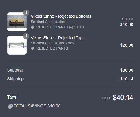

This build was ridiculously cheap without taking into account the 3d printer and laser cutter I already have lol. Just used the extra hardware included with the purple Sinne that I bought and some extra orings I had lying around for the burger mount, so no extra costs there either.
It was only $40
I like that bottom row a lot.
What PCB did you use?
