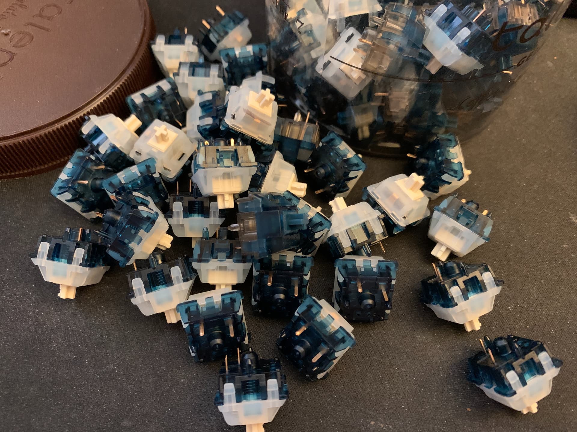

I was on the hunt again today. Hours of trying this stem in that switch. I must have at least 100 sets of different switches that I don’t like lying around unused. But I finally found something that really works and is unique… but there’s a catch. It’s very short travel.
Combined v1 linear Naevy housings ( I harvested the stems from 3 or so years ago) with what I think are cherry speed sliver stems. They must be… but I never noticed that they have extra legs on the bottom rails to reduce travel.
Lubed up with 205g0 and filmed, these sound incredible. And the feel is quite unique. I think it’s because the rails are slamming into the resonant switch bottom, instead of the intended pole bottom-out. I measure 3.2mm travel. I know, that sounds off-putting, but the sound and feel of the switch might just be enough for me to overlook it.
I tried them with a dual stage 63.5g switch and it was nice, but I think I can use something more traditional and save those springs for another switch. There’s such little stem movement that I’m not sure a dual stage spring is getting the most use out of it.
Gotta think of a name for it. Not sure it’s practical since most people can’t get v1 Naevy switches anymore.
“S.S. Naevy”?
Well shit. I got everything prepped and lubed the stems. Assembled 12 switches and had the little voice in my head saying, “better try these out.”
Only 2 of the 12 registered in a hotswap board :face_with_symbols_over_mouth:
I thought it was something about the contact leaf and the speed switch stems, but it appears it’s something to do with the pins because the switches register on a multimeter.
’m not sure I want to put in the effort to film and assemble these if I can’t use them in a hotswap build.

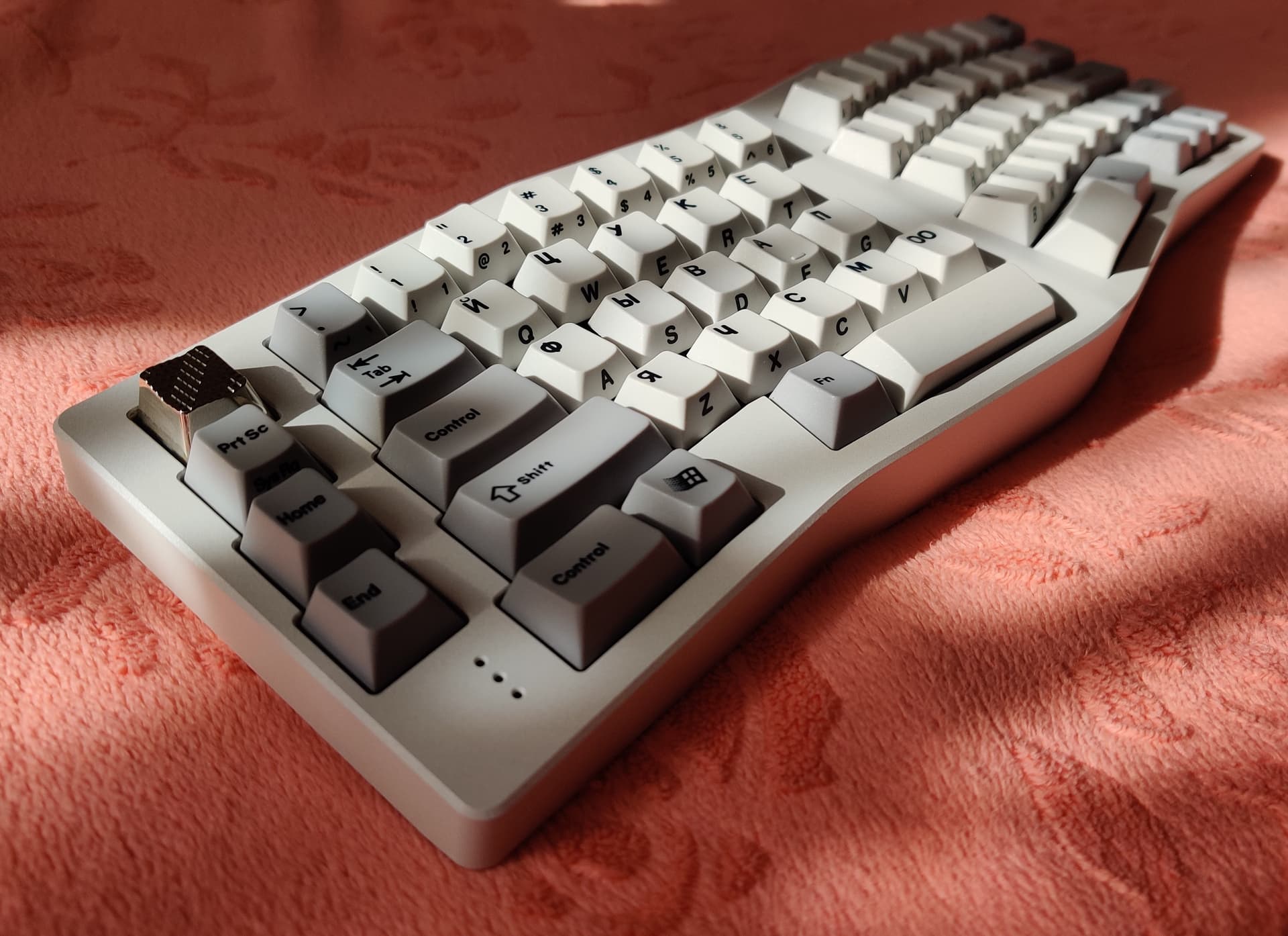

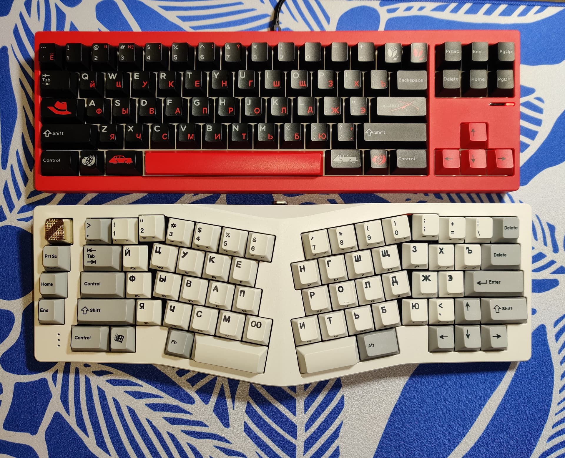

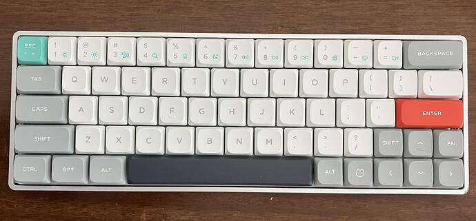

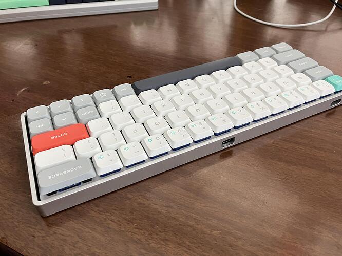

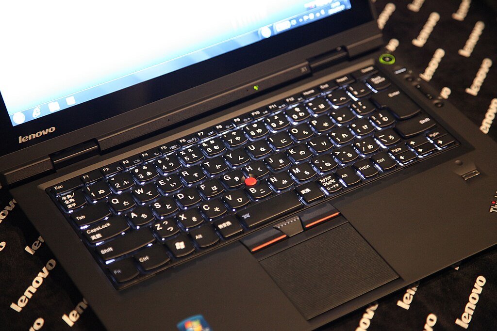

Something about the small spacebar reminds me of Japanese Thinkpad keyboards.
(I dont actually have this thinkpad for the record)
That bottom row is cheating! :joy: I swear I see some 0.75u keys lol

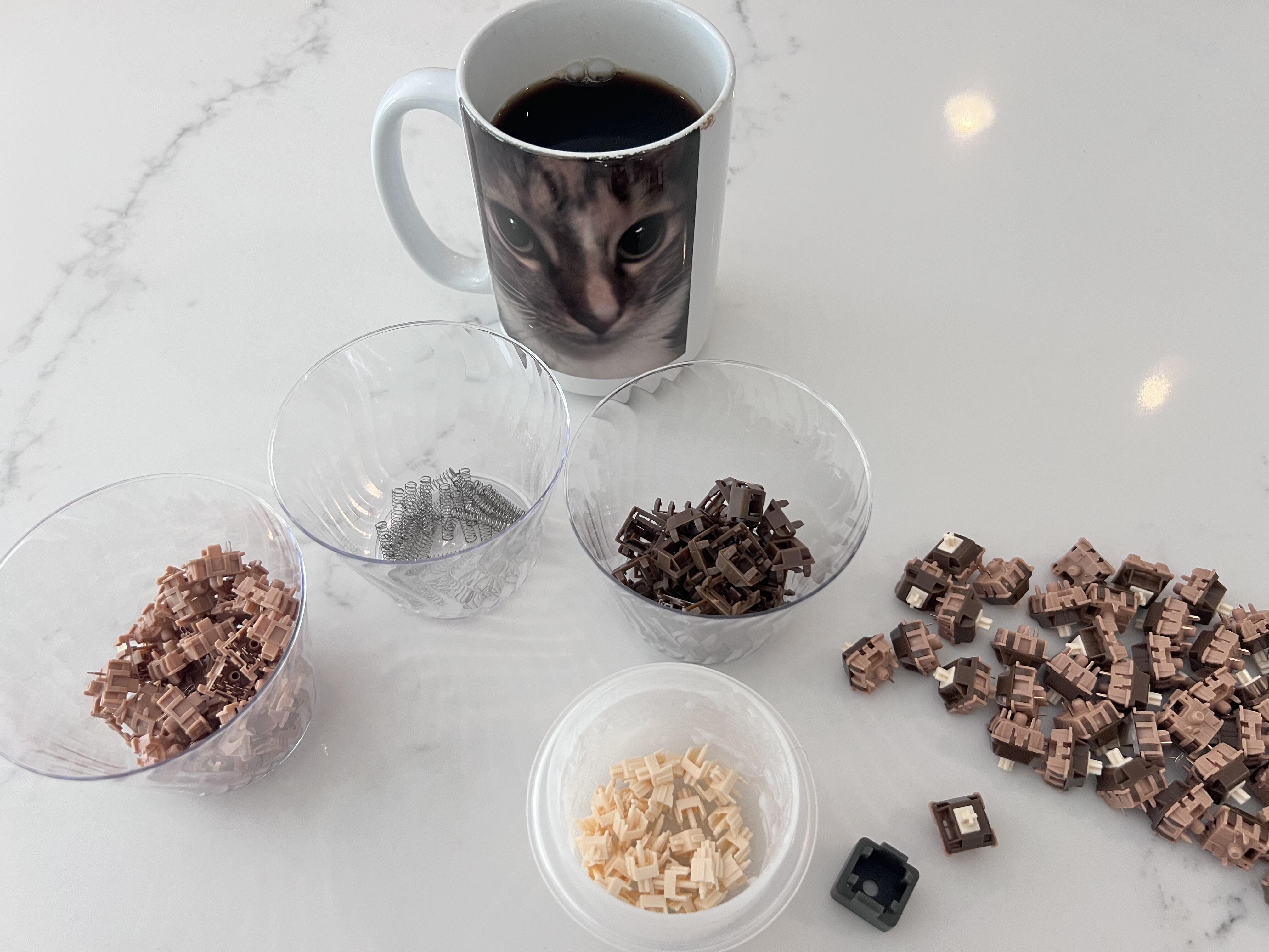

Tub lubing some Huano Caramel Latte stems. And yes, I drink coffee out of a cup with my old cat’s photo. I still miss her sometimes :smiling_face_with_tear:
There is no reason or cause.
I see a cat, I like it.
These caramel latte switches are pretty fantastic with lube. If I had one complaint it would be the spring is slightly lighter than I would like. Would like to have about 5g more resistance. Just make sure you trim the stems if you decide to try them.

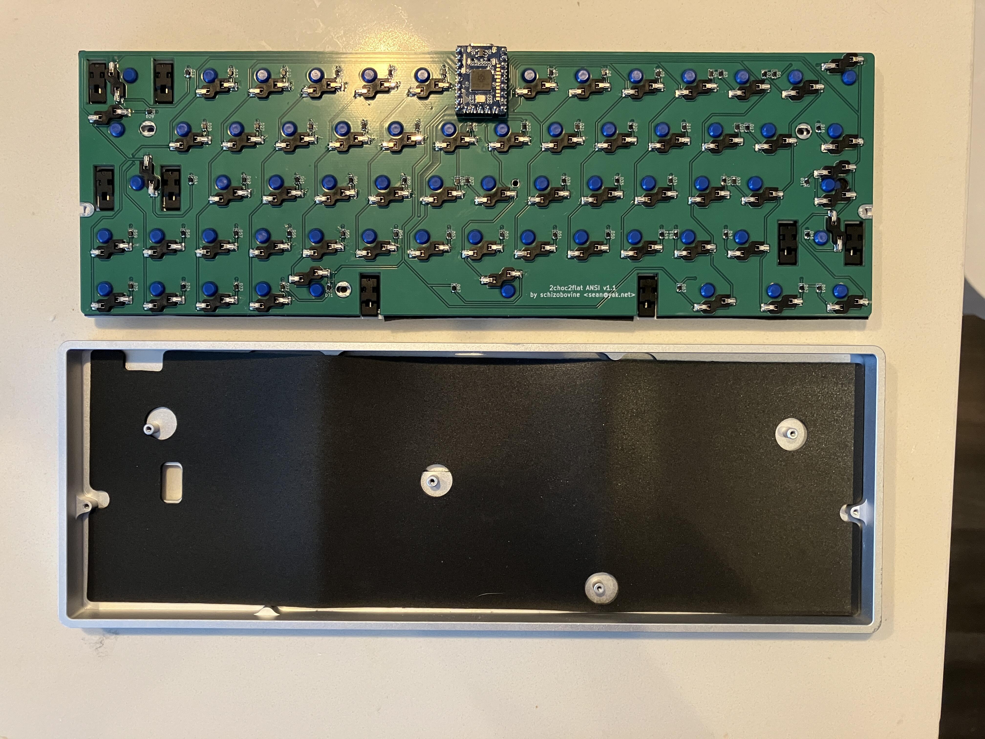

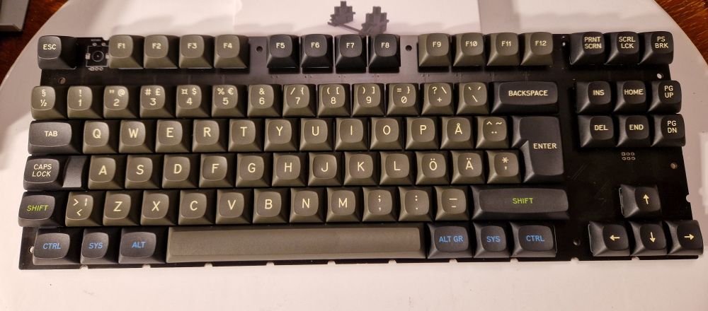

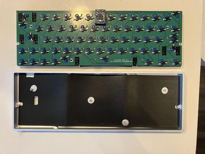

Custom PCB to use Kailh Choc v2 switches, specifically the whale silent tactiles. External MCU (Waveshare Zero) because I haven’t actually laid out a RP2040 based board before (plenty of AVR based ones tho). Case is a standard GH60 low profile with some light Dremel work.
I have an ISO(ish) version in the works. That build is currently waiting on more hot swap sockets, stabs, and a custom cut plate.

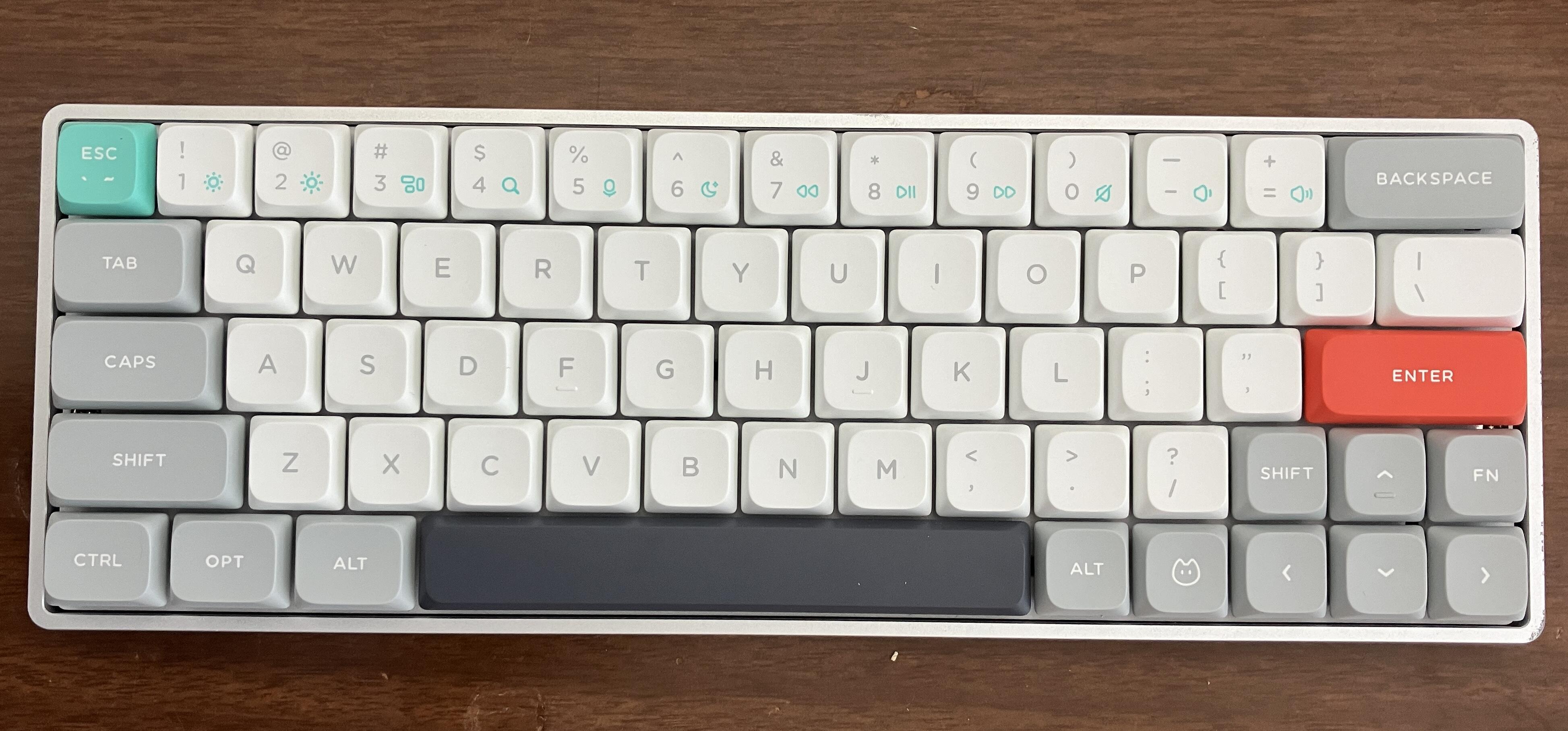

Just ticking off a milestone.
PCB with Kailh choc v2 low profile switches and MTNU keycaps finished.
That actually looks sick without the case lol

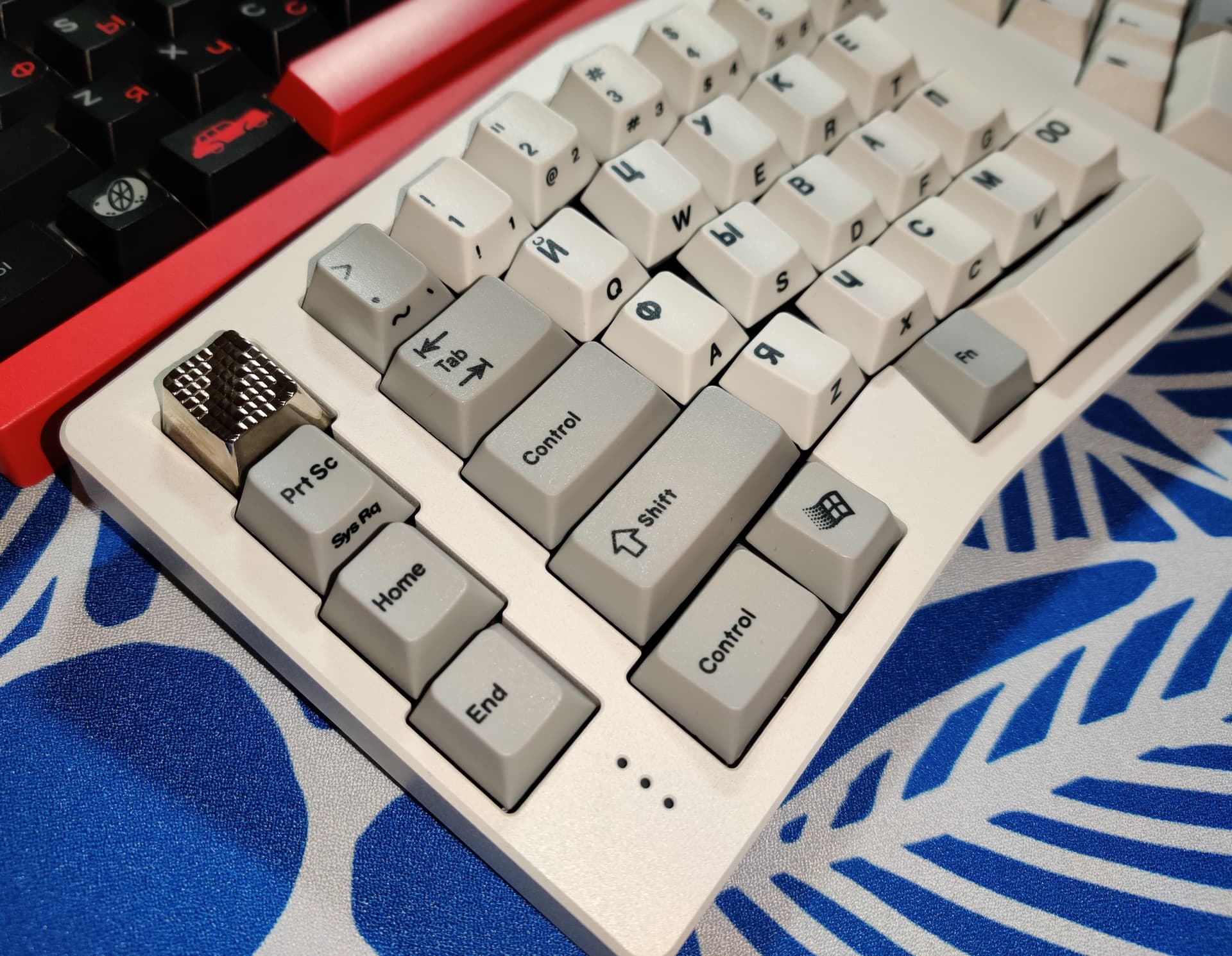

Replaced Ink-bottoms of my Cthulhu frankenswitch set with Mekanisk Ultramarine V2’s polyamide bottoms. It now sounds more distinct from the Cream Soda set and prettier. Mekanisk Ultramarine V2 with Ink-bottom sounds pretty good too.
Emerald Cthulhu recipe:
  • NK Cream stem
  • Gateron Milky top housing
  • Mekanisk Ultramarine V2 bottom housing
  • CK Super Long 58g 2-stage spring
NOTE: film is necessary. remainder combo did not need filming.

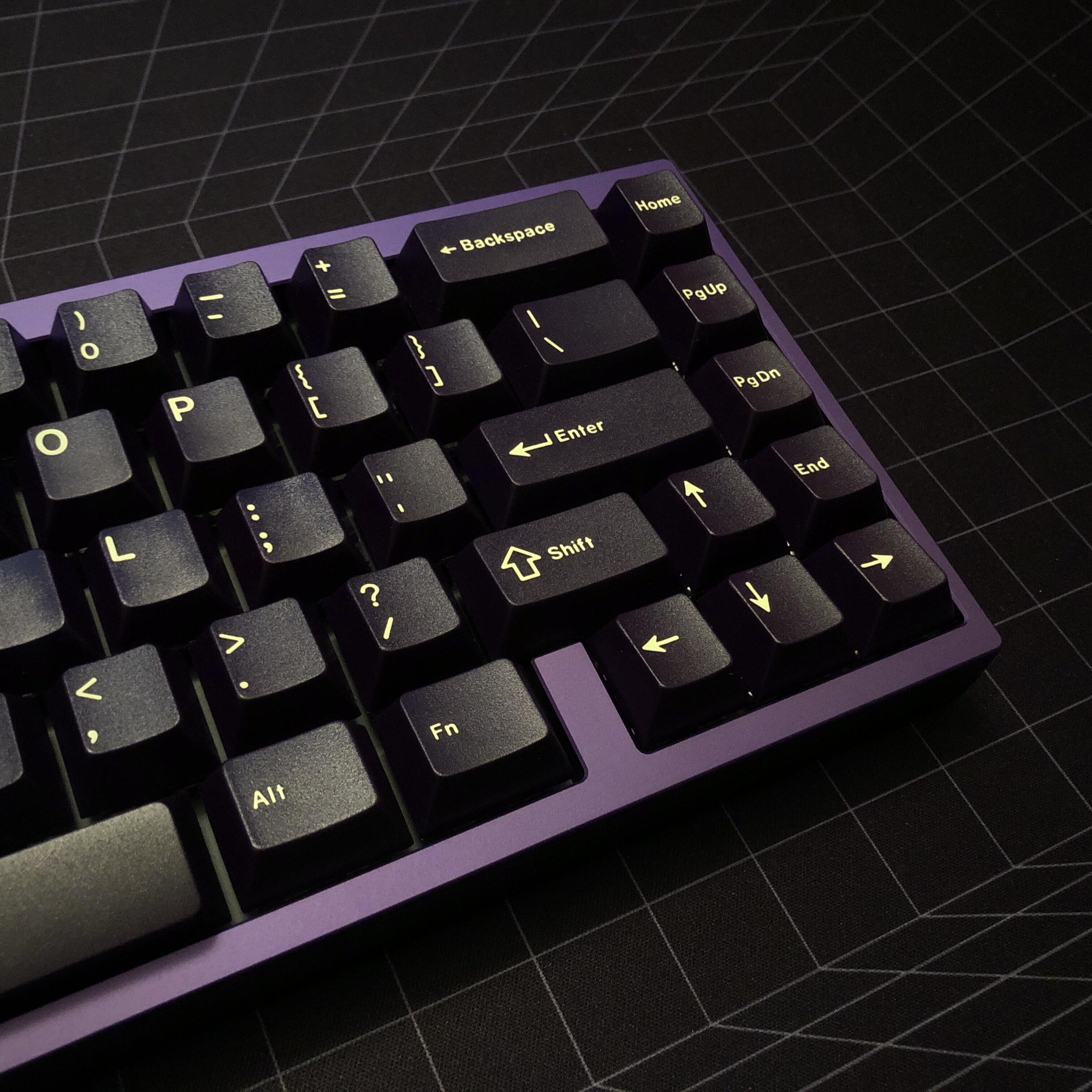

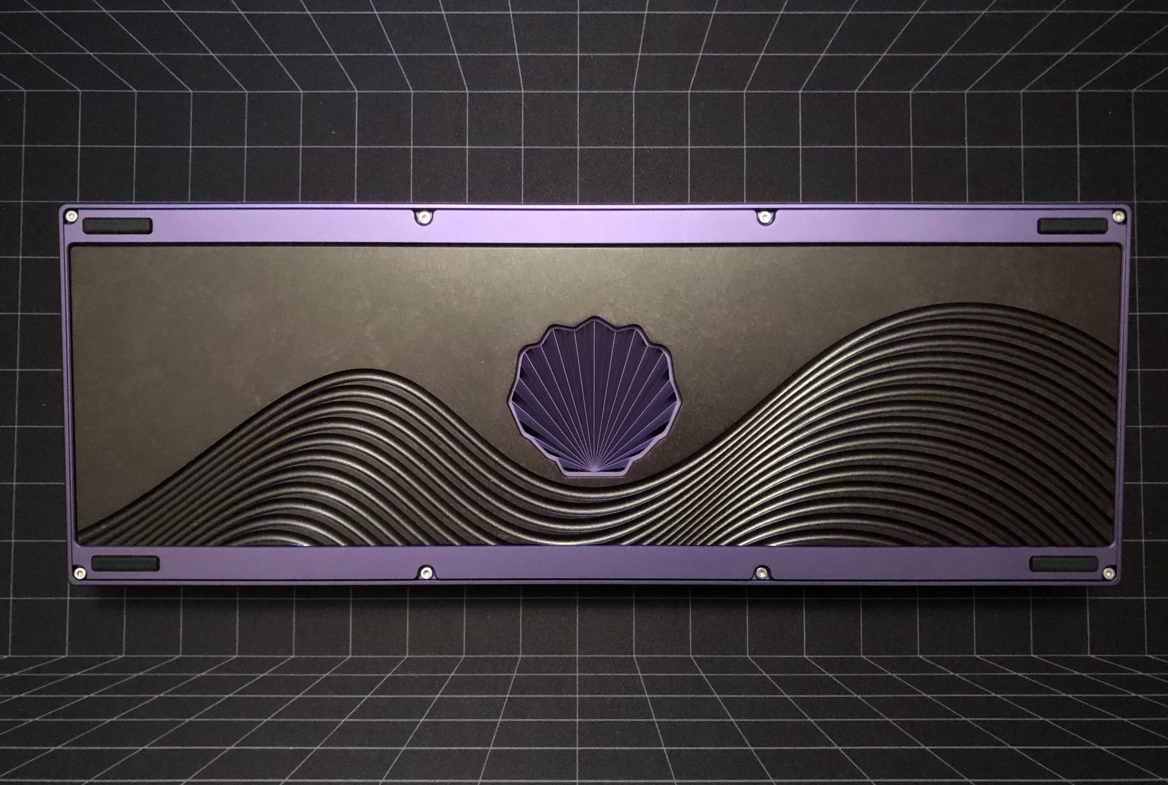

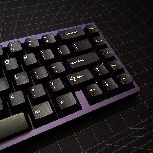

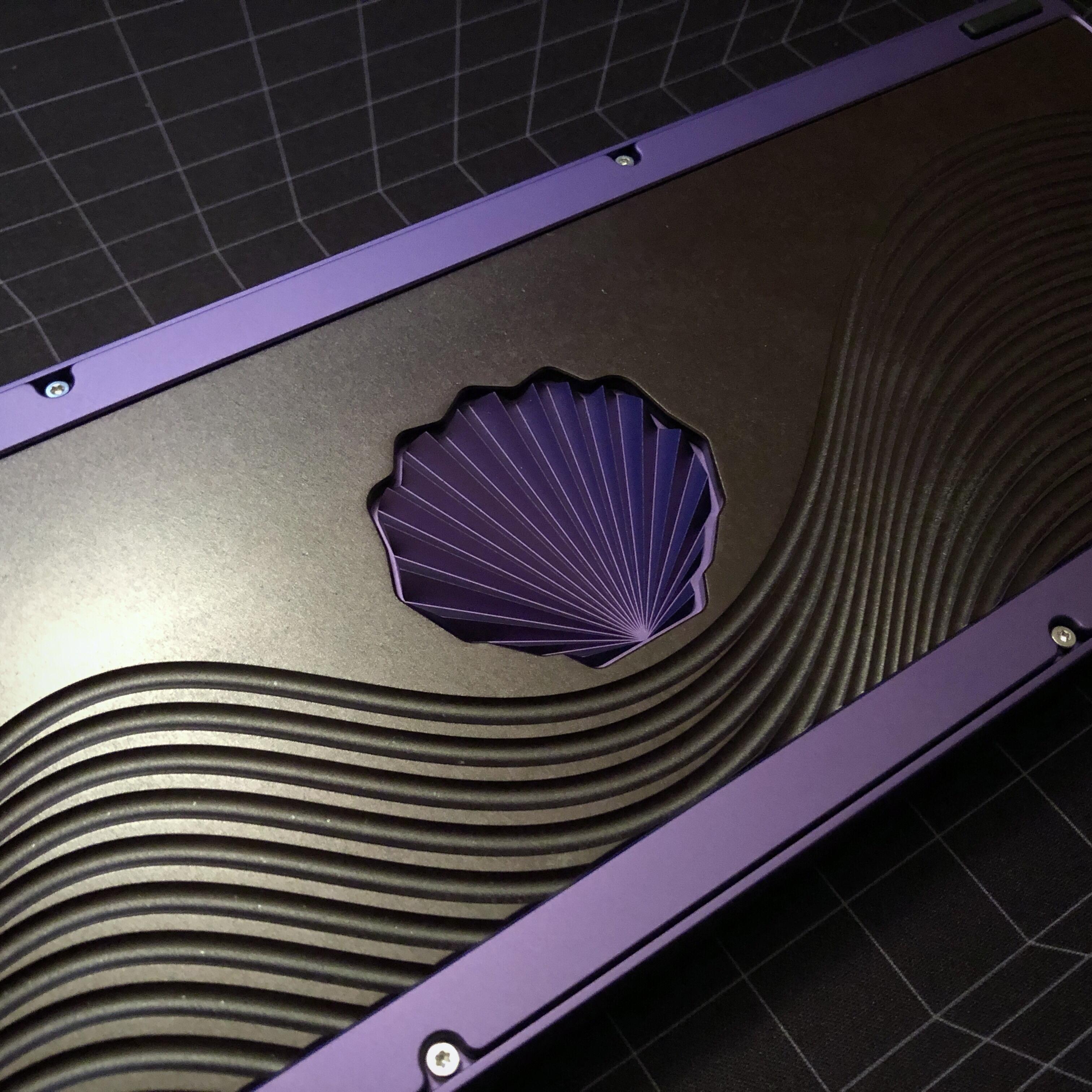

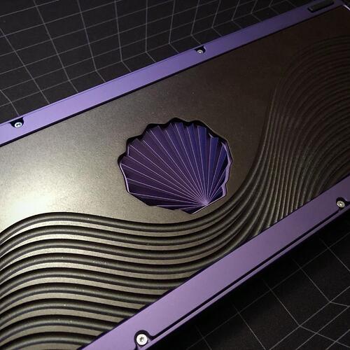

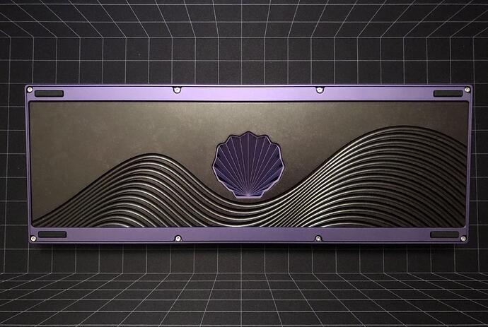

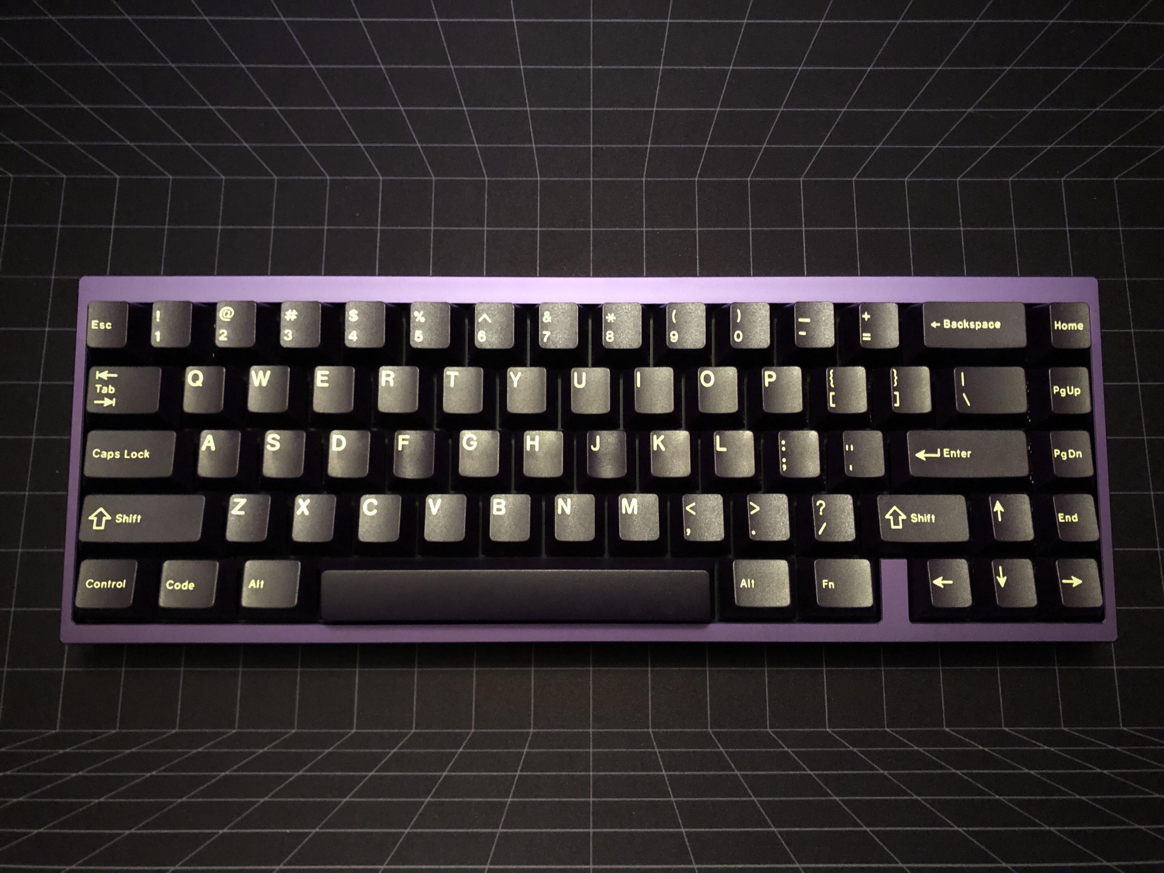

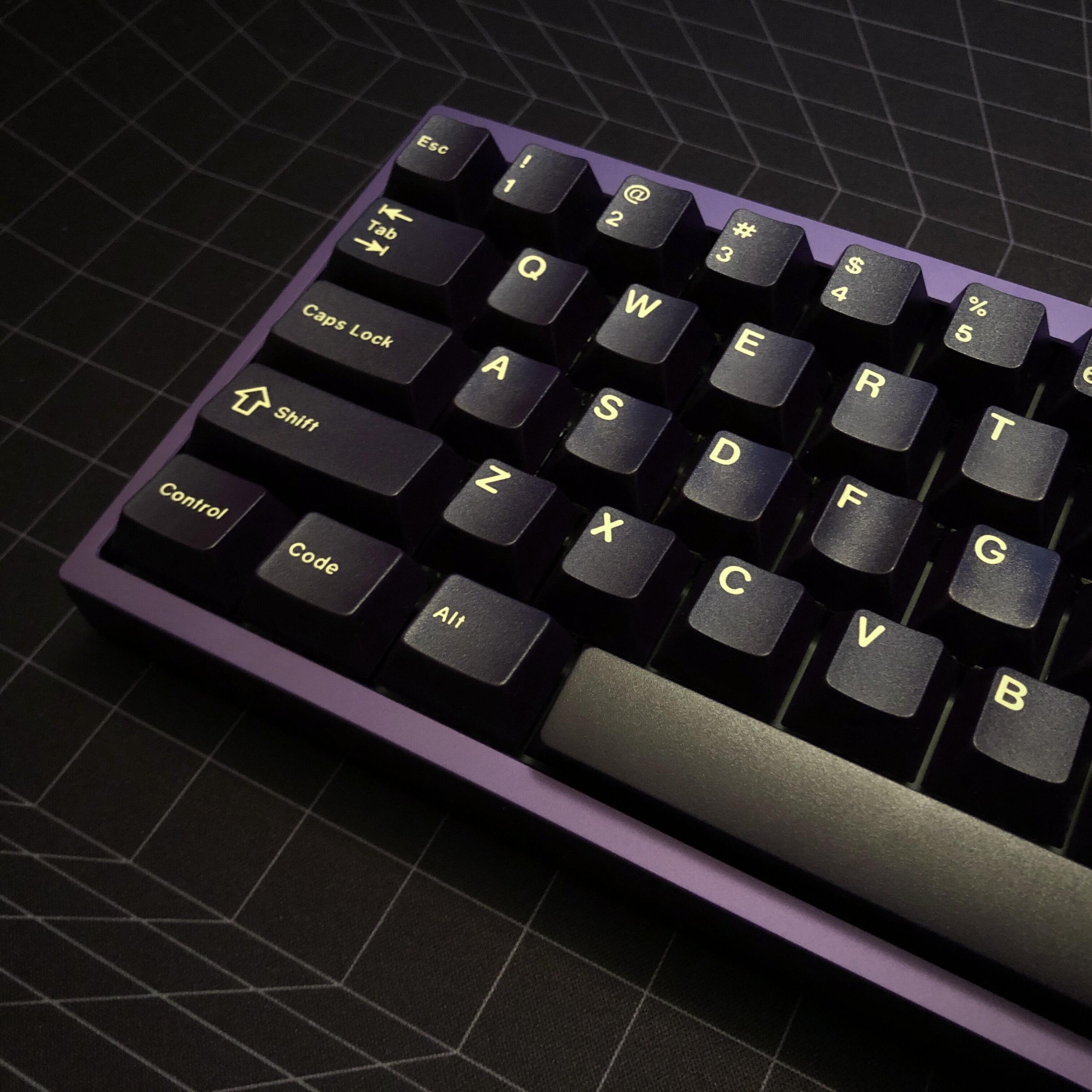

Potato photos, beautiful keyboard:
KBDfans Margo in purple
  • GMK Phantom R1
  • NuPhy (BSUN) Fleeting Gold light tactiles
  • Aluminum plate in black
  • SK Knight V2 stabs
  • Bottom foam
Sound is uninspired, but this one is all about the looks.
Looks gorgeous! Alexotos did some mods to try make it sound decent in his build video.
