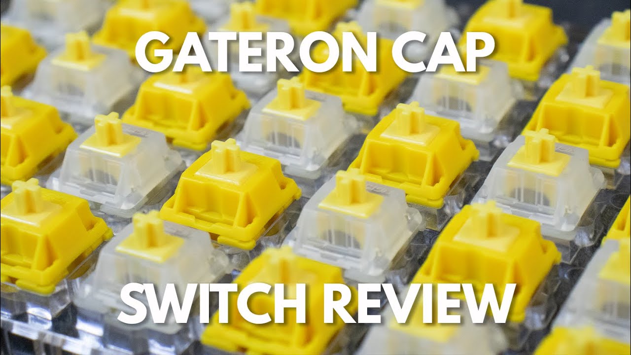

  • Their “Cap” switches use a modified version of the MX design with the stem fitting around a central pole, rather than inside a central tube; this tends to provide a more stable-feeling travel but isn’t otherwise revolutionary. The bottom-out sound is a little different, but nothing crazy. Early versions had an issue with dribbling oil, but I’m pretty sure they’ve fixed that with the V2s. These and all the other Yellows have some amount of factory lube as well, but I don’t think any of them are quite as smooth from the box as the Pros.

Here’s a video from a few years back comparing traditional Milky Yellows and CAP Yellows:
