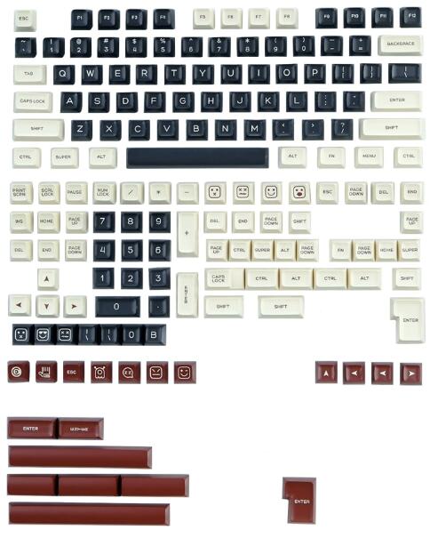

Hello there.
Looking for a set of SA iso set of keycaps i’ve noticed something I find odd.
Lots of set send an extra keycap of the letter B. Why is that? It’s not like it’s a different size, like some 0 out there or some space bar keycaps. (notice the extra B near the slimmer 0 key)
I’ve seen it in quite a few sets and I find it strange since doesn’t look to me like the B key gets the kind of stress that may warrant a replacement.
So, can anyone tell me why they do that?
Alice layout (https://kineticlabs.com/blog/what-are-alice-mechanical-keyboards) and the like have become pretty popular. They have a b on each side of the middle gap in most cases.
Since I’ve never paid much attention to that layout I must admit I’ve never noticed the extra B in there.
Thank you mate :slight_smile:
Perhaps you’re already aware but I thought I’d mention it since I own this set: they’re not actually SA. They’re one of the several knock-off kinda SA-inspired spherical-ish keycap profiles discussed here.
I don’t own genuine SA, but I’m told they’re very different in terms of profile and quality.
Can’t say how different the caps you got are from authentic SP SA, but the Maxkey SA sets I got were very similar to SPs so the difference might not be as big as you’re thinking. Unfortunately I just never got comfortable using SA so most of my SA sets are SP & get used sparingly. We have a few people around here who love SAish profiles so they could probably tell you better the differences between SP’s SA other manu’s SA.
I haven’t tried the AFSA/ASA, which I understand to be a bit nicer, but the “QX” SA mentioned here are a good value. I reckon they’ll shine faster than SP and the sound is not as nice IMHO, but they’re decent double-shot caps and there’s nothing out of the ordinary in the typing experience compared to other modestly sculpted spherical profiles. The dish is very much a rounded square and the height is a bit lower than Signature Plastics’ SA, closer to OEM, and you sort of “get what you get” with kitting. The pudding-ish partial shine-through versions can look a bit wonky when the backlight is on as they obviously didn’t (couldn’t?) adjust the legend shot to fully fill in, but that won’t be an issue with an opaque set.
