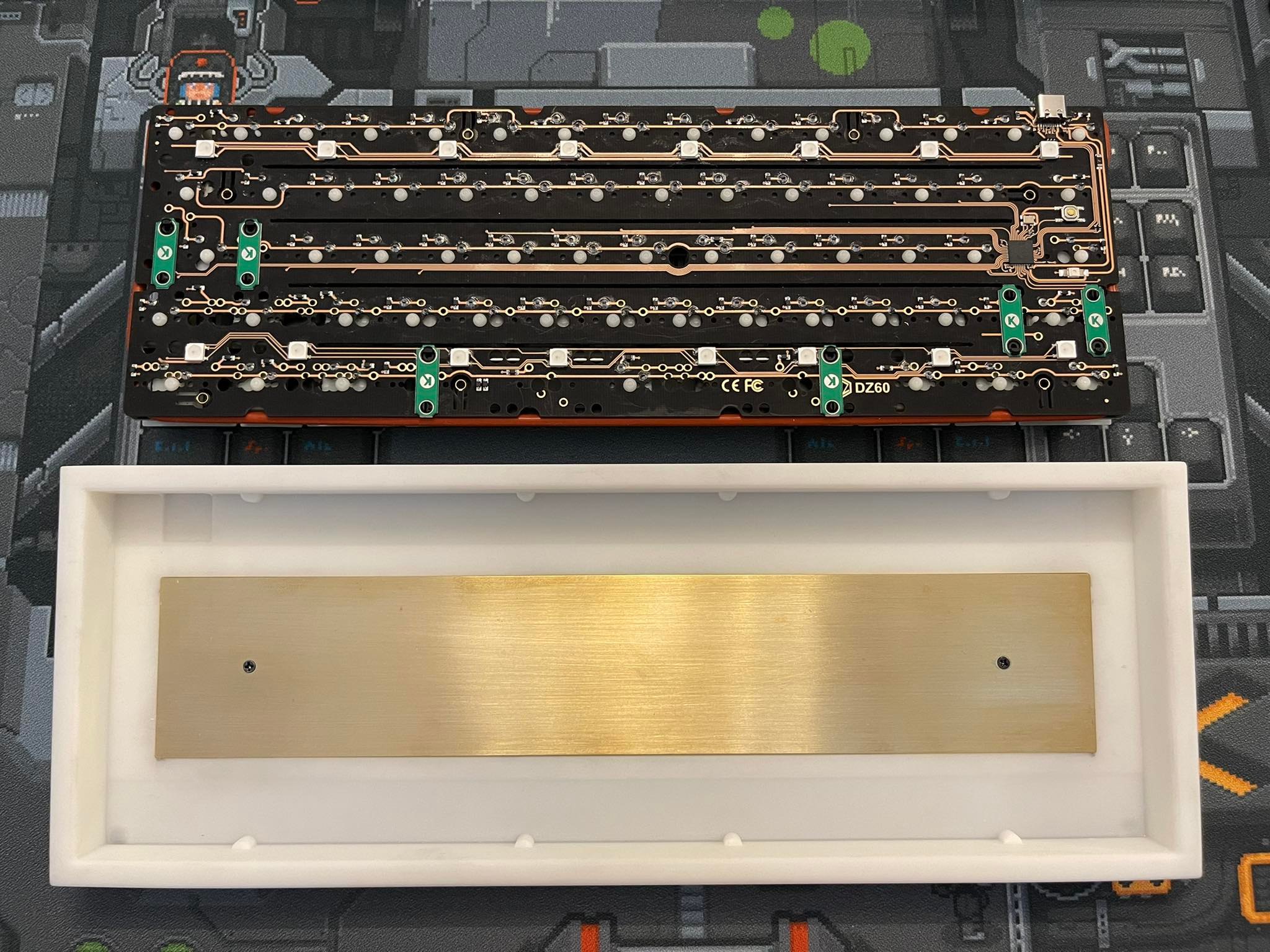

The o-ring is only there to hold it in place instead of the screws but the PCB is still resting on the standoffs.
Are you sure the standoffs aren’t cut out?

U would need cut-outs on the edges of the pcb like this.
If you could cut those out without dmg any traces it’s doable… ![]()
Are you taking about those little semi-circles on the edges? If so, I think I could do it but I would have to check the pcb
