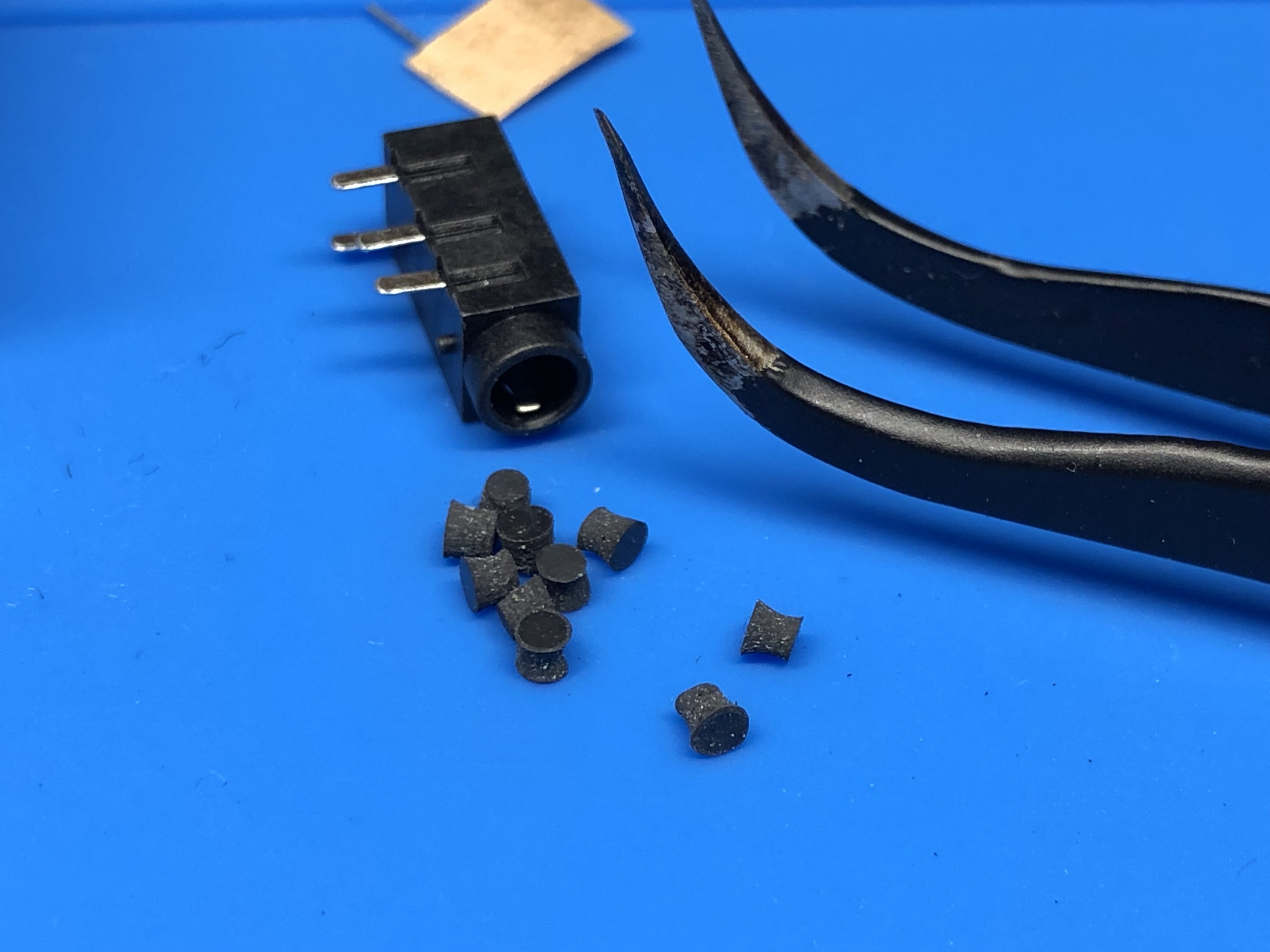

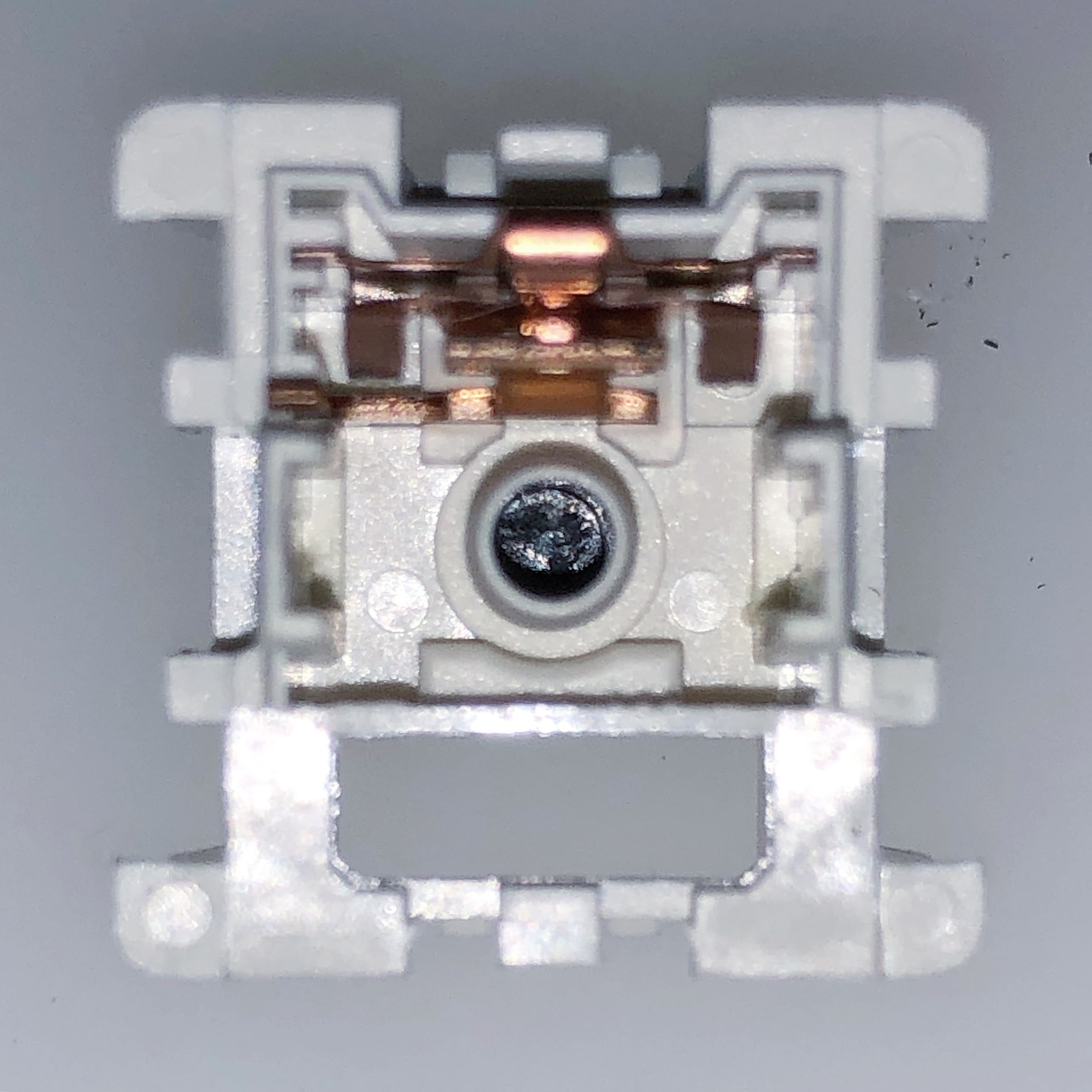

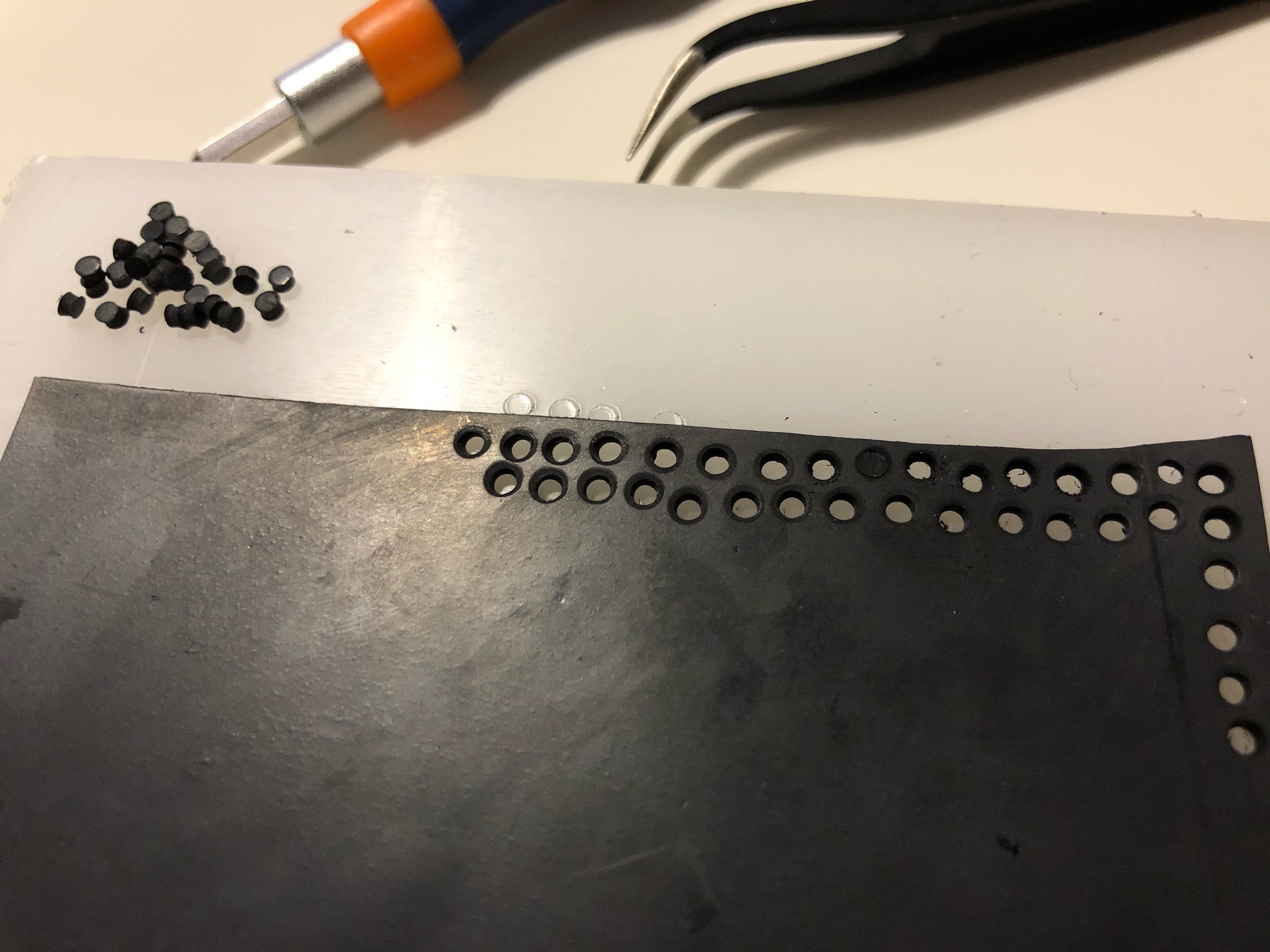

you measure the distance between no actuation of the stem and when the leaf make contact (caliper + multimeter). you take that value and buy 0.1mm less then measured hard epdm rubber. epdm is very hard, there is no mushy feel just no sound. so if it actuates at 1.4mm get 1.2mm rubber. you have to manually cut out 2mm wide circle with a 2mm holepunch. you can also get a 2.4mm japanese holepunch but the 2mm will do too because the rubber compresses a bit when punched out. this is really hard and takes way too long. you take those rubber circles and press it with a switch stem down the plunger hole - I used one i carefully cut straight off and filed down a bit so I’m left with a flat end. be careful! you want to insert it straight and press down straight because if it rotates 90 degree you’re screwed - you will never get that rubber ball back out there.
next you want to select a switch that also fits qmx clips. with linears thats easy, they will all work. with tactiles its harder because the qmx clips take travel off the top. its not much, but it can lead to loss of the bump. MOD switches work great for it. the qmx clips press enough down on them to make the bump start RIGHT when you start pressing. its a feeling like topre. overall all of this will feel like topre once you’re done, just with less travel.
with those two items you will completely silence both up and down stroke. you can additionally use a silent switch with a strong padding like the outemu silent switches (gazzew), they have thick rubber blocks on their shoulders.

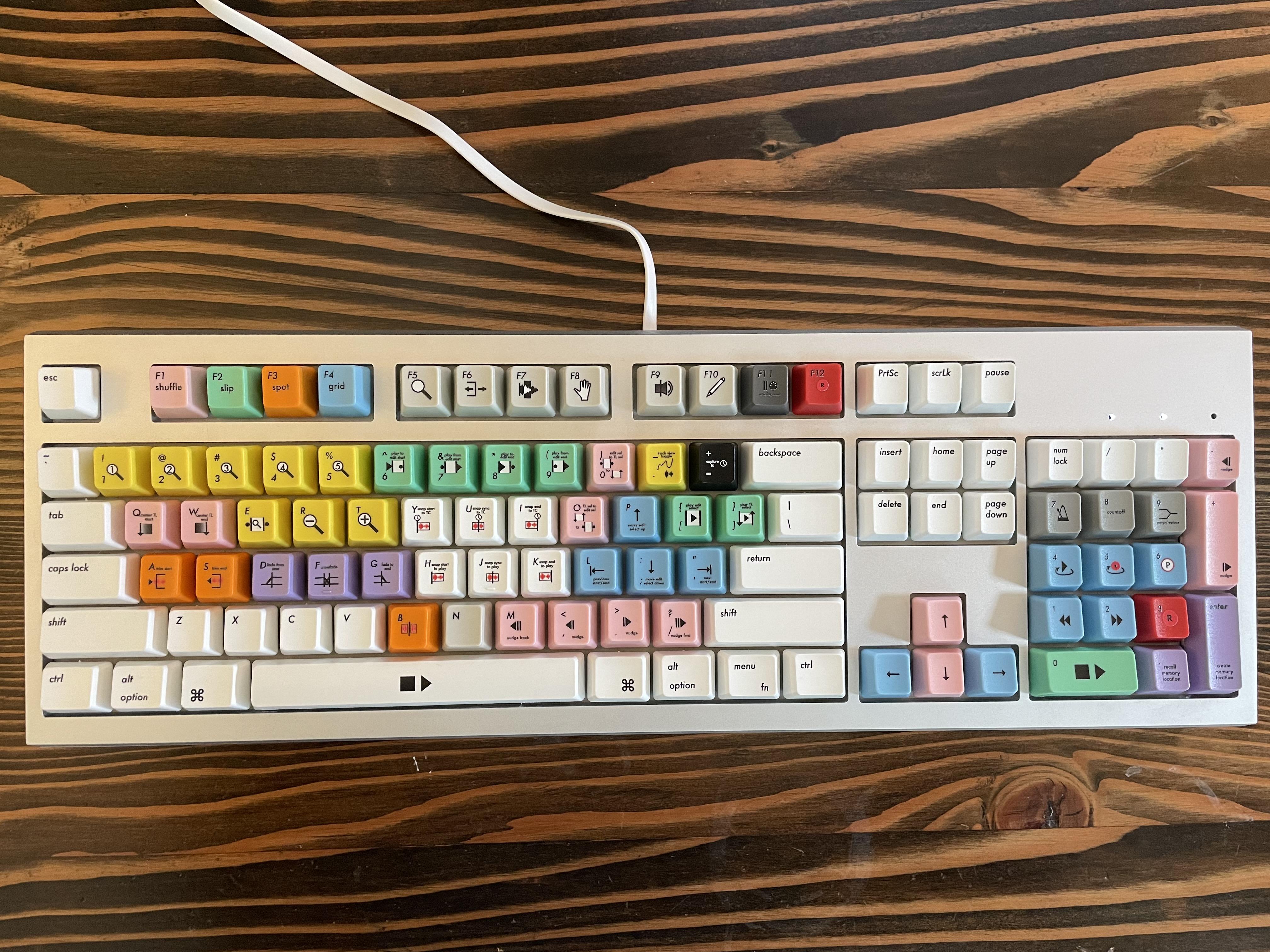

I would love to use thicker keycaps but the whole point of this is to use the protools keycaps from WASD. They are pretty thin which is why I am filling them out with felt and blue tack. Silicone is a good idea, however, I think dampening foam will accomplish the same thing. The silent forest switches kind of eliminate the need for a lot of your suggestions wouldn’t you say? I will not using QMX clips because they ruin key feel.
