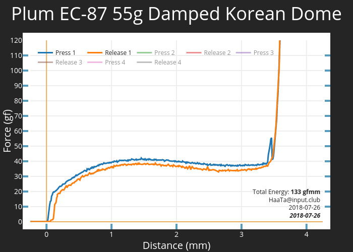

I DID manage to bring along a Plum EC87 with 55g Korean domes! The result was surprising - quite similar to what a 40g Topre switch would be, with less falloff.
https://plot.ly/~haata/573/plum-ec-87-55g-damped-korean-dome/
Plum EC-87 55g Damped Korean Dome

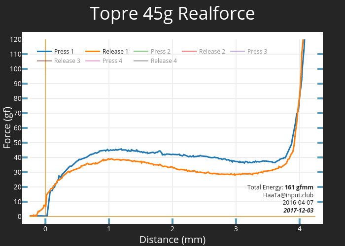

For comparison:
Topre 45g Realforce
