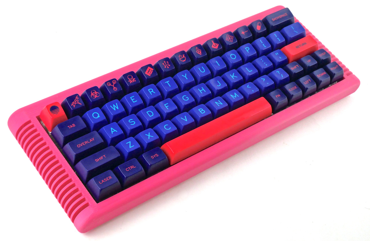

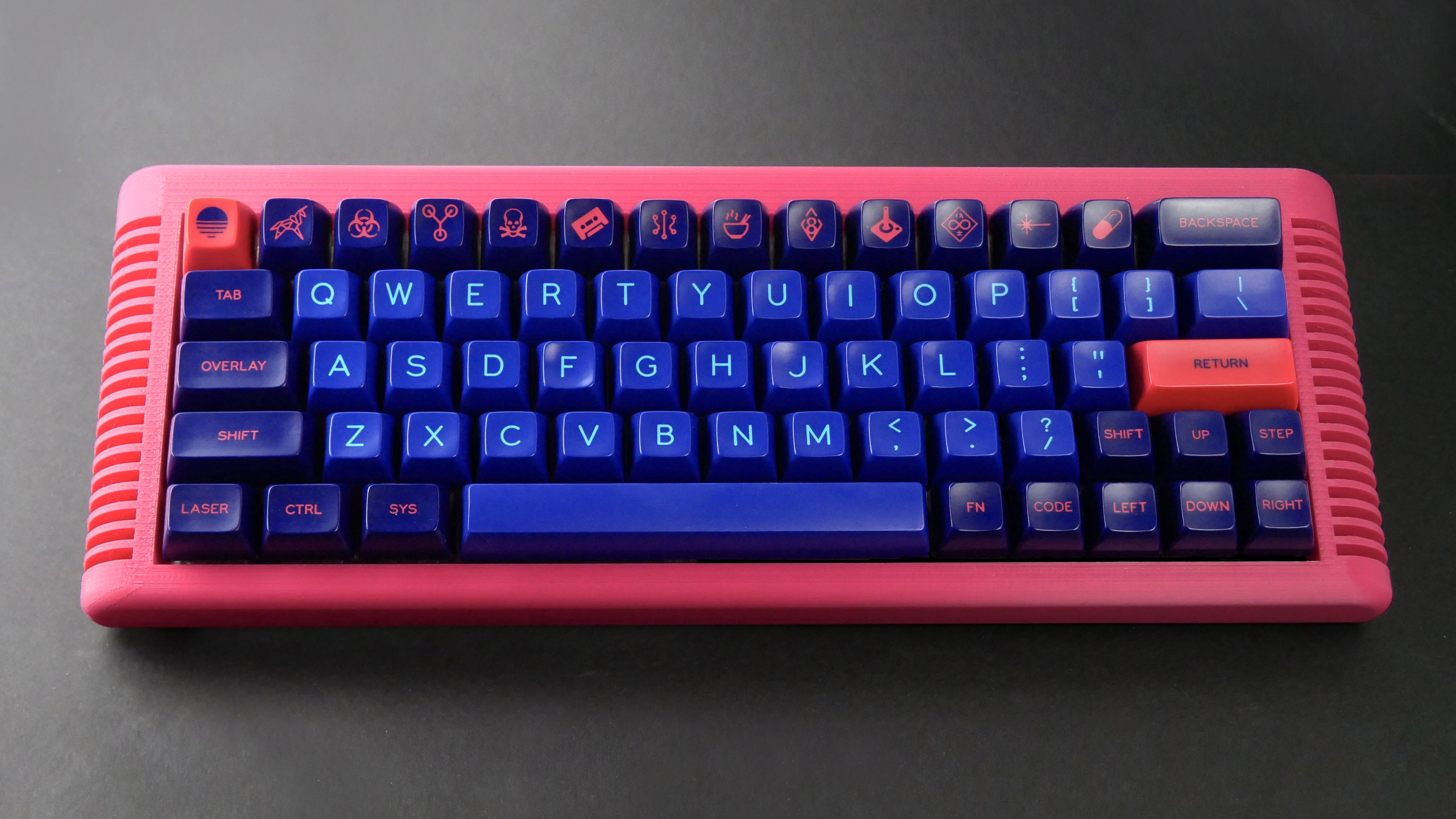

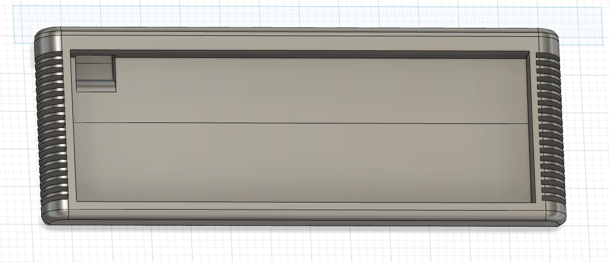

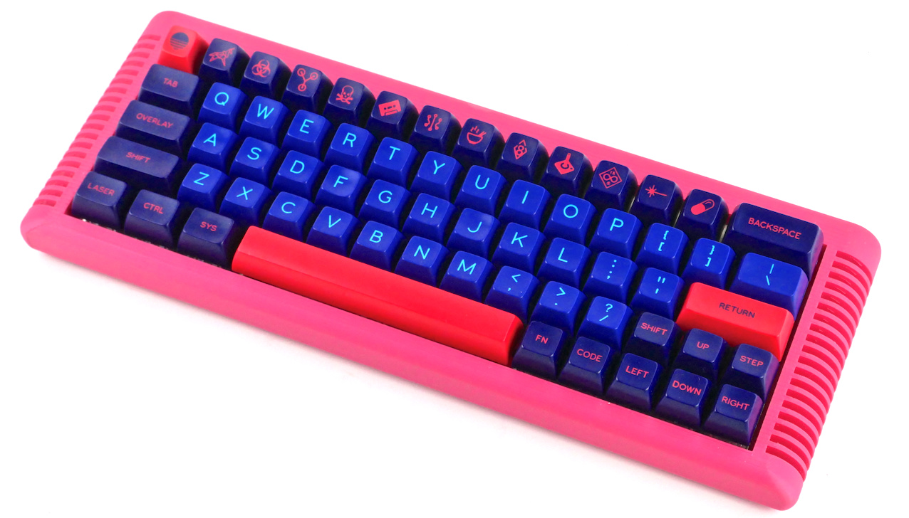

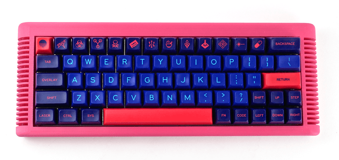

I posted about printing my first keyboard case a while back, but I finally decided to try my hand at designing one in Fusion 360.
It was definitely a learning experience since I don’t really know how to use the program, but I’m slowly catching on. I had to print several iterations to get the sizing, etc. correct.
I didn’t originally design this with SA Laser in mind, but then I saw that I had some hot pink filament and decided to see what it would look like. It would be nice if it was an exact match for the pink accents, but still I think it looks pretty decent, and it functions as a case, which was the important thing.
I bought some brass knurled nuts that I could heat up with my soldering iron to melt them into the case, allowing me to use screws to attach the PCB to the case. But I had trouble figuring out where to place standoffs in the 3D model so I ended up not doing that.
This was printed in 3D Solutech PLA on a Creality CR-10S4 printer, which is big enough to do it all in one piece. Due to the curves, I needed to print it at .1mm layer height, which meant it took more than 30 hours to finish. But it didn’t really require any kind of post-processing.
[EDIT: I decided to get rid of the pink space bar and take a photo in different lighting.]

Dang dude, that looks awesome. The design is pretty sick for you’re first go! I think 3D printing gets a bad rep because so much of it is so low quality, but when done right it can be very nice. I have a nouvelle form @keyboardbelle and it is very very nice with a really satisfying kind of deeper sound than most of my other boards. I dunno if they still are on here but maybe they have some insights into 3D printing keyboards, considering how many they’ve done.

This maybe just the pictures, but the case looks too smooth for a printed one. How come? Was it sanded after?
No, it’s just printed at a finer layer height than people typically use for 3D printing cases (since it takes so long, it’s not practical to do that if you’re wanting to sell dozens of them). But for a one-off that I’m using myself it doesn’t really matter if it takes a long time
Oh, I see. These edges does look stunning! But I imagine that to make 30 hrs per case commercially viable it would probably have to be about the same price as high end CNC cases.

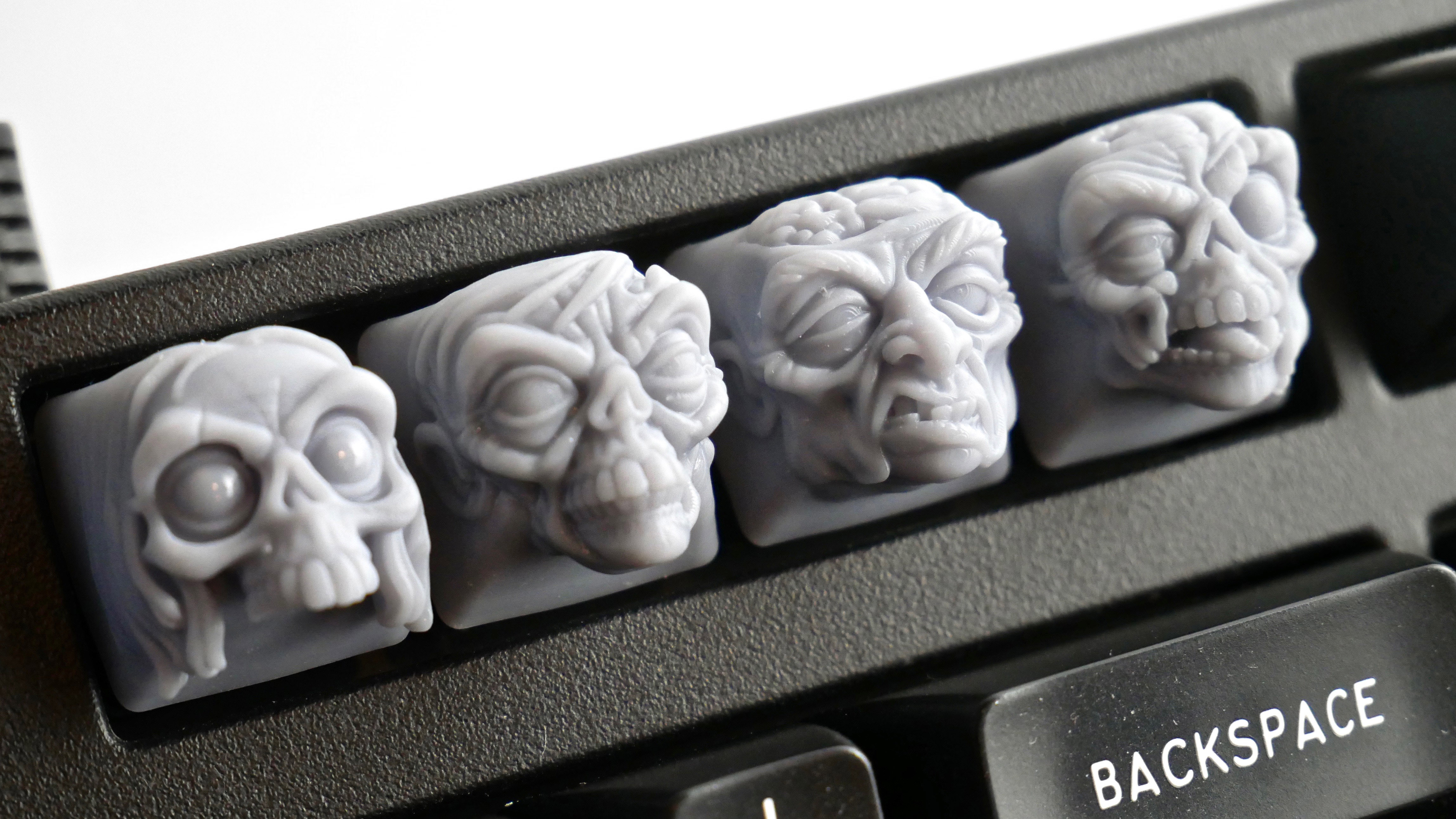

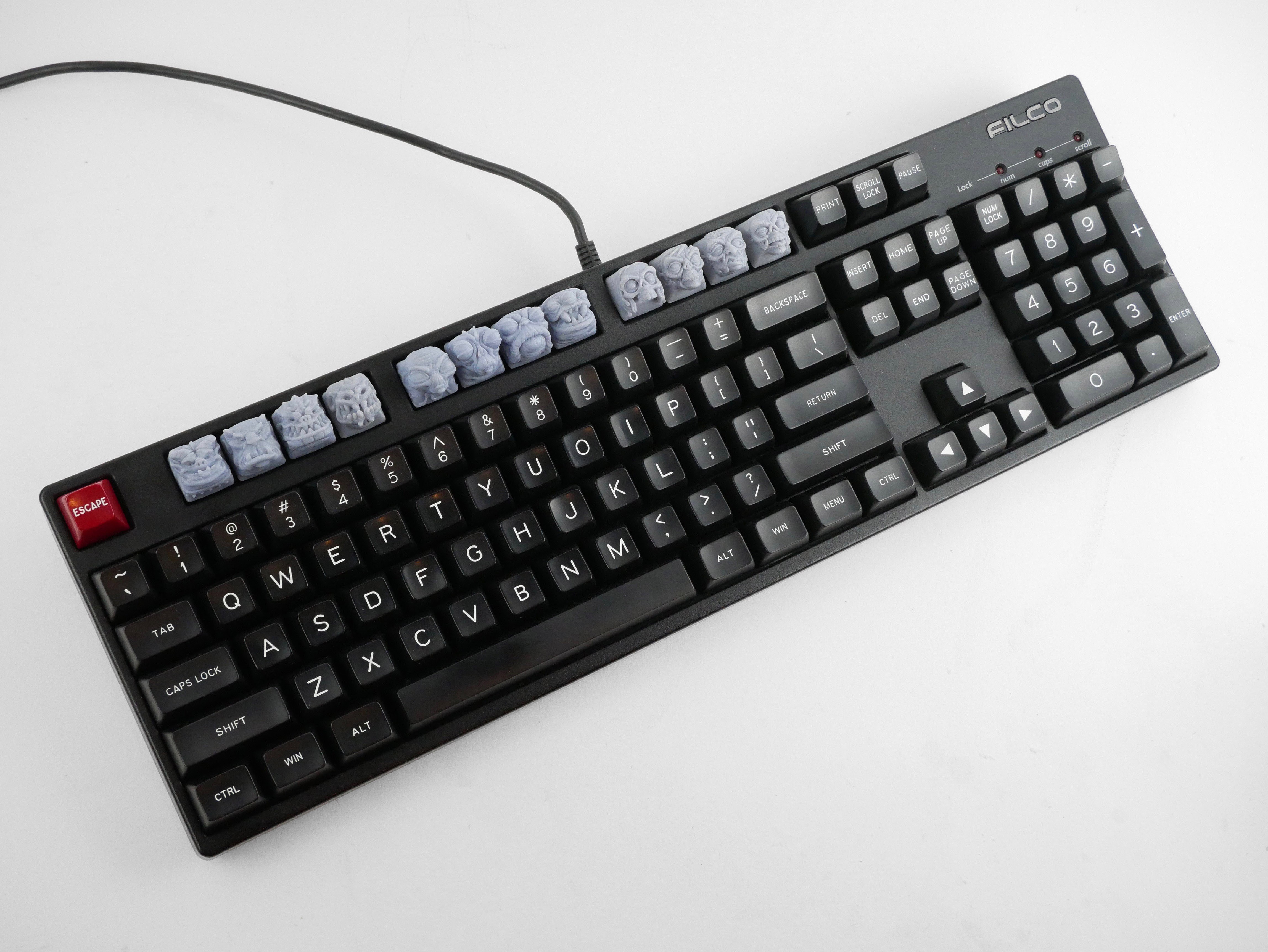

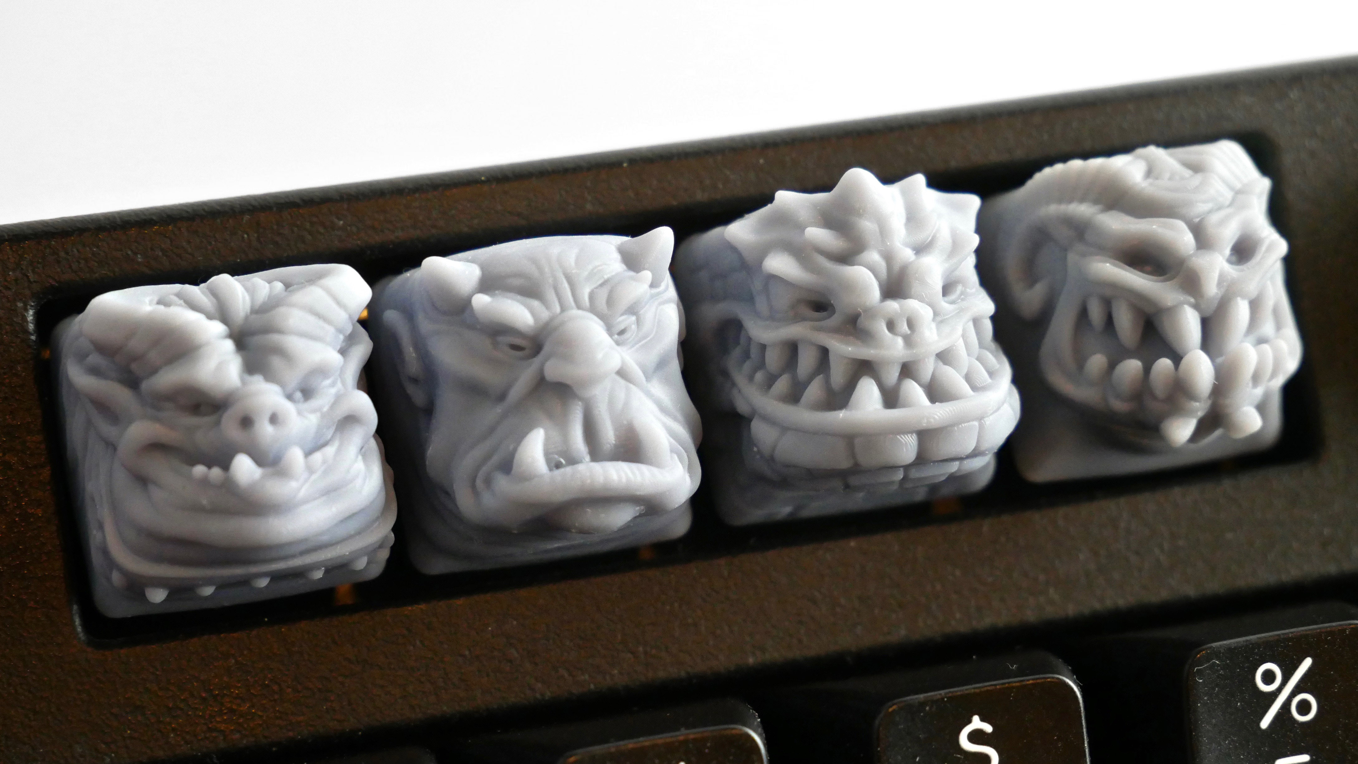

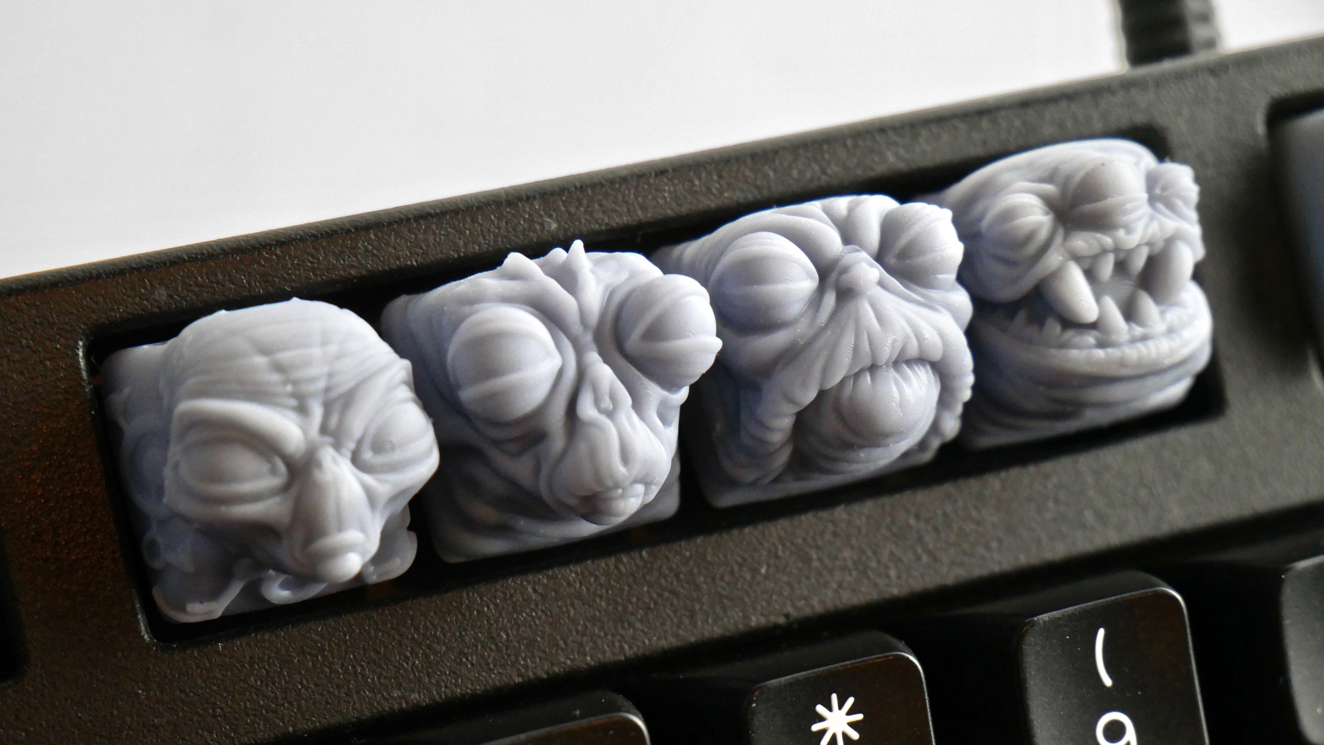

In other 3D printing-related news, recently there was a Kickstarter project for some 3D printable artisan keycaps. It only barely got funded, which kind of surprised me, but I suppose the number of people who are both interested in artisans and are able to 3D print them is relatively small. There were 12 designs (4 aliens, 4 demons and 4 zombies). I printed them all on my Longer Orange 30 resin 3D printer and they came out perfectly. It’s kind of amazing, actually. And I think it only cost $2 or $3 to print them all.
I put them on my Filco Majestouch for now since I don’t really know what I will do with them. I’m considering putting a black paint wash on them to bring out the details, but they look pretty good as they are. Of course fully painting them would look the best, but that would take a long time.
Wow, those artisans are really nice! (and that’s coming from a not-normally-an-artisan-guy). You’re right that it would be neat to see them painted!
