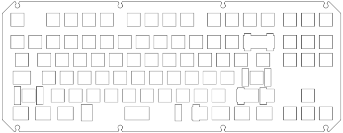

I think the stopping block right now is that I’ve got to figure out a way to have the plate file edited in order to remove the ‘flex cuts’ that were meant for a metal plate.
The HMKB has metal / brass only, so there are significant flex cuts in the plate. But they are not supposed to be present in polycarb.
I already have a custom polycarb plate for the HMKB, but I submitted a stock plate file, which means that it has flex cuts. The person who made the plate later said that such a plate could have too much flex.
So I need a flex-cut-free plate file before asking anyone to build anything.

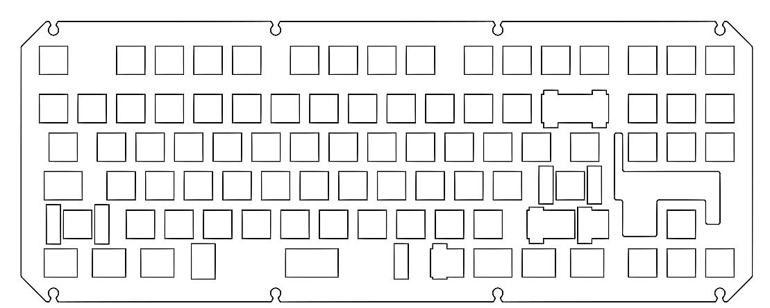

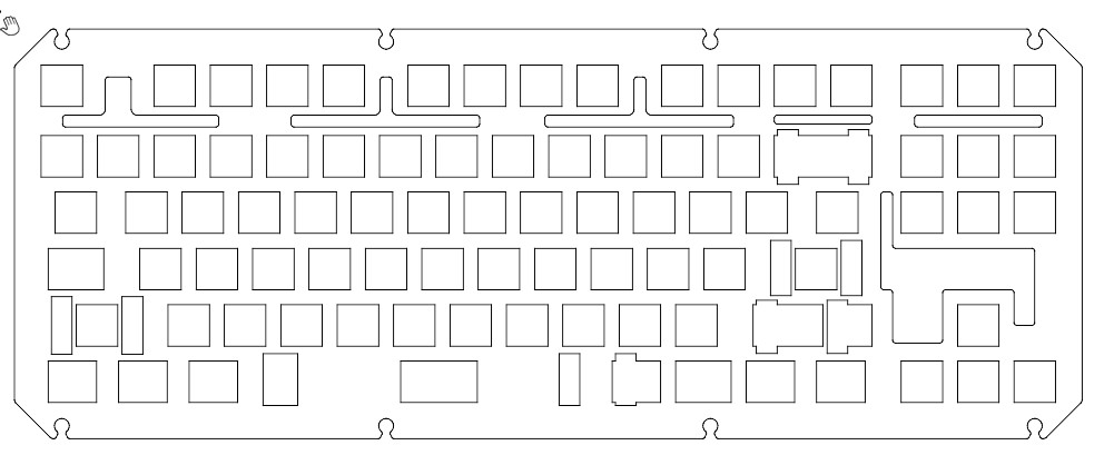

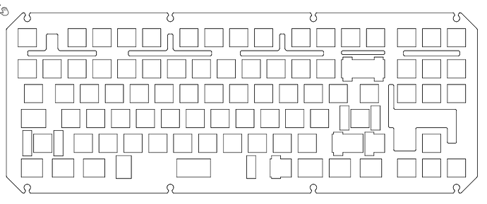

A kind person managed to delete what they think are the flex cuts.
2 Versions: one with flex cuts deleted, and one with any other suspicious cuts deleted.
LessFlex
https://cdn.discordapp.com/attachments/705429775665332274/860384885276934174/HMKB-80-PLT-ANSI_lessflex.dxf
EvenLessFlex
https://cdn.discordapp.com/attachments/705429775665332274/860386766854553630/80-plate-ansi_evenless.dxf
Does this constitute deletion of the flex cuts?
I would say yes on the even less flex file shown below from your files. But I don’t know why the cut out exists over the arrow cluster I don’t know it is necessary or could be removed.
Less Flex:
Even Less Flex:
Good observations. I’ll see about the arrow cluster.
Ok, so here’s the final contender maybe:
https://cdn.discordapp.com/attachments/705429775665332274/861632378568572938/HMKB-80-PLT-ANSI_nocuts.dxf
I think all the flex cuts may have been removed?
Looks good!
Okay, I will try to get this built and let you know how it goes!
