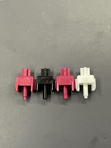

More Cream Stem fun!
Comparing the tapered and flat Burgundy Pro stems with those of the Cream+ and Cream Dreams.
The tapered Burgundy Pro stem is about .3mm longer than that of the Cream Dream stem, which I believe have the same specs as the normal Creams, just broken-in at the factory.
The N/S faces of the stem of the Burgundy Pros extend farther down as well.
What’s also interesting is that the flat-bottomed Burgundy Pros, Cream+'s, and Cream Dreams are almost identical in length.
Also, the Burgundy stems are semi-hallowed out…
As far as how they all sound in a Cthulhu setup, almost identical. The Cream+'s bottom-out isn’t as bright, but similar in tone, at least being actuated next to my ear. In board may be a different story.
This is just a quick and dirty comparison, and I hope to have more information soon as I craft the next batch of Frankenswitches. :+1::+1:
