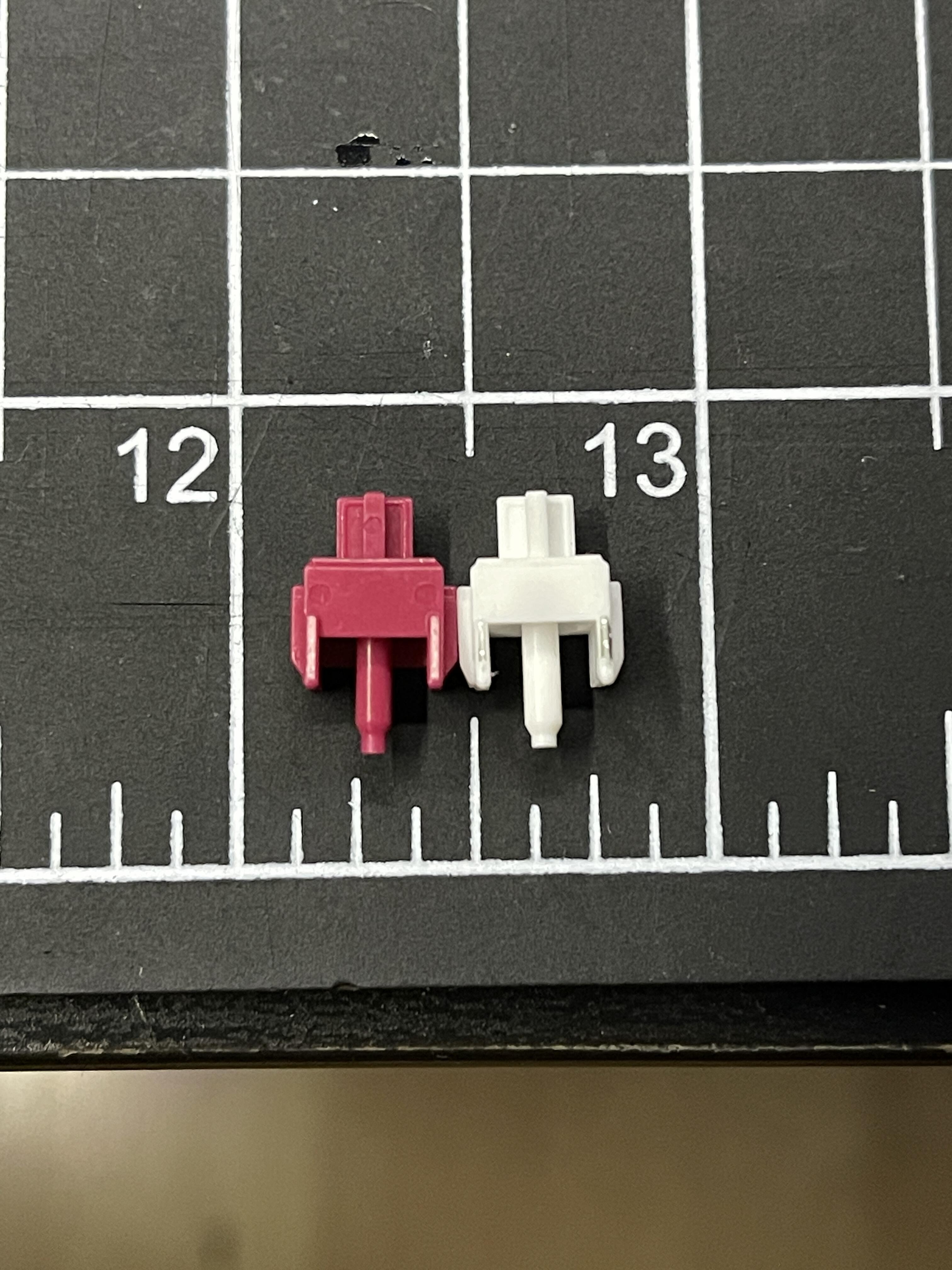

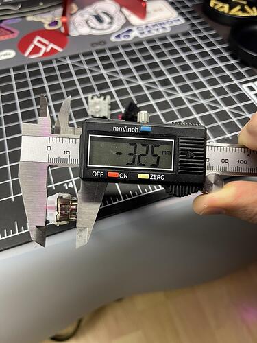

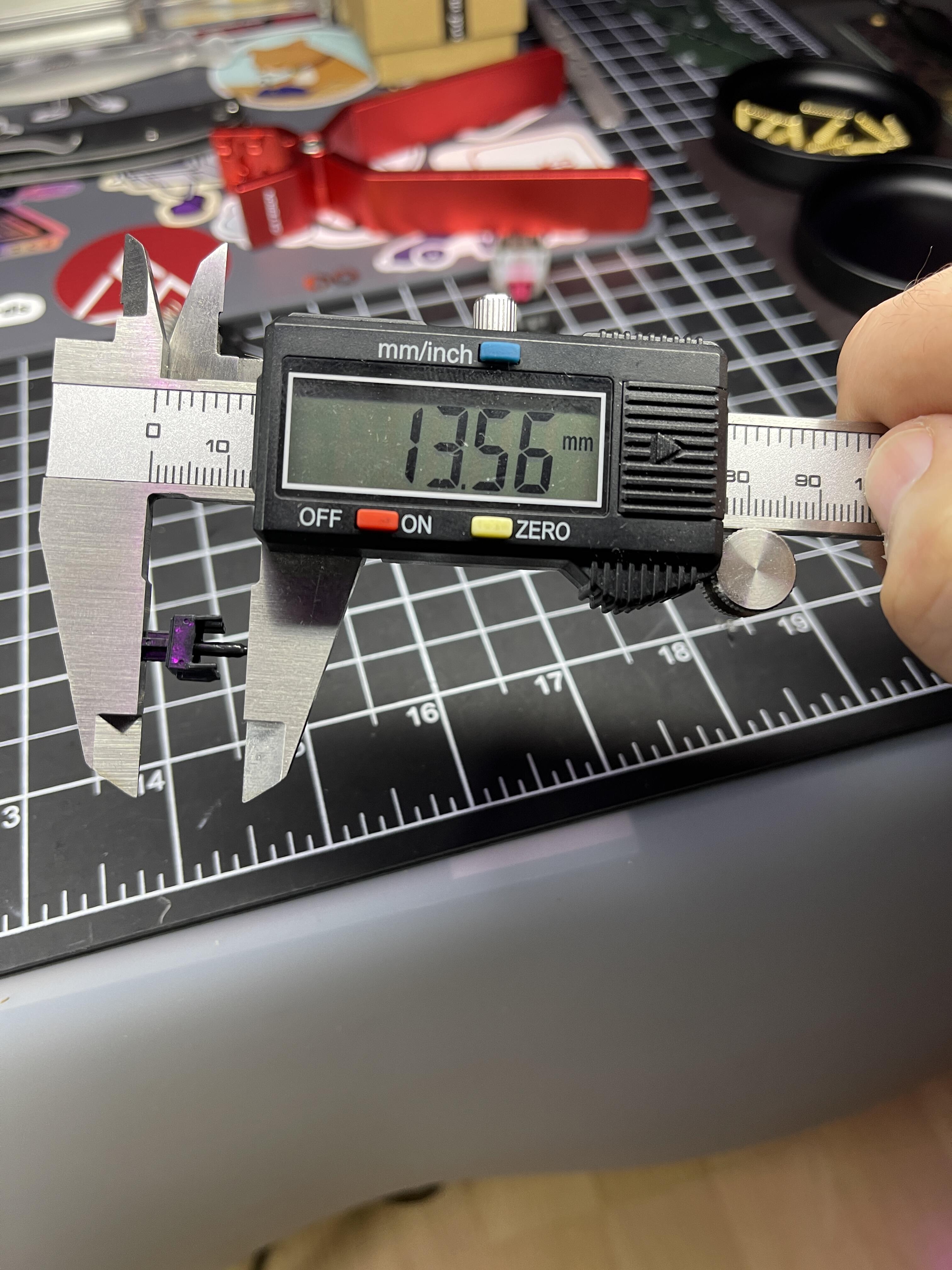

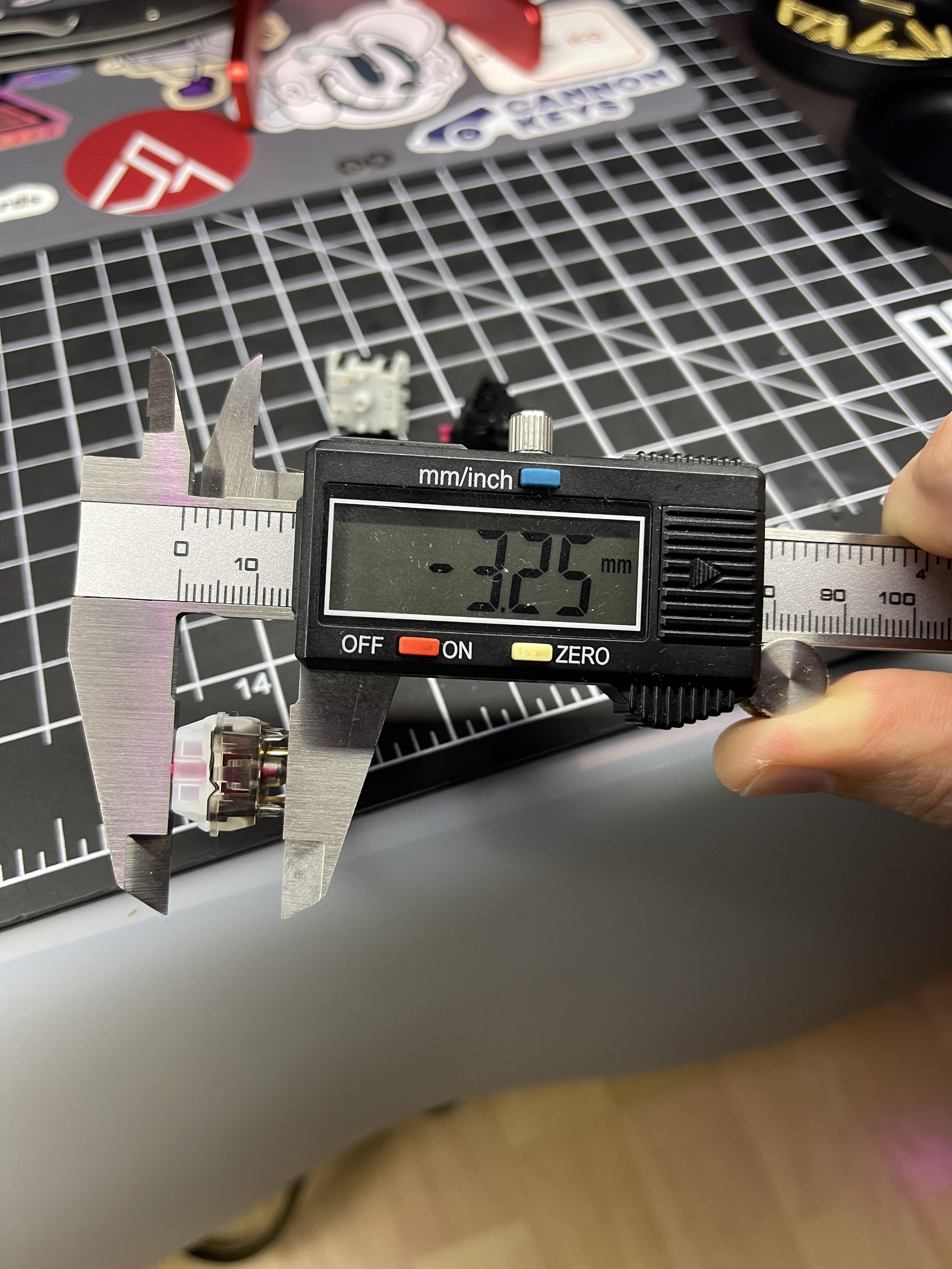

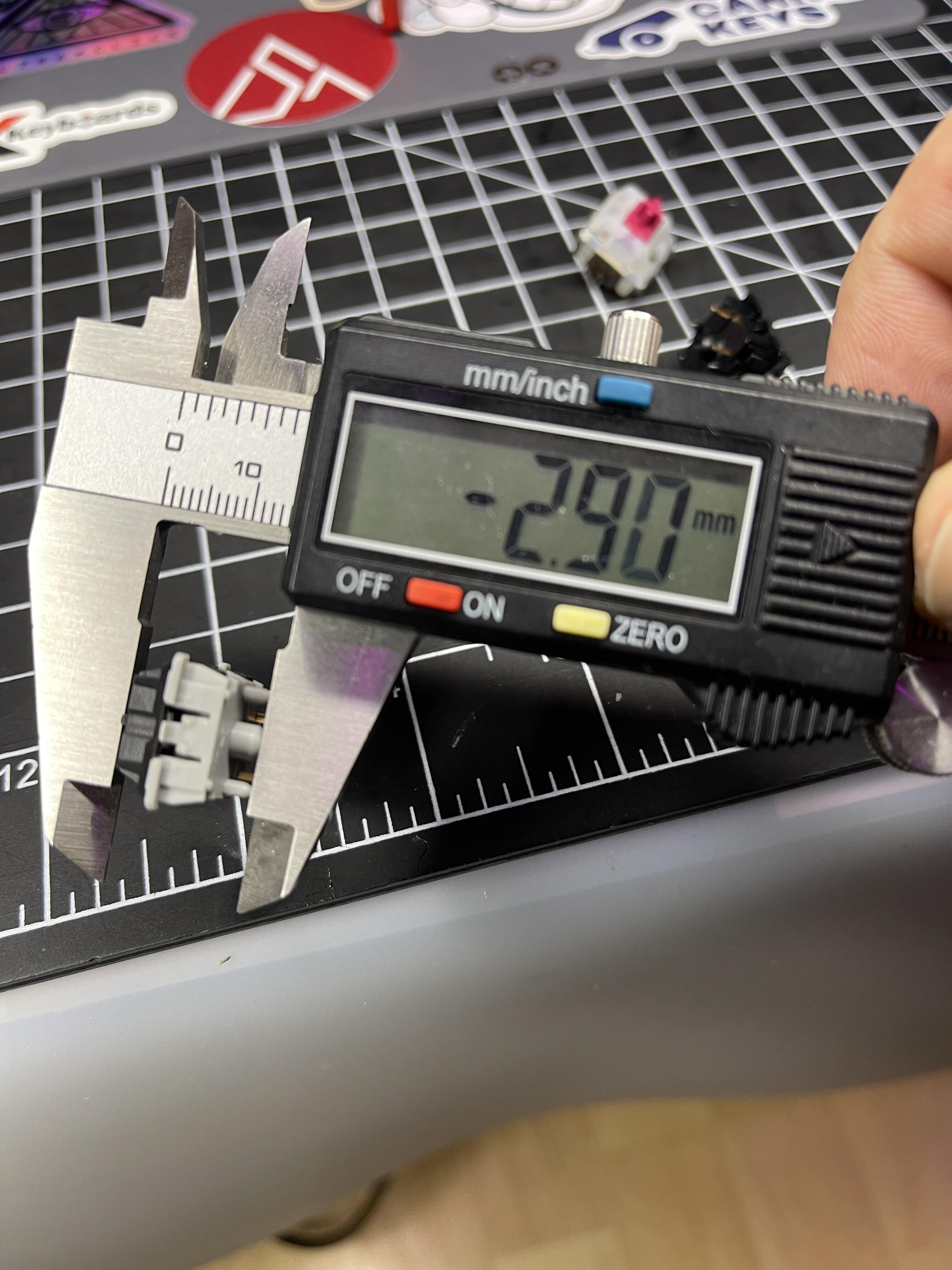

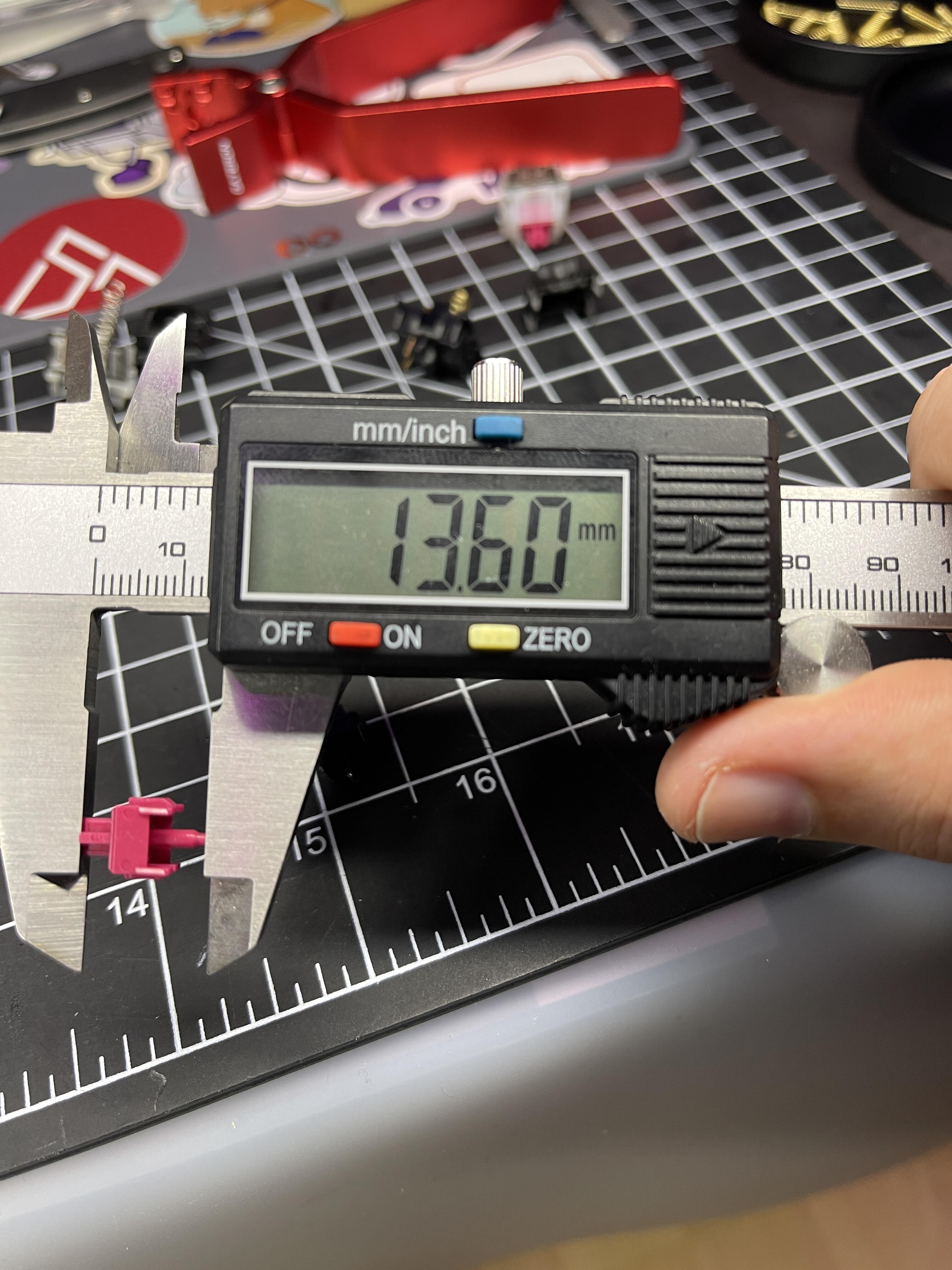

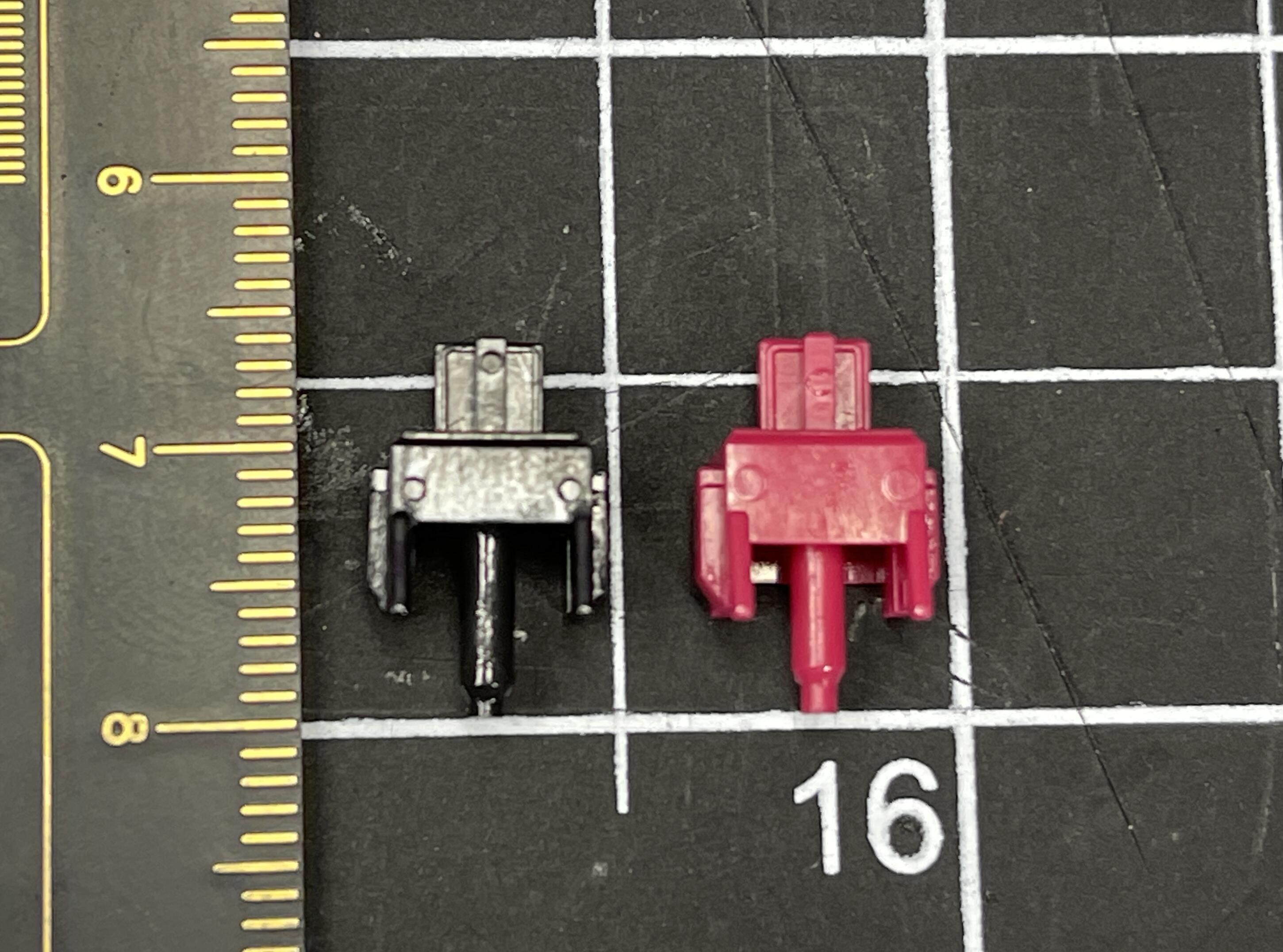

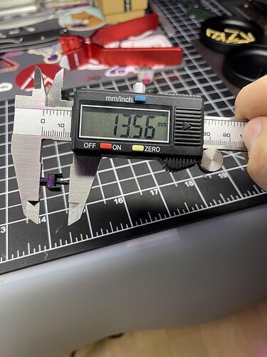

More Cream Stem fun!

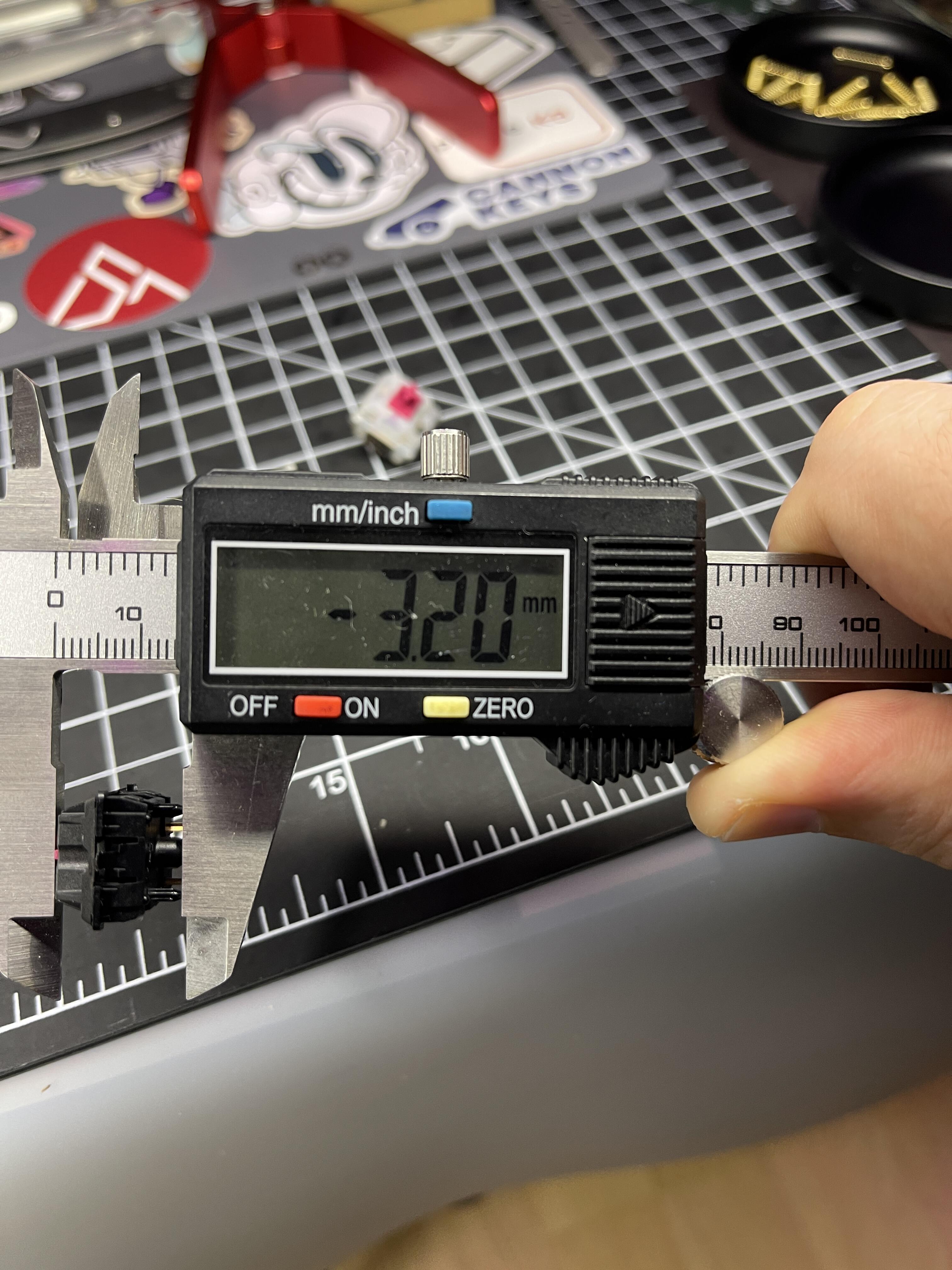

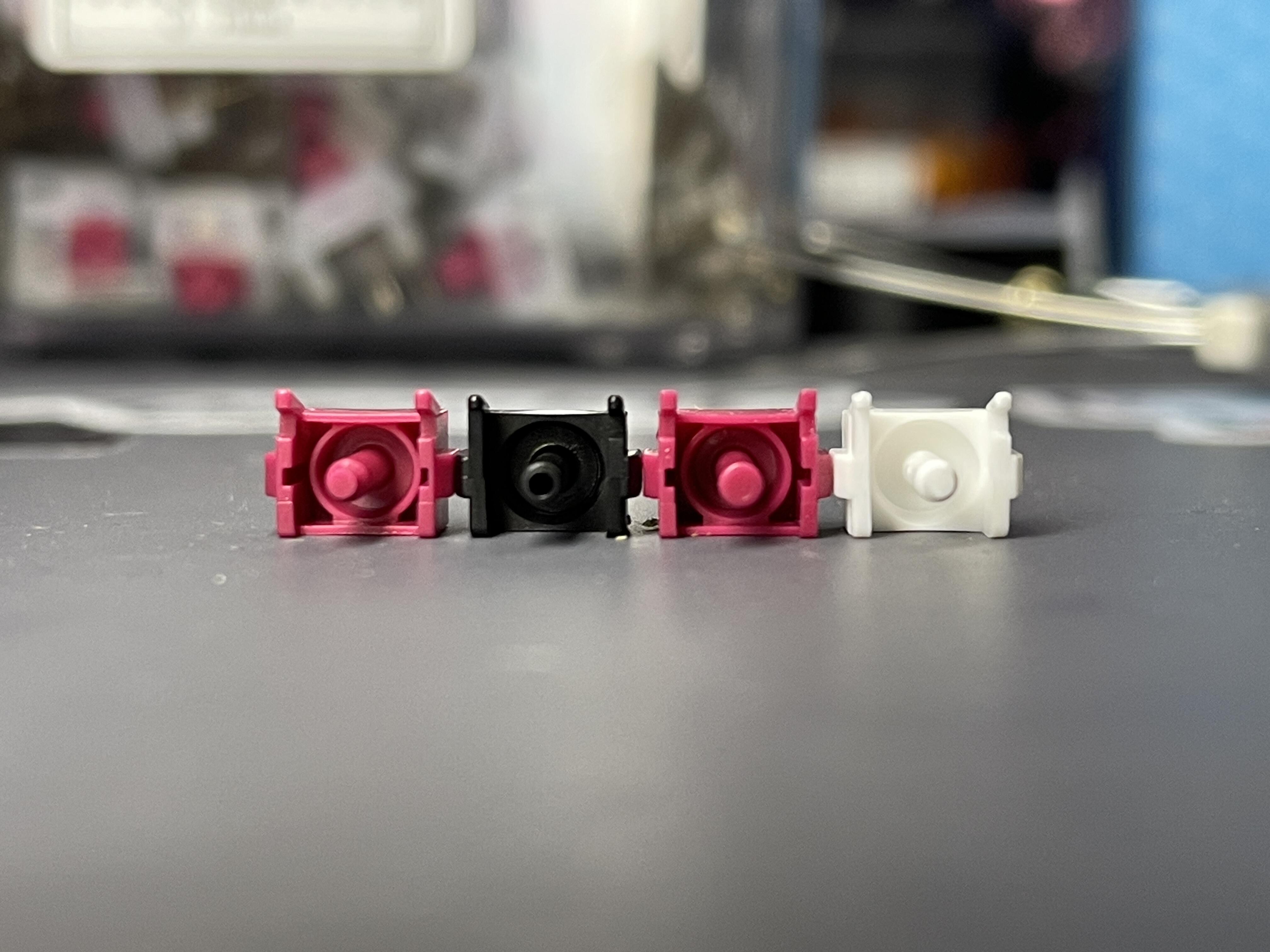

Comparing the tapered and flat Burgundy Pro stems with those of the Cream+ and Cream Dreams.
The tapered Burgundy Pro stem is about .3mm longer than that of the Cream Dream stem, which I believe have the same specs as the normal Creams, just broken-in at the factory.
The N/S faces of the stem of the Burgundy Pros extend farther down as well.
What’s also interesting is that the flat-bottomed Burgundy Pros, Cream+'s, and Cream Dreams are almost identical in length.
Also, the Burgundy stems are semi-hallowed out…
As far as how they all sound in a Cthulhu setup, almost identical. The Cream+'s bottom-out isn’t as bright, but similar in tone, at least being actuated next to my ear. In board may be a different story.
This is just a quick and dirty comparison, and I hope to have more information soon as I craft the next batch of Frankenswitches. :+1::+1:

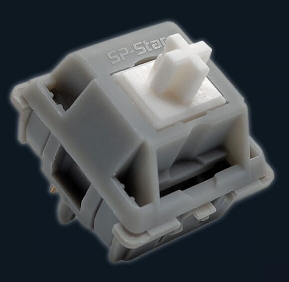

Next, they use the tried and true Cherry top Housings, and then use the bottom housing of an SP Star Meteor White.
Seeing as how long-poles are all the rage right now, this Frankenswitch delivers that sweet clack in spades!

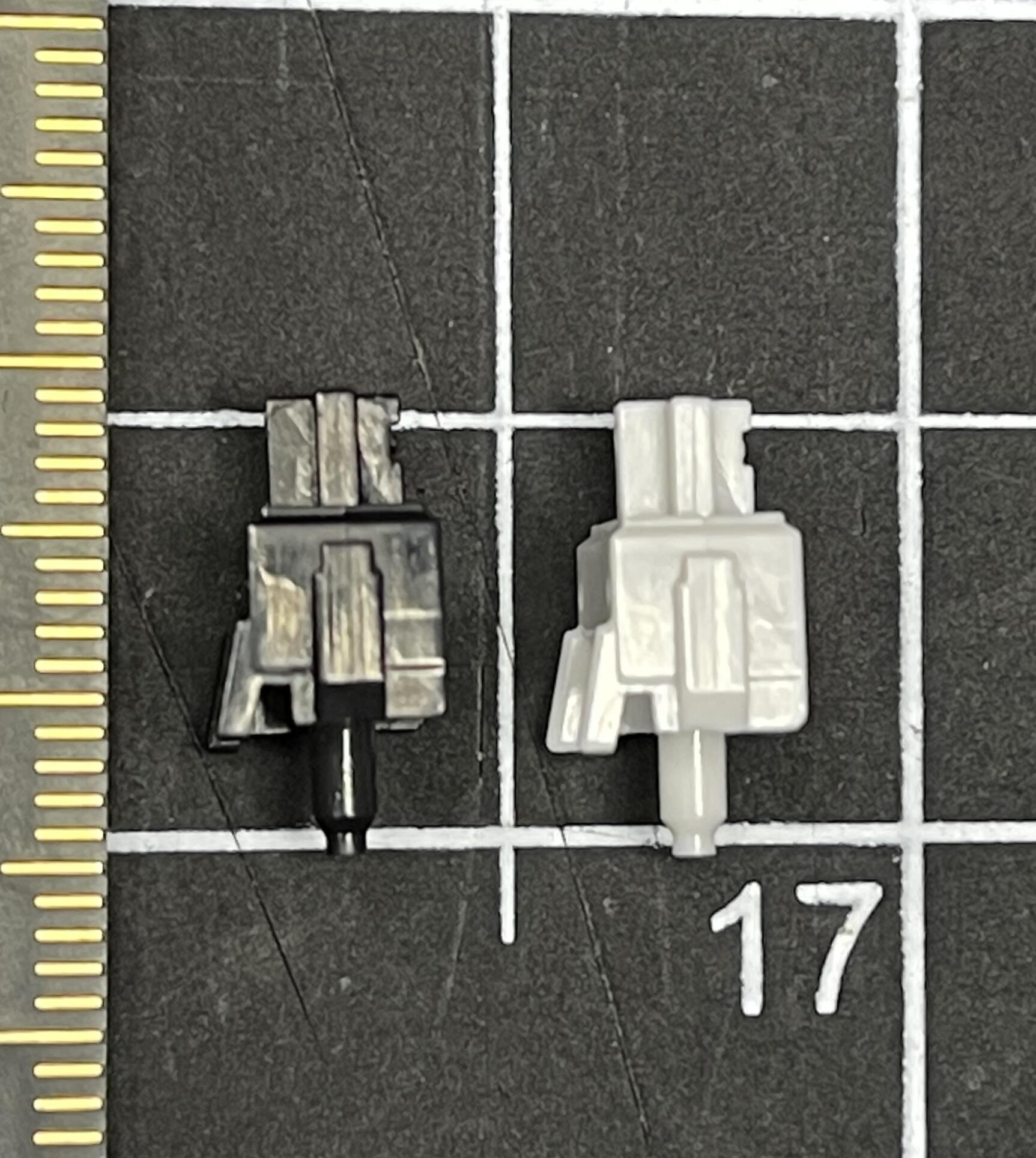

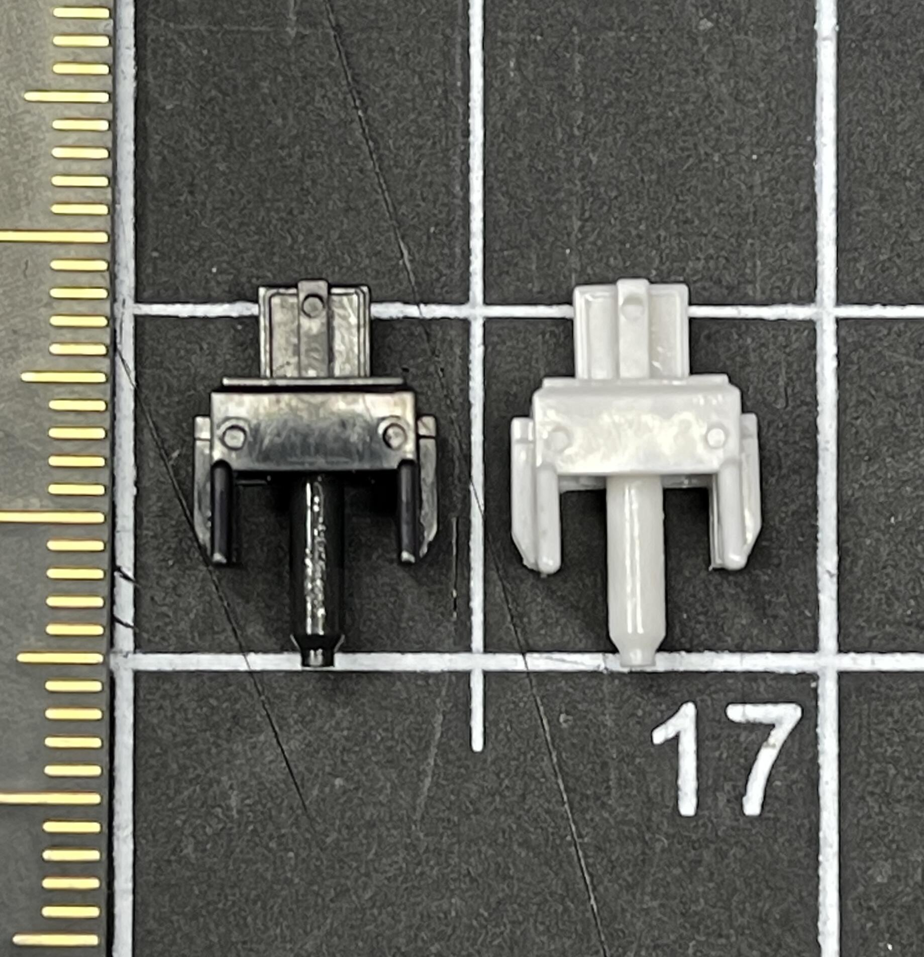

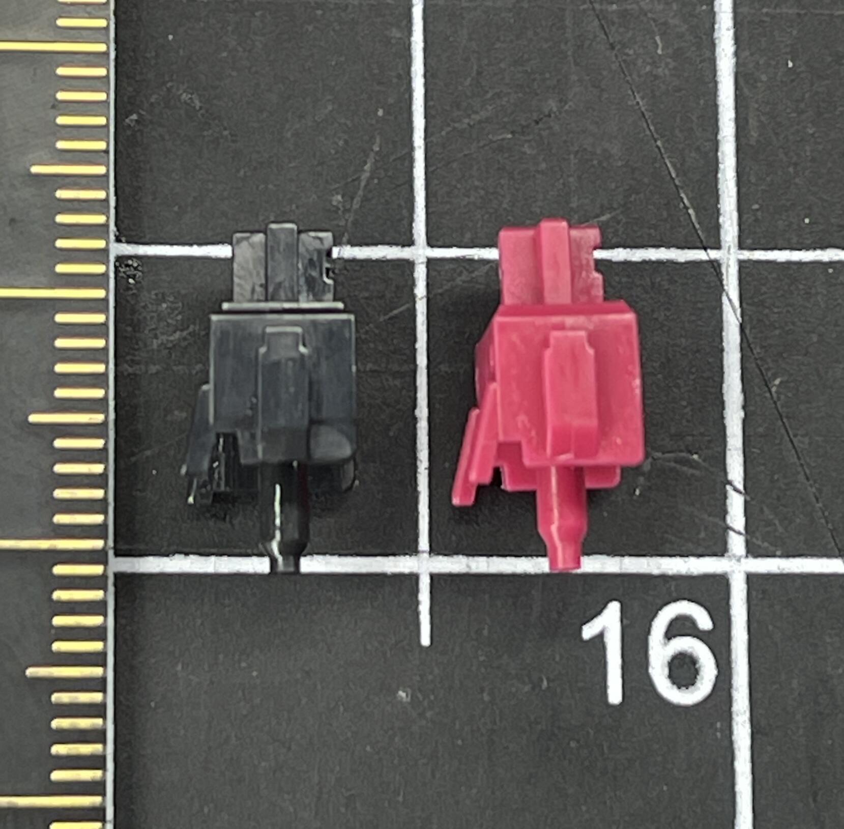

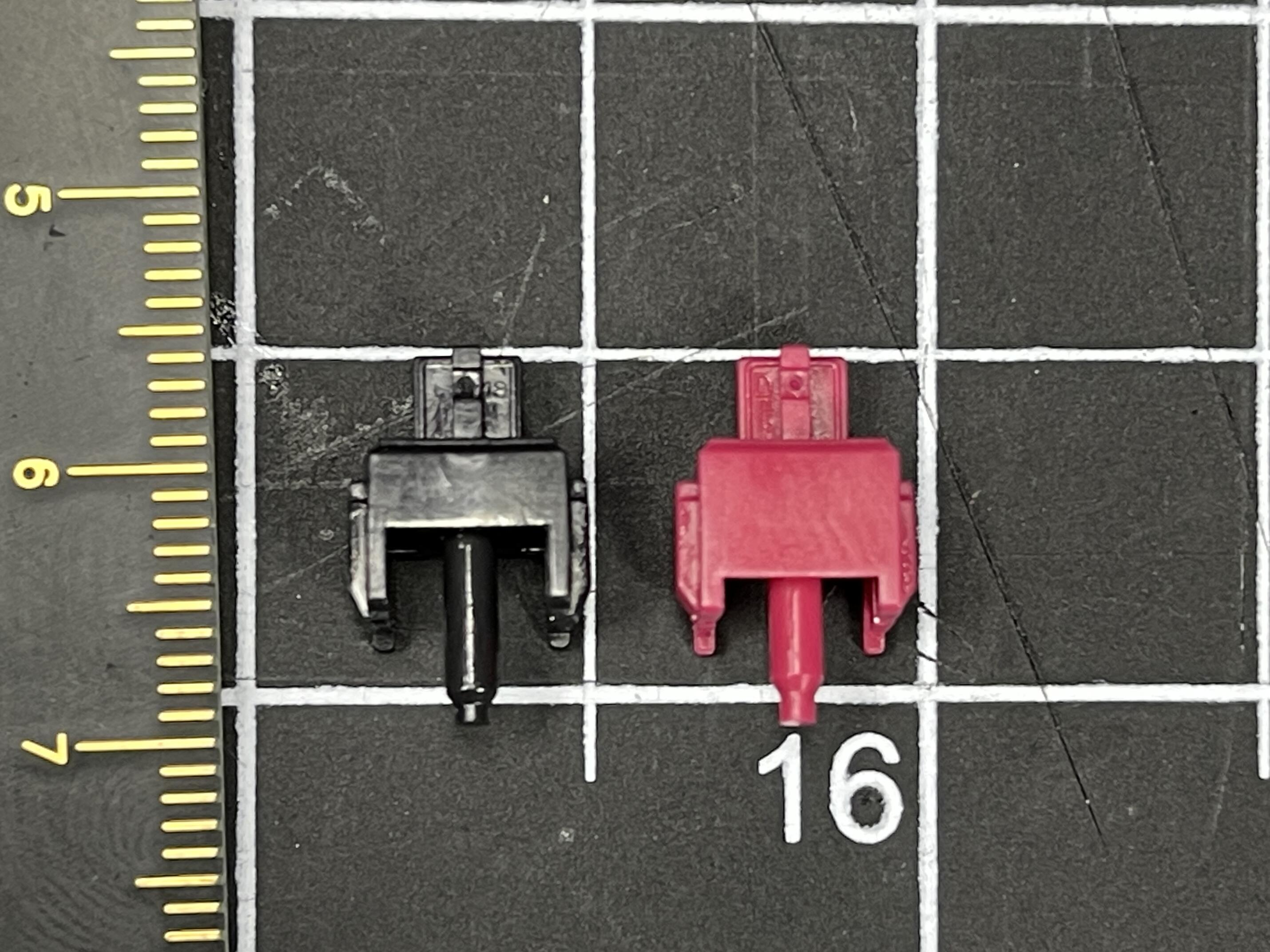

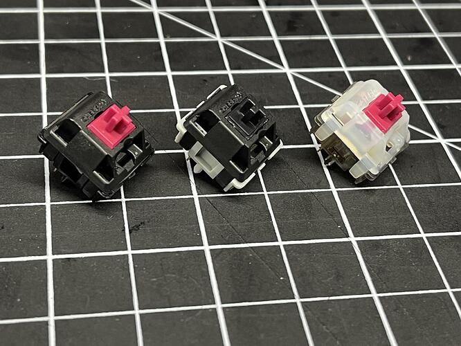

The stems on the Bubble/Black/Zakus are not too far off from the Kailh Burgundy (Cream) stems I use in my BCP’s and Cthulhu Frankenswitches.
From Left to Right: BCP, Unnammed Frankenswitch, Cthulhu
Bubble/Black/Zaku stem
Kailh Burgundy stem
The real difference is in travel!
You are definitely going to want to use long-pole stabilizers with these switches.
BCP
Cthulhu
Yet Unnamed Frankenswitch

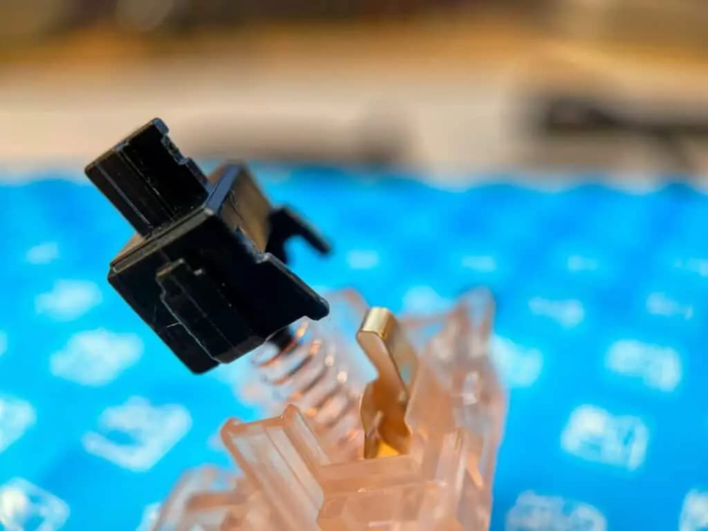

Has anyone here made Soju switches and experience issues with the leaves getting pushed out of place when inserting and causing them not to registering? I’ve found it is due to the boba top housings not having the same teeth that hold the stems in the Kiwi bottom housing which are in the stock kiwi switches, which results in the Kiwis having loose leafs. Does anyone have a solution for this at all?
This is definitely a thing with some combos since not all switches hold the leaf in place the same way.
Only sure way I know is to install the switch into hot swap sockets is without the top so you can hold the leaf down while installing. For soldering it’s usually enough to just be careful.
Do you think there is any mod that could hold the stem from the inside like how some top housings do, while also not damaging the switches?
Seems like it would be possible, but might take some experimenting to figure out. Maybe a 3D printed part that slots in somewhere or maybe fits in like a film, but performs the function of holding the leaf down. Looking at JWK housings like Kiwis, they have little “teeth” or nubs on the top that hold the leaf down - seems like that would be possible to supplement.

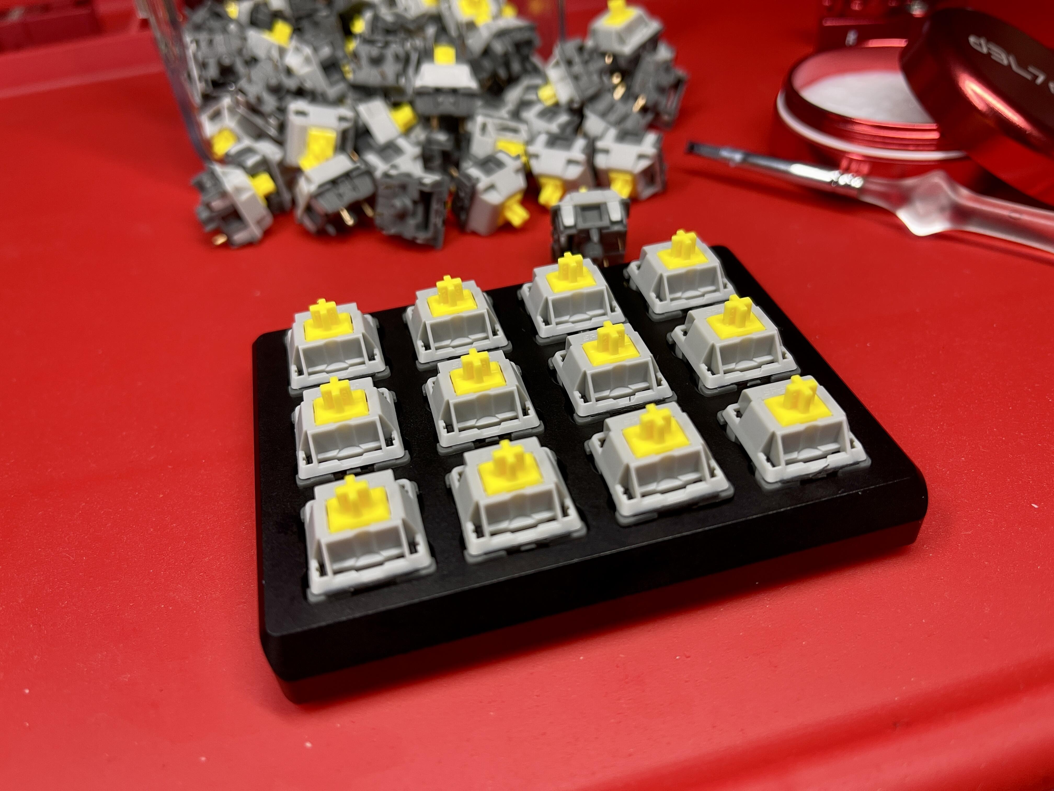

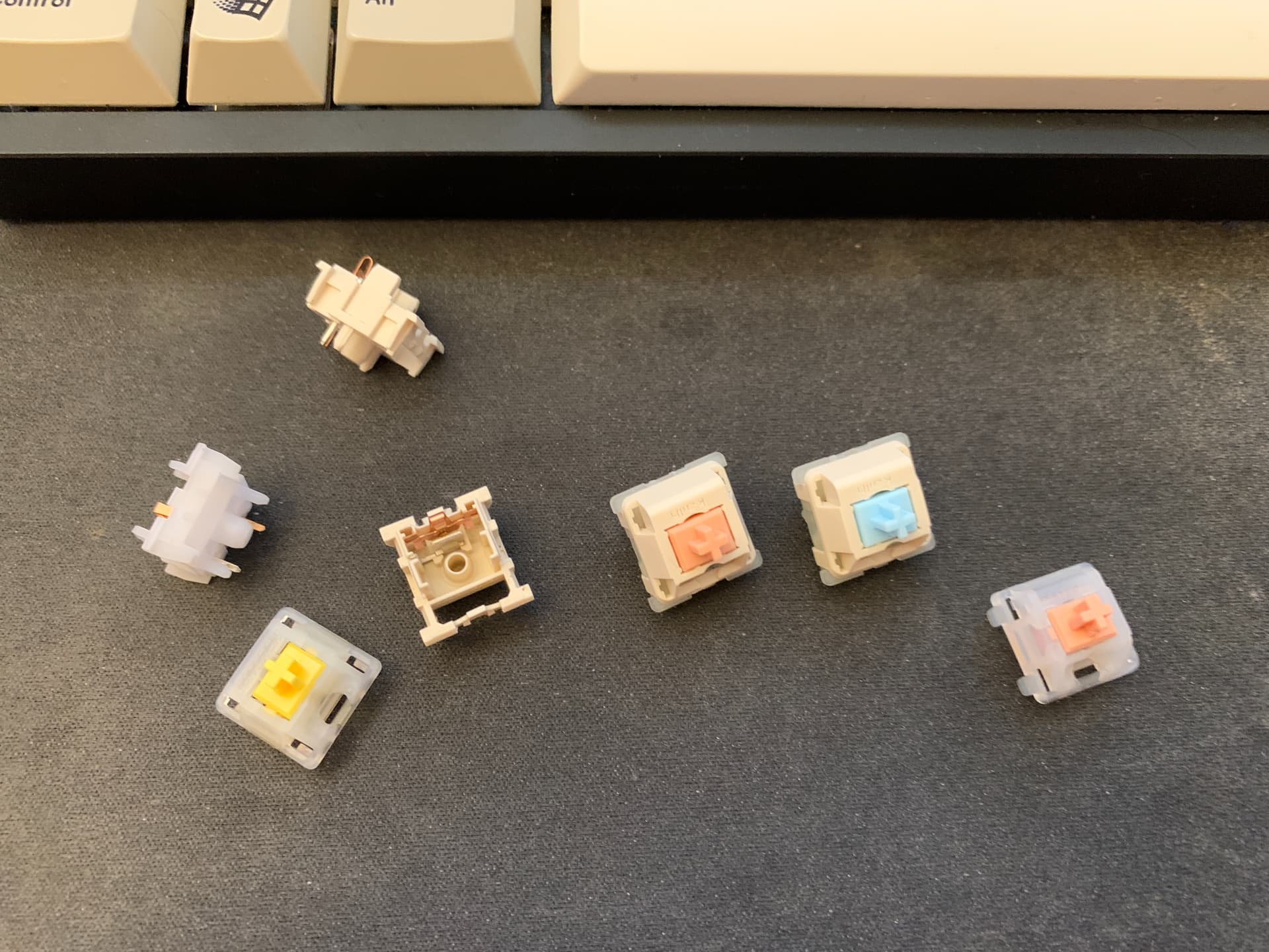

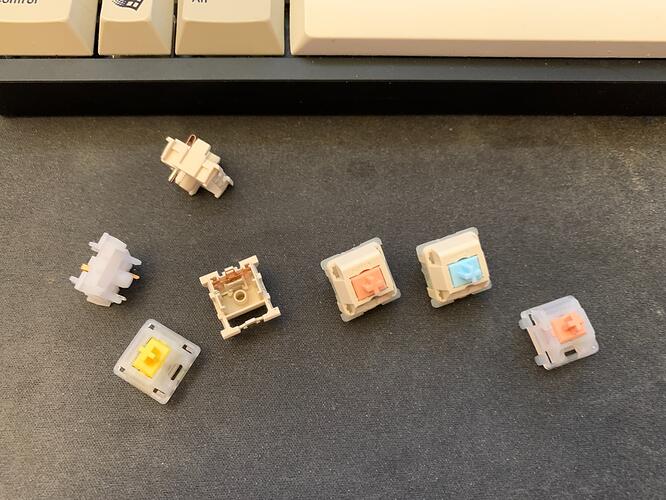

I am going through all of my leftover parts and trying to come up with switches and found one that actually sounds and feels pretty good.
Top: SP Star Meteor White (Nylon)
Bottom: DROP x Gateron Holy Panda X (Nylon)
Stem: Gateron KS-3 (Milky Yellow) Pro (POM)
Spring: NK_ Silk Olivia (Single stage, 45g Operating
63.5g Bottom, Rose Gold coated)
I have yet to put them in the board, as I need to go though and lube them to mitigate the occasional (very light) leaf ping that is in just a handful.
I tossed Deskey films in them and it snugged things up a bit more, but you can probably get away without them. Standard Gateron stem wobble is cinched right up and the switch has a really nice look overall. Will try them out this weekend, hopefully :+1: :+1:

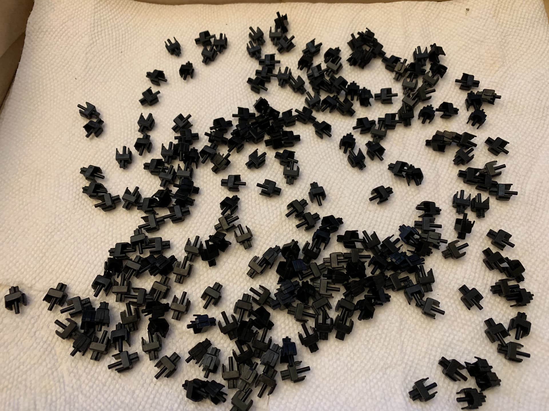

Sundried Kailh Black v2 stems w/4 coats of RO-59 for frankenswitching.
Okay, I am really vibin’ on the looks of these switches… :hot_face::heart_eyes:

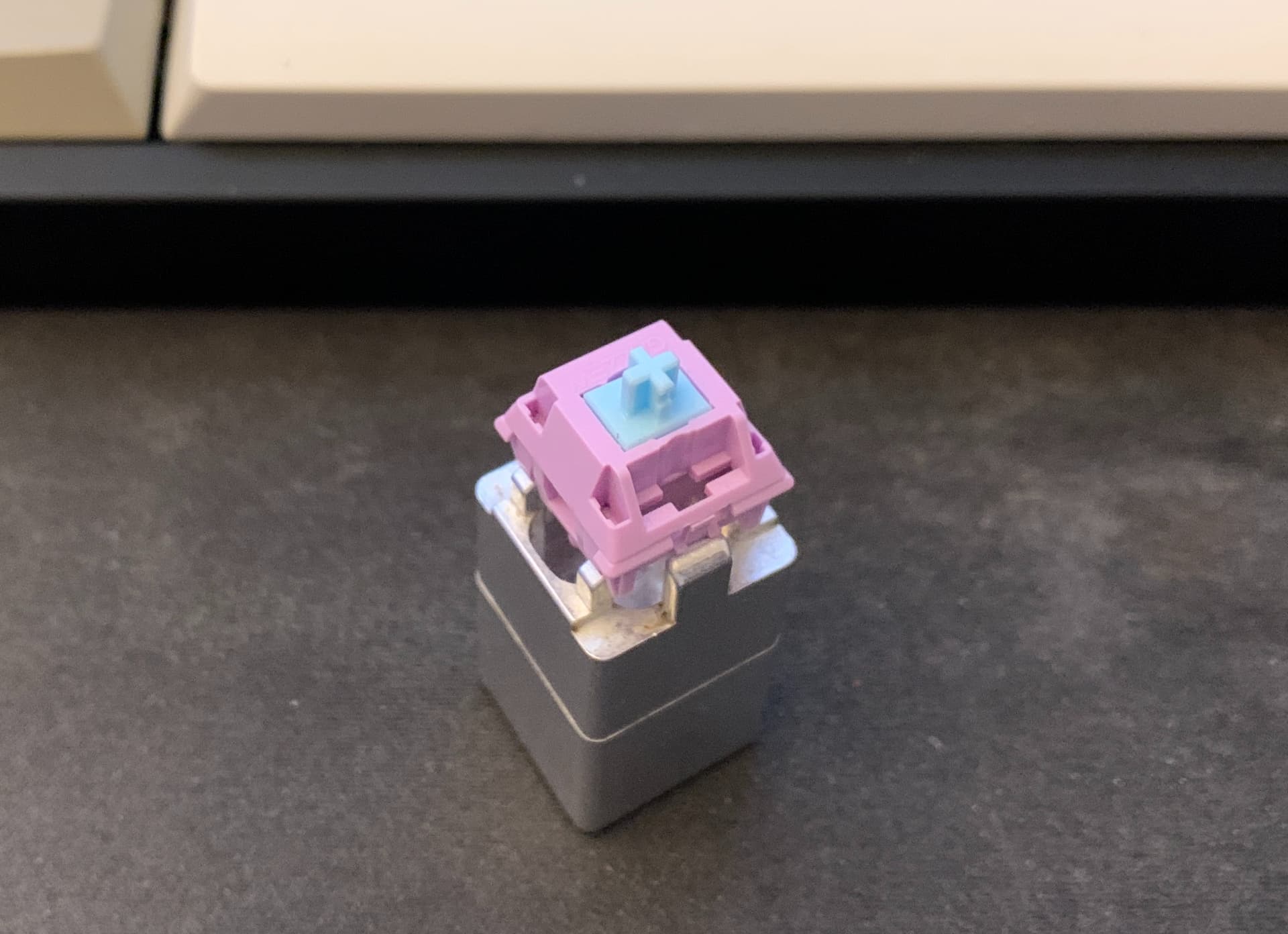

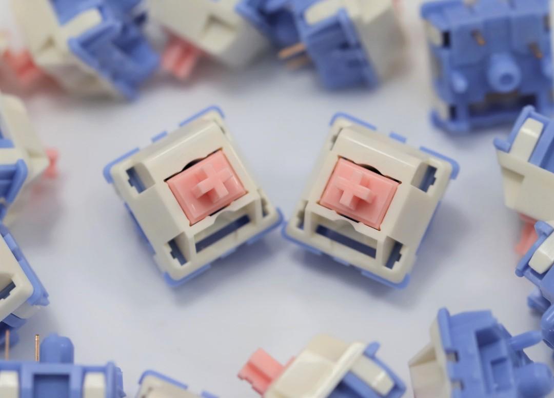

Sharing a datapoint: Geon Baby Blue tactile slider fits Boba LT housing very well. Little or no N/S stem wiggle. Slight but very decent E/W stem wiggle. I’d rank this one among the least wobbly frankenswitch. Feels, sounds, and looks nice.
