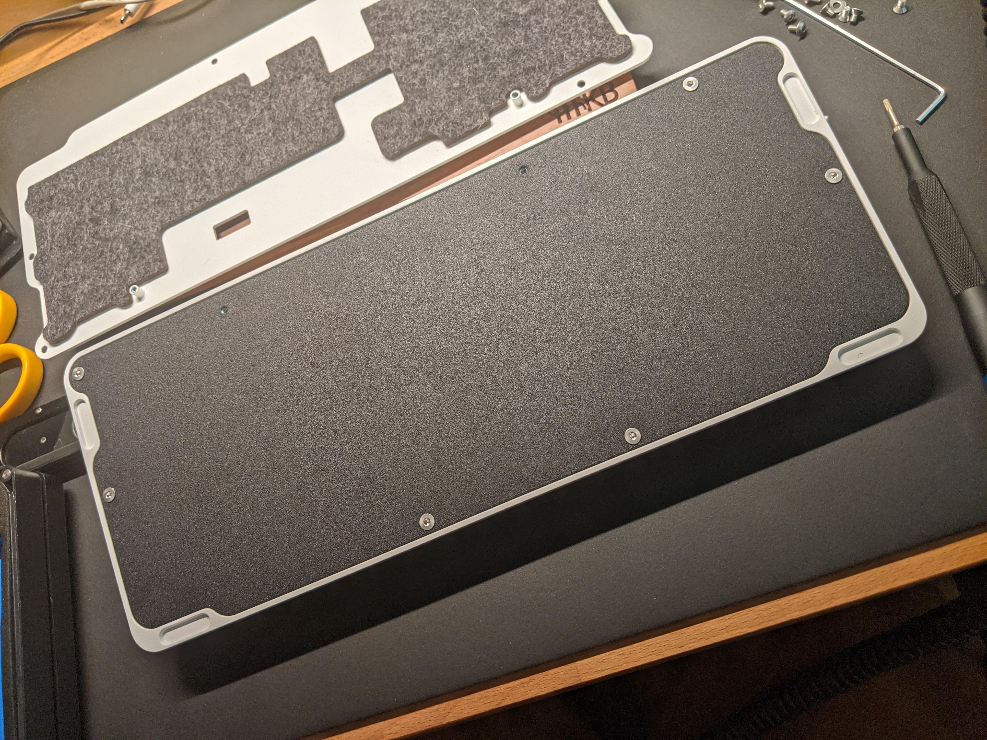

Ok, I’ll bite: why is your rear plate black?
I got a mismatched Pro 3 bottom (the white one with the hole in the first photo) and Pro 2 top. They ran out of Pro 2 bottom plates in K2 when I contacted them so I told them I’d be happy with a black one instead and am sending back the K2 Pro 3 bottom.

Et voilà!
Q: How long did it take you to put this together?
A: Around 6 hours, including lubing, silencing, and other mods.
Q: What was the best part about the build?
A: The complex detail of the custom plate was riveting. It was a piece of work really worth admiring. Also, the package was delivered a day early so obviously it felt like Christmas which made the experience even better.
Q: What was the hardest part about the build?
A: The top edge of my custom plate (where there is a little tab that seems to be for easy positioning) needed a little filing to perfect the alignment. The included tool which could be used for this purpose was a great touch. The poron gasket positioning was a bit of a challenge as well, but it gets simple when you figure out that you can lift the whole enclosure around to let gravity do the work for you.

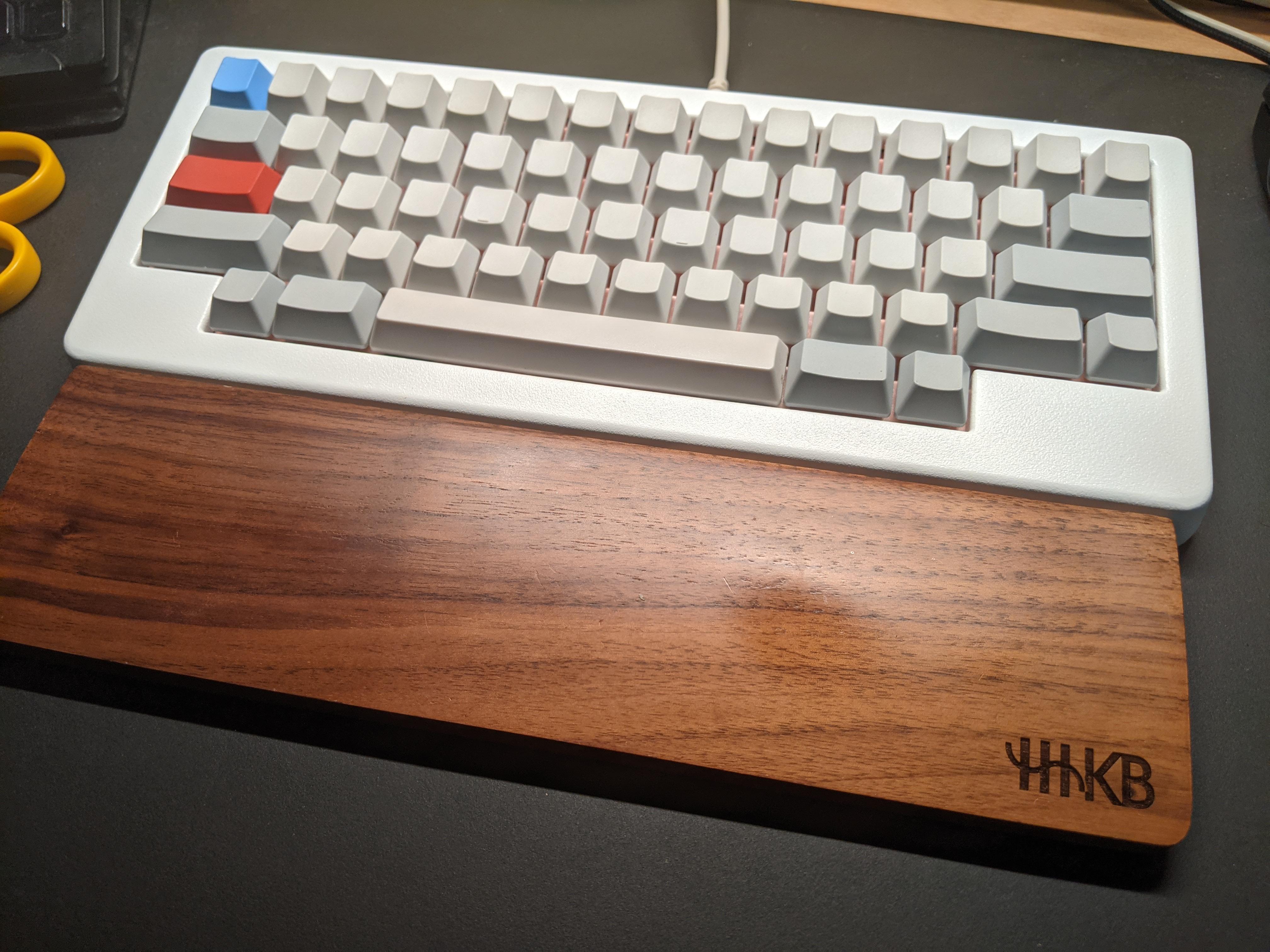

Built my Heavy Grail yesterday. This keyboard feels and looks amazing. To me, it types like a much sturdier version of the original. The bounciness is still there, but the fact it stays put on the desk makes gives it a more regal experience.
I have no less than 8 HHKB layout keyboards, and this one is by far my favorite. Great work by @norbauer and team. Thank you!
