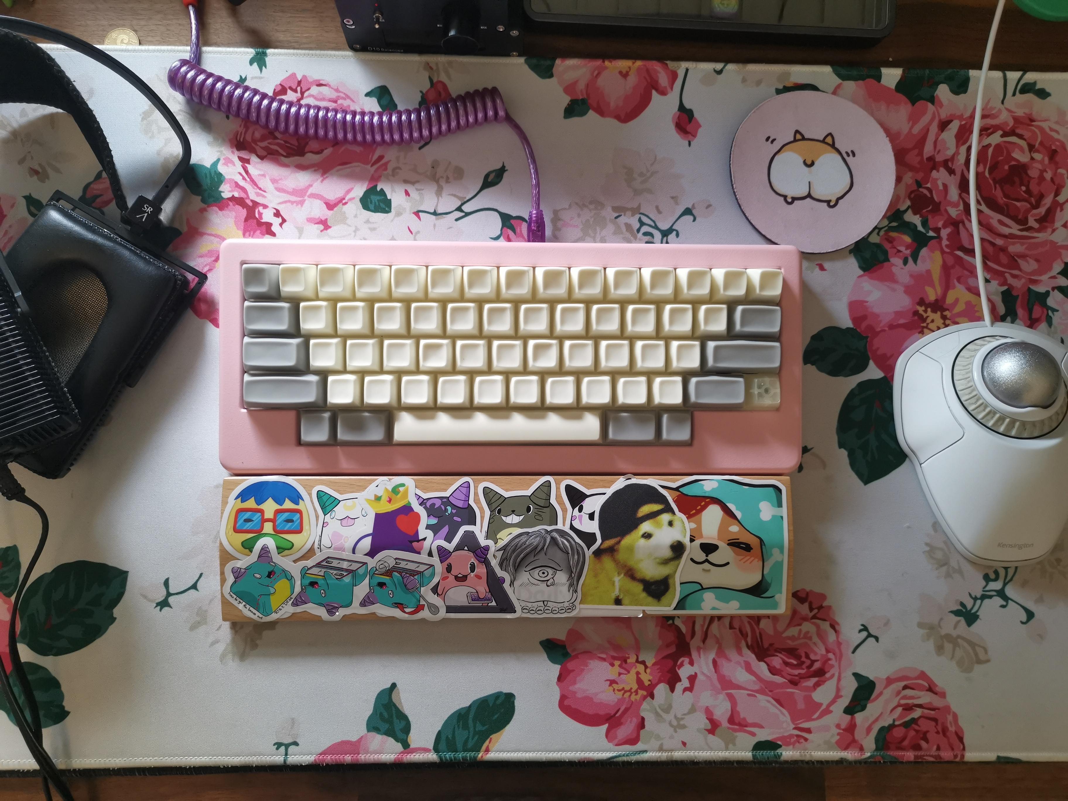

I used yoycart to get a usb-c version of his Bluetooth controller. Based on previous reports here it should work with the pro2 heavy grail.
Thanks again for your hardwork into this project, love how it looks in the setup. Hoping the 23u housing will be offered in sunset blvd so i can pair it up. :slight_smile:
