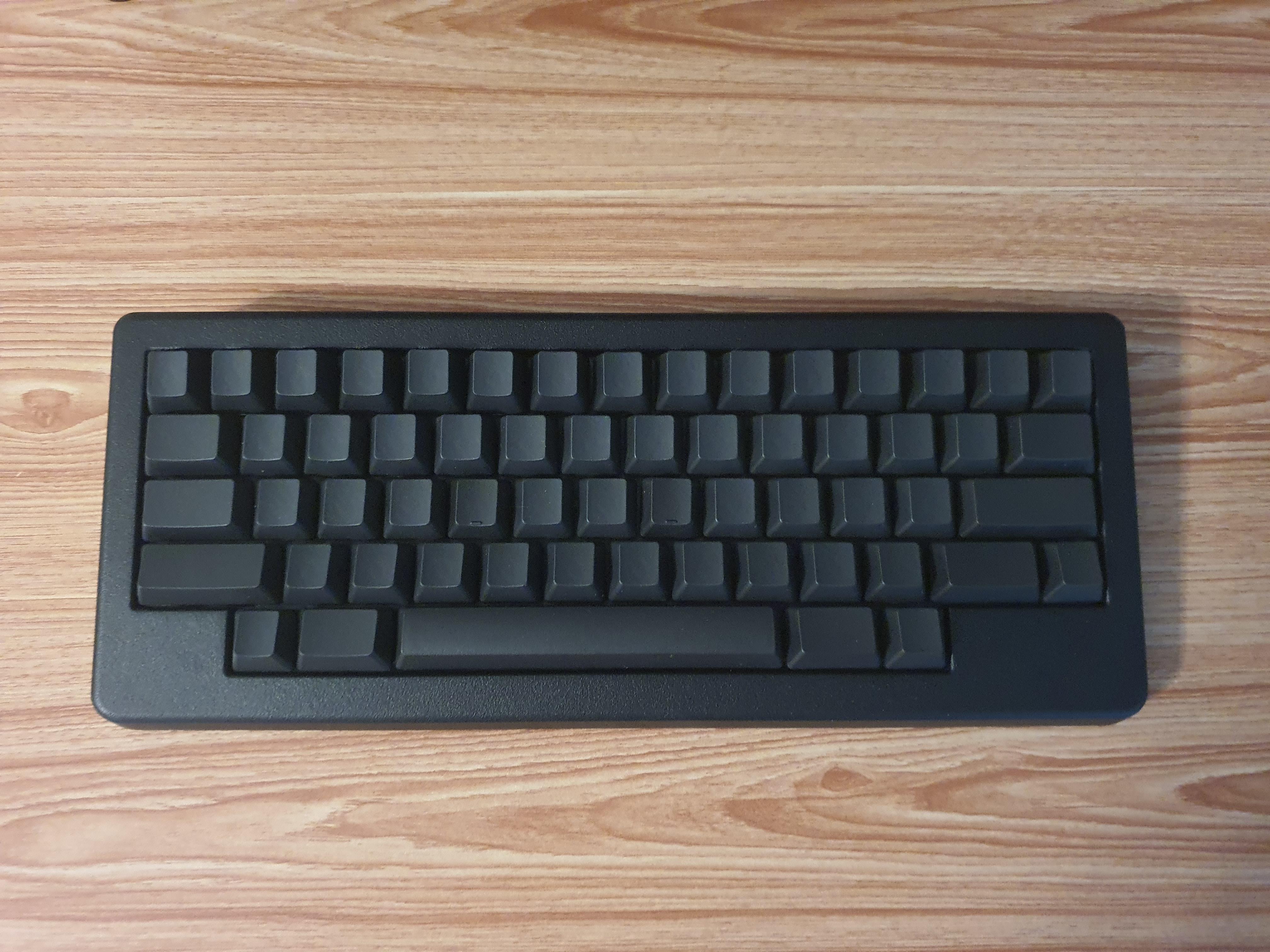

I had one of my keys (x I think, something in the third row) which I really needed to file the plate down on to get it to free fall. I’m using stock black sliders from a HHKB I’ve been using daily for 3 year, so its definitely not the slider. I was shitting myself filing the plate watching it go white, turned out fine from what I could tell in last couple days.
In total, I had to file 4 or 5 of the slider holes. Not something I really expected but I’m fine with it because where it counts, the slider walls, the plate is consistent and smooth. This is without lube, no silencing rings and no plate gasket.
I have 1 kbdfans slider for an artisan, and it sucks just like on the regular HHKB (Uber rattle). Can’t wait for these Des Stabs.
Heh, my memory is failing me, I do remember taking the file and gently circling each of the plate cutouts for the sliders. I don’t remember if this was because the sliders were getting stuck or not, but that might have been the case. My thinking was that I wanted to do all the mods to the plate as fast as possible so that in case I ruined it, there was still a possibility I could get a replacement while they were still available. I’m happy to say that the sliders are still extremely smooth as well.

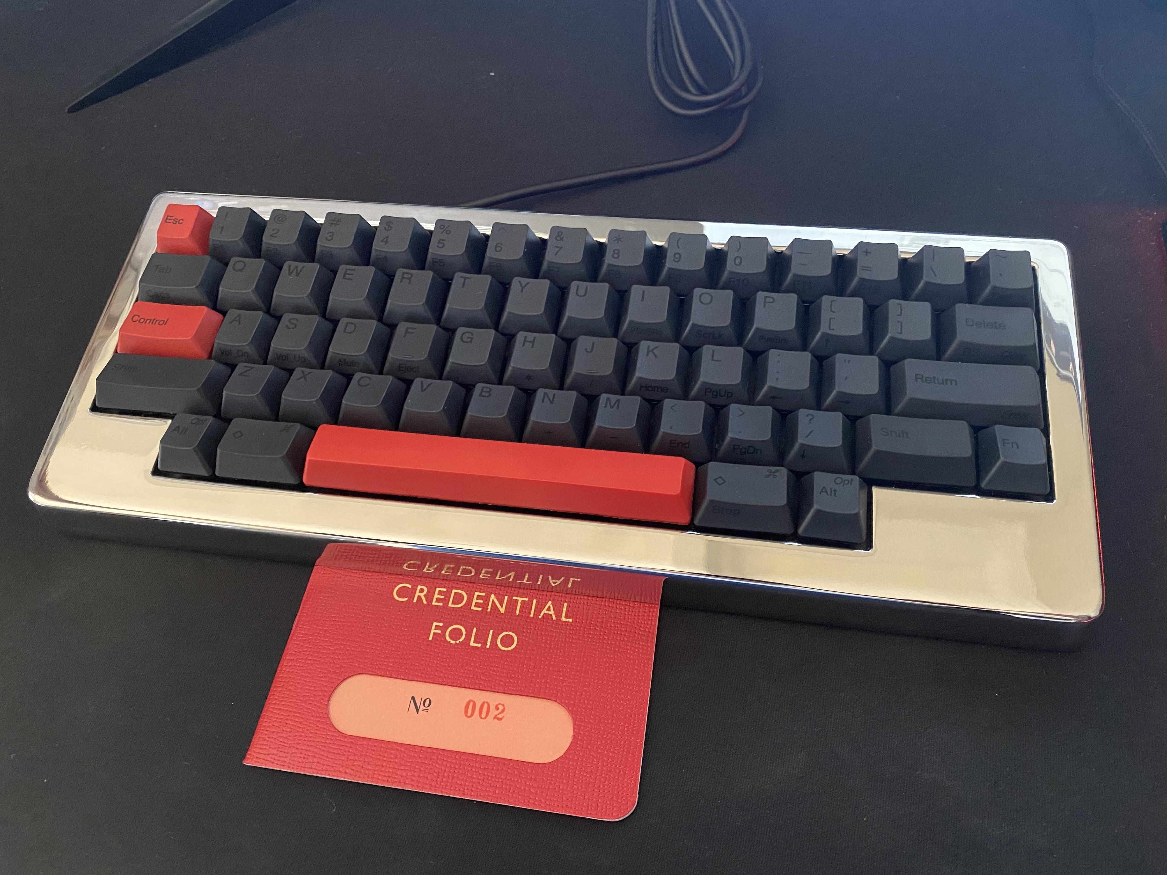

002 in veracity steel checking in! (Who’s got 001?!) It’s been a long road to get this one done, but well worth the wait. Your craft has come a long way since the first Norbatouch. Love it.
