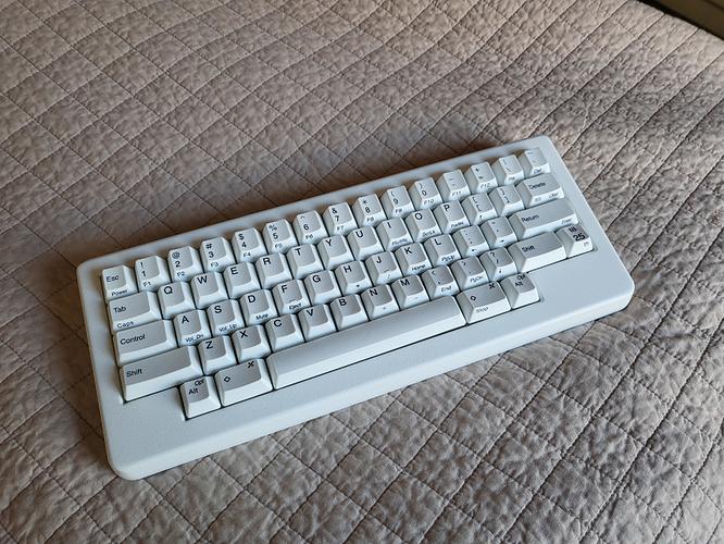

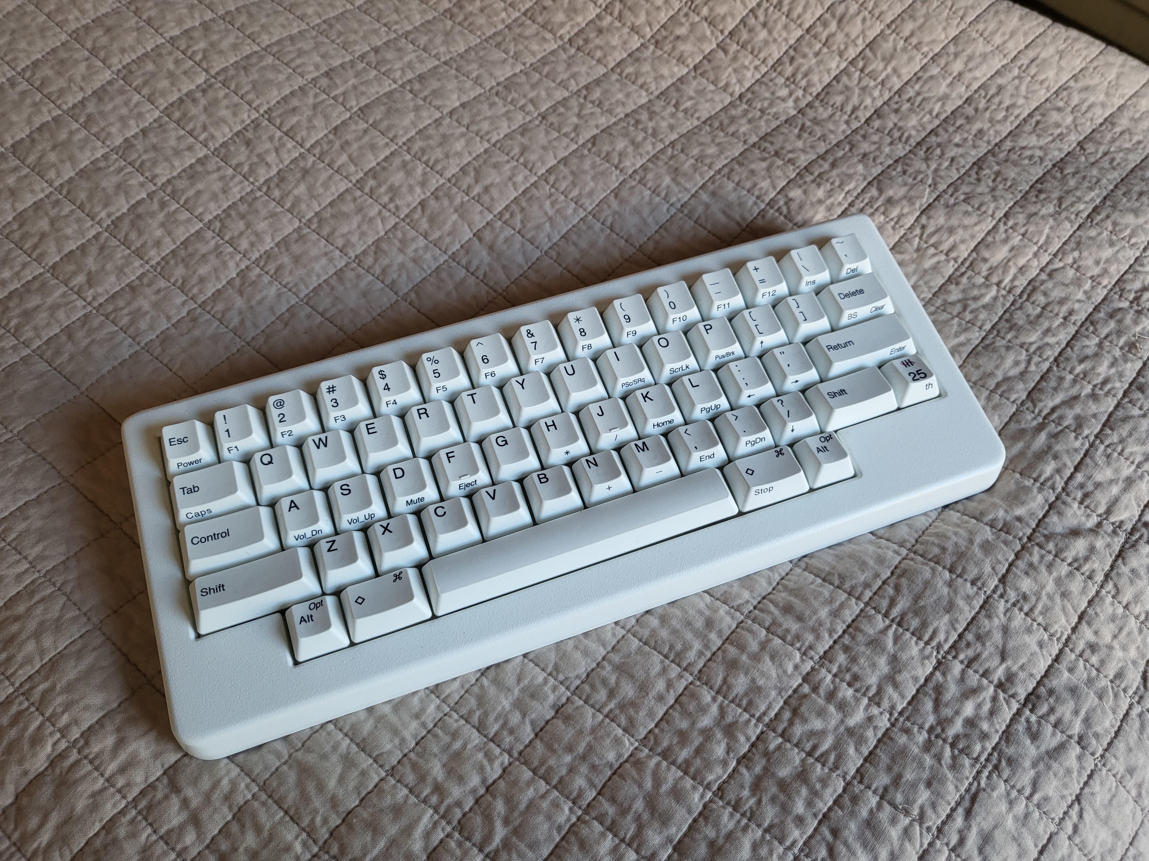

Has anyone been able to get a blank 25th edition pro 3 or hybrid in the US? Maybe just the new all white keycaps? I think they would be a perfect fit for my K3 finish norbauer.
Happy to pay extra if anybody from Japan was able to get their hands on them.
