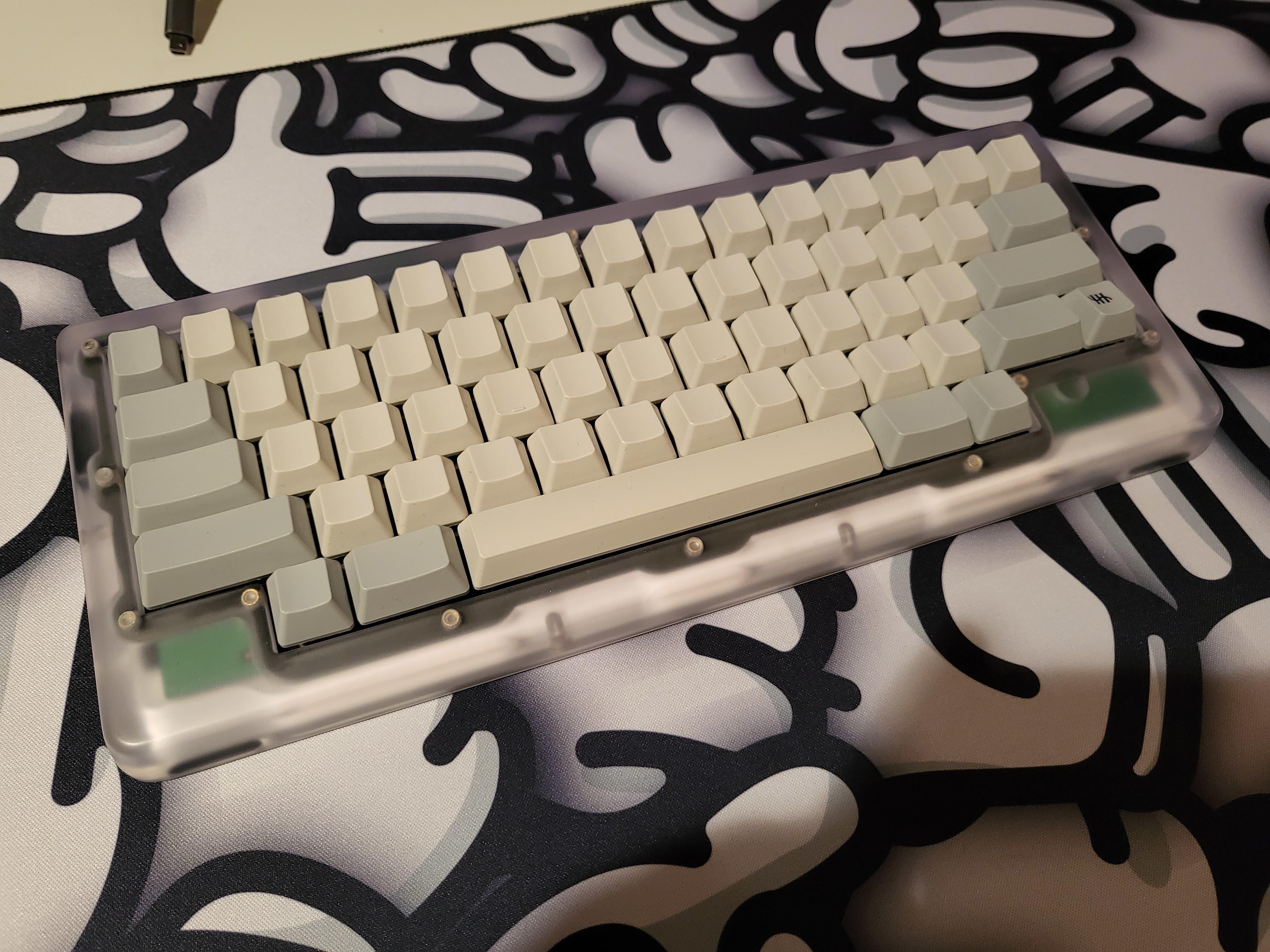

Now that the order page is up I feel a little better posting this heh, I was graciously offered a prototype unit a little while back to make up for some really frustrating shipping mishaps with my K2 unit. It’s gorgeous with blank caps and I can’t get over how cool looking the visible PCB/domes are. This is 100% my favorite design from Ryan so far :slight_smile:
That looks amazing! Any comments regarding feel or acoustics compared to your K2?

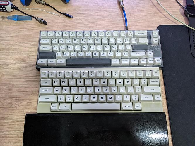

Context is I’ve got an HHKB pro 2 with Yang controller and couldn’t resist getting a PC Heavy Grail. So the question was to HHKB pro 2 pcb + Yang controller into a HG Pro 3 and the issue are two-folds:
  1. Mounting the Yang controller to the rear plate of the Pro 3 - double-sided tapes would do just fine, although Ryan is generous enough to offer an Pro 2 rear plate
  2. The USB cut outs would be wrong - I would be 100% using the board in bluetooth mode, the only cut out I’ll need is for the mini-USB port to actually charge the Lipo battery. and from the pictures the USB port on the Pro 3 is actually way off to the left-hand side vs. the closer to the middle ports of the Pro 2
Guess the solution for #2 will involve either (1) some laser cutting / CNC if that comes to it or (2) buy a Pro 3 and hoping Yang will come out with a custom BLE controller soon or (3) a Pro 2 PC Heavy Grail please Santa Norbauer :shushing_face: :shushing_face: :shushing_face:
EDIT: bonus pic of what is on my desk right now

It’s tough! I would say the Polycarb sounds a little more muted compared to the K2 where there’s a little more resonance. They’re both built and lubed the exact same way and I go back and forth on which one I like more acoustically. Both sound wonderful though :grinning_face_with_smiling_eyes:
