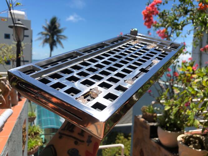

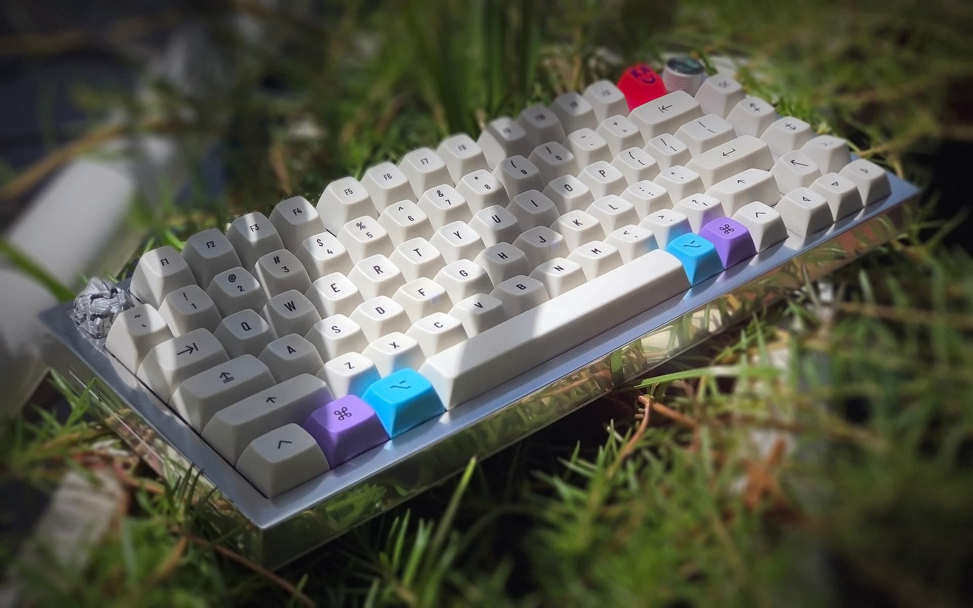

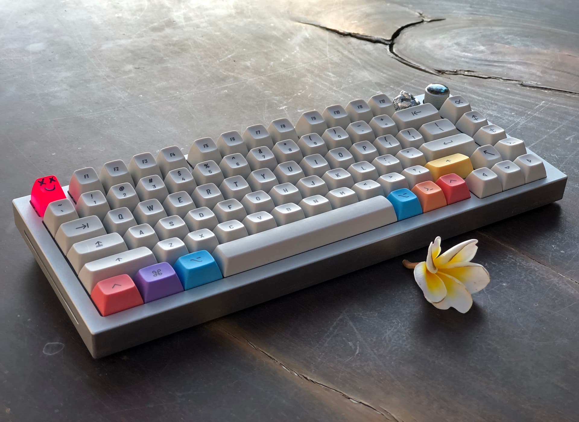

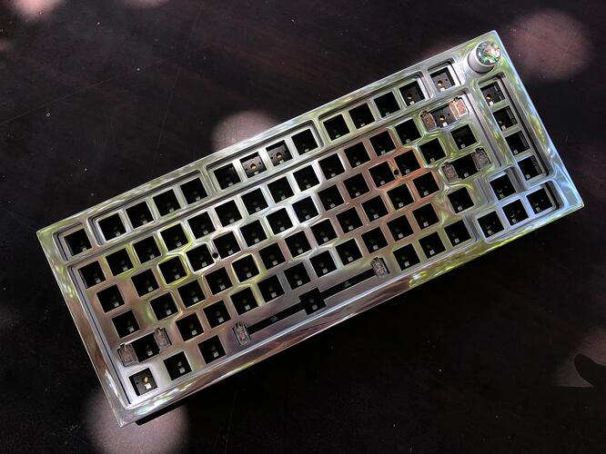

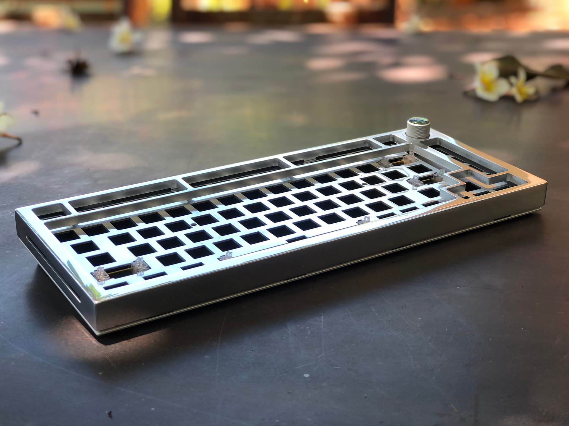

I’m finally happy to share my GMMK Pro with you guys. This is my daily driver. I will do some more tweaks to tune the sound but currently I’m happy with it.
My next keeb? A slightly better layout (75% but not to cramped) and bluetooth support. Sample: Share your favourite layout from KB Layout Editor
I think it’s pretty safe to say you have the sexiest GMMK Pro on the planet, m8
Wow that’s actually the best GMMK Pro in existence hands down hands up hands everywhere for all them smudges :slight_smile:
Beautiful GMMK Pro. Now that the 75% percent layout is starting to get popularized in the content creation area of keyboards, I wonder if companies will start making more budget 75% boards, as some companies like FEKER already have made some, like the FEKER Ik75.
